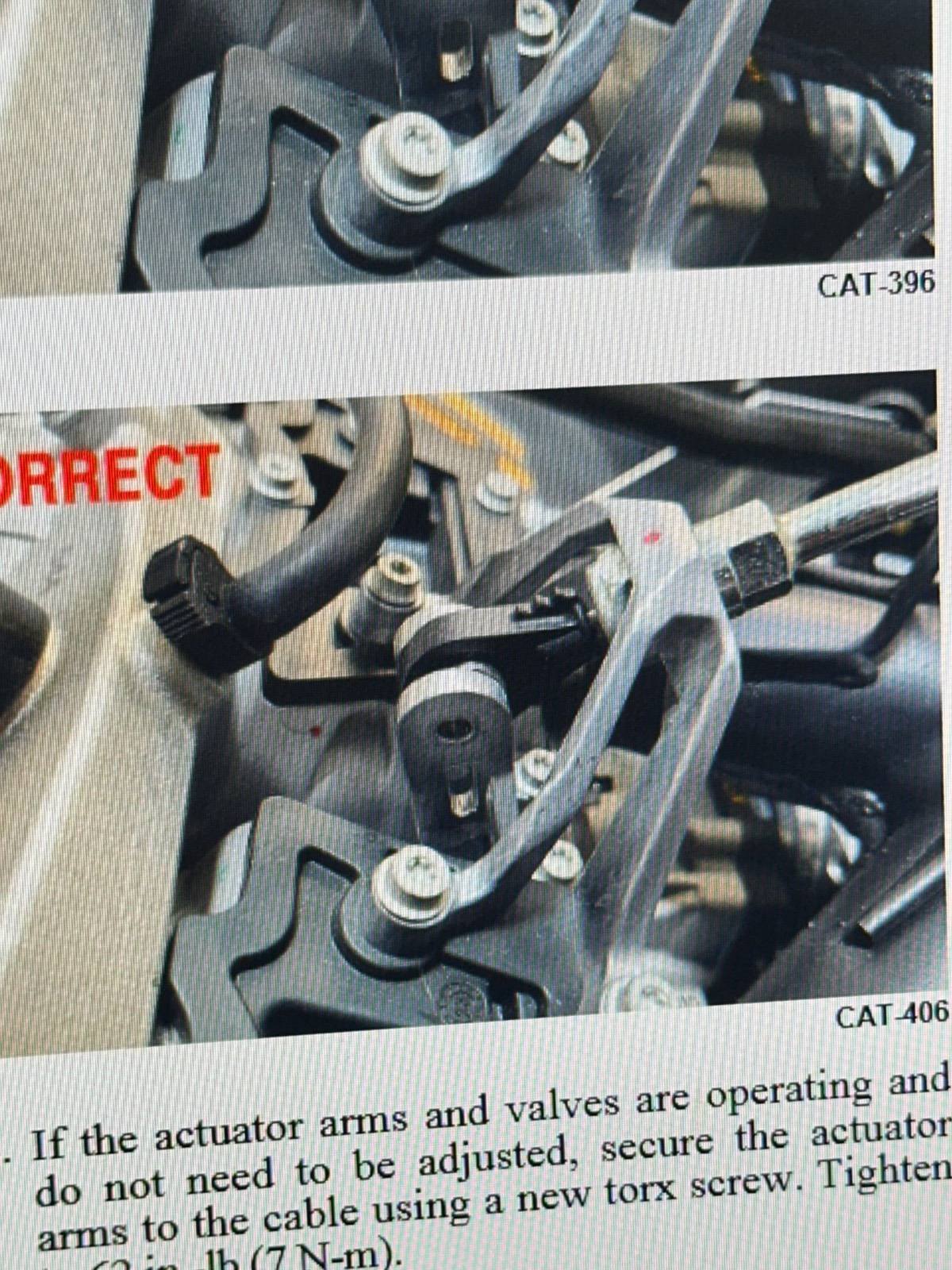

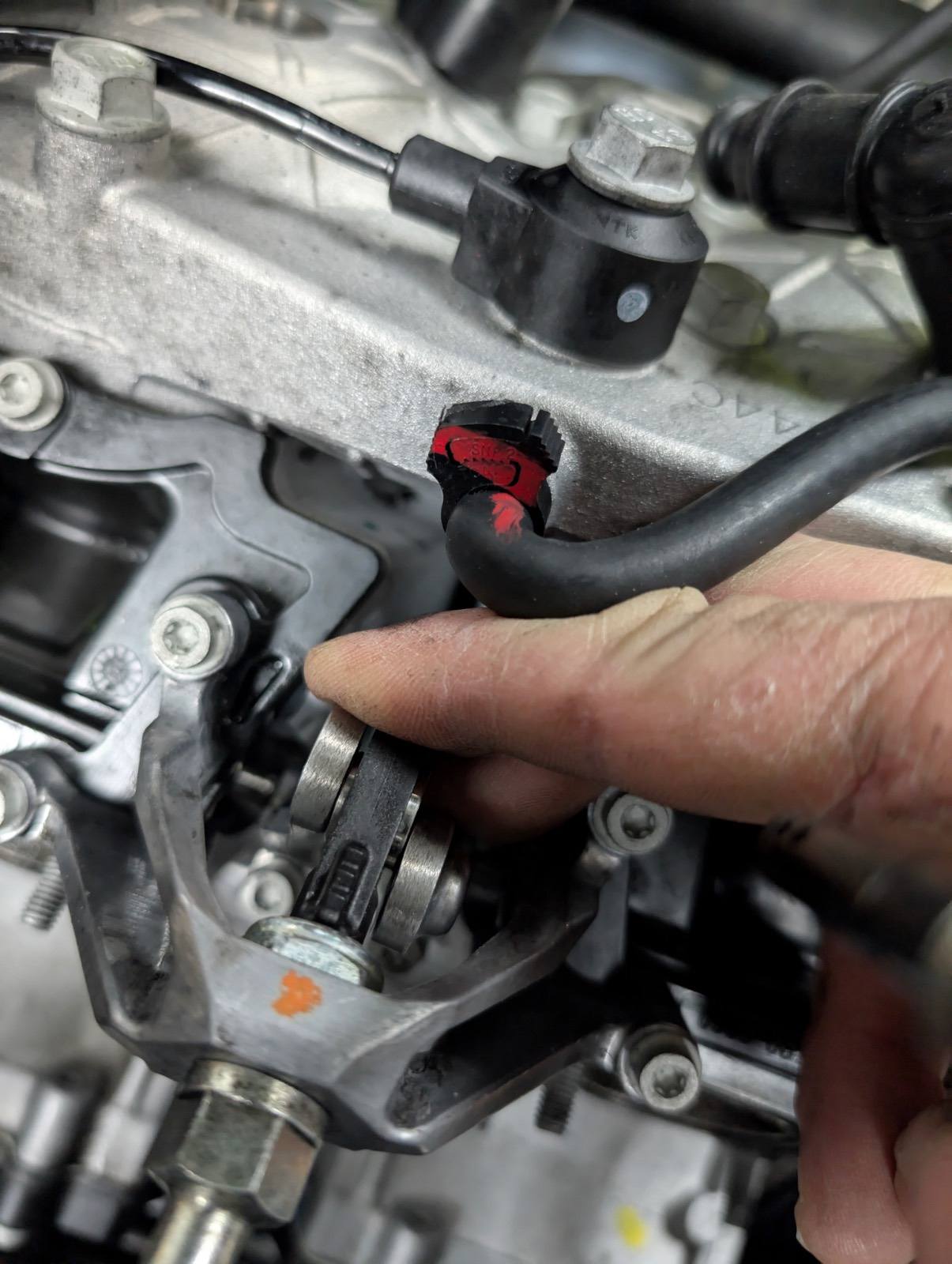

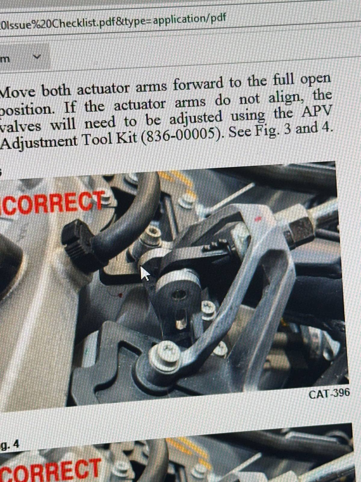

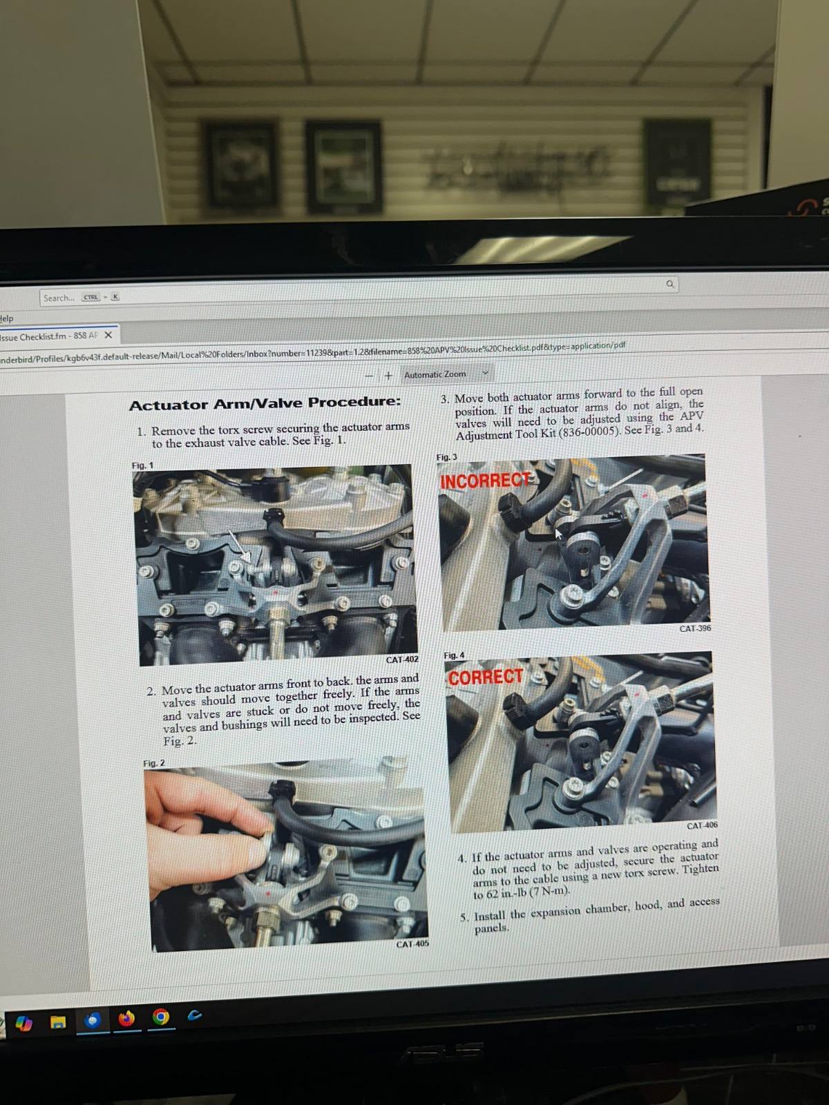

DO NOT adjust your 858 servo motor bracket without a cat scan tool to run the motor through. When you bend the tab it’ll throw the cable adjustment off and the motors stays running at each end of the throw. It’ll burn up the servo motor.
A little context would probably help.
We had one that the servo motor was burnt up on today. We looked and there was plier marks on the bracket. We adjusted a few that were having binding issues and found when adjusting them and testing them. There’s one very small sweet spot where they’ll run through fine with no binding and are within cable adjustment.
Found 2 like this this morning.
You can check them at home without the tool. A good one has 20.25mm between the back of the cable end and the threaded end of the cable sheathing when fully open. We just held that and the exhaust valves open then adjusted the one that was way off to the cable end.
I’d venture to say this is more of an issue than the bent bracket.
I think this is a bigger deal than riders realize.
My dealer has found quite a few.  I was in to pick up the sled and he asked if I had time to wait while they checked mine.  They were off by about 1/4".  I'm not sure how much that would have affected operation.  Some of their early riding customers came back with sleds that ran terrible.  Their valves were much further out of alignment.   It seems to be pretty random which sled is or isn't out of alignnment.
The instructions mention that the servo code only show up after three failed servo cycles.  I doubt many are far enough out of whack to stop servo function.
The first one we found it on did not have a code, but it did eat up a servo motor. The weirdest part about it is it would run through fine on the scanner but would open the valves only about 1/10th of the time on the stand. Tom’s sled never ran over 6500rpms at all and his were off the exact same amount as the other one we found
