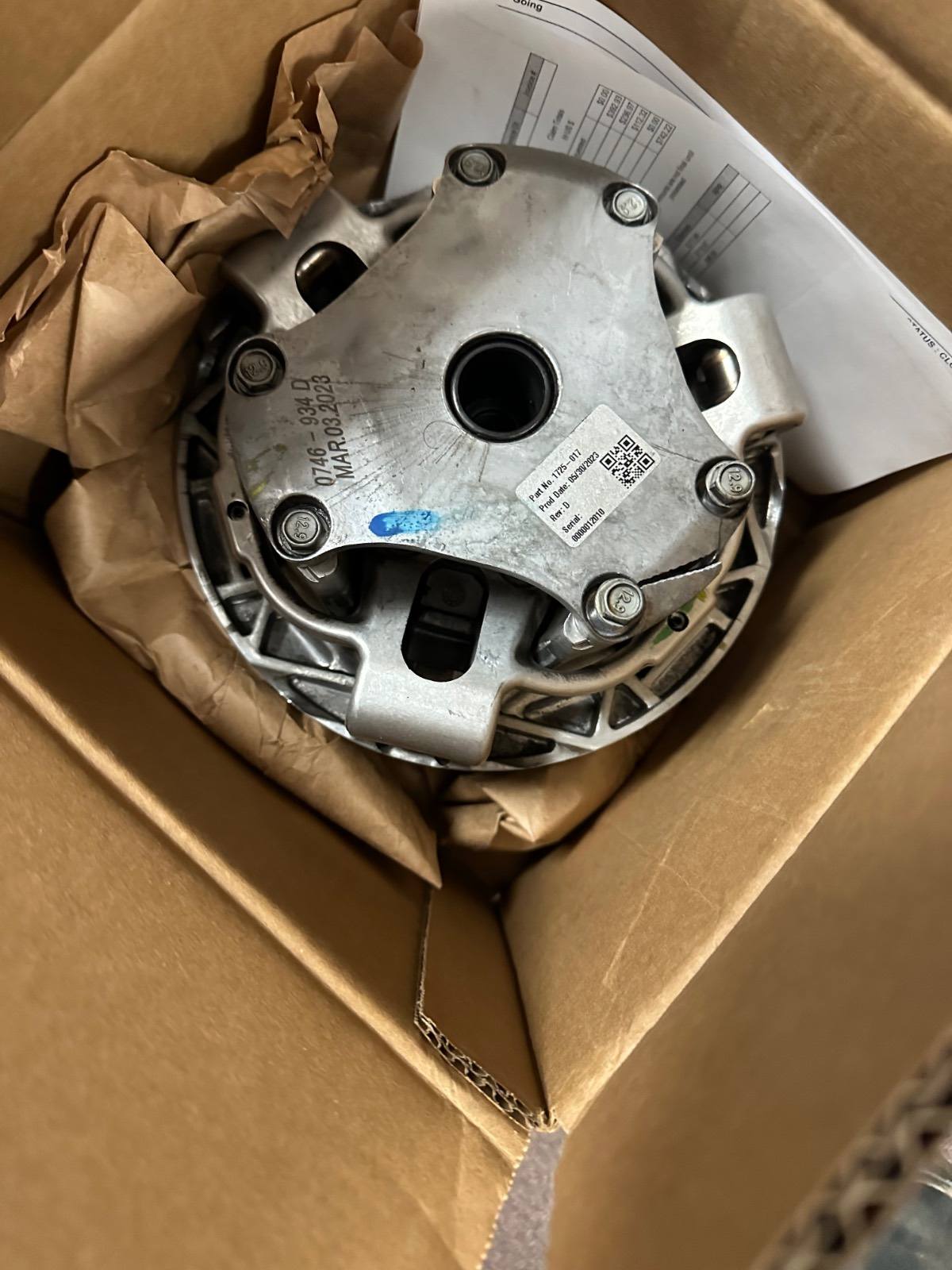

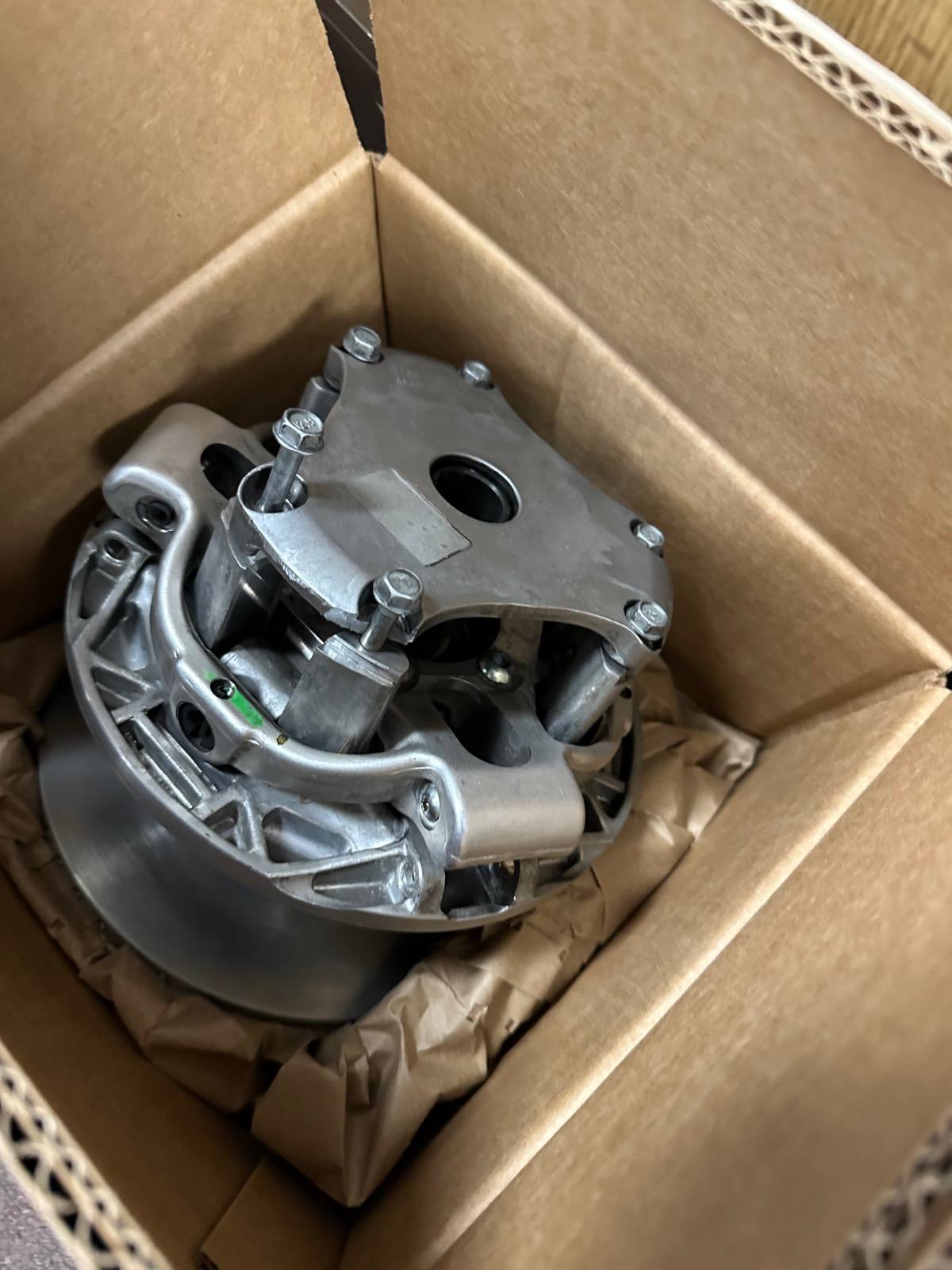

Not exactly as exploded as the pics some people post but they do crack. Speedwerx cover looks to be the nicest all while being the cheapest option out there.
IMG_3241.thumb.jpeg.7b0c7c45b1b85ef639abeb157a9744a0.jpegIMG_3242.thumb.jpeg.d13b0a448b8f1cf1dcc42241cd275646.jpeg
That sucks. Any idea how that happened?
2 of them!
Edited by jonlafon1
1 hour ago, mnstang said:
I'm going to drag my catalyst behind my car and claim with my tuning my stock catalyst goes 120 mph gps and then sell products and that won't be shady at all because it's not technically a lie.  Solid business model.
You could get ZR to be your marketing guy and probably make a fortune. He does have a degee you know.
2 of them!
Heat and being thin in that area I think
I'm wondering if we are seeing some variability in the casting batches.  I've got quite of few miles on my tuned turbo with an ADAPT. Zero issues so far.
Yea it seems like its not every cover. As some get miles on bigger power sleds? These covers should be fine on lower power sleds. I just don't trust them personally, when I broke down the adapt the first time I was really concerned. The cover weights virtually nothing.   :dunno:
Guessing your using a INCH pound torque wrench when installing. :thumbsup:

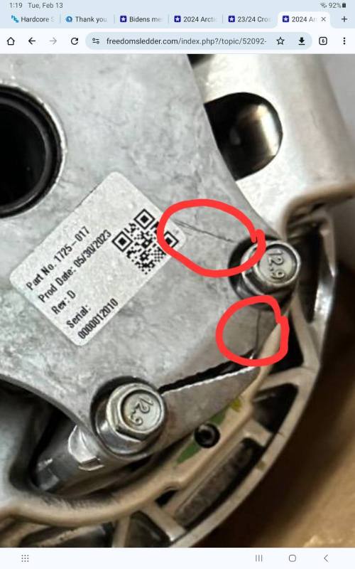

Maybe the towers and the cover not being flat and parallel with each other??
Appears to be more cracks circled in red
That one cracked two covers in a day so we were actually thinking it may have been a tweaked tower as well. Not sure if the one going in towards the spider is a crack or not but the other circled area was also completely broken off just held in by the bolt
