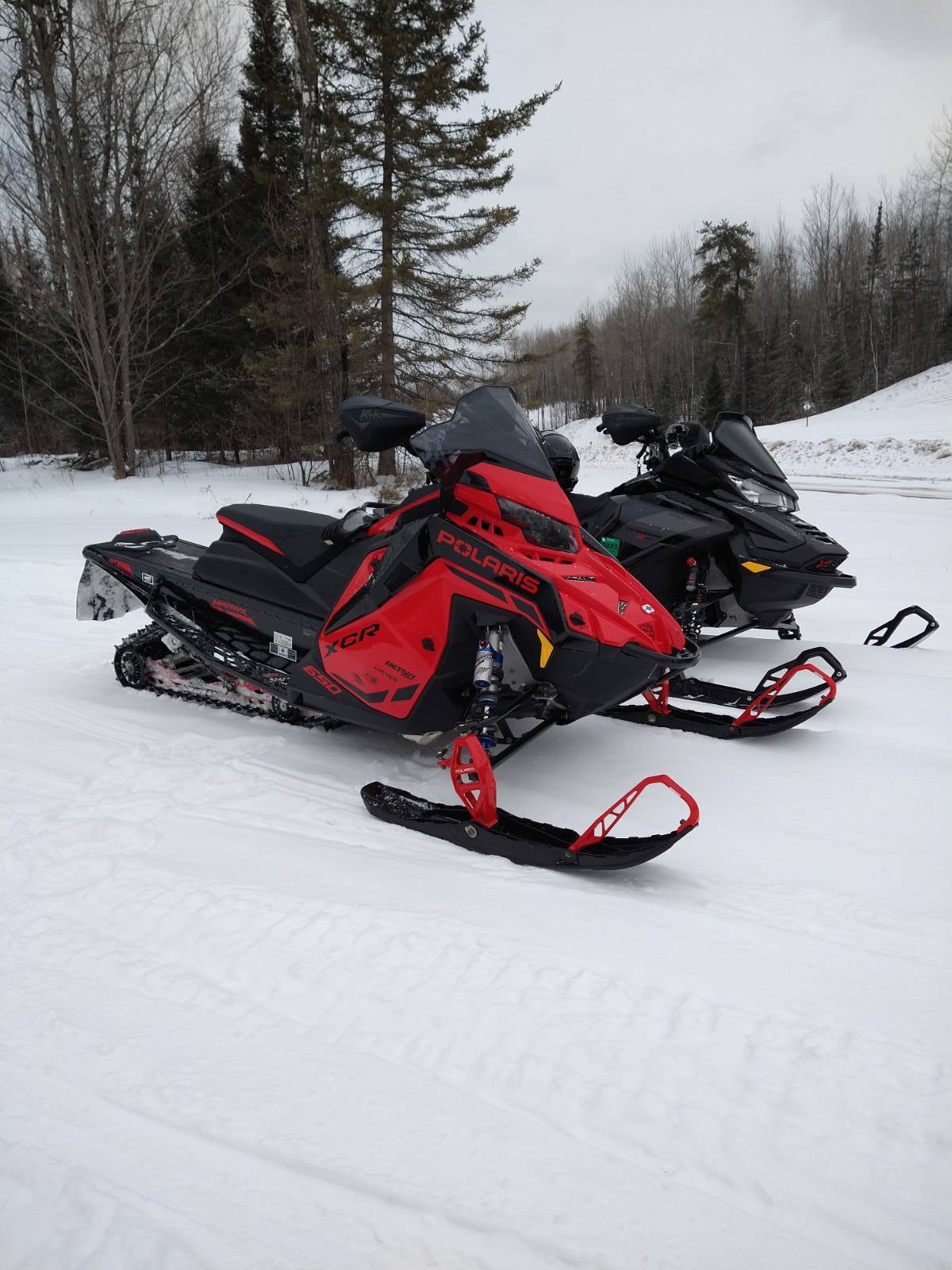

Have about 300 miles on my XCR 850 now.  Yesterday was the first good ride to feel the sled out with the guys ride.  Set the sled up similar to my VR1 with the spring pre-loads and put all the shock adjustments both hi and low setting to the middle of the adjustment.  I go about 250 fully geared up for riding.  I set the suspension so it does gently bottom on some of the larger bumps on the trail.  Right now I have it close to what I'm looking for which could be different for others.  All shock adjustments are set from knob set in closed position
Front ski High speed shock set on 4 low speed set on 4 springs have .812 preload
FTS High speed set at 4 low speed set at 5 spring has 1.25 preload
RTS High speed set at 1 low speed set at 5 stock torsion springs set at medium.
Coupler blocks in high position to couple the suspension the soonest
I did have the RTS shock set on 3 for low speed on the last ride so I'm trying it at 1 for next weekend.  If that don't work I'll move the torsion spring up to high and back the shock down.
