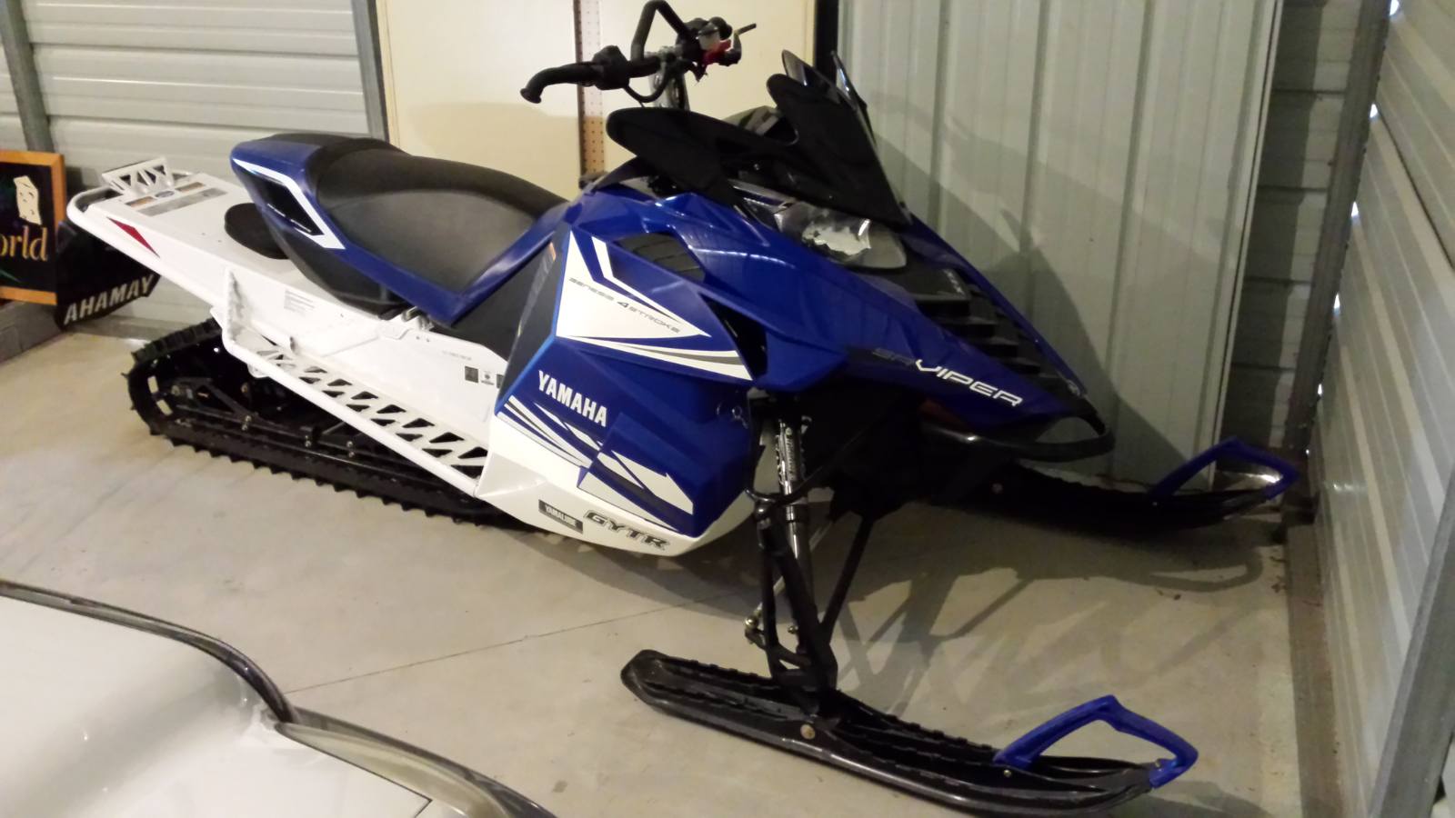

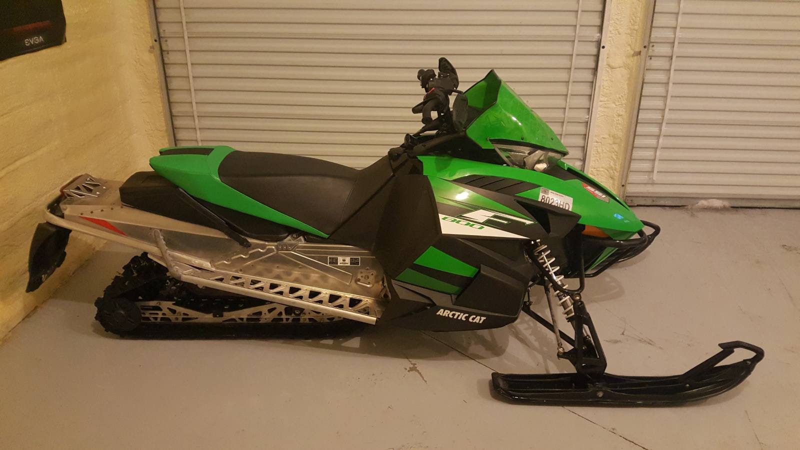

Interesting, I've known many people with ProCross sleds over the years, Cat and Yamaha, owned a 12 F800 and 14 Viper XTX myself, put good miles on both, never had either get hot. Don't know anyone that overheated outside of a higly modified F1100 Turbo. The 160HP Zuke 800 is a motor ive put 7K miles on between two sleds, a 2010 F8 and 2012 F800, never had any type of temp issue or know anybody that did.

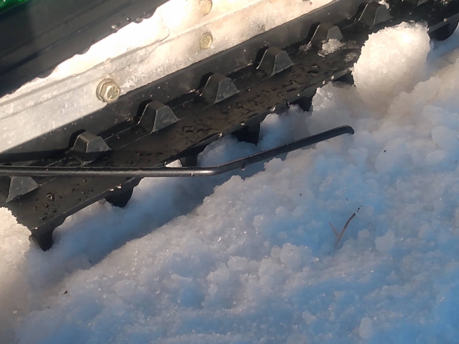

On my buddies Polaris Voyageur 600 it was as simple as the snow flap. In good conditions his would get warm and he'd have to stop. One day he was riding along side if me and I noticed the snow was going under the flap. Apparently he backed into a hard snow chunk and it bent forward. We tied it slightly back with a nylon strap and he doesn't have issues anymore.

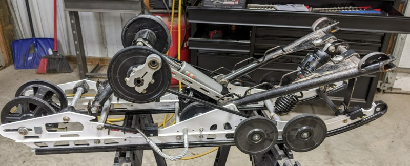

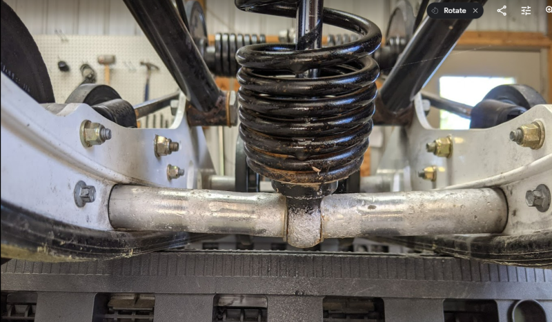

Between the lines designs brackets and duraflex cables. Moving them farther forward made a huge difference. You can see in the pic the original hole i used and how much further forward they are now
Do you need to drill the idler wheel holes in the rail larger?
Spent the afternoon on one of the 19s running a solid 140-155 today.
Tomorrow one of the 14's comes out to be a degenerate on.  Seems like those stay cooler in low snow conditions.
No. The bolts are the same. I use the bracket while bolting the scratcher to the rail. Works great!

Yes you have to drill the hole out bigger for the cable mount, the holder bracket you don't need to

I've seen scratchers on every make of sled and I'm pretty sure some people run them all the time regardless of conditions.  Did you ever think that the PC you ride with didn't cool as well as you because it had cable scratchers that don't work as well as your wire scratchers?
couple things which were problems... he purchased and mounted the cable scratchers himself (without experience) and he mounted them too high on the rail.  basically, they're curb feelers if you're old enough to know what those were.  yesterday in good snow conditions I ran the 720 which I almost always have the scratchers down on (because I refuse to jeopardize that engine) and was running around 100 degrees consistently.  brothers RXC was running in the 120-130 range.  as a test, on a section I knew there was good snow I lifted the scratchers on the 720 and was running in the low 130's within a couple miles, and the scratchers went right back down.   so... on his RXC I'm removing the curb feelers and installing either wire Cat scratchers which I know work very well or the Doo wire scratchers.  if we use the Cat one's he's just going to always remember not to back up with them deployed, or the Doo ones can be used in reverse.
the Cat coat hangers throw up a ton of snow and ice. ;)
I always feel guilty riding ahead of someone when my scratchers are down, because I know how much crap they throw everywhere.
