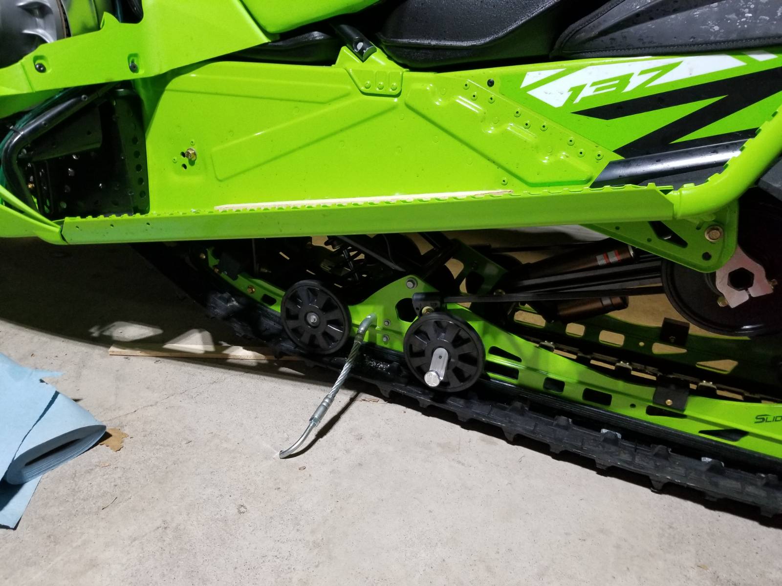

Those tunnel flares might be an option for me during summer maintenance this year, we’ll see.  Not sure how much they’d help on the longer tunnel, if it’s the same part# for the shorter tunnel.
those coat hangars kick up so much crap that chunks of it often hits me in the back of the helmet.  brother claims it looks like a snow tornado behind me.  :)
1 hour ago, p51mstg said:
I always feel guilty riding ahead of someone when my scratchers are down, because I know how much crap they throw everywhere.
They work great on the 129 and 137. No issues. No more chunks.

Yeah, I think the cat scratcher's work the best.  If you just put them down once you're on the trail, you shouldn't even need to use reverse for it to be an issue.
I have a set of new cat scratchers if you're looking to buy.
I got these from DK and they seem to work fine.

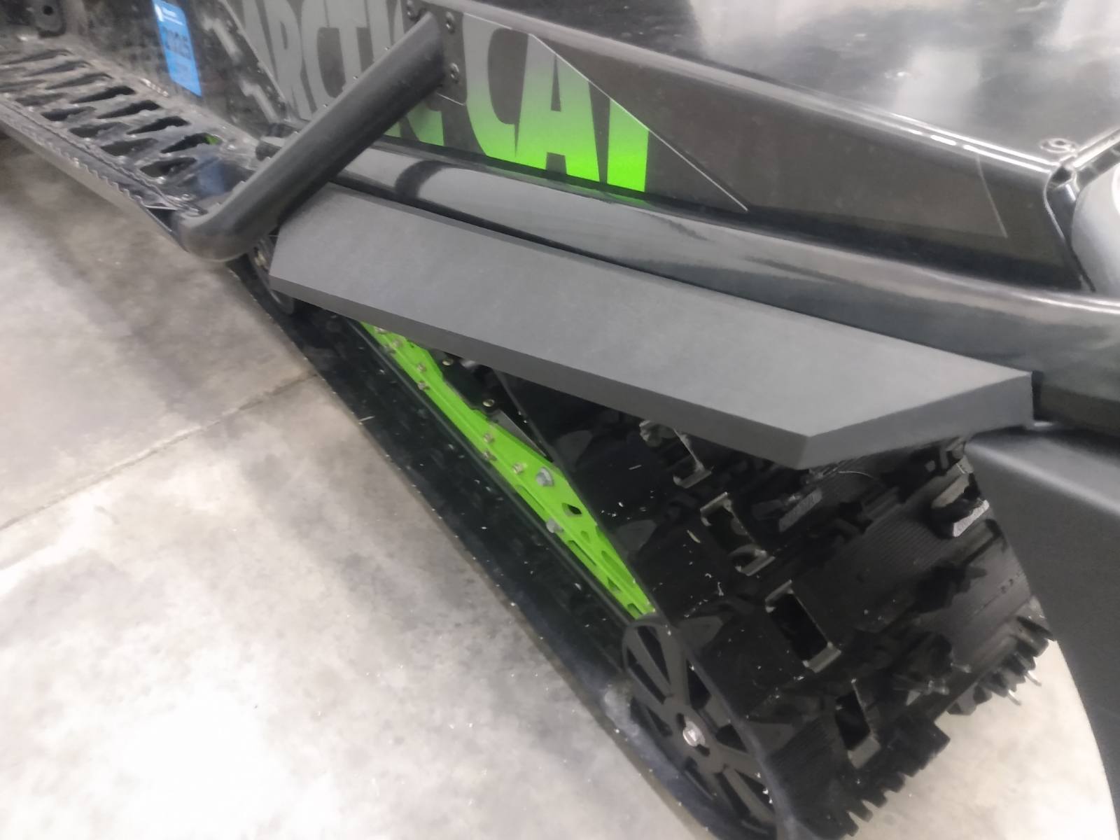

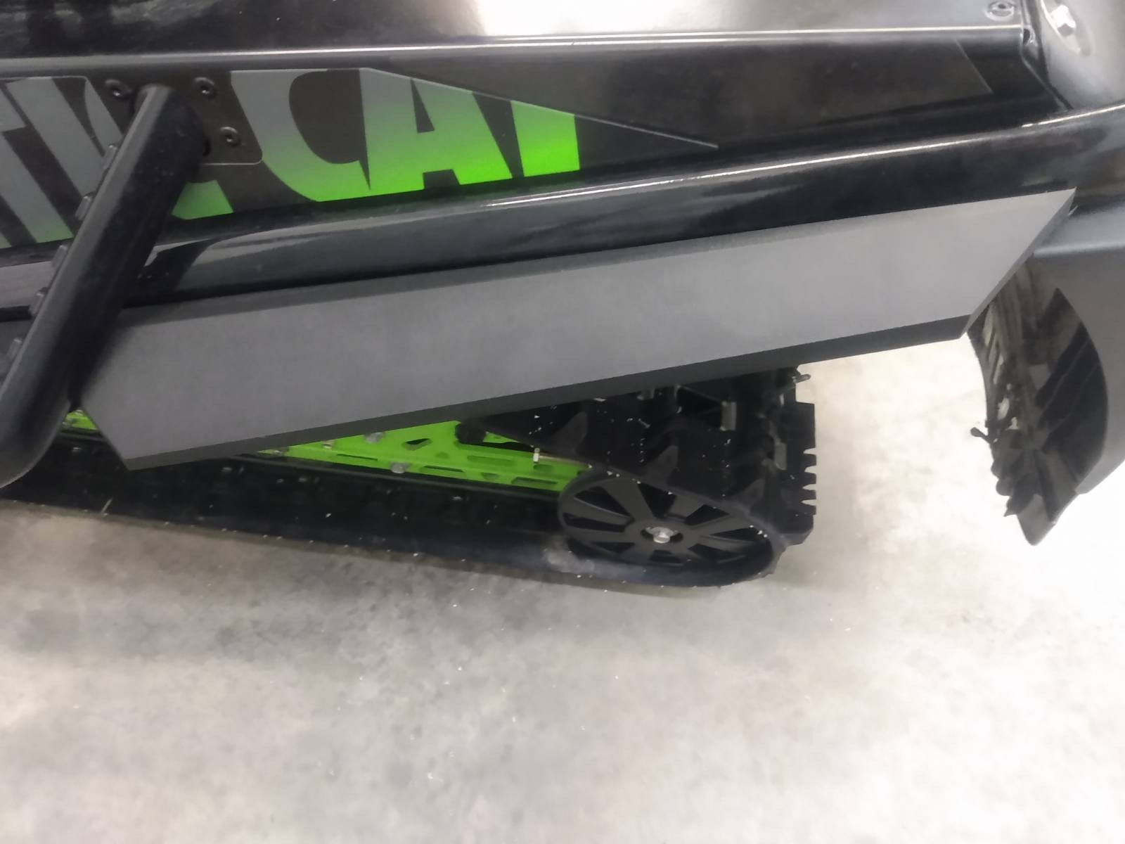

Tunnel flares help a little bit.  The stock flares are a one size fits all and don't go back to the flap on 137 sleds.  I make my own flares out of 1/8" polycarbonate.  It's way cheaper than stock flares and I can make them fit each sled.

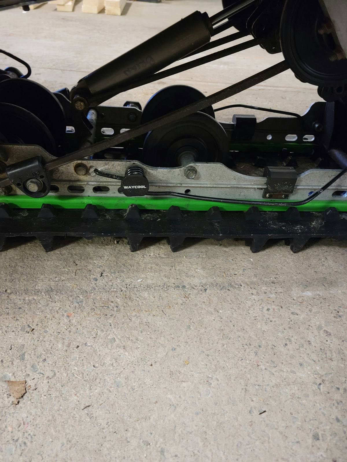

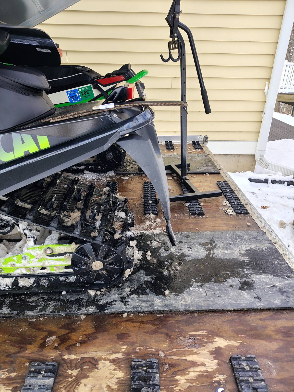

Here is my setup. Had to remove the inner idlers to install, then put them back on. Clean look and the hook protects the idler wheel

22 hours ago, Cat45 said:
Yes you have to drill the hole out bigger for the cable mount, the holder bracket you don't need to
Grrr, I hate drilling rails.
At least it is a clean look.
I hear ya, it's been awhile but I think it's a 3/8 hole, factory hardware is 1/4" or so. Atleast on the rr, your rxc might have beefier bolts. I'm a big guy and ride pretty hard still and didn't have any cracking issues from the bigger holes.
You are not going to crack a rail. I have done it to 5 sleds. Zero issues!

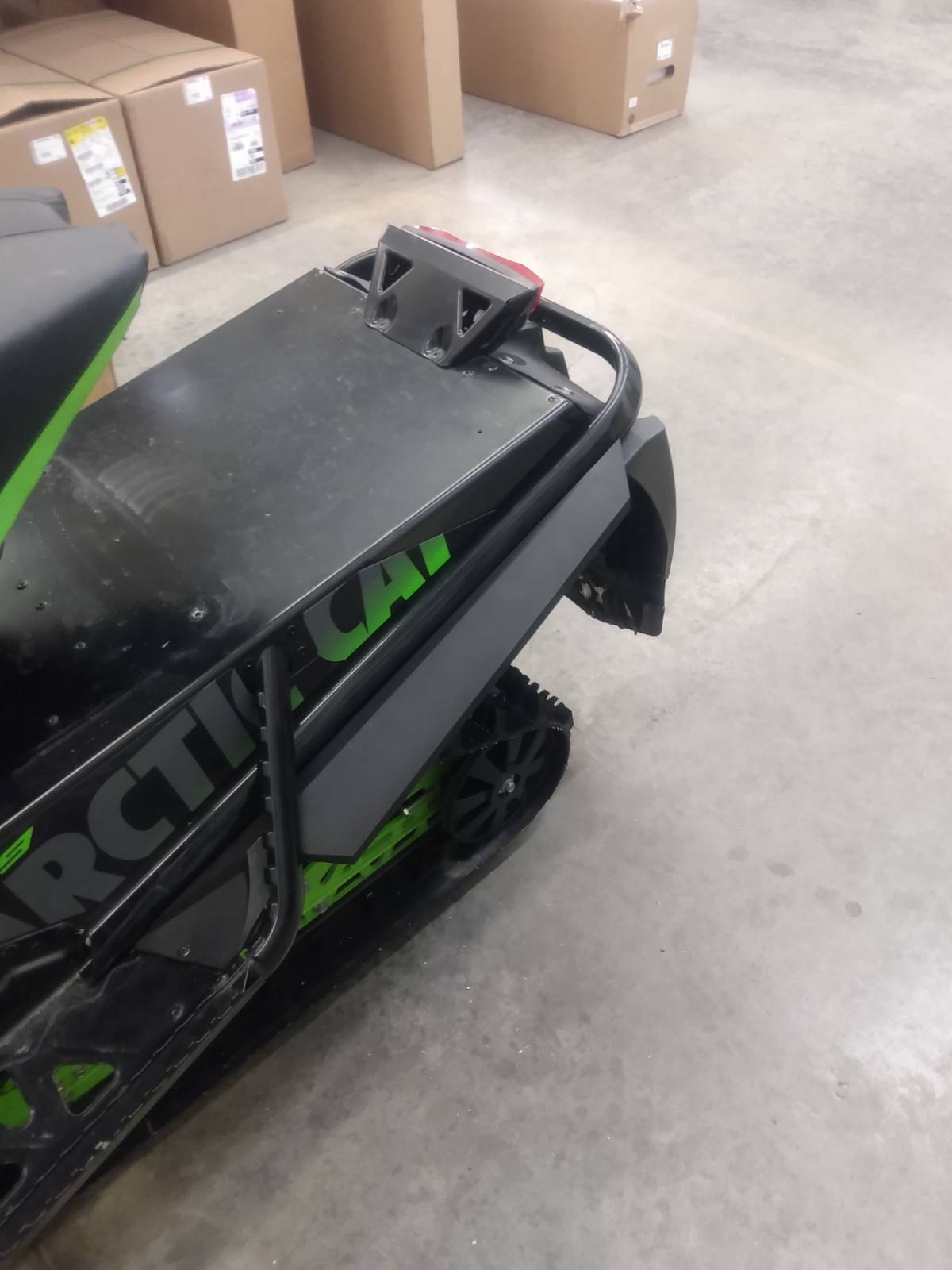

from what I saw, and in my opinion in stock form it's biggest variable kept coming down to the height of the snow flap, as his scratchers weren't doing anything because of the height he mounted them.  good intentions, improper execution.  ;)
Found one of my flap extensions back.  Might throw it back on a sled.

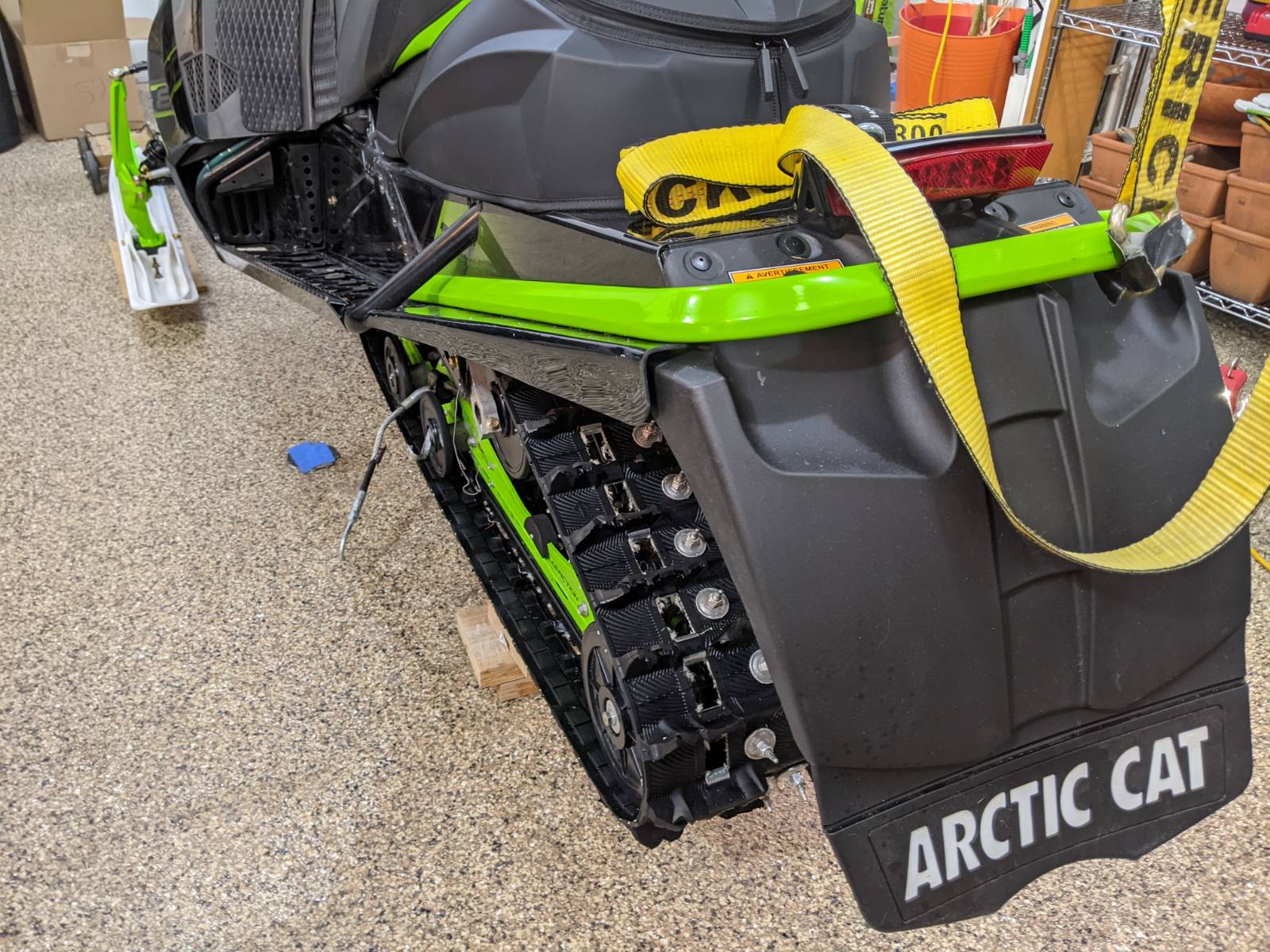

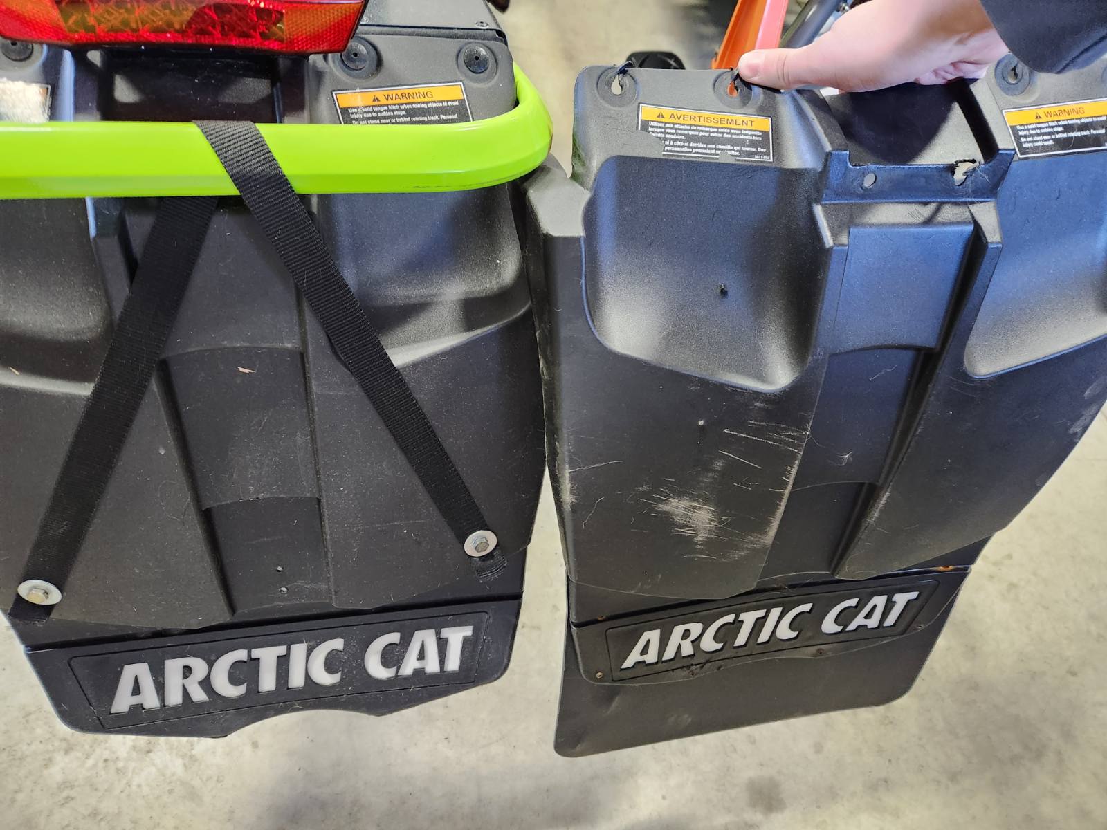

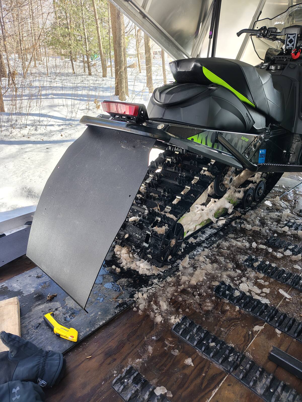

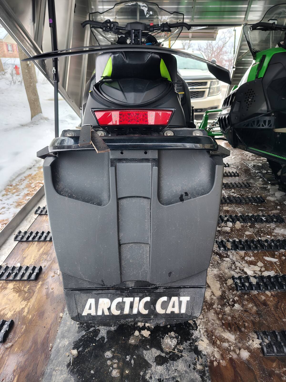

Since it's already chewed up on the bottom from being backed over by the studs... I just sent my brother the part numbers to order the SX flap, reinforcement and straps to try next winter if we actually get snow to ride on.
  9_9
  • 11 months later...

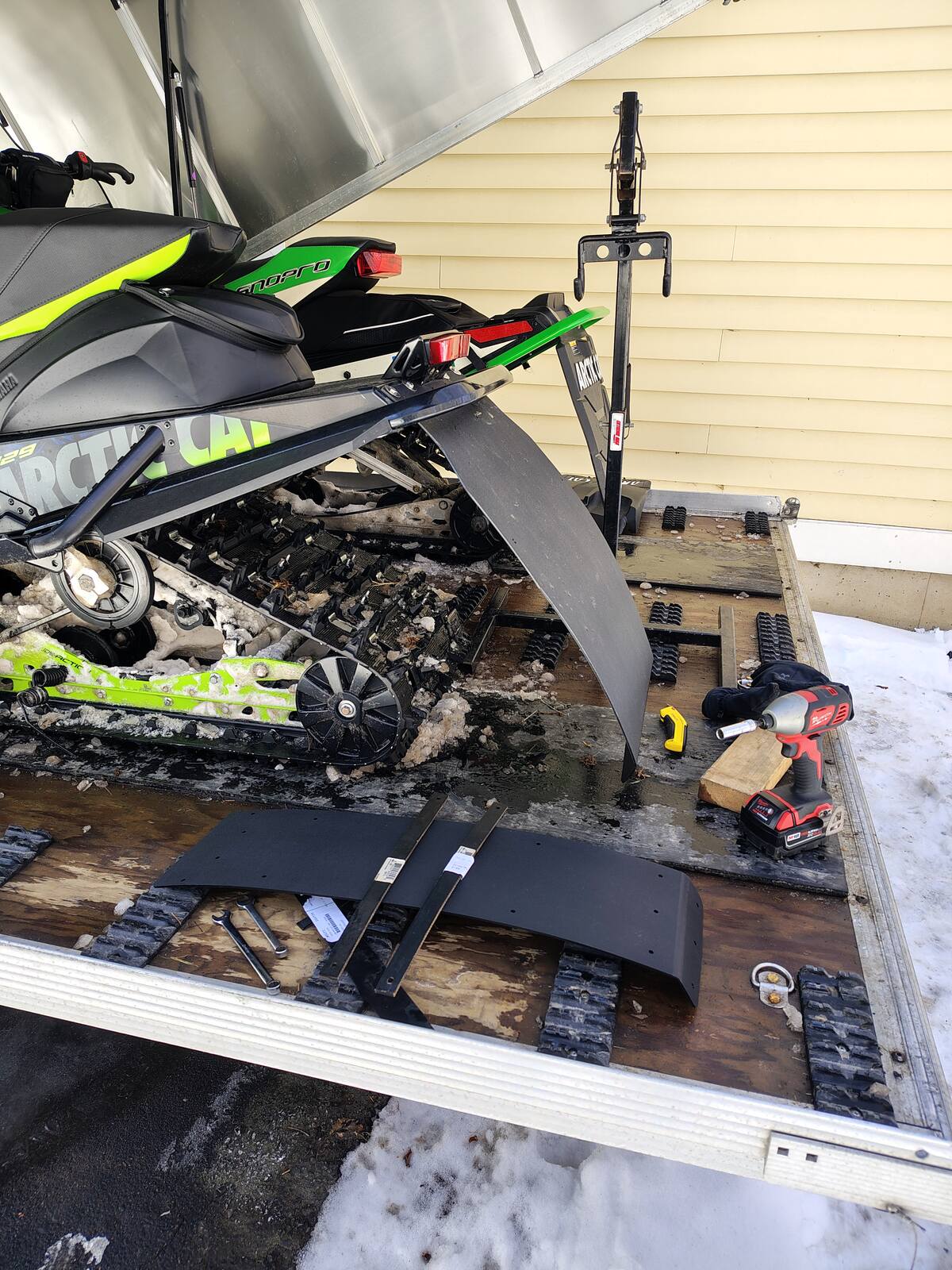

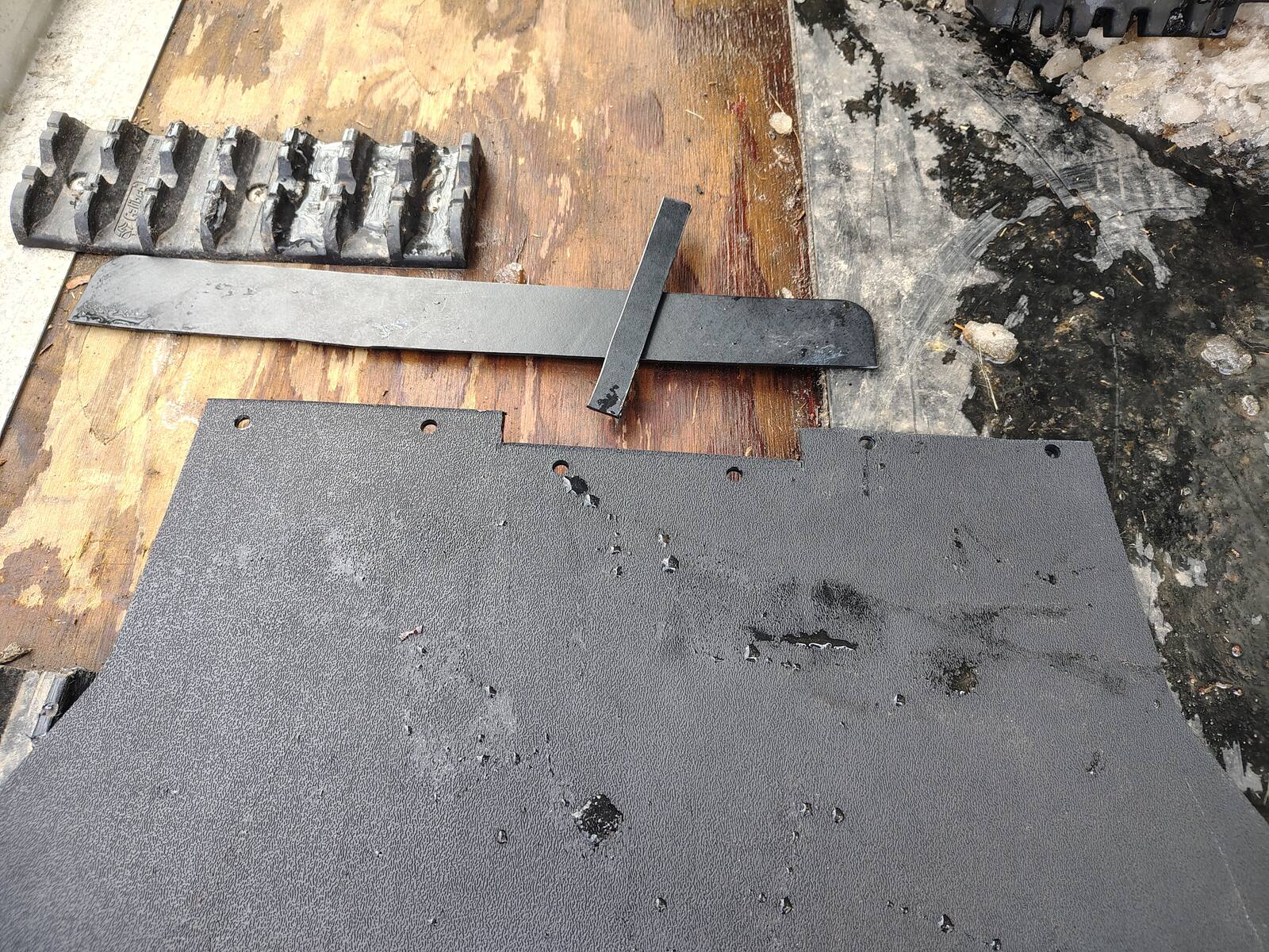

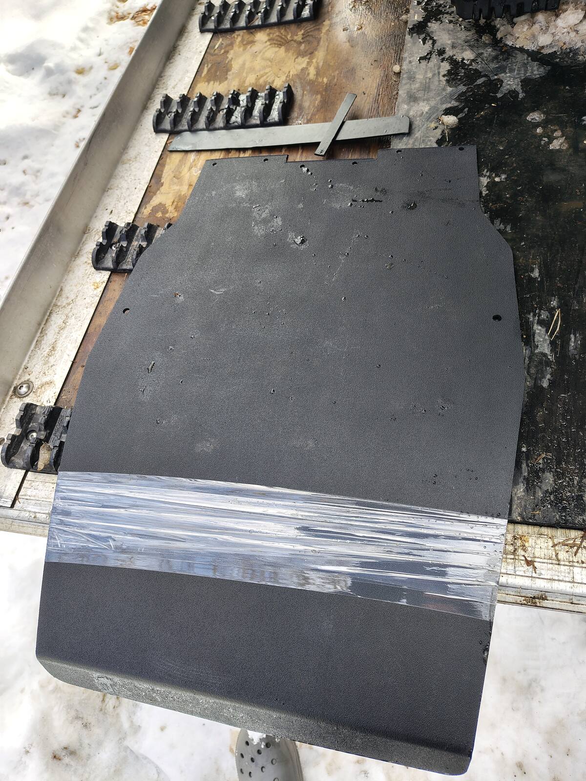

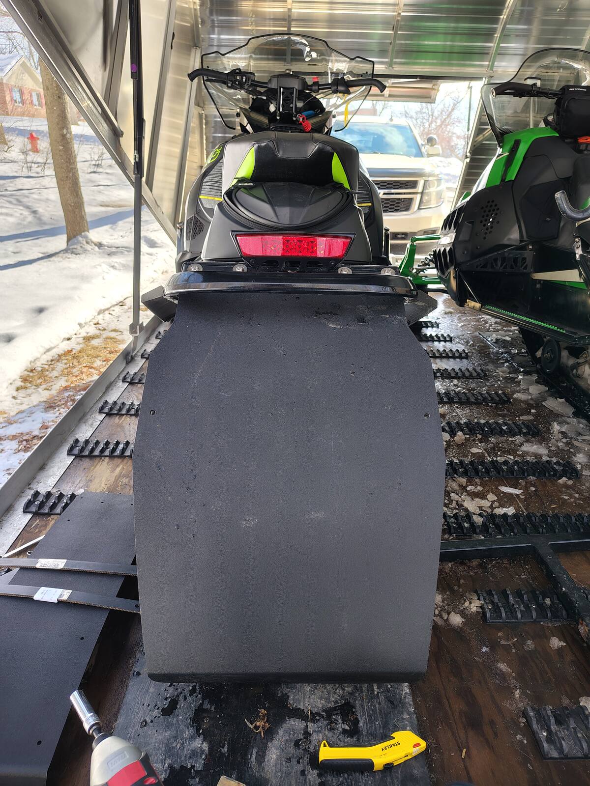

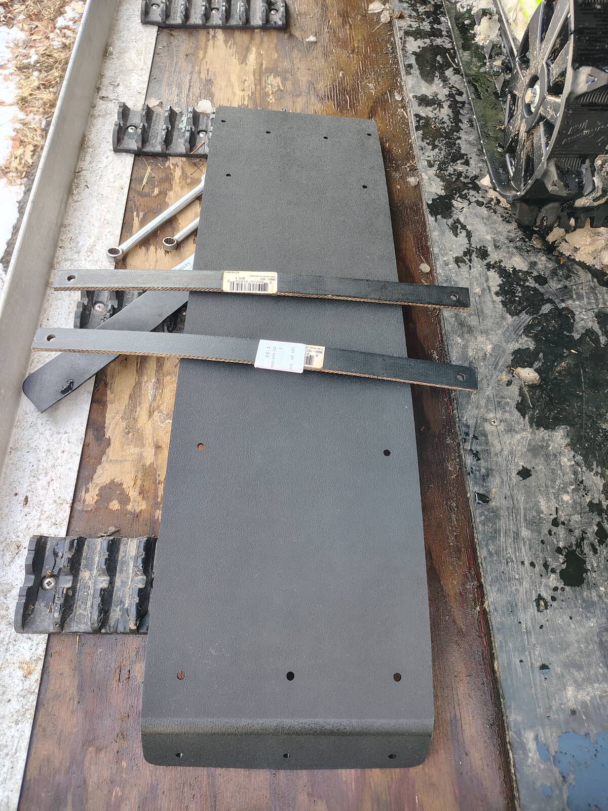

finally made time to do some minor surgery on the SX flap and fit it to test before attaching the straps and maybe the backer.
probably going to run over it a few times in reverse but someone had to be the guinea pig.
Tell ya one thing the ProCross is prone to .... idiocy in the early designs for getting the hood off of it! Holy shit - what a moronic design & thank God they got things figured out with the newer models. We had one of our club members riding a XF600 (year, I dont know ... but I know it's not current by any means), and she pulled over to the side of the trail yesterday with issue. Had her start her sled & we could tell it was running on one cylinder. To get to the plugs ... even her diehard dad and a few other Cat guys were like, "Ugh - we gotta get this f'ing hood off now" and knew what a shit show it would be. Thankfully it was in 30 degree temps and not colder than hell on the side of the trail. Ended up likely being an injector and a tow back to the roadside.
My buddy (Dad in this situation / diehard Cat guy for 50 years) laughed and said, "Can't even blame this on Textron!" lol
