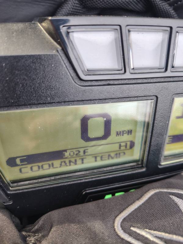

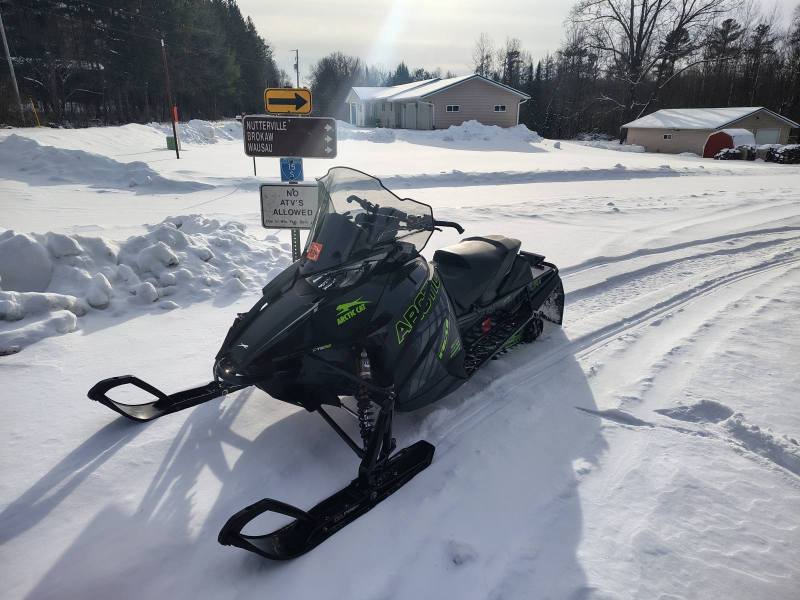

First two rides on a new to me 2018 ZR8000.  137'' studded down the middle, 2200 miles.  About 15 degree weather both today and yesterday.  Maybe three inches of hardpack on most of the trails.  Struggled yesterday keeping temps below 150.  When I got home I raised the front end about two feet up, warmed up well and added about two cups coolant, thinking air pocket.  Went out again today and same thing.  Unless I dipped into powder frequently, and I mean nearly constant, temps would rise to 160+.  A blast into some powder and temps would drop 25+ which suggests the heat exchangers are functioning well, just no snow getting to them.  Are scratchers a must on these machines?  Any other insight would be helpful.  For reference sake my two kids on Sabercat 500's had no issues, nor did anyone else in my group.

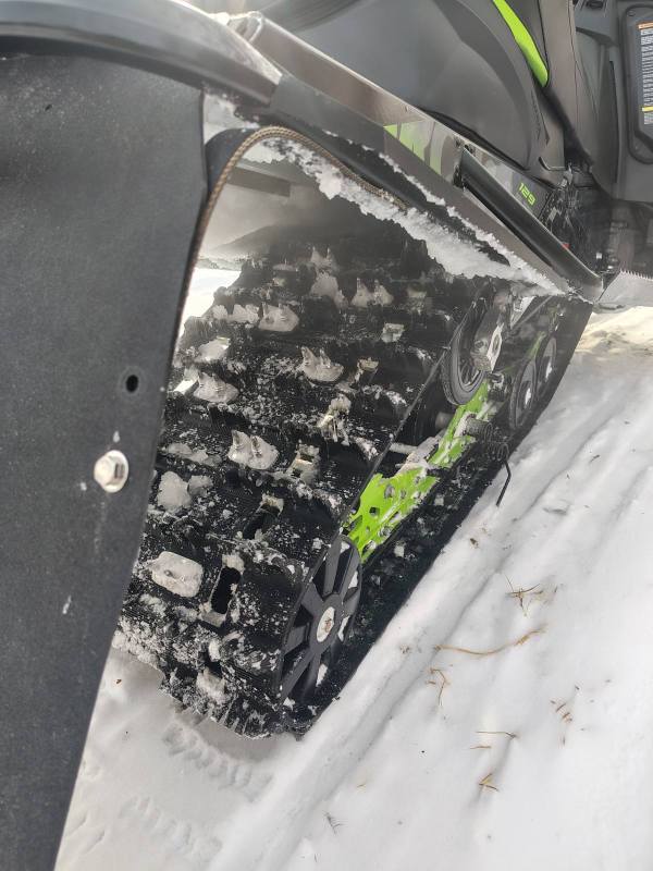

I've had two Procross 800s and they both were prone to overheating.  My '14 Suzuki and '20 Ctec are both finicky with temps so I put scratchers on them.  Scratchers really do help and have given me peace of mind.  Although I still find myself fixated on the damn temp gauge.  A friend of mine who owns a sled dealer/shop has said for years that manufacturers have built bigger engines but haven't enlarged the heat exchangers to keep up.  I don't know if he's right or not, but that's been my experience.
I know it sucks, but get some scratchers and then you don't have to worry about it.

Thanks for the reply.  Todays ride was not enjoyable.  After 16 years and 10000 plus miles on the F7 it was a bit disappointing.  Can you give me some idea what temps you see with the scratchers, and what brand do you use?

I’ve used scratcher for years but, I tested my last SX with a be without just to see.  I quickly ran 160 degree without them.  Dropped the duraflexes down and temps plummeted to 130 almost immediately.  That’s with a 1.75 track and only 4 gallon coolant capacity.  I don’t plan on running scratchers on my current 1.25.  We’ll see.

I've seen similar temps.  I have the cable type on my '20.  They are ok, but they have a memory and lose their down pressure.  My '14 had the spring type that worked great, but they aren't as durable and you need the kind you can back up with.  I broke a couple of those when forgetting about them while backing up.  Honestly, I hate scratchers and having to think about whether they're up or down or smacking against my rails or not.  But they work.  I currently run a '20 ZR8 with the 1.25 track, and I need them often.  If the snow is powdery though, you should be good to go without them.

I just ran my cables down all the time.  No reason to mess with them.  I’ll do the same if I have to go back to them again.  Never had any problem with them losing stiffness but you do have to make sure they are torqued good and don’t turn on you (oops).
Each of my riding buddies with newer Cats have installed scratchers for the exact reason you're experiencing @jdels.  If you don't have scratchers yet, I'd recommend getting a set installed sooner rather than later.  This warmer temps issue has plagued these sleds for several years, and each of them are running typical tracks (1.25") with studs down the middle.  It's amazing how quickly the temperatures will come down once the scratchers are in use.

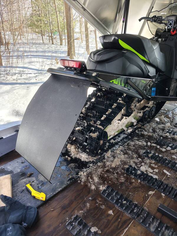

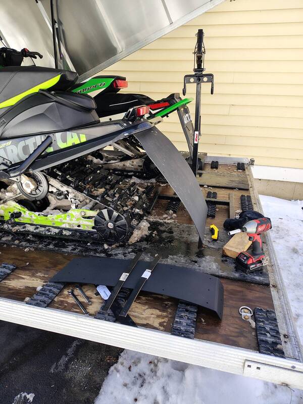

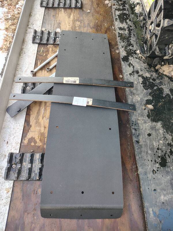

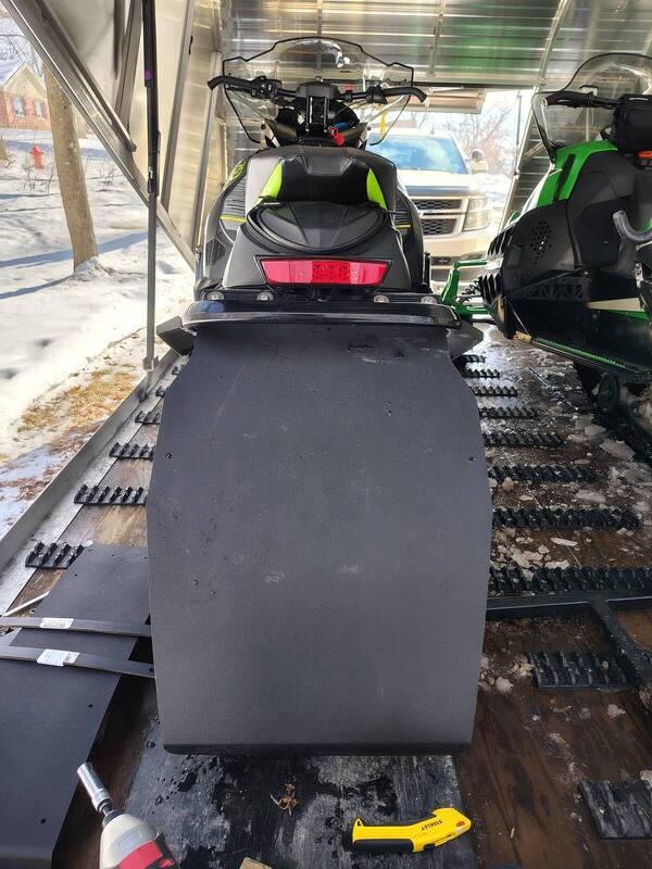

Spending a decade in a radiator shop that dealt with everything from lawnmower to locomotive cooling systems, not to mention racing and performance applications taught me a thing or two.  :)
My 2018 always seemed to run warm. I did put tunnel flares on it this year and that seemed to help. Only 90 miles so far but never went over 122. My former 2020 ran cool in all but pure ice. I would drop my scratchers and it would take it down in minutes to 98-110. Waiting patiently for my 2022 6000 RR to show up at my dealer. Supposedly next week.
22 minutes ago, Crnr2Crnr said:
They list the wp driven shaft, impeller and housing as the same from 2014 to current for 600&800.  There are revised part numbers for the water pump cover and shaft but not the impeller.  Uncertain why but my theory is if the pump was spinning too fast or the cover allowing too much flow the coolant doesn't stay in the cooling loop long enough to properly cool which elevates temps.  The inverse can also occur if the pump and flow is insufficient and the coolant stays on the engine side too long.  Another trick one can do under specific circumstances is to drill a tiny 1/16 bleed hole in the thermostat to assist in low speed cooling.
