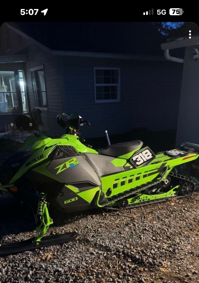

I mean, I guess it looks like any other RXC other then numbers and the mid-height windscreen.
I'm not posting too many photos to keep the owners out of this shitshow.
Do you guys have number plates or decals somewhere? I have Rox plates from my 17 but not 100% sure I wanna drill into the tunnel. I can get 1 rivet in them if I put them on the battery box or whatever you wanna call the back plastic behind the tank.
Number plate riveted to the tunnel.
