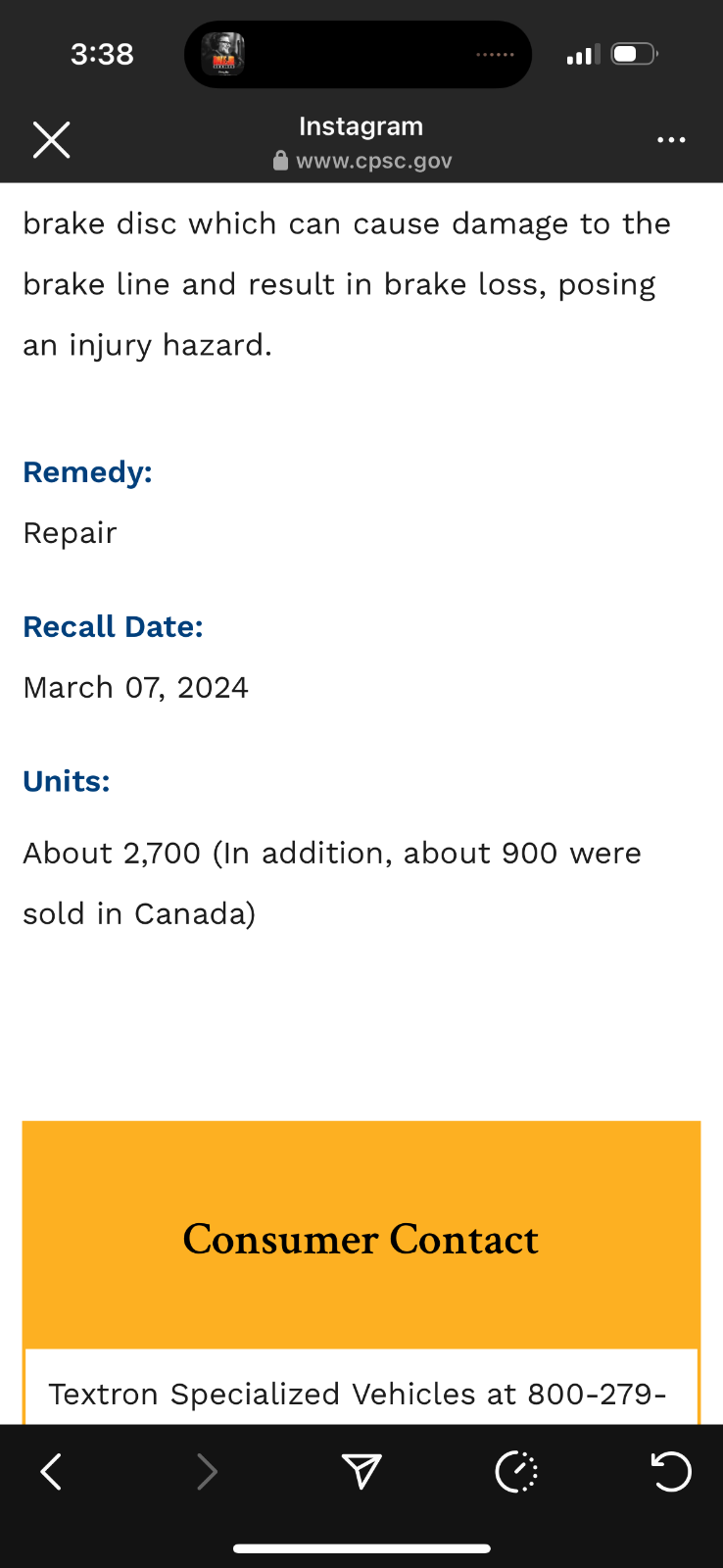

I forget who doubted what I said when I passed on the info that Cat needs to sell 2.5X what they sold this year to be profitable. Take a gander at how many total catalysts were built for 24 👀
That is nothing.  No way that is profitable.  Ouch.
good thing they were all sold out in March... 9_9
That was me.
But hey, according to someone they sold out almost day 1. That must mean something. LMAO
The 858 coming out the door is already behind the 850 Doo Turbo and Poo 850 Turbo and 900r. Cat is already starting from behind the 8 ball. Also consider that Doo and Poo are already developing replacements. This is going to be a tough haul for Cat in my opinion.
