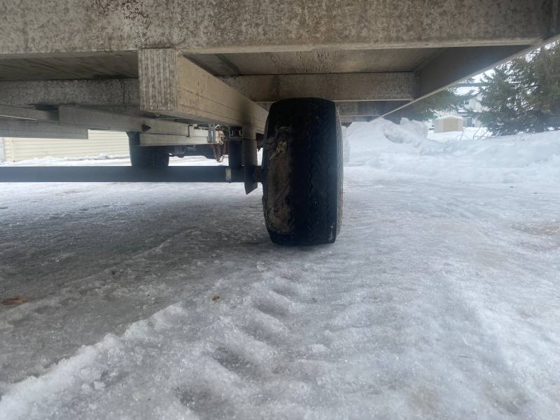

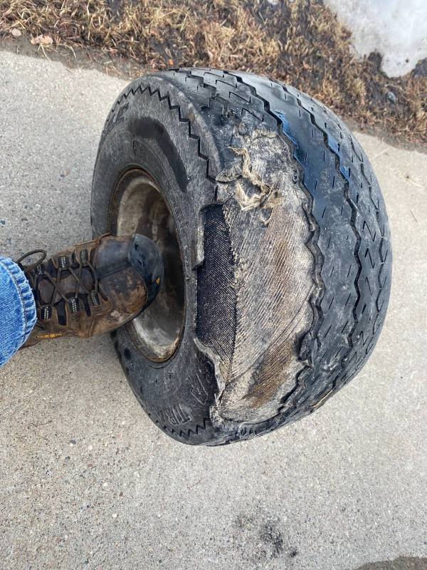

Check those trailer tires
Must have happened on the way home last trip, because this one came out of the garage like this… still held air!

  • Check the hub bearings
The tire and underside could use some tlc.
?  Did you hit a pothole + bend something?
It's amazing how little maintenance people do to their trailers.  Check tire pressure and grease the bearings at the minimum.  Also, check for corrosion and axle/frame damage due to road salt.
let me make this corrosion comment more clear... take a full aluminum can of soda, place it in a plastic bucket.  fill the bucket with salty snow from alongside the road.  leave it in your house or garage until the snow is melted.  remove the aluminum can.  it will likely have tiny pin holes in the can and have leaked the contents out of itself.
Both hubs were replaced two summers ago - this is/was a tire issue.  Yes the trailer needs a bath but the tire simply came apart from running over something or age.
Two yrs ago and you didn’t check the hubs before the season?
Yes the hubs were checked before the season…
I HATE those little tires.
Glad you caught it and it didn't let go while you were on the road.  New tire(s) and you're back in business.
Wasn't there and issue with the I think it was Carlisle branded tires and someone selling knock off Carlisle tires or there was something about the tires delaminating from under inflation and over heating or the wrong class rating or dot rating???
How old are the tires?  Bias ply are usually only good for 5-6 years.
Maybe - I know these tires had a good 7-8 years on them.  Obviously due for replacement.
