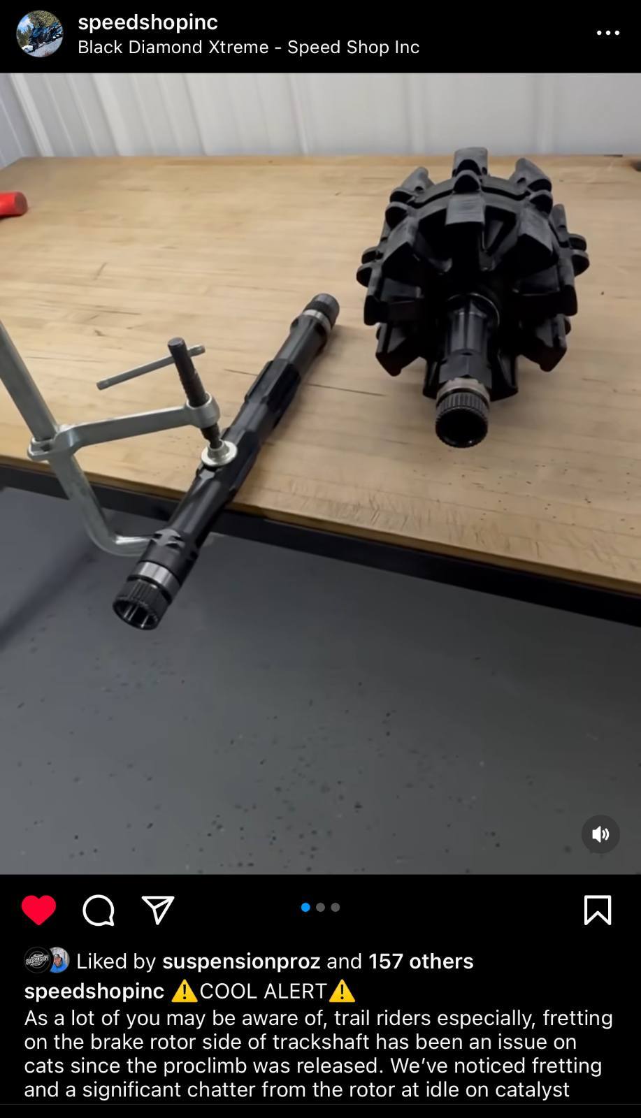

Dumbfounding that Cat did not address this :thumbsdown:
How do you get chatter from a brake rotor at idle?
As in loose tolerancing?
I get chatter (pulsing) on the scallops rotors out trail riding, but that is all I've really noticed.
From what I’ve seen on pretty much all cats is initial run after setup the rotor will rattle a little bit. Grab the brake a couple times and it seats on the shaft where it wants to be and its fine from then on
Maybe it is just an issue with all the 8000 and 9000 riders who never really use the brake since they ride at like 20mph anyway.
What's crazy to me is this isn't some magic fix for a poor design...it's literally just tighter tolerances and Cat apparently couldn't even pull that off???
I thought the brake rotor was supposed to have a little wiggle?  My understanding is that allows for a driveshaft that might not run true.
Whatever the reason, I think I've always had loose fitting rotors.  The clip doesn't clamp them in place.
Personally I don't care so much about the rotor... Its the inner race of the bearing wearing out the driveshaft.
BDX has new magic shaft that will fix the rotor/bearing issue. They started pimping it last week on social media. Looks like a better solution than the barn of shit contraptions
Pictures load that premium posted. Damn Canadian cell towers
I think a little green loctite on the shaft and should be good to go.
Yes, disassemble your brand new $20k sled to apply loctite to a critical component. It might work.:lol:
If it were that easy there are 2 scenarios:
Cat could do it (apply green loctite) at the factory and has elected not to....FAIL
Cat doesn't acknowledge the core problem at all due to cost/assembly logistics/etc....FAIL
