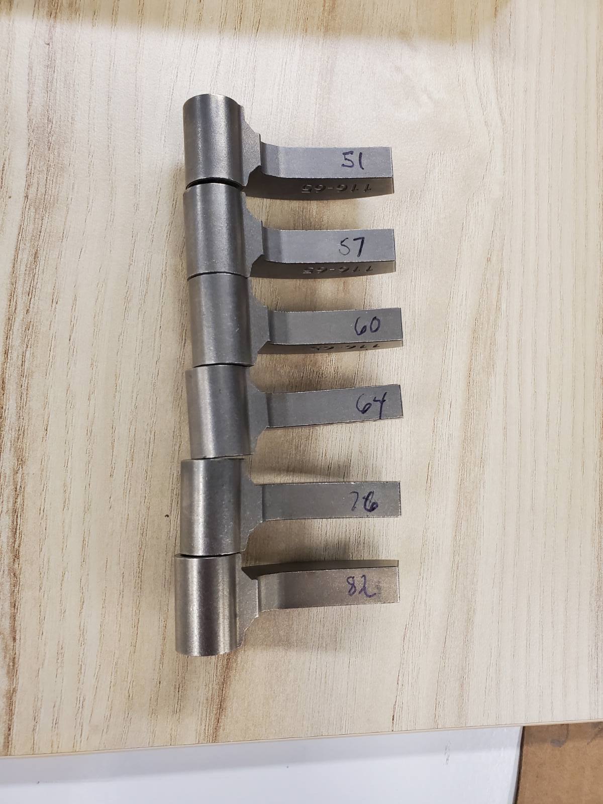

29 minutes ago, favoritos said:
Is that still running 66g
picture looks to be 65 grams
Add the weight of bushing.  It's a 66 in the pic.

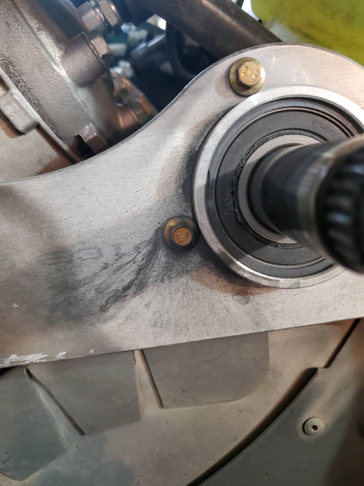

I found one bolt loose on the jackshaft end of the TCL.
That happened after initial break in miles.  I guess it's worth checking behind the primary too.

22 minutes ago, jonlafon1 said:
So your saying the weight is at least 66 grams with the bushing?
Deja vous all over again..
Though it came up already in this thread, but its come up hundreds of times so it may not have been this thread..
Textron in their infinite wisdom marks weighs with the last 3 digits of the pn, and the mass of the weight not including the bushing.
Everyplace else they label and mention it, the mass of the bushing is included.  So 66g weights are marked 65, 64g weights marked 63 etc.
The ADAPT weight numbers for reference are 1 gram over the number stamped on them.
It's a goofy way of doing the numbers, but that's what they use. Haven't weighed the bushings, but  I've weighed quite a few with bushings and the actual weight is just under the rated number.  I.E. 66 gram reference number actually weighs 65.70 grams.
Here are a couple sets of 116-65, (66g) weights with bushings.  I wrote the decimal point over 65 on each.

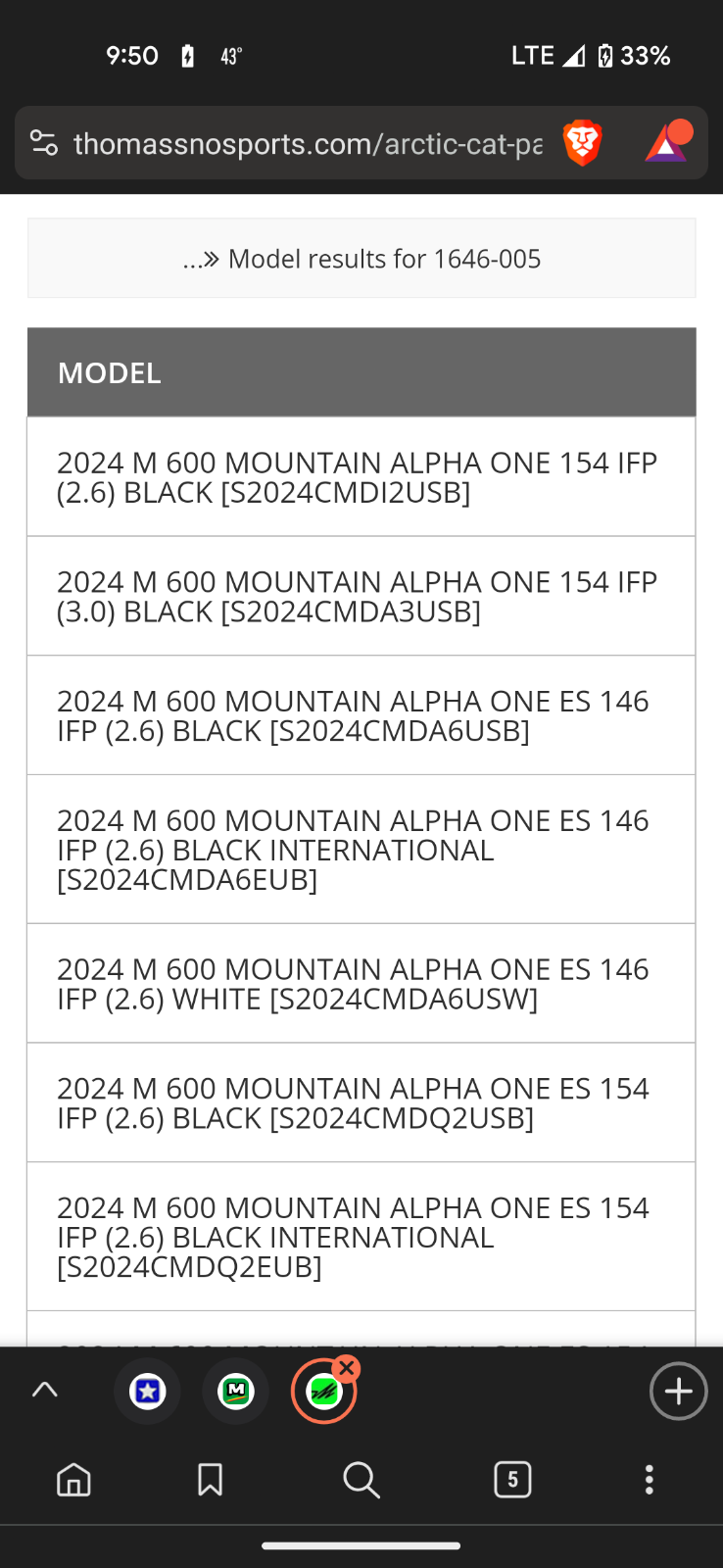

I found a Cat spring part number 1646-005 , listed as a 85/255 rate.
Had to order it non refundable.  It doesn't look like a normal stock item.
BTW, our little 65/255 spring is not available.  I'm a little curious to see what is replacing the thing.
That is the stock spring from a catalyst M 600
