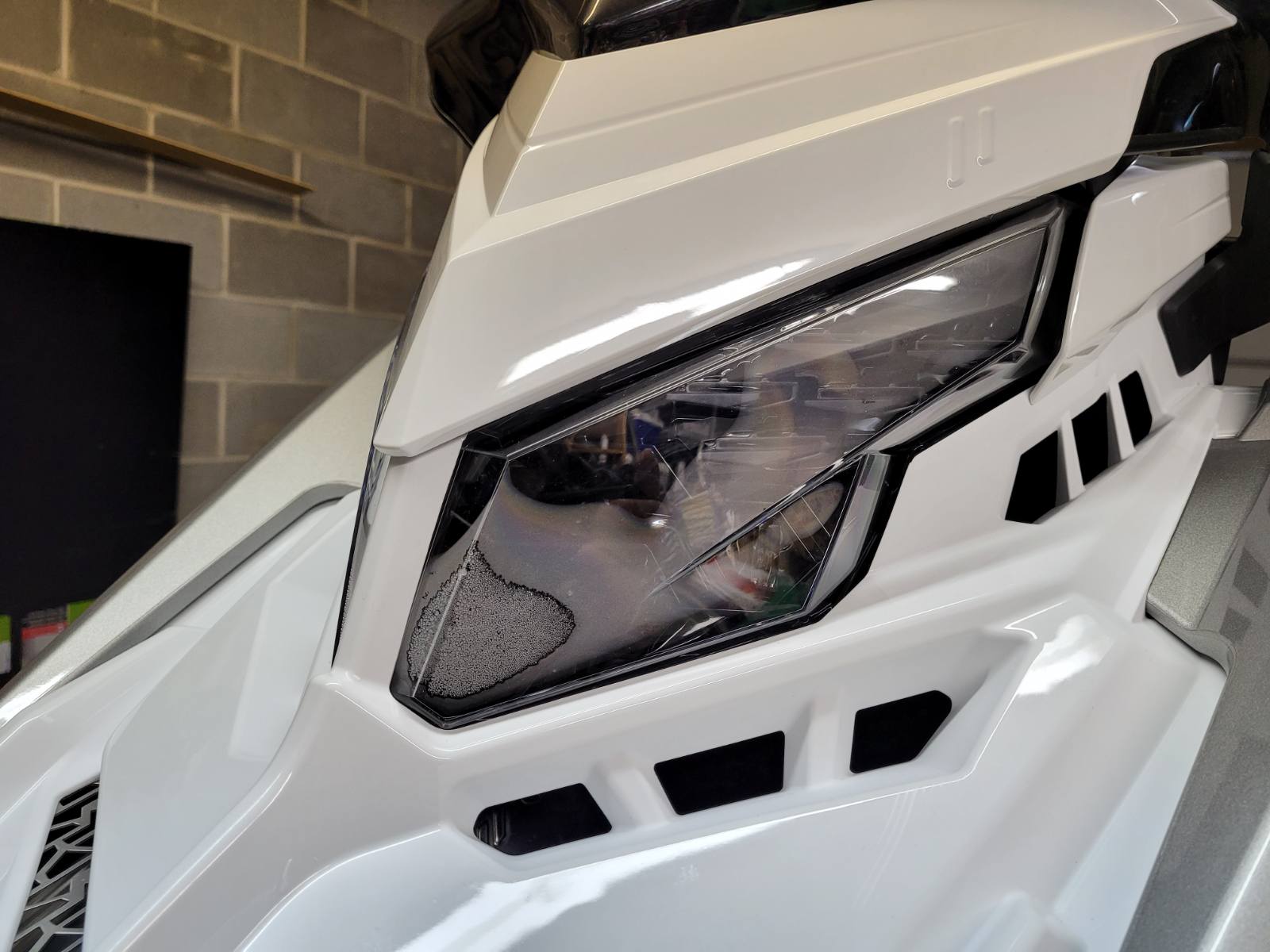

I've read a lot about the Night blade headlights. It seems that a lot of folks felt that it was a step down from the Axys. It certainly isn't as intense as Cat's LED headlight, but I really like it. The Cat LED headlight caused a ton of glare in heavy snow dust. The Night blade seems much better balanced.
Oh, and there's that whole headlight condensation thing.....
That headlight condensation has been a hot topic since last year, and supposedly the added venting for 2022 was put in place to address that.  Oops - not so much, from the looks of it!!  I'm assuming you were just running the stock 4" carbides for the shake down run?  That's what I plan on doing with mine (if it arrives) and conditions are so-so.  Surprisingly, those carbides hold their own if the conditions are decent.  Your comment about maybe needing a little more room with your bars ... give Pete a call to see if they can get you an Assault riser to replace the stock one.  I did that with my VR1 last season, to help make enough room for the handguards and a mid windshield.  Although I never got to ride my sled, sitting on it in the garage it felt noticeably better with that Assault riser installed.
As you get more seat time, and things dialed in, it'll be good to hear your full report (good and bad).  Although, don't get too giddy over that display ... some of the Cat faithful will tell you it's stupid, and that all you need is an analog setup :stirthepot:
Water Vapor will always be an issue with LED headlights, it should work its self out with some heat cycles.
We would see it all the time in aftermarket headlights in jeeps. people always wanting replacement.
https://www.jwspeaker.com/blog/headlight-condensation-3/
There was a trick get rid of the vapor, remove the membrane on the back and place by a heater for a night then replace the membrane, not that I would try that on your headlight but just something we would do for the cheaper procomp LED housings... not the J dubs in the above link.
There's the Polaris quality we've all come to expect.

I can’t remember which PC I had that the lights held moisture.  Think it was my 13.  It drove me nuts!
big issue with general motors as well, and they tell you it's normal. then i get them with 2 inches of water in them. not normal and does it pass inspection? newer pickup tail lights are 700.00 . moisture in them as well
water ingress is an issue, vapor is not.
Ive seen vapor in all brands, and not just LED projectors too.
If the dealer wont replace a light with water, they are dicks.
I say bring back the lights you can barely see.
Not only will he help with people see water vapor, cheaper replacements and probably slow every one down... Cant see 20ft in front of you or other peoples tail lights. WIN WIN :)
LOL, the demo we had last year did the same thing.  They need a PTFE membrane filter to allow the headlight assembly to breath and keep the moisture out.

I've never had an issue warranty replacing a procross headlight, for moisture.
only ever had 1 or 2 of the leds do it
Even my halogen stockers with led lamps does get condensation.  It's a symptom of low cost and low expectations.
It would be interesting to see what IP rating polaris has on their housing. I've had led's in a ton of hot air areas that have never had condensation but they were IP68 /67

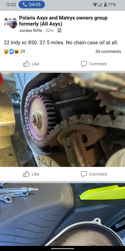

-Ahh...and she was about 4 OZ low on chain case fluid.
Most of the sled is setup perfect. But, I am finding a few items here and there that were missed on the pre-delivery inspection....all minor.
