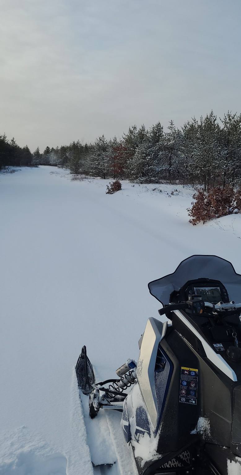

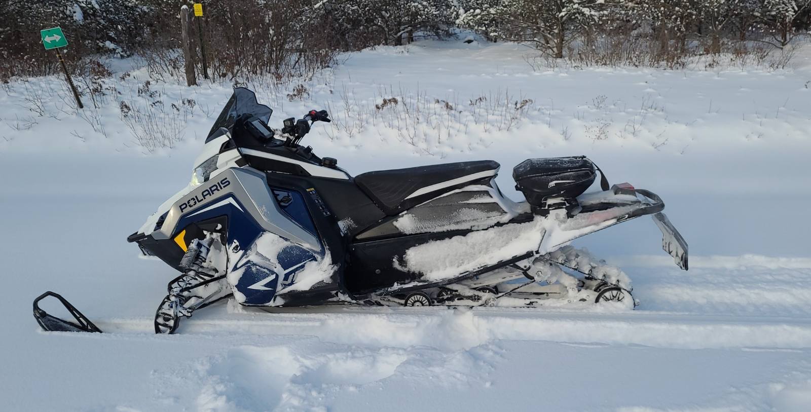

Crispy. Powdery...
That tiny seat give me a cold ass. I think I also need a grandpa windshield... .
Floats beautifully through the cold powder.
Between Barnes and Iron River. The deep powder is very spotty.
So far, I am liking this sled. It does have some quirks.....
