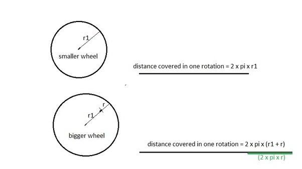

    Ok...since you dont understand the wheel or coin concept.....imagine 2 rubberbands....one being slightly larger in circular diameter than the other one.  Now use a sharpie and mark each band.

I have already explained it, linear vs rotational motion. Total diameter only matters when it's rotational motion.
10 minutes ago, motonoggin said:
No, it won't be correct, but that's because it's rotational motion, not linear.
And it's not a 'theory'. This is basic physics.
Calling it a theory is like saying the statement 'water is wet' is a theory
That's all fine, but a track isn't a wheel.

If we're talking overall track diameter, a longer track vs a taller lug would effect final drive, but it doesn't...
True, keep slaining. This is interesting
So why dosnt a taller lug change the diameter of a track? Not looking for anargument , just learning here.
It does change the diameter just like a longer track, but since the track isn't moving rotationally at the point of ground contact, it doesn't matter.

This was not the question in the OP.  He didn't ask about one full rotation of the track.  He asked about one full rotation of the input.
@motonoggin is correct.  Lug height is not what's important.  The track is being laid down and the bogies are rolling across it and slides are sliding across it.  Regardless of lug height, if the track driver pitch is exactly the same on a 1" lug or a 3" lug, the suspension will only roll one driver rotation-worth of track LENGTH.  Assuming no lug flex is present.
Put another way, if the circumference of the driver is 20 inches and there's a 4:1 reduction in the chaincase, one rotation of the jackshaft will result in 5 inches worth of track being laid down, regardless of the lug height.
