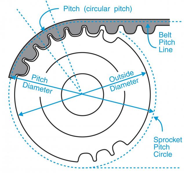

If you have a bull dozer and one track had 4" grousers and the other track had 1" grousers.  Assuming both sides had equal traction and no slippage, the dozer would go straight. The taller grouser would have no effect on the drive ratio.
4 minutes ago, Matt said:
Bingo.  Lug height doesn't matter in drive ratio.  It's like asking if putting a thicker (taller) chain on your bicycle changes the drive ratio.
The machine can only roll as far as the amount of track is laid down by a rotation of the driveshaft.  This is a constant.
Yep, length does not matter.   Pitch diameter of the drive sprocket/track is all that does.

No input for track length or lug height.  If it makes a difference find ONE online source saying it does.  JUST ONE.
http://www.racenssr.com/calc.htm
http://www.wahlracing.com/Gear-Ratio-Charts.html
https://www.hurricaneperformance.ca/gear-calculator/
