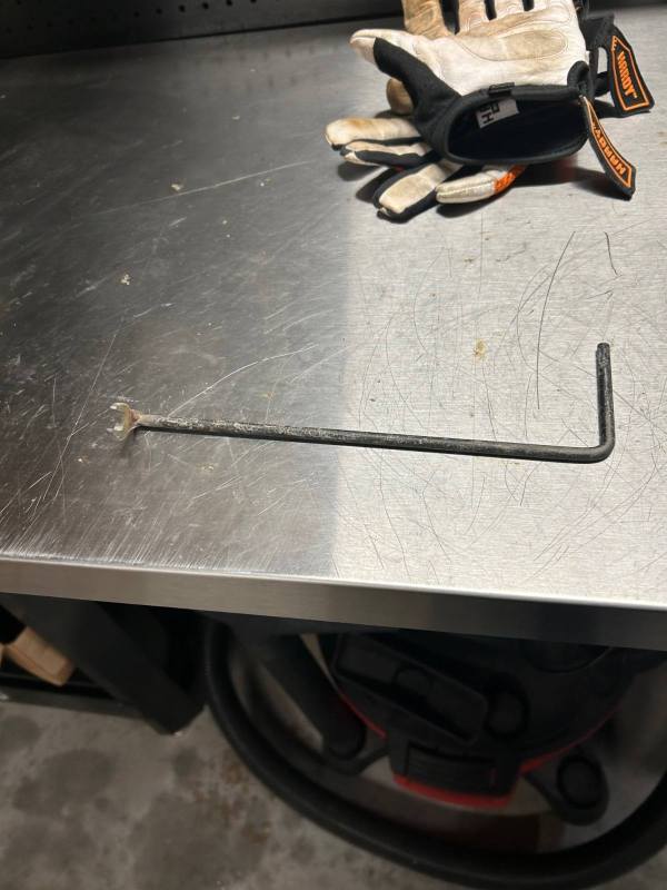

  • Not sure why I'm helping.. but you go at it from the exhaust side with a mirror to check. taking off the bottom pan won't do you any good there is no cable to adjust, its a rod between
there is no cable to adjust, its a rod between the pump and throttle bodies

And yes the lever will drop down when you unhook the rod.
