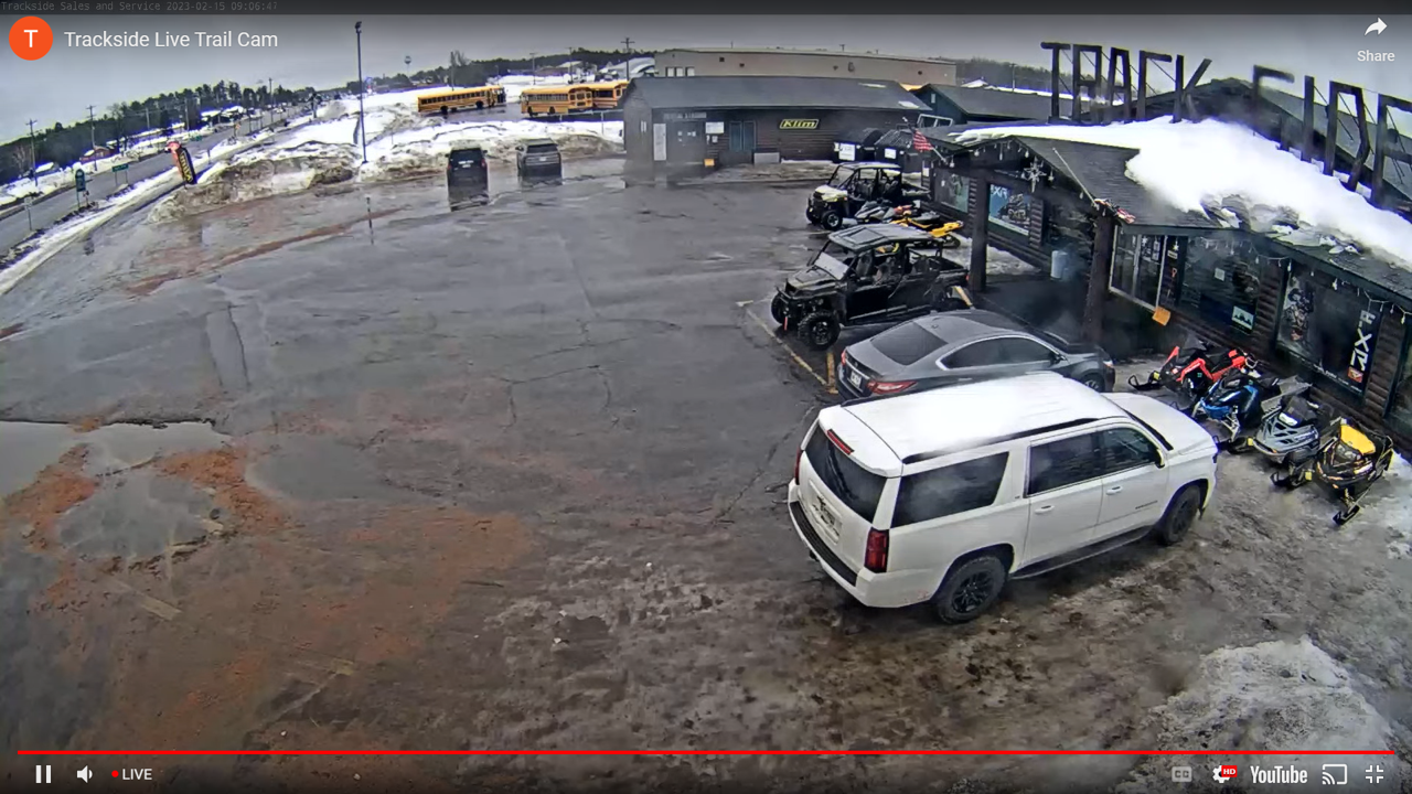

Trail through town looks sweet.  We were going to ride this weekend but not anymore.  What's left of the trails after melting and rain will now be solid ice.
