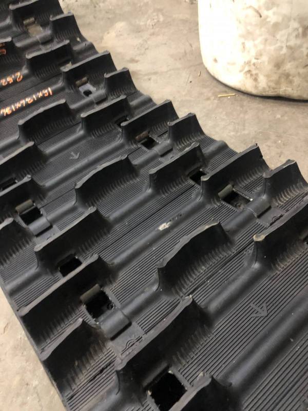

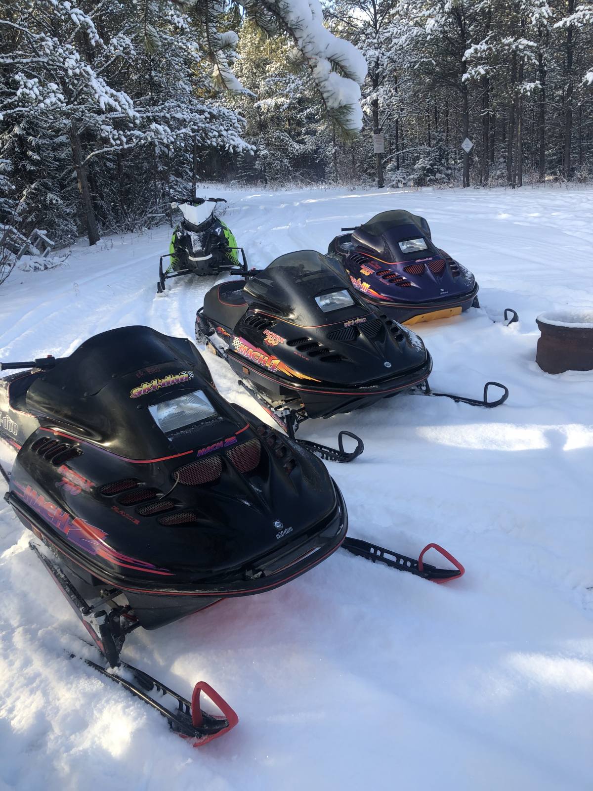

Went right through the gape and wail machine this winter. Rebuilt the skid, new chain case chain, replaced the wore round 1” full block junk track with a 1.75” cut down to 1.5, new drive axle bearings tbh
everyone is pretty Jealouse but if you have to ask you can’t afford it
just got back in from laying some gapes tonight tbh. She just friggin wails with the new track and geared down a bit

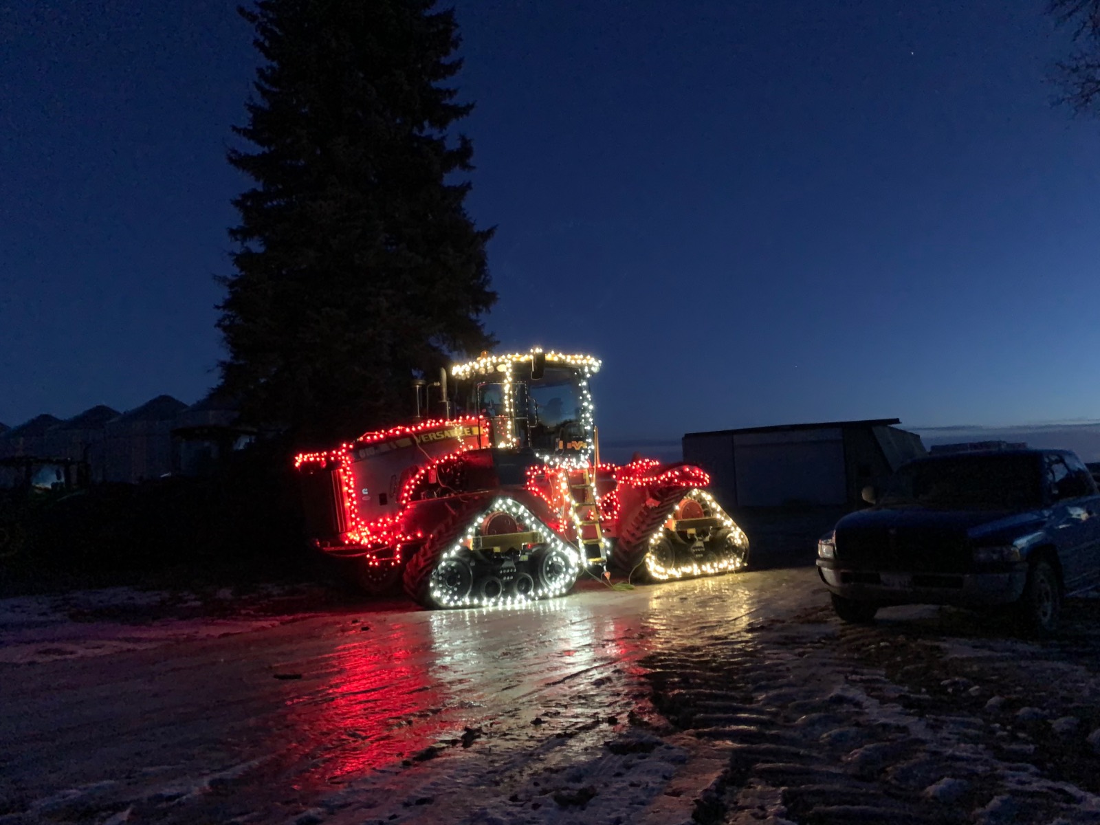

Need to get more clear lights to finish the grill bud turned out ok
Awesome!
Hell ya badass !
Do they stay lit when you drive?
More seriously, love it.  That's something worthy of outlining.

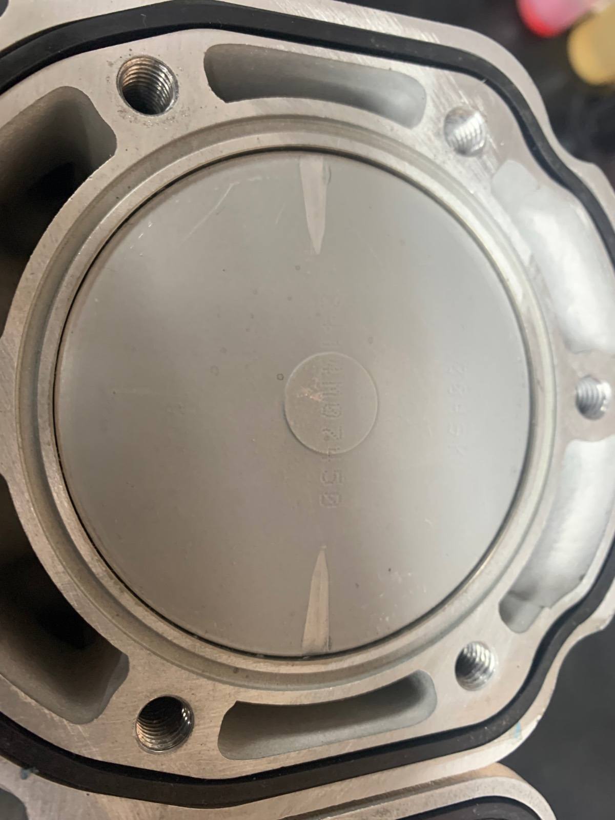

It has some kinda Kawasaki watercraft pistons in it so I’m not too keen on blowing it up getting that last 5 hp lol
76mm bore size you can use 583 pistons
That’s what I figured would be in there but they used some Kawasaki pistons for some reason
Interesting! I think the big bore Lemke motors used Cat pistons. When you peak inside, let me know the part number if you can. I’m always looking for options. I have an old Union Bay motor (928) with RMK pistons in it but it’s a 71mm stroke
I will but I hope I don’t have to lol
I hope you don’t have to either but if you ever put a bore scope down in there :bc:

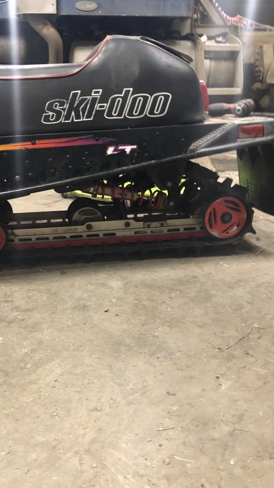

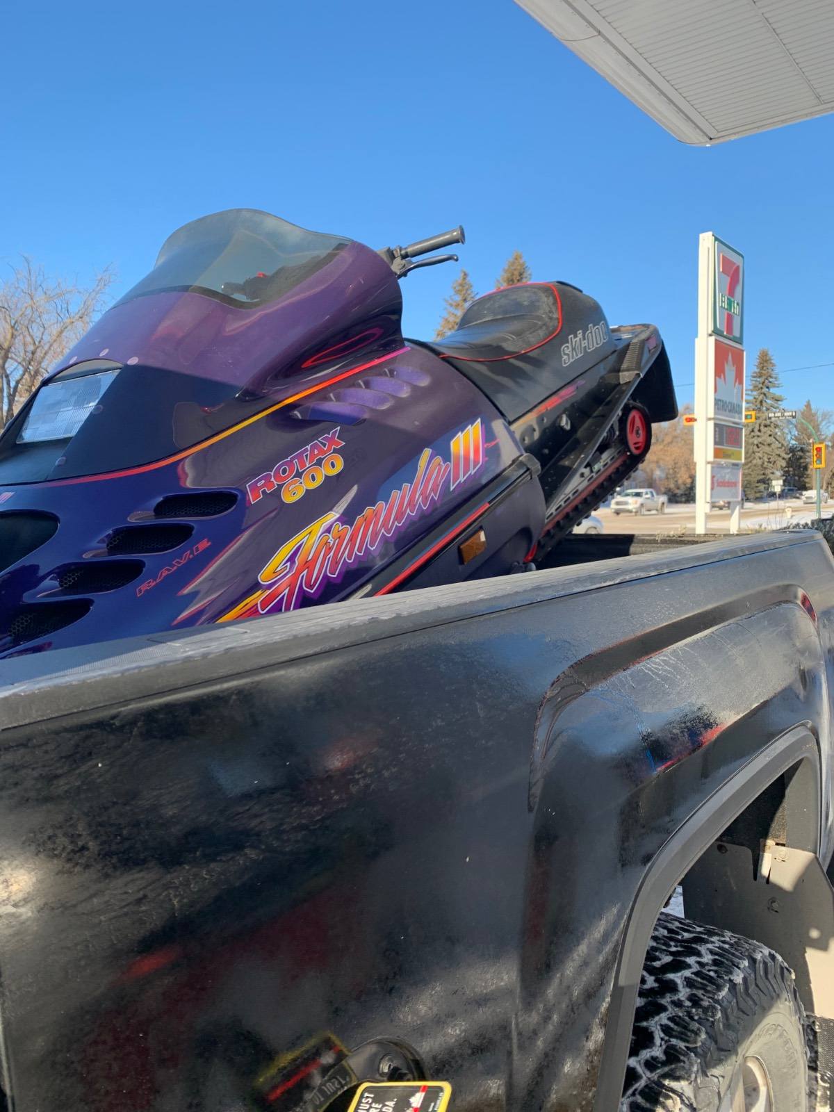

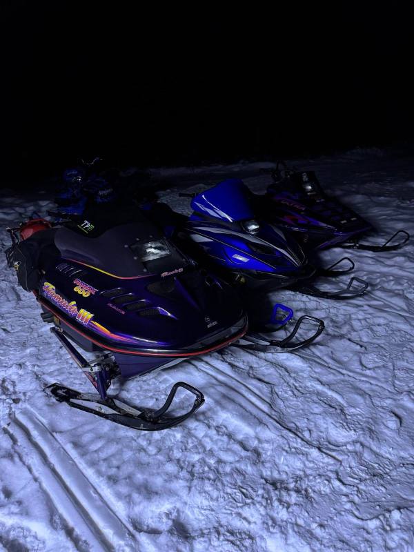

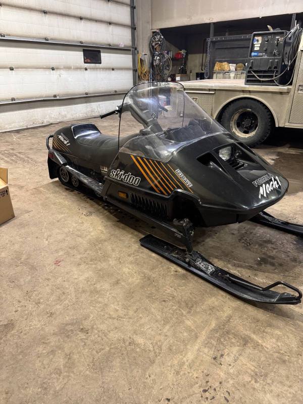

Guy posts this really clean 96 f3 LT for $1900.. couldn’t help myself
Bought this f3 years ago. Just rode it hard and put it away for years

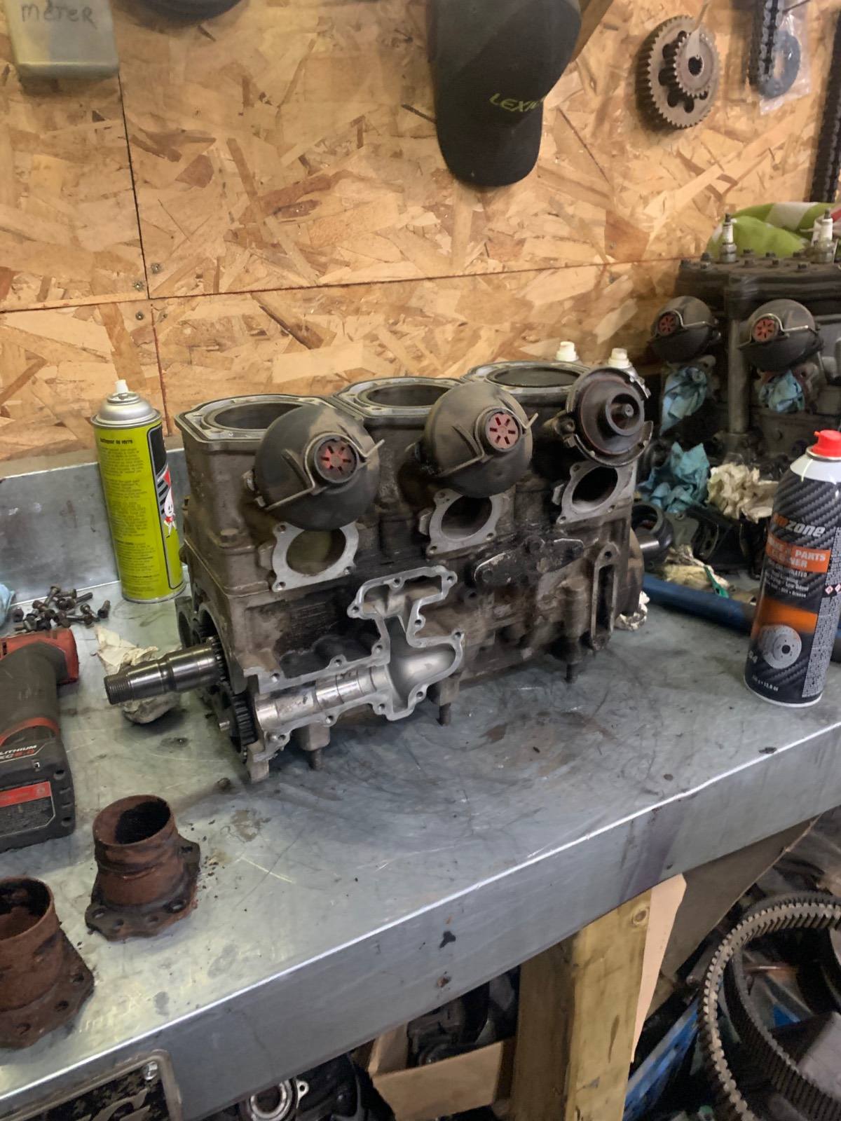

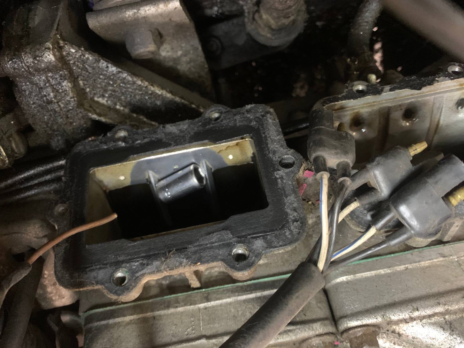

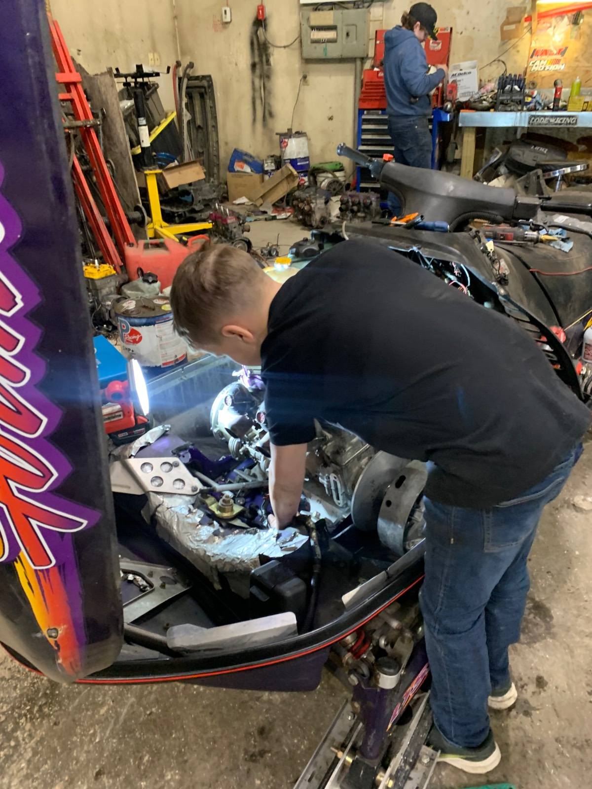

decided to tear it down to do a service rebuild
found this in there lol
its a craftsman. I don’t have any craftsman

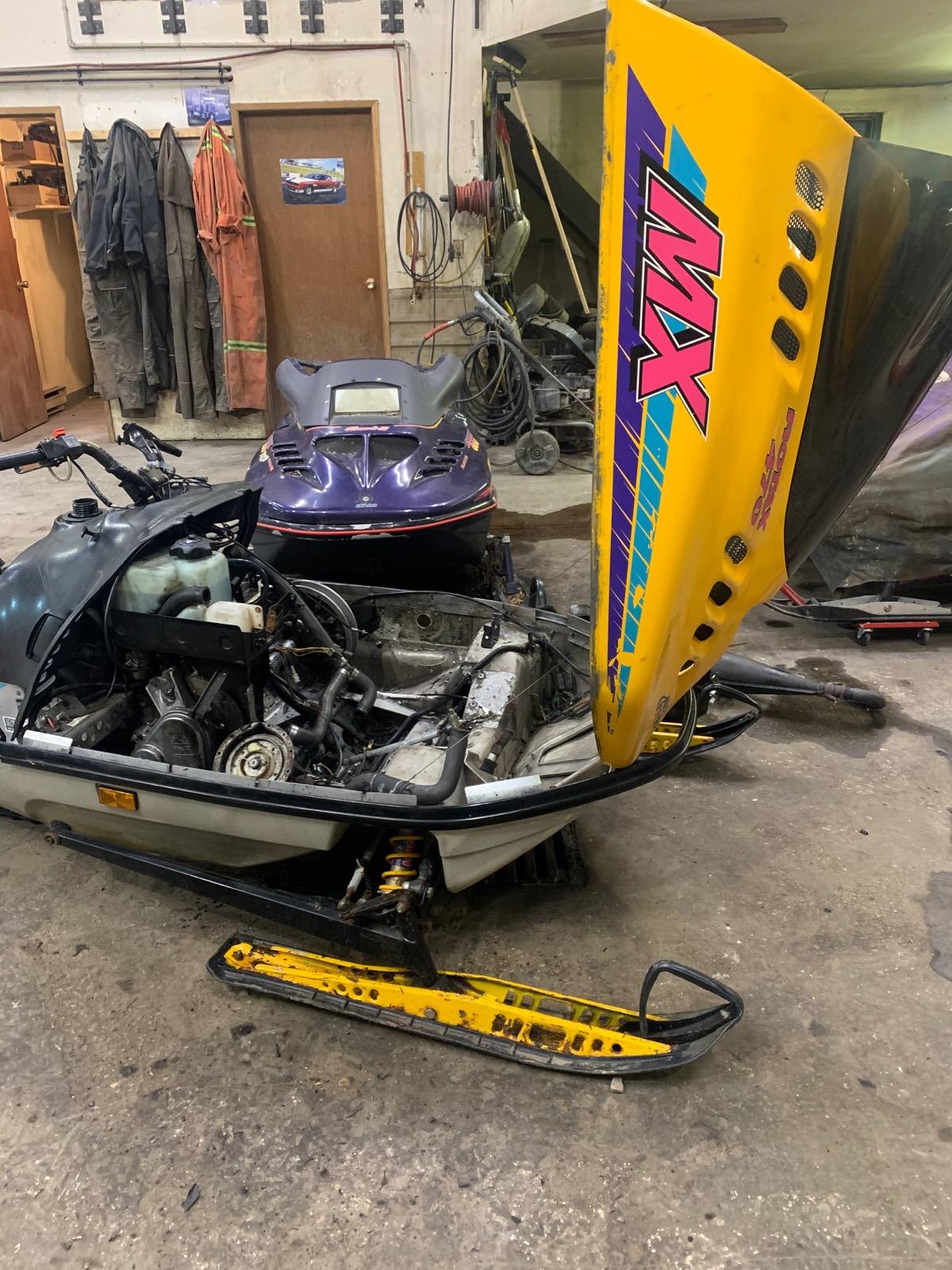

Oldest boy wants to triple swap this 470 so why not
had two 700 runners. First one ran when pulled but checked it out and it’s pretty effed
2nd one looks pretty good inside. So away we go lol
