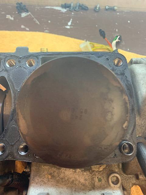

stock Polaris was the initial choice, but fortunately his compression checked out perfect and upon examination with a borescope everything looks good.  so, he's going to check some other stuff, change the belt and possibly uninstall a New Hampshire clutch kit.

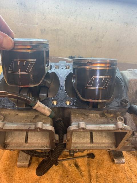

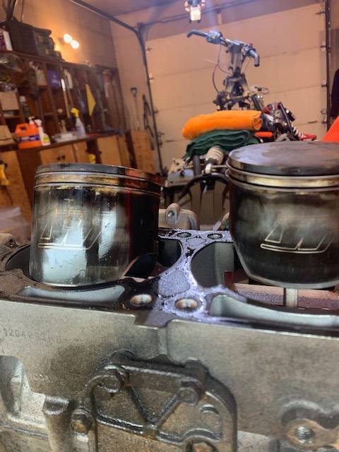

no fix kits, just go new Axys or try the Wiseco piston kit (not fix kit).  I have 3300 miles on my wisecos and they are still in almost perfect condition other than some of the Armor Glide coming off on the exhaust side of the sled.

I heard stick with stock before, but a bud of min threw in some zuke 800 pistons years ago and its been awesome.
my take---I use Stock, or SPI Hyper Drives.
Every fix kit that I've seen has failed!!
Most fix kits come with forged pistons, great for 4 strokes, BAD for 2 strokes. The forged piston expands at twice the rate of cast. Most snowmobilers are too dumb to run forged! See it ALL the time, cold seize!! Every fix kit failure I've seen is a cold seize failure!
If you are smart enough, and have the right clearances you can achieve success with forged pistons. I've ran them over the years with success, BUT you need to warm the sled up, take it easy the first 3 or 4 miles, and get the thermostat open and the coolant moving to not shock the cylinder.
