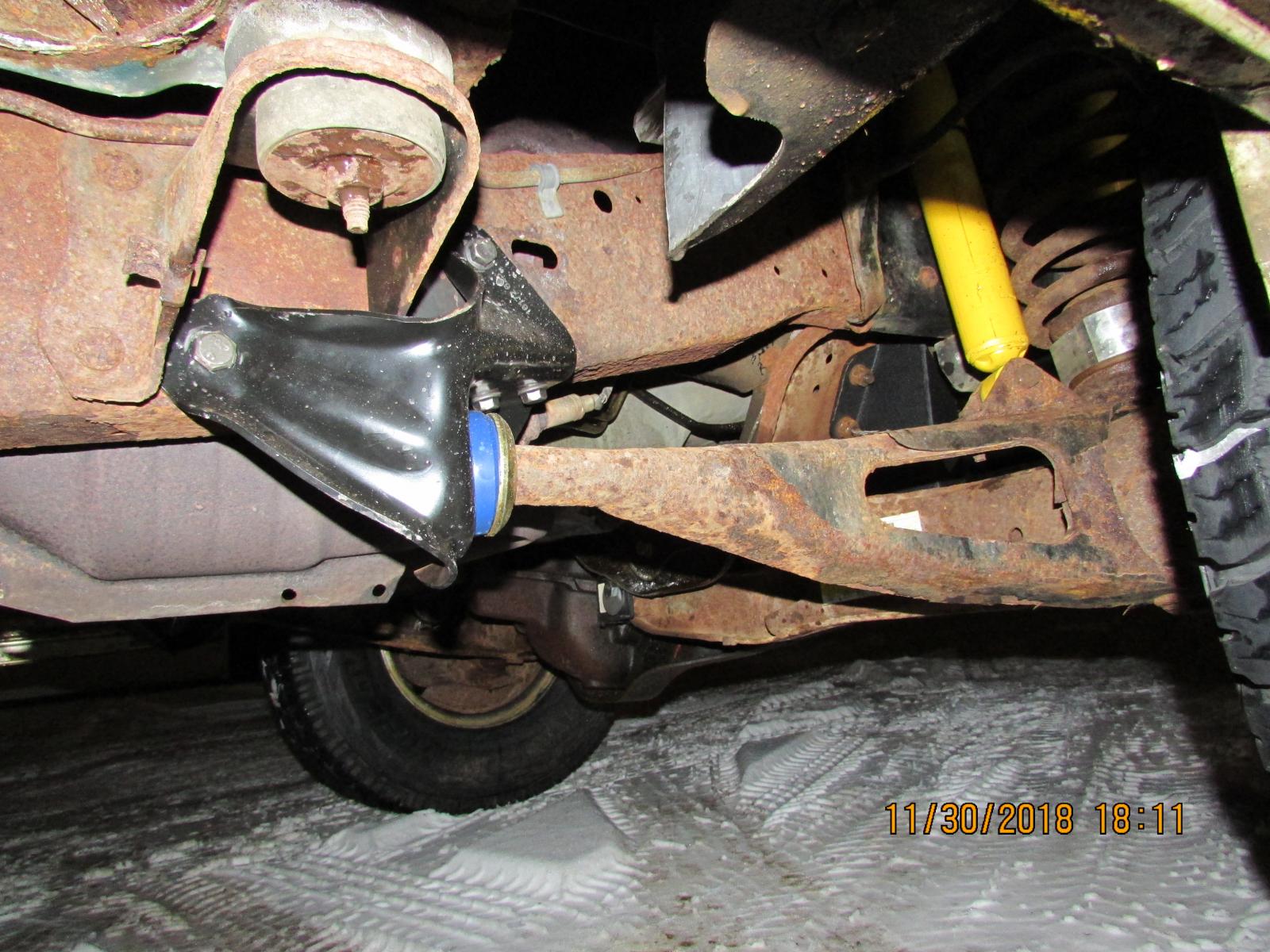

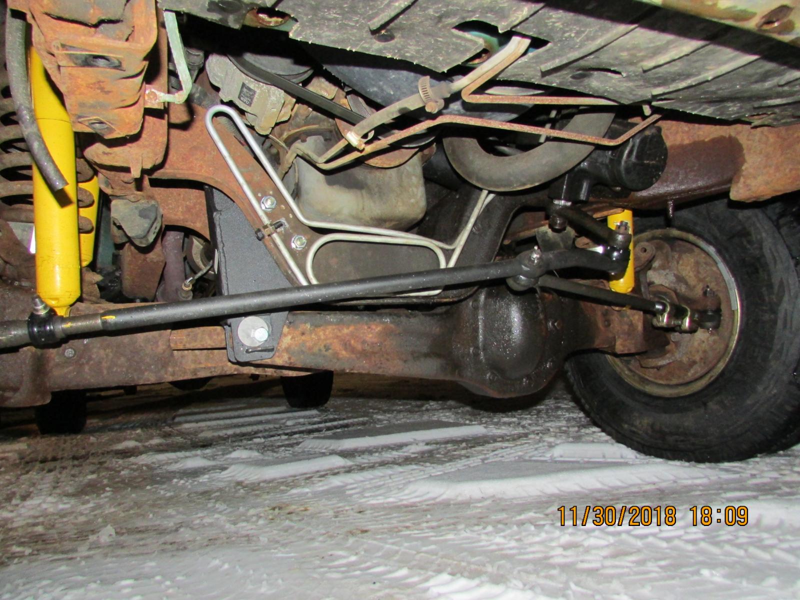

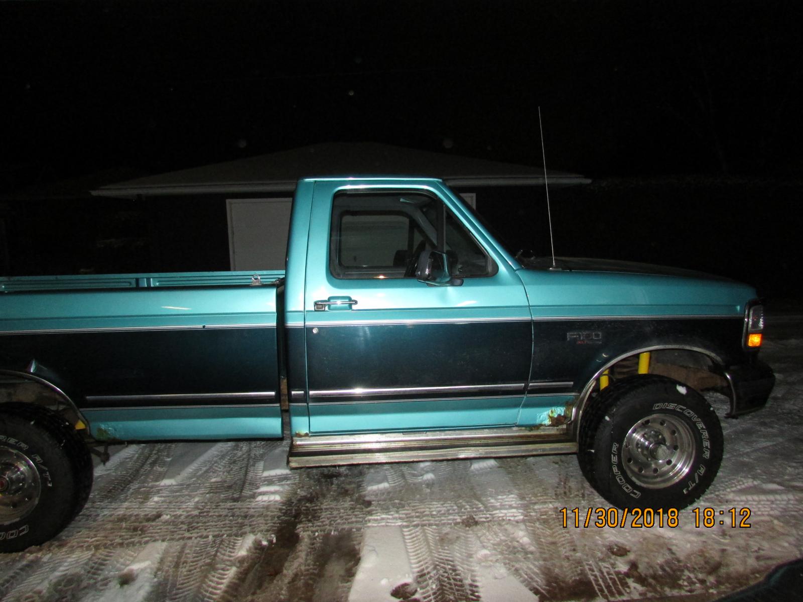

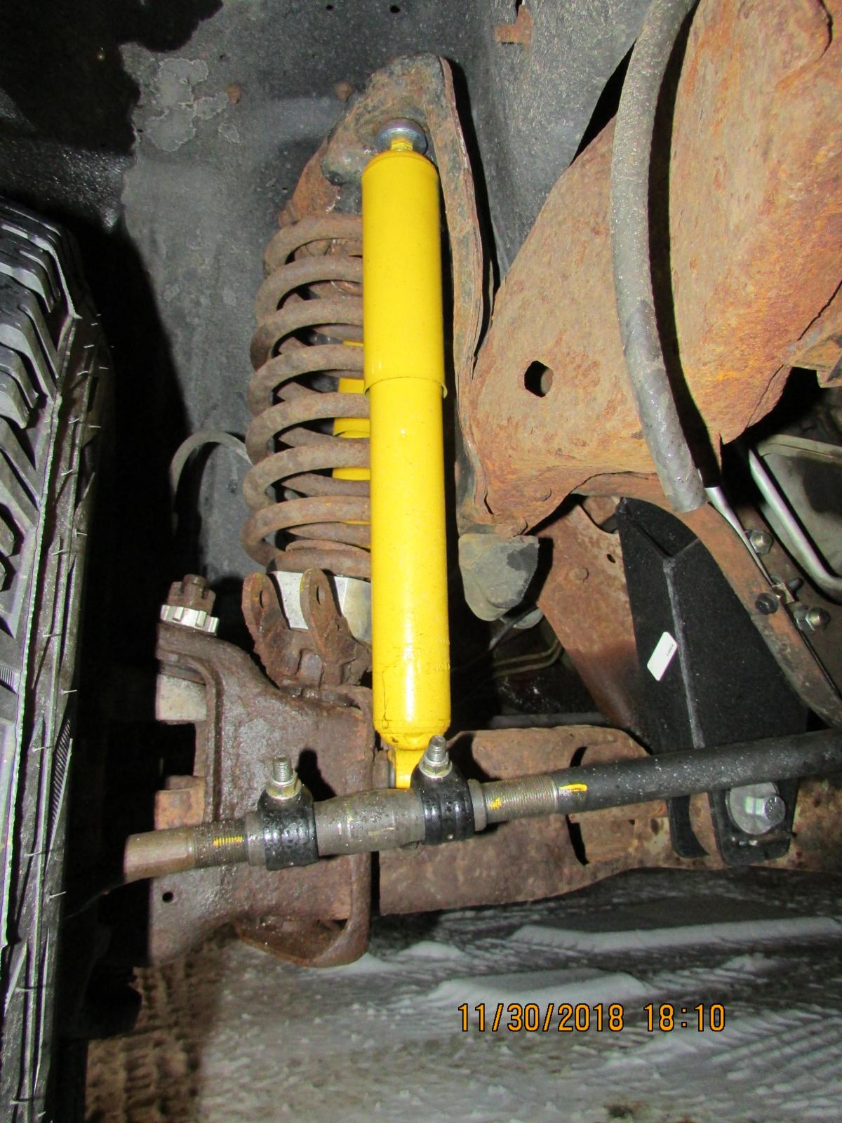

This truck I bought July 2018 from the original owner with just 97,000 miles on it.  Needed some work so I figured it was time to upgrade a few things.  I just picked it up from the alignment shop today so I'm done working on it for the year.  It's a 1994 F-150 in Calypso Green and Dark Tourine. 5.0L 4x4.
Replaced/Added:  6 shocks, rear add-a-leafs, 2" front leveling kit, 2" front axle drop brackets, tie rods & drag link, steering box, PS pressure & return lines, PS cooler lines, radius arm brackets & bushings, front axle u-joints, rotors, seals, bearings, calipers, pads, CD player, TPS sensor, new tail lights, and all fluids changed.  It's been a lot of work and my first suspension lift.  I've had 2 alignments done in this process.  It's sitting on new 31" Cooper AT3's and I have a set of 33" Dayton Timberline's on offset wheels for it also.  That's it for this year, I'm seriously tired of working on it and I've so gone over the budget :lol:

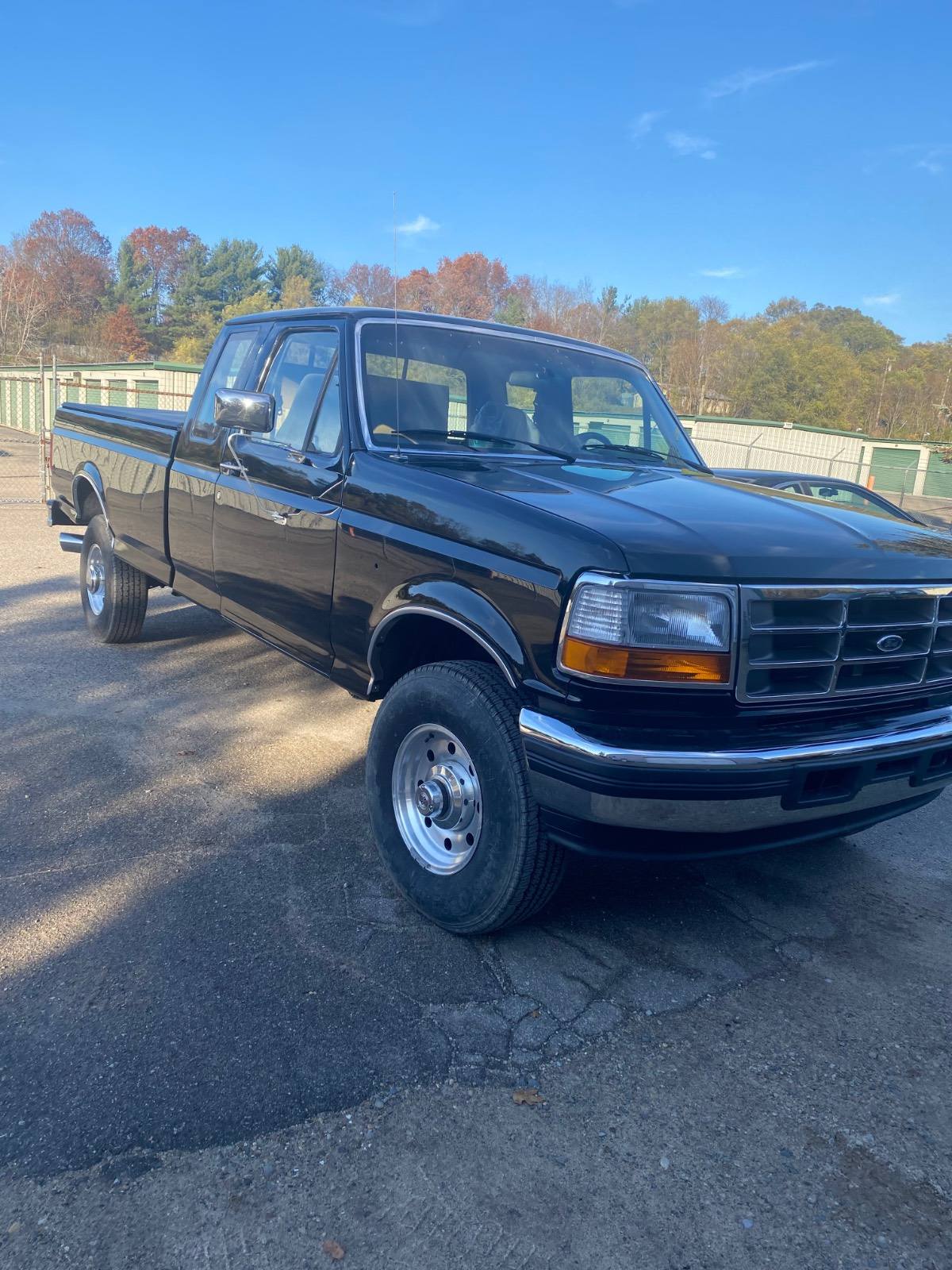

Don't have a pic of my 97 but was the same as this.
I have this sitting out in my driveway right now.  Now I know what it looks like with the mirrors “turned out”.
loosing it to corrosion and high mileage, still use it to get my sled up to Vt and back. Gonna miss it when I have to let it go.

this is actually it That is what it looked like with 186,000 on it.

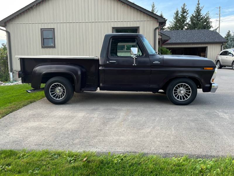

I’ve been debating for a year now over what motor to put in my flareside. I’m not sure if this is the right way to go but I made a deal to buy a 460 and C6. Both are in a truck owned by a friend of a friend. 78 motor all stock. 87 C6 from a van. Truck has seen some mud in a 4x4 so hope to check out the bearings when changing the pan.

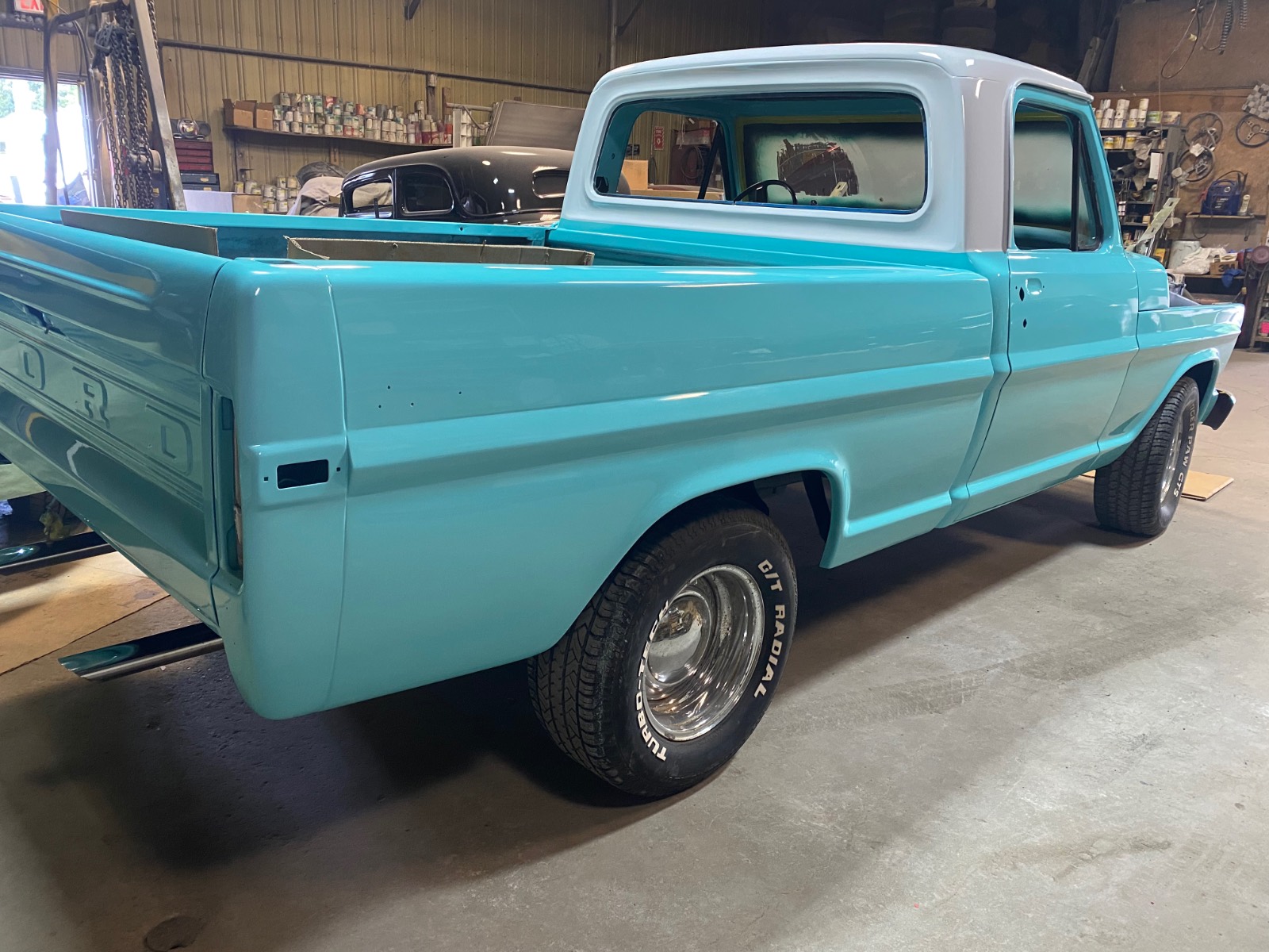

Almost ready to go home.

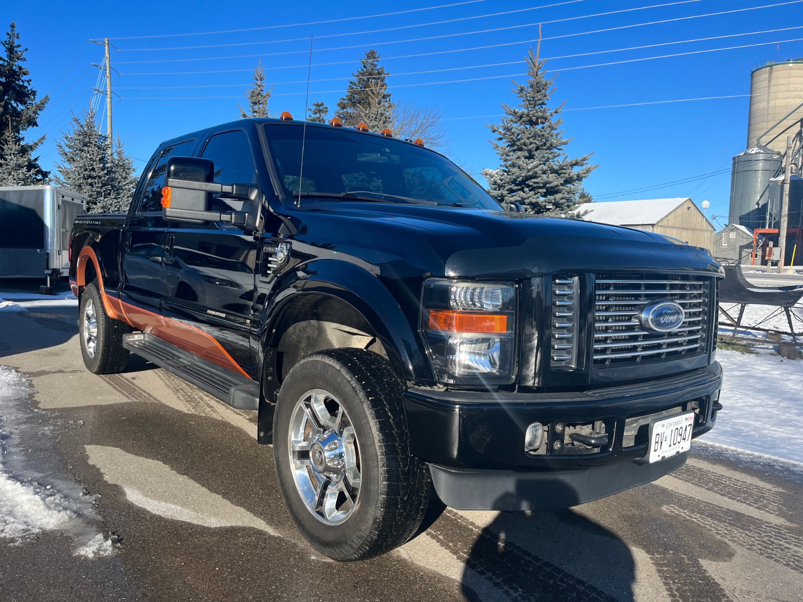

You would think an ‘08 would be that dated but the truck didn’t come with Bluetooth. Added an Alpine double din head unit to fix that. Also added a tailgate handle with rear view camera. Wired it to one of the upfitter switches so I can turn it on when I want. Retained my steer wheel controls,  added SiriusXM module and the sound works with the factory sub. Everything plug and play with matching connectors to factory. Amazing what they have available these days…..lol
A wash and a wax and moved it out of the shop for the next project.
Debating what to do with those tires. They just look too small. 275/65/20’s
Previous owner did a 2.5 inch level/lift with new coils upfront and a 1 inch block added in back under the factory block. I don’t like stacked blocks but I could easy cure that with blocks from a 350. Ride up front is a bit stiff compared to my other trucks.
Need to figure out what can be done with the heated seats too. The only have on/off and it burns your ass after 10 minutes.

Very nice. Are the deletes all done to it?
Ya, Egr and DPF. Previous owner had it done at a shop right after he bought it.
Only problem is he didn't buy a programmer. He just had the shop load in a tune for the deletes with a big hp tow set up.
Its got big jump off the line and she'll puff black smoke anytime you go a bit extra.
And it has an annoying trans shift at 55mph. Upshifts and downshifts on speed, not throttle position so when you try to drive 55 it is constantly up and down, up and down, etc.
I have to go see my buddy who owns a Ford Superduty repair shop and see if he can restore it to stock then put a programmer on it.
I've done some reading and most of the programmers on the market now don't handle the deletes. You have to go to aftermarket tune suppliers. Sounds messy.

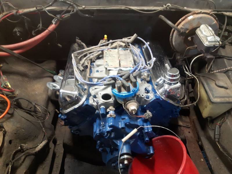

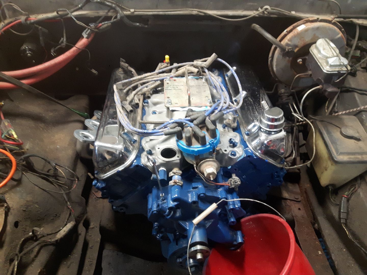

Out with small block, in with the big block.

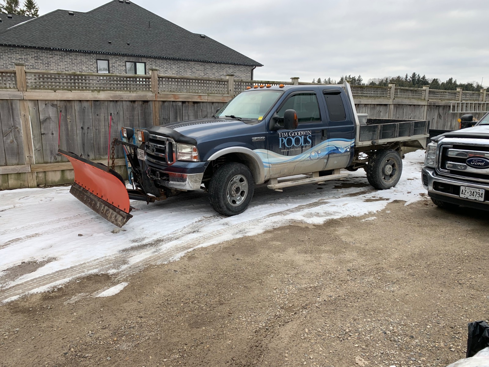

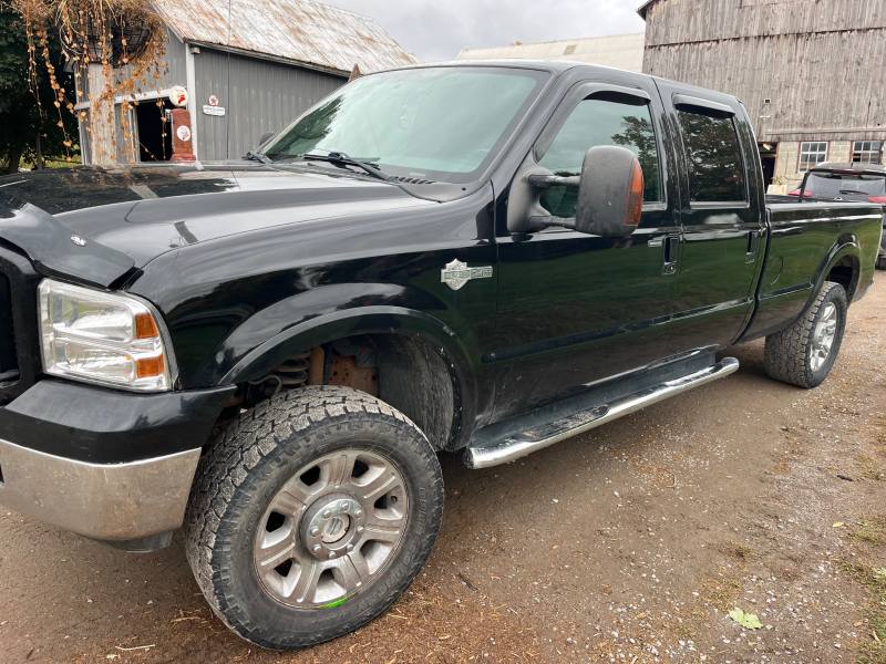

After 14 years working together, my ‘07 F250 is leaving me. After finding a crack in the coolant tank I realized there was diesel fuel in the coolant. Off to my mechanic who says it’s at the least a leaking injector cup but more likely a cracked head. He says run it until it dies, it’s not worth fixing at this stage. She just turned 400k kms and 9000 hrs. I was hoping she’d go another 2 years.
So I’m on the hunt for replacement, thinking ‘06-07 6.0 Crew so I can reuse the flat deck and plow harness. Only plowing a few driveways now since I gave up my commercial accounts. Hopefully something reasonably clean so I can park my others trucks for the winter and use it to pull my sled trailer (will need to be clean enough for the wife to ride in).
