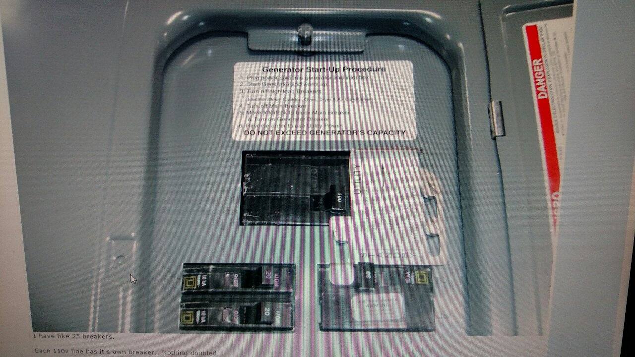

    Here's my set up using a 6000 watt generator with 8500 surge.   I installed a sub-panel next to main box and re-routed anything I felt necessary for comfortable living. No Stove ( use m
for comfortable living. No Stove ( use microwave, BBQ or wood stove top) or
hot water tank. At 60 gallons the hot water will last at least a day if you conserve.
Installation is straight forward if you have decent electrical knowledge and are careful.
Panel has a 30 amp interlock switch, sufficient for size of our generator. It has saved our bacon many
times up here, lots of wind storms and fallen trees
From the sub panel I ran an 8/3 wire to garage, just inside door with a 30 amp plug. Fire up
genny, plug in, flip switch and Bob's your Uncle

Transfer switch is the way.  As was said.  Shut off the main.  Slide plate up.  Flip genny breaker on and pick what you want the genny to run.  Easy.

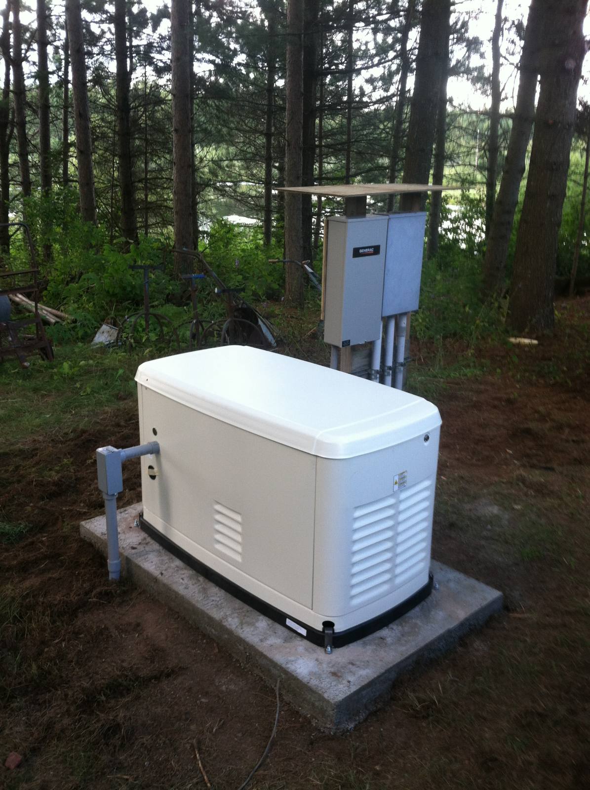

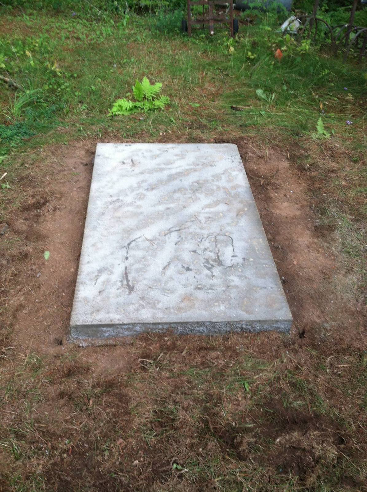

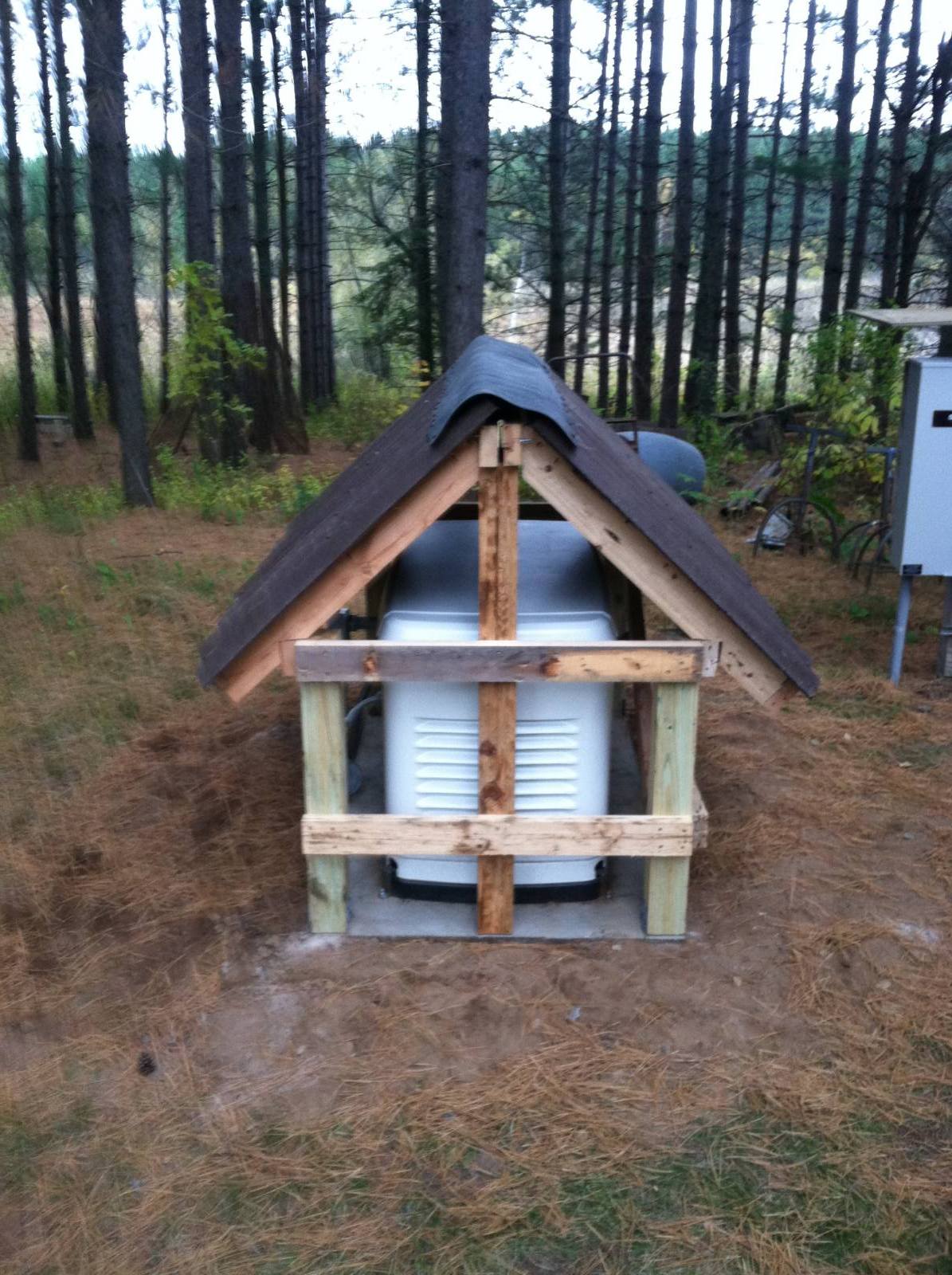

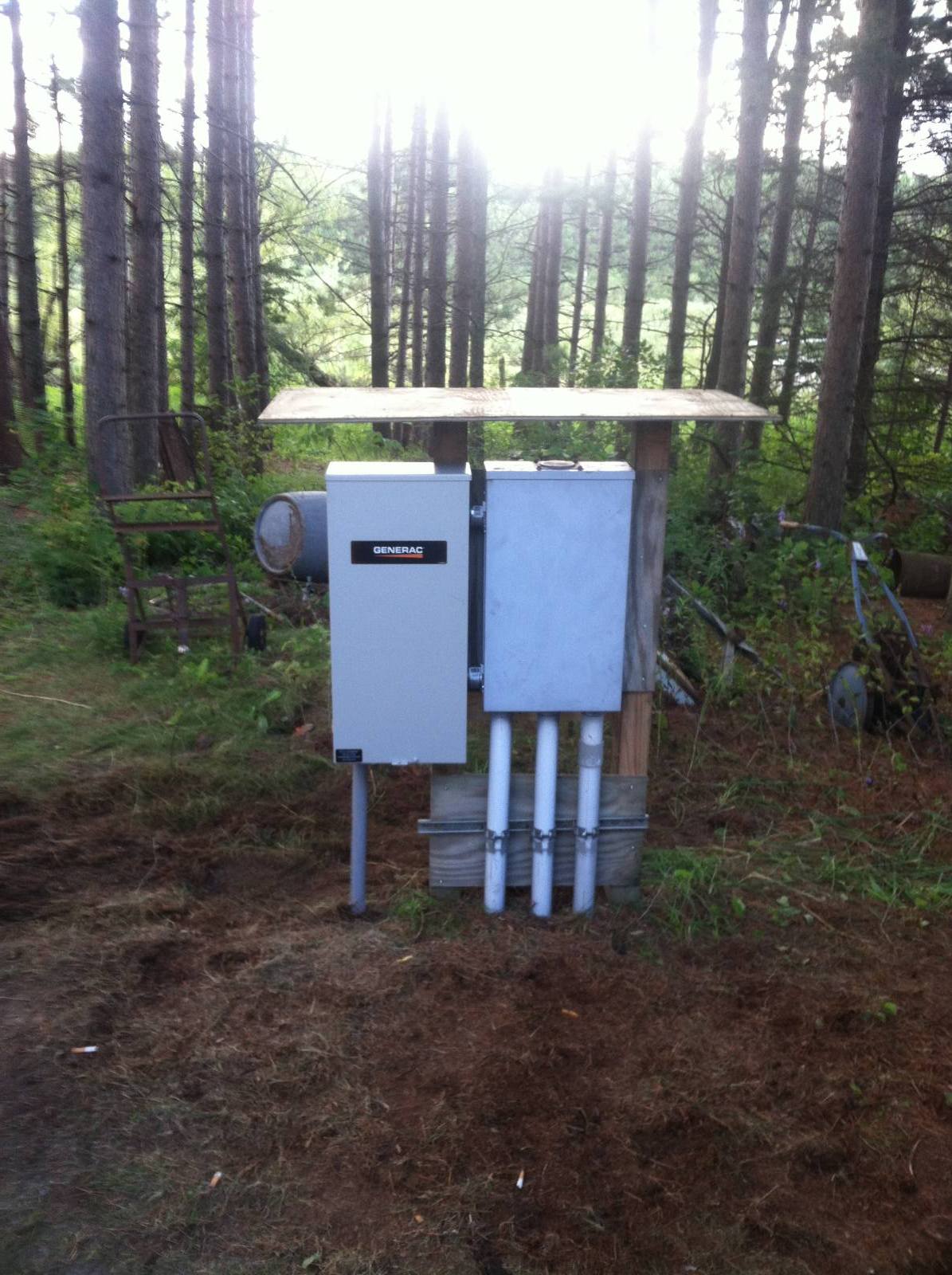

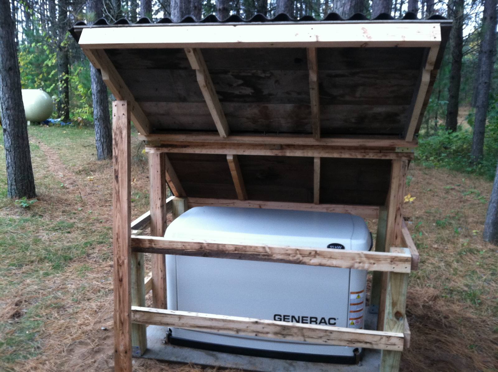

I installed a 11,000 KW generac in my dads place 6 years ago.
Came with a 200 amp transfer switch.
Very easy to install and works great.
When the power goes out, he has power again within 30 seconds.
As long as he has propane, he has power.
Edited by Greasemonkey
