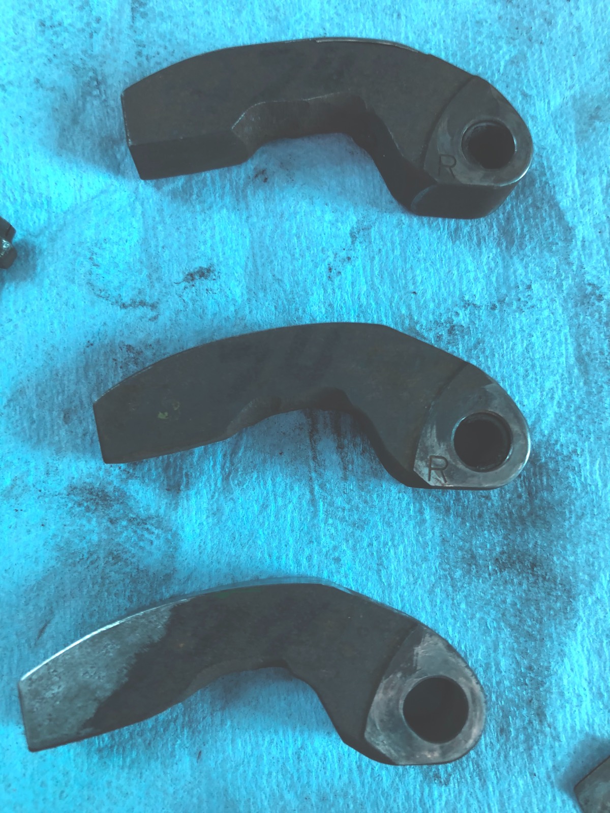

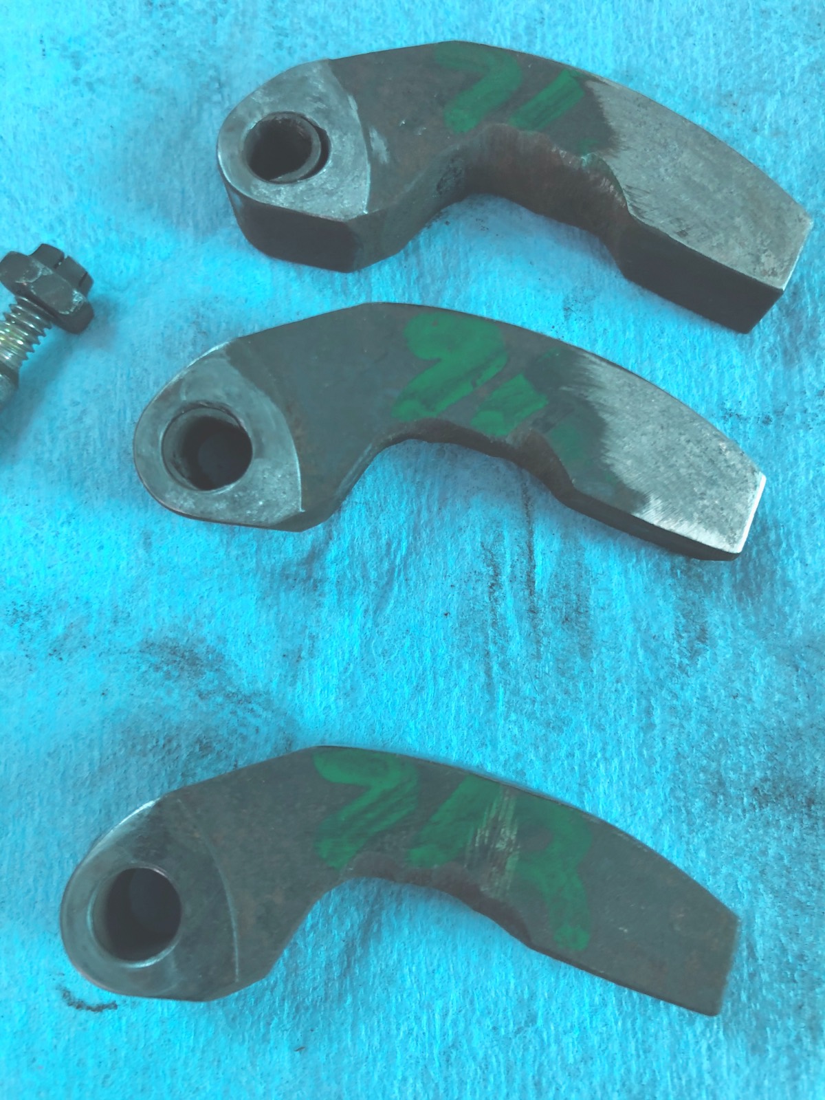

Can anyone help me identify these cams?  My SP500/F7 refused to disengage normally on my ride yesterday and I found worn cam bushings and a flat spot roller.  I was hoping to just rebush them but one is chewed up a little from where it wedged in and they are looking pretty worn at the hole.The primary spring is silver and the cover says 160/300 on it.  It also says 71.2 or 71.5.  The cams have 74 written on one side and 71.2 or .5 on the other with an 'R'.  This clutch came on the F7 motor and I thought it ran well.  If I need to replace the cams any suggestions as these are hand ground.  Hope it's ok to just start a new subject in this post.

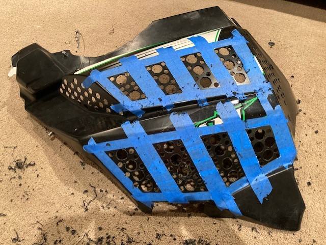

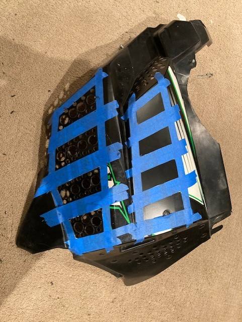

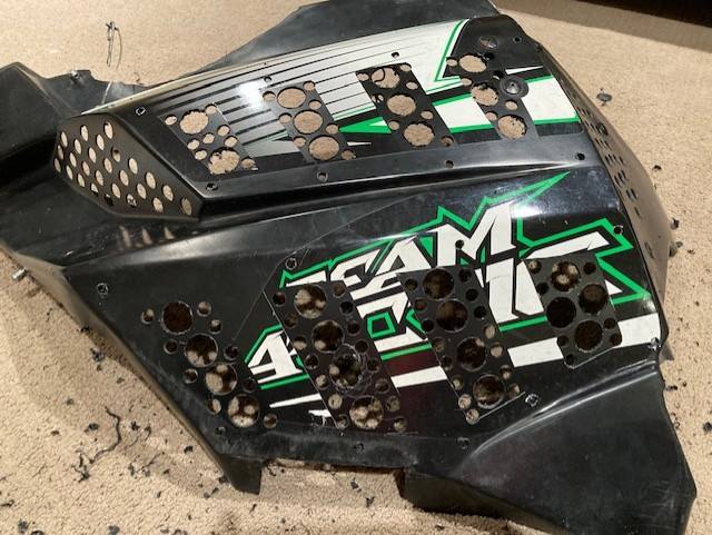

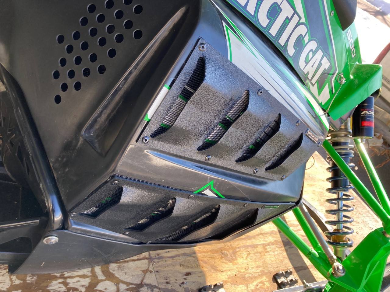

well, this was a gigantic pain in the balls because for some dumb reason I wanted to retain as much of the original decals as possible and at the same time extract heat from the engine compartment but here was my process for adding the Proven Designs vent kits to the Sno Pro 720.  high quality stuff, and a perfect fit.  my wife is a great sport for letting me do it right on the living room floor.  so, with the 15" wide track, Cat M-scratchers, the Koso gauge and the vent kit if I overheat this thing, it's all my own damn' fault.
I'll get a couple pics on the machine, at some point.
It'd be cool if you got the original side decals and cut them in a way so they lay over those louvers
I thought about that as well, and it would be cool.  Problem is the vent material is pretty slick and I doubt the decals would adhere real well, and cutting them properly would require a PHD in physics.
in hindsight I should have gotten the lower vent in white, which is an option.
finished look of the vent panels on the sled.
took a very brief ride around a small field before loading it into the trailer, snow was rock hard - pulled real well out of the hole even with the XC gearing.  need to loosen the track a bit.  hope to do some break-in riding on the lake tomorrow if we get the snow they are calling for because our local trails are currently fubar'd.

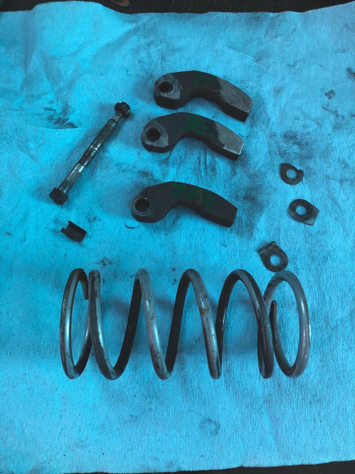

On 2/15/2021 at 8:23 AM, mnstang said:
Anyone want one of these secondary springs.  For the team secondary
I might... pondering my secondary on the 720 with fresh XC gearing right now even though I haven't tested it yet.  looking at the spring and helix on the XC and wondering if I might need to upgrade there as well.  devil's often hidden in the details right?  maybe I can get some info from Jeremey Houle or @Fast 440 knows, wish TwoLapsDown was still around too as I know they had numerous gearing and spring combo's back then for the 600 XC's.  at the very least I should probably take my secondary apart to inspect it and make sure the helix is on 40 and see which spring is in it as the D&D clutch kit with the engine kit only addressed the primary.
Stock 2010 500
Helix is 40/38 - 0648-805
Spring is Black/Blue 180/260 - 0648-790
20/46 gearing
Belt 0627-047
Stock 2010/2011 SX 600
Helix is 68-48-36/64-48-41 0648-789
20/46 gearing
Belt 0627-075
Stock 2010/2011 XC 600
Helix is 44/42 0648-809
Spring is Black/Orange 180/280 0648-792
20/39 gearing  (already have this)
Belt 0627-076 (already have this)
