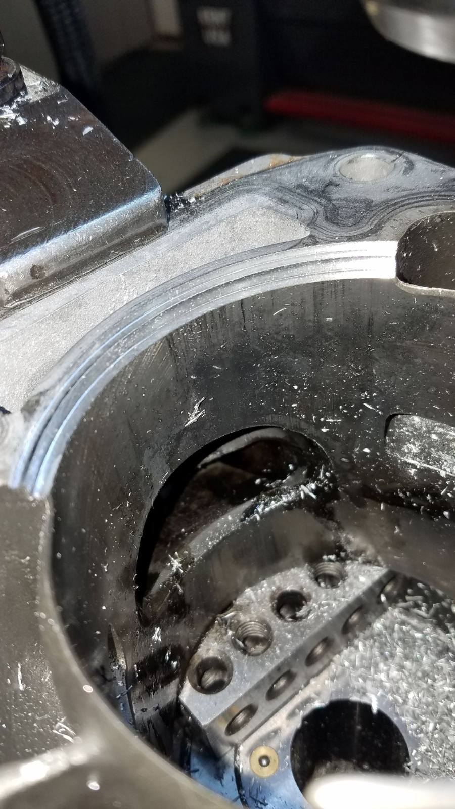

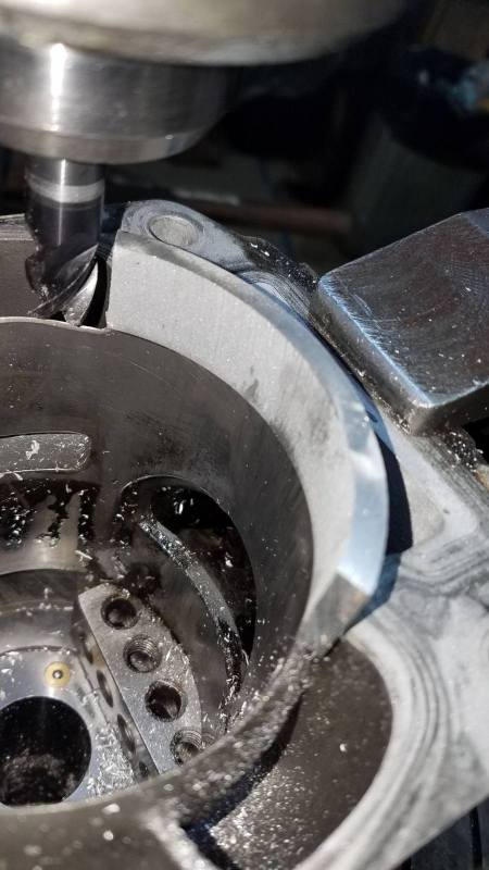

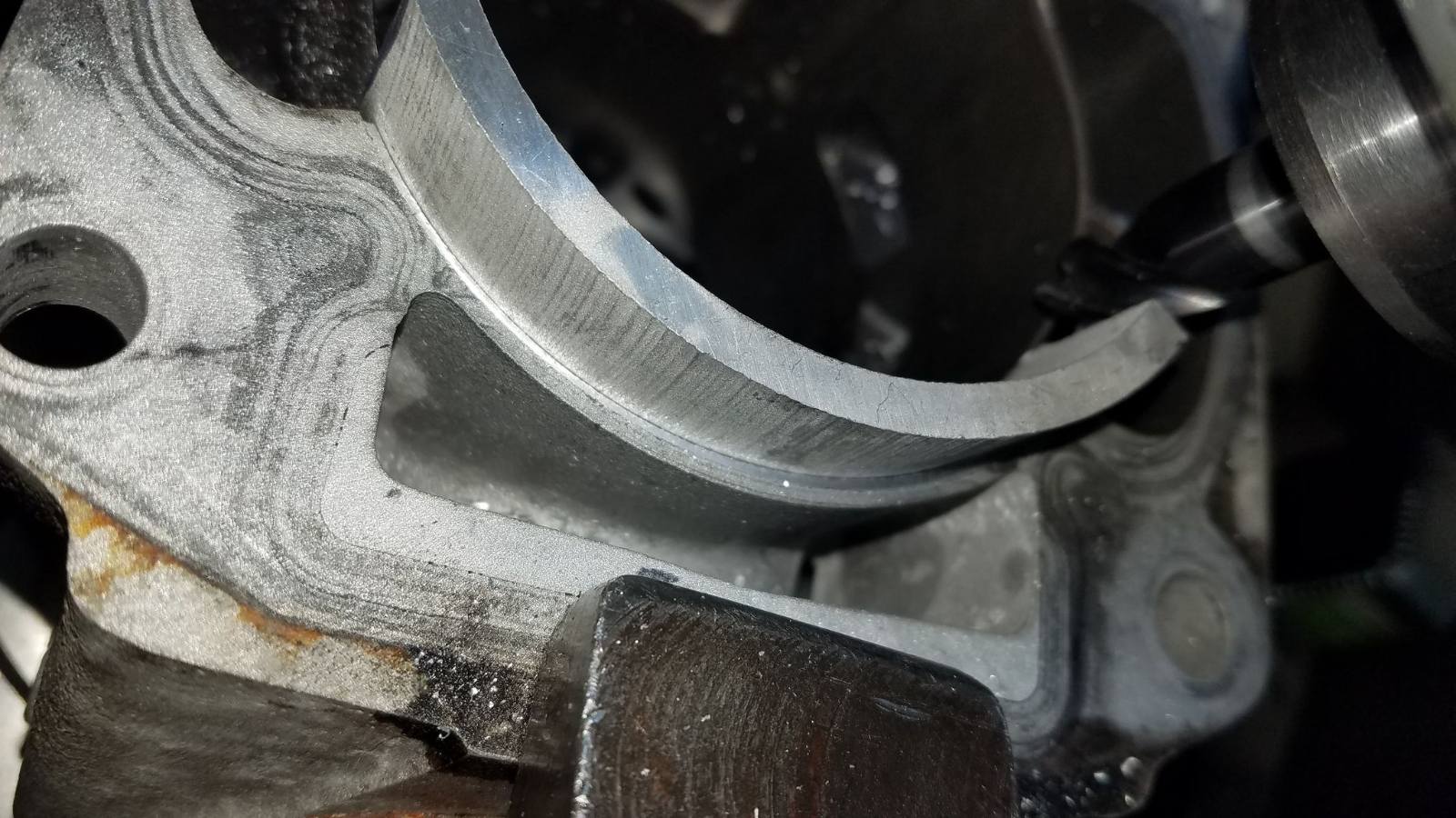

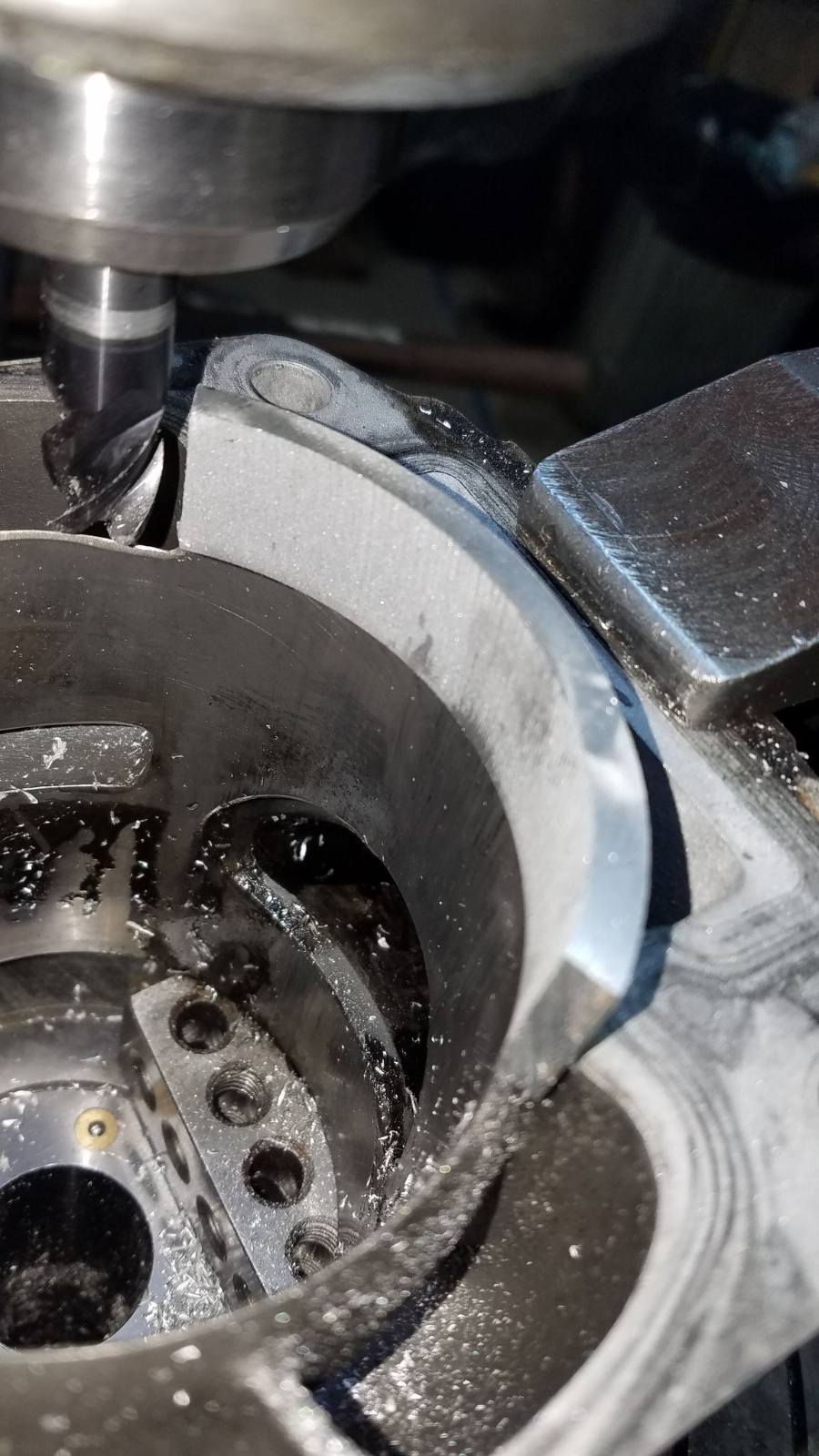

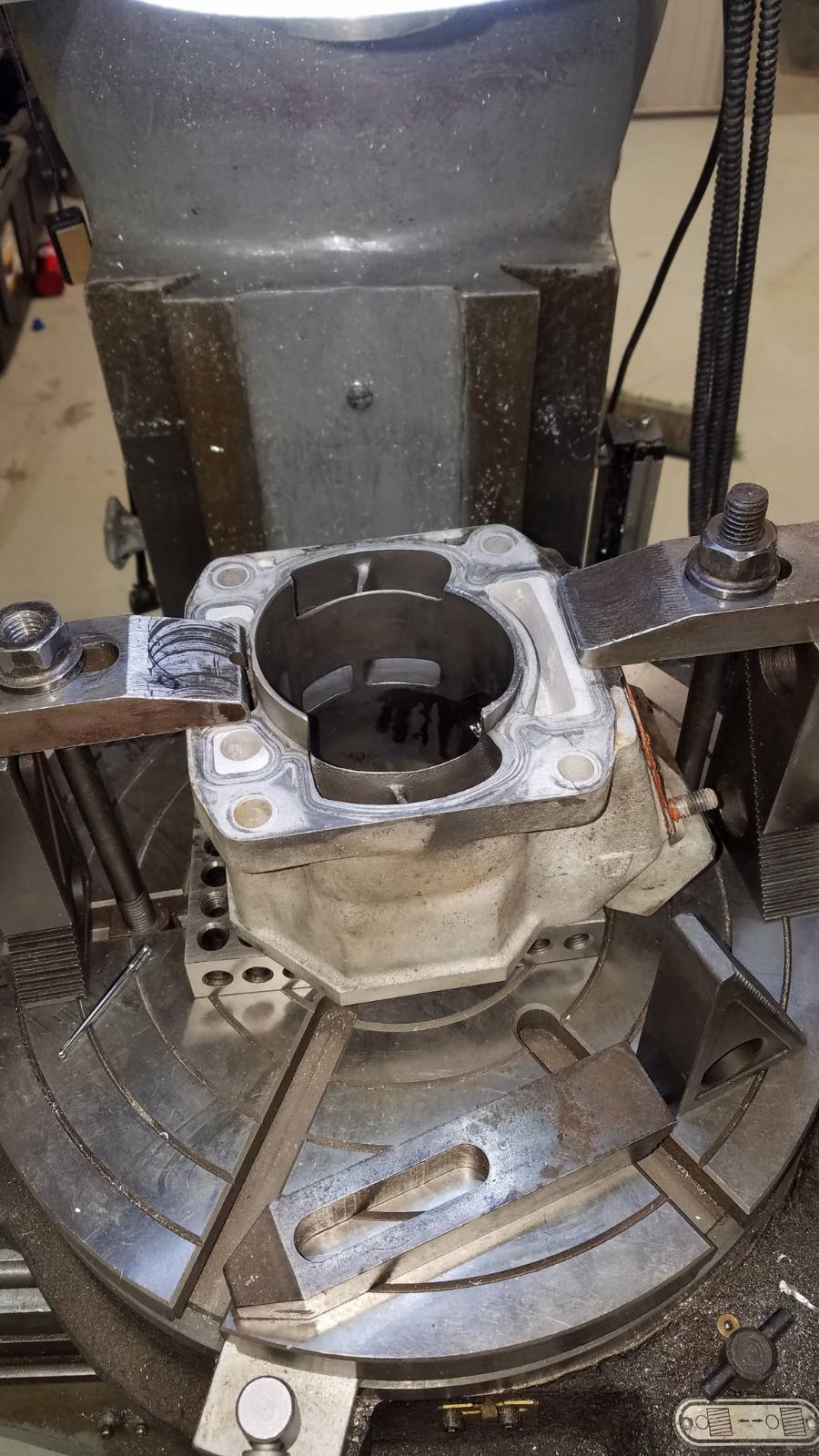

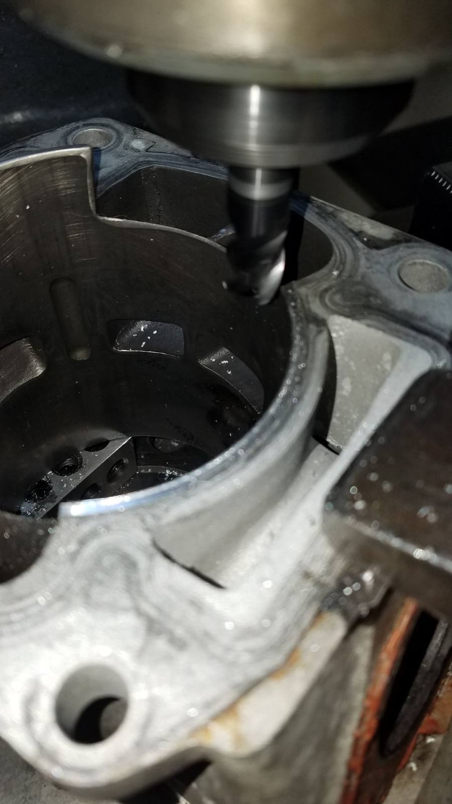

cylinder progress
if anyone else has one of these, apparently the skirts breaking isn't uncommon
20 hours ago, Crnr2Crnr said:
cylinder progress
So what is going on there exactly.
welding in a new skirt?
repairs to the bottom of the cylinder that most of us can't do at home or work.  cylinder skirt was broken off and sent into the crankcase, new cylinders are not available and these have been ported.  the cure, finding someone capable/competent of repairing the existing cylinder and making it useable again.  found that person.  guy bleeds green and does high quality work.
Looks bad ass.  I was really just wondering if he is going to put in a new skirt and then have it re plated. which after starting at the pictures more is quite obvious, just had to zoom in.
This might sound stupid but I love fixing things most would just throw out.
I am also lucky to have mold making shop at work.
