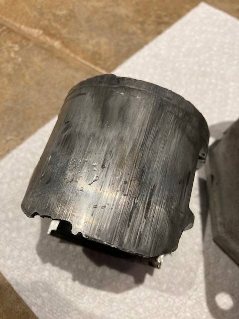

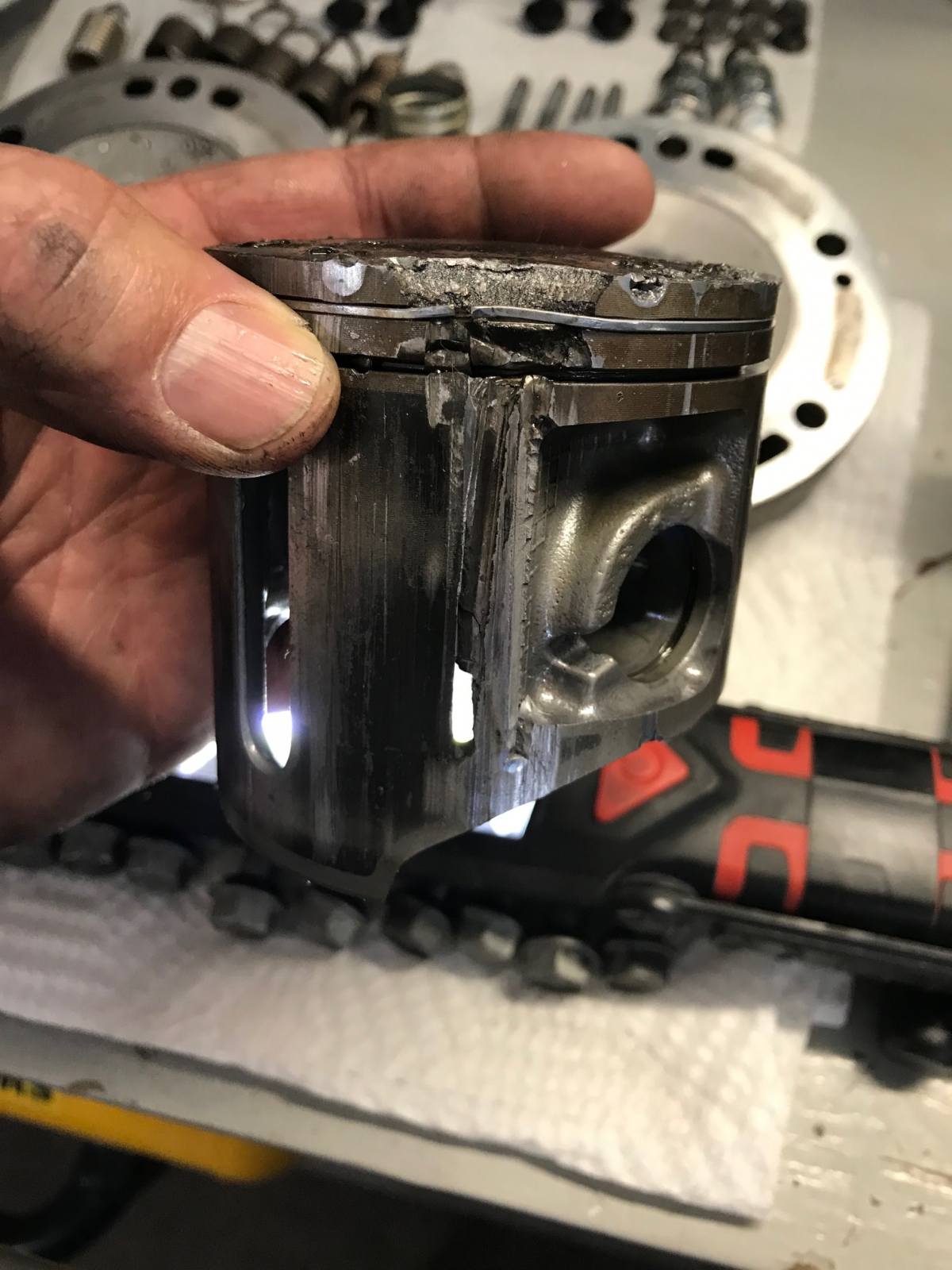

ripped D&D 720 apart hoping to find a burnt piston on PTO side
no such luck
overheated, possibly multiple times with 4K? on modified top end
found PTO piston rings melted into and missing from the PTO piston

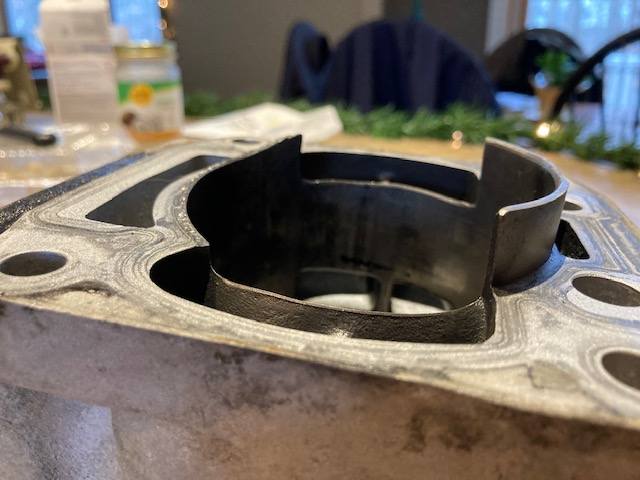

found front skirt of PTO cylinder missing

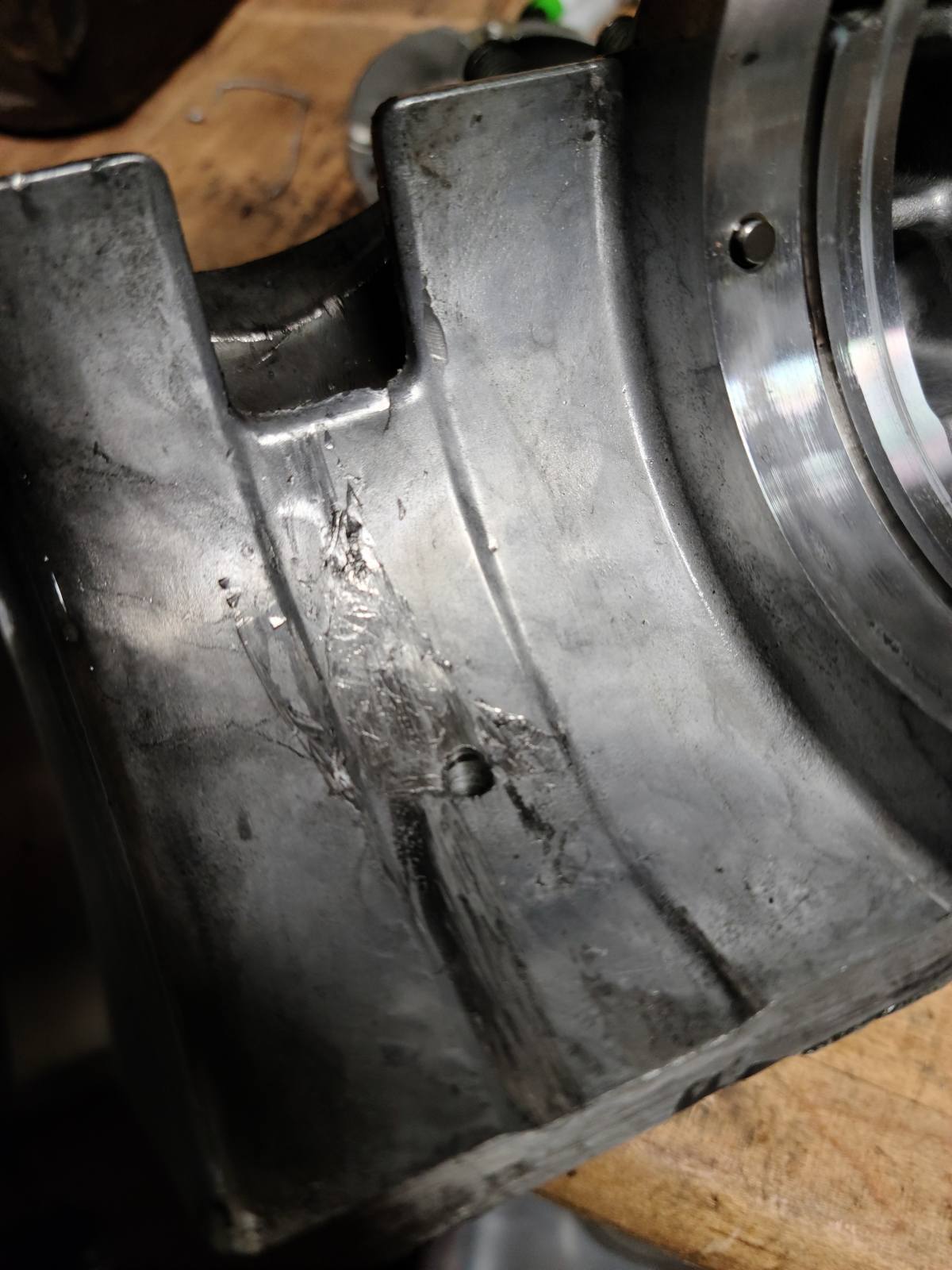

found crankcase, crank bearing and general mayhem in crankcase
purchased good used case and crank
found a magician in PA more than capable of repairing cylinder and matching new discontinued pistons with cylinders and nikasil plating the cylinders
ordered several hundred dollars worth the bearings, gaskets and seals because 'proprietary'
new reeds, tested/cleaned/rescreened injectors and updated throttle body covering per recall waiting for install
updating Boondocker for more fuel during long pulls while depressing 'add fuel button'
adding additional coolant temp sensor and gauge to monitor
even more stuff I'm forgetting at the moment
replacing jack shaft bearing because why not, installing XC gearing, Vespel slides and new track - struggling to decide if I'm going 128" or 136"
replacing rear bumper which was bent when I bought it
I have it on a good source that Santa may have acquired the last know brand new tunnel bag still in it's original packaging which might appear under the Xmas tree
and there's more ?$?$?$?$? to burn but I love these sleds so fuck it.

I bought the 720 at a good price anticipating doing a top end, what wasn't factored in was rebuilding the entire engine due to my own fault or damage began before the purchase.   I look at it this way, I love the chassis, I adore the suspension upgrades done to it (alone worth what I paid for the entire sled), it's easy to work on, relatively low tech, doesn't have to go to a dealer, takes a pounding like a Tijuana hooker and it's (to me) a special sled only a handful of people have.  The bonus, it makes as much power as a brand new Polaris 650 more power than the stock 600 SX/XC sleds of the era but appears to the unwitting as a lowly 85hp 500.

no, but I'll likely go with a Koso.  the D&D pipe has a bung on it.  it runs pretty well when it isn't self-destructing itself on 91 or better octane.  looking forward to getting it running, broken in and seeing what it will do with the XC gearing on the big end.
You really dicked 'er

Mine is better....but he did fuck his case up better than I did.  :lol:
Extra slot for cooling!
holy baby Jesus! that is fucked good
