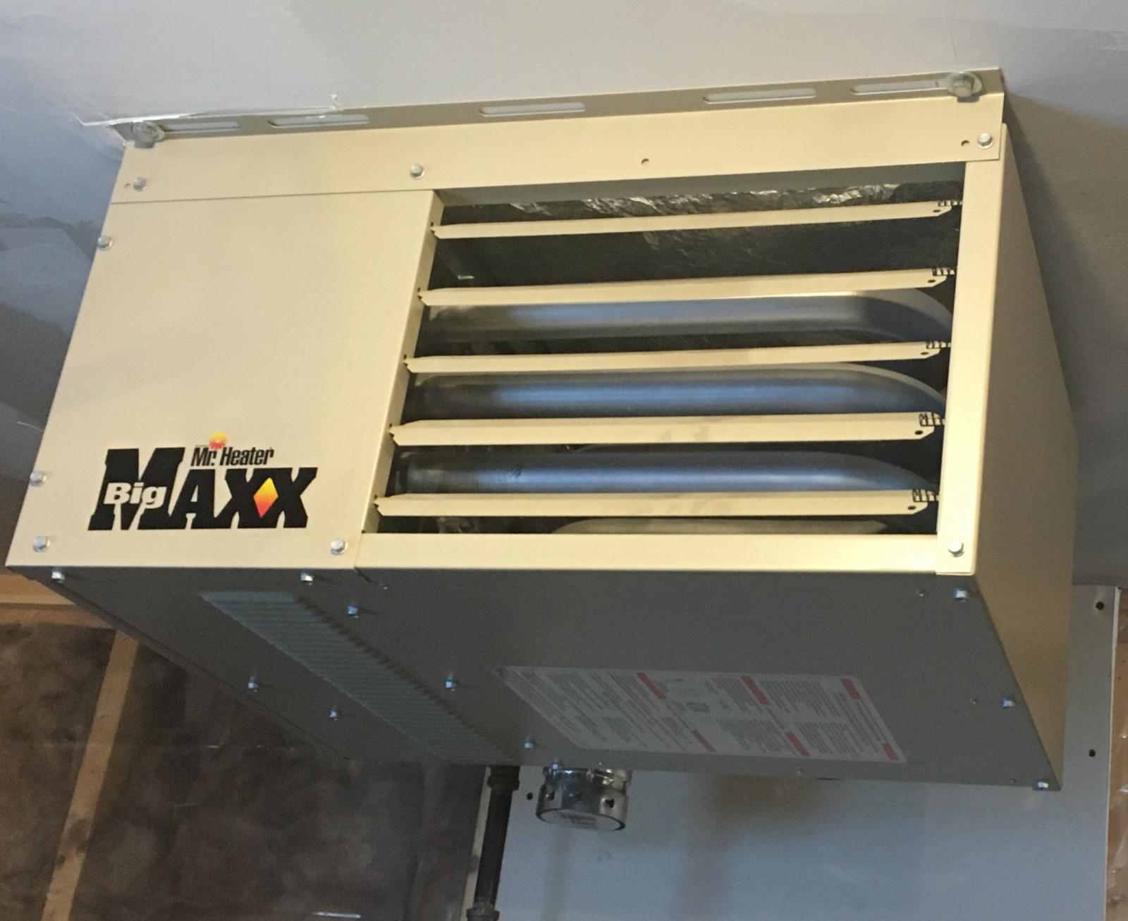

I picked up this Mr. Heater unit last summer.  ~$400 I think.  I believe it’s 50k BTU.
My garage is currently 28x36, 8’ 5” walls with an upstairs that I’ve closed off for winter.  R-19 in the walls and ceiling and vapor barrier sealed tight.
 In about 20 minutes it can go from 10-20 degrees to ~65and sustain it easily.  I only run it when I need the garage warm.  The only moisture problems I am seeing so far is just excess from snow on vehicles and my sled.  Otherwise, it stays dry.

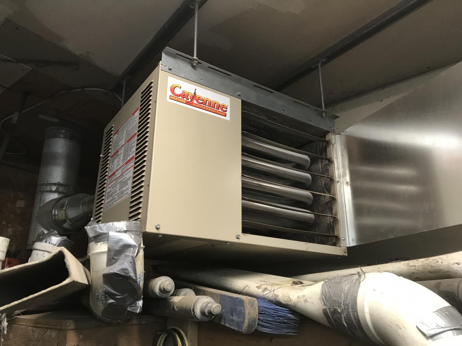

I have the same type unit on natural gas in 60k btu. I heat a 30x50 with 10 foot ceilings. It struggles to hold 70 degrees on cold days. Some day I'll put in a regular furnace with duct work.
Duct work makes huge difference to any forced air type heating,  and when exposed you don't waste the heat coming from the duct itself...
I like the look of well put duct work, can look real nice if done right

This was the biggest unit I could do. I replaced it last year ago when the old unit died. It was a 40k unit.
When I bought the place there was a furnace in the back corner with some venting. The shop had been split in half at one point and the furnace heated the rear portion. I sold it for $100 cause I thought I didn't need it.

Mr Heater Big Max sells a 80K unit that is meant for a 2000 square foot space, there are all kinds of different brands that are pretty much the same though.....but if I was replacing, I would look at a HE furnace instead that you can install ducts throughout to distribute the heat.
http://www.mrheater.com/80-000-btu-big-maxx-natural-gas-unit-heater-1239.html

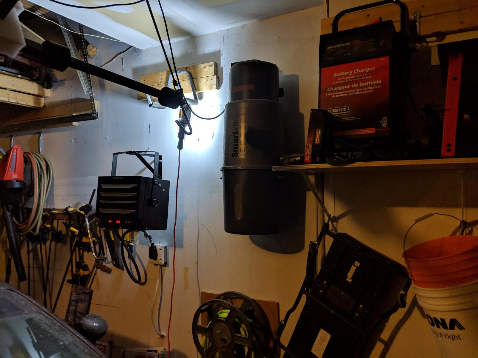

So bought the CT 7500W yesterday with #8/3 although it does not require neutral.  Hope to install tonight so I can be toasty warm.  Garage is maybe 18x20 standard double.  Cottage will be 30x40 so propane will be the way to go there.

BTW.  7500W equates to 25K BTU/hr.
Installed heater yesterday, (rough), it works, knockout on unit is too small to feed #8 wire securely.:dunno:
hopefully you can angle that heater when you use it, it should be 45' degrees to the garage door

Should have read manual
