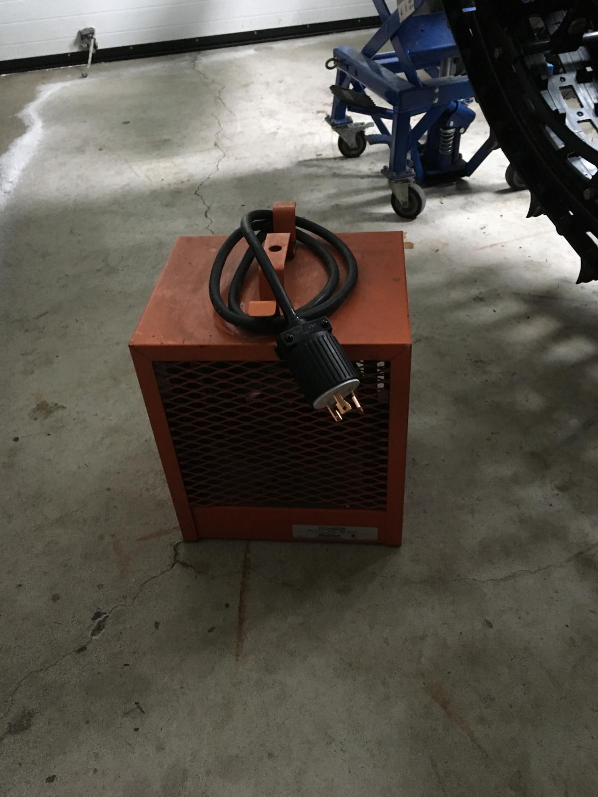

Not what you’re looking for, but if you want to set something up in the meantime, it’s a cheap way to do it.   4800w, 240vac 30a. They’re about 80$ new, I grabbed a couple at garage sales for under 10. My 1.5 garage is insulated, with insulated door. Works good for me.
I used that before I installed the heater I have now, it worked to heat the garage up, the problem was the recovery rate, it took too long to reheat the garage after you opened the door, etc....but was far easier to hook up than the heater I have now!
