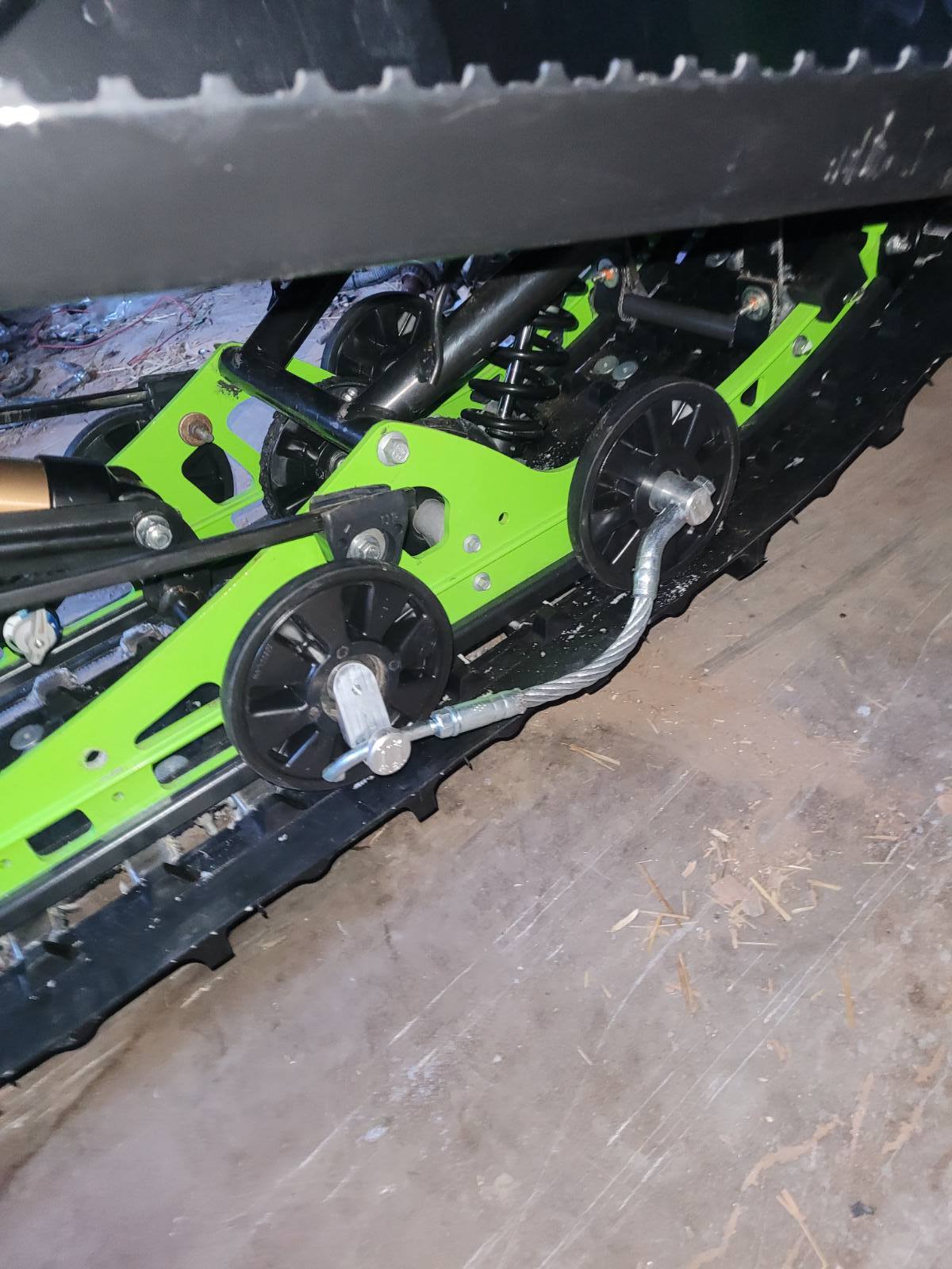

I had Duraflex and between the lines designs mounts on my cat

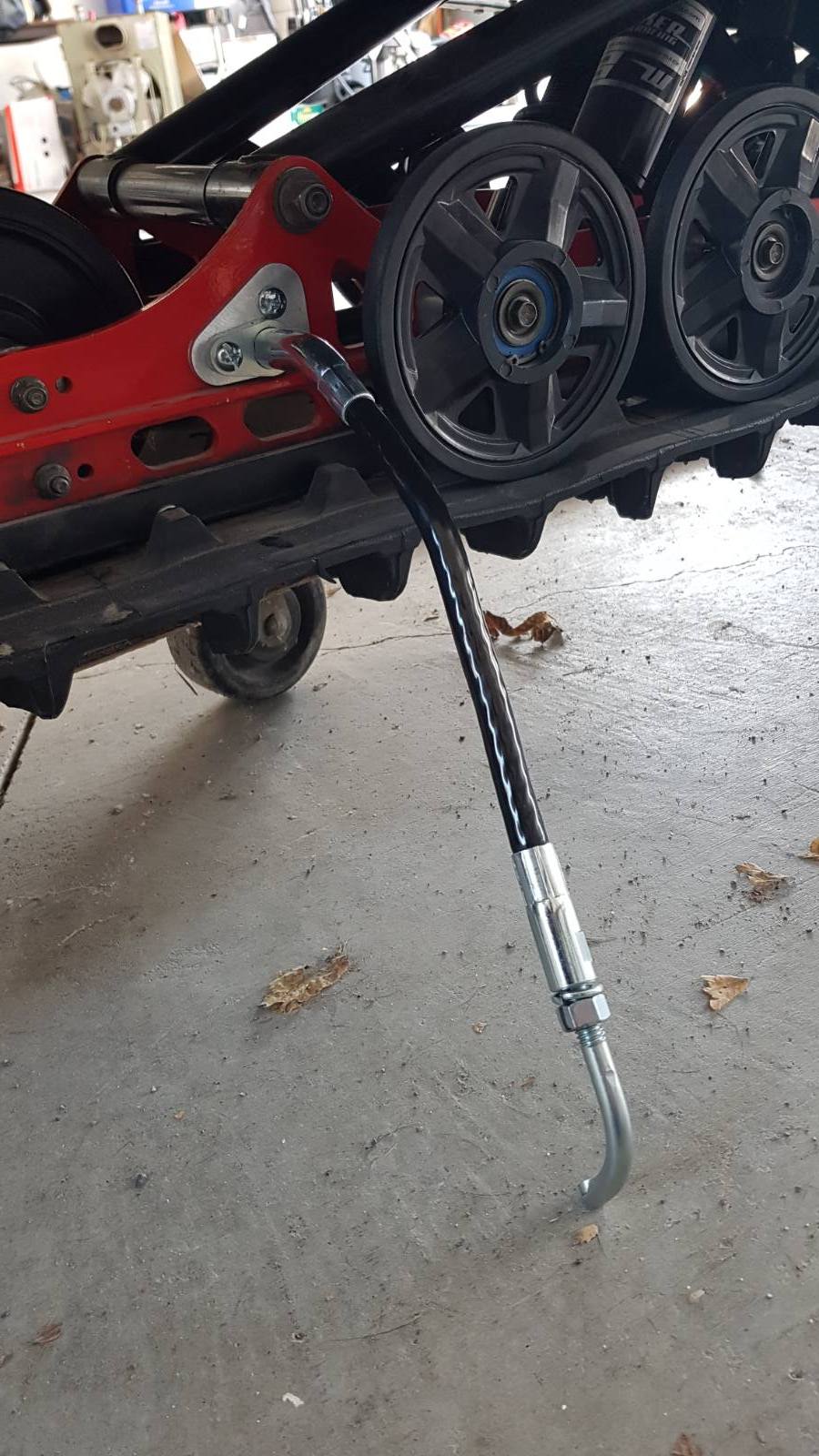

Duraflex - been running them for years.  Yes, they kick up shit that will beat up the rails, as would most any suspension type scratcher.  Just put new tips on these this year.  Chunk of garden hose split in half zip tied to the rails keeps them from gouging the rails - or I’m sure there are many other methods where you could spend money to do the same.

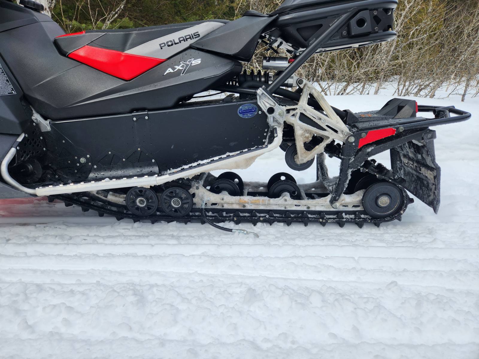

I run the doo double spring scratchers. They throw up way more ice than any cable type and don't ding anything in your sled.  Fold up out of the way and allow reverse.
*If you run where there is exposed gravel it will kick that up...

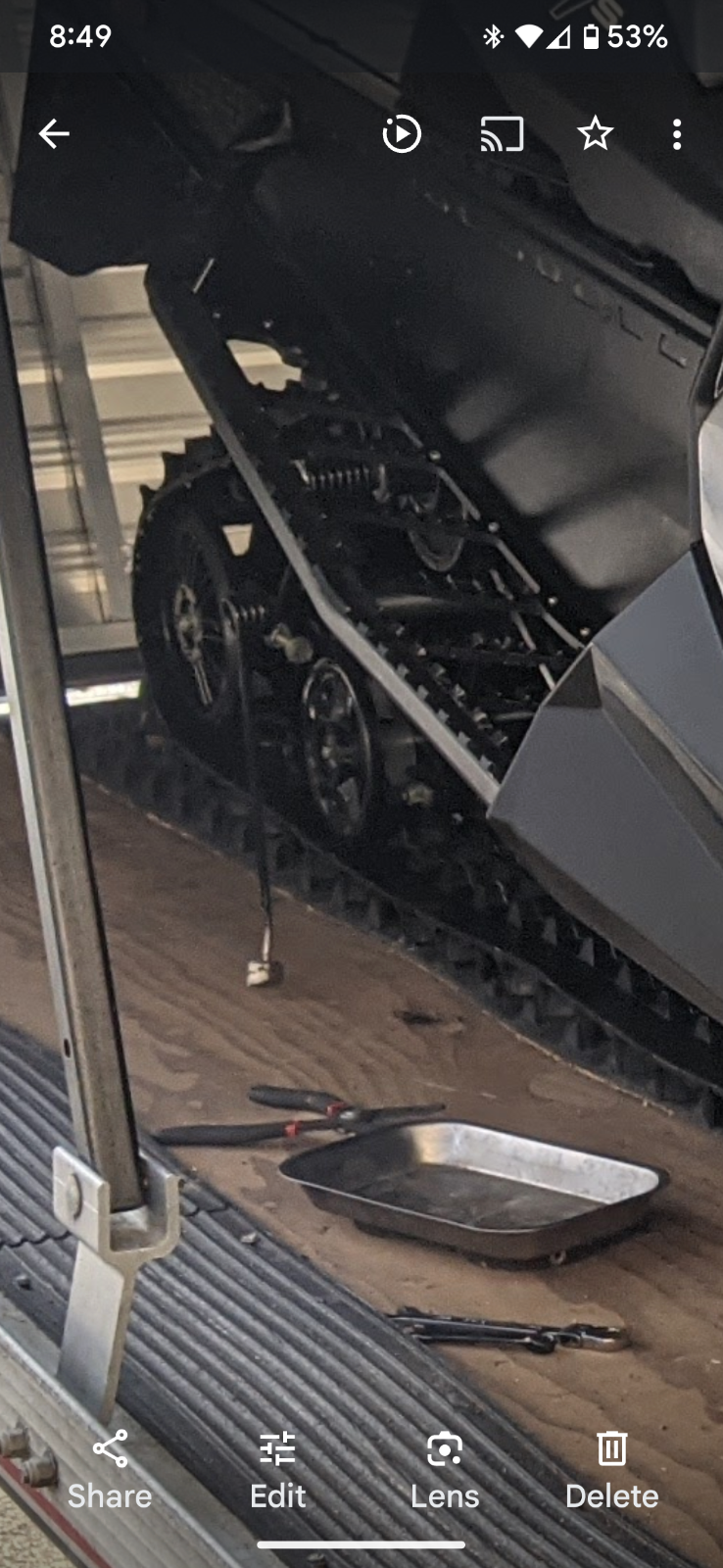

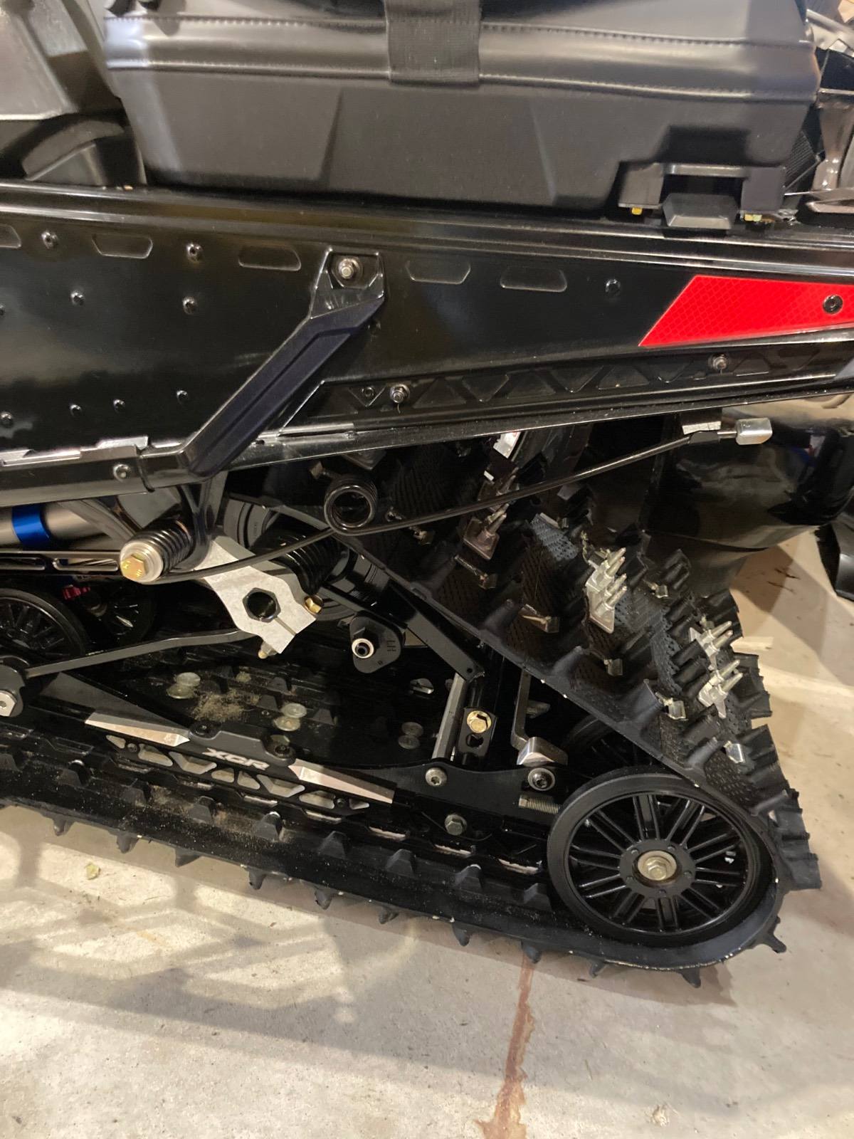

Ski doo tunnel scratchers on my Polaris 136.
Yep.  Those rock.  Exactly what I am running.  Last forever and out of the way.  Best option by far imo.
Do you have a pic of the deployed?
You do have to drill a 1/4" or so hole in the sheetmetal as a stopper but it is super easy, non-visible and in a spot where I am not concerned about weakening the structure

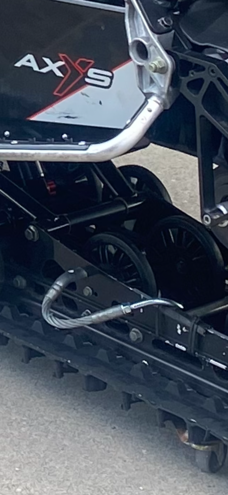

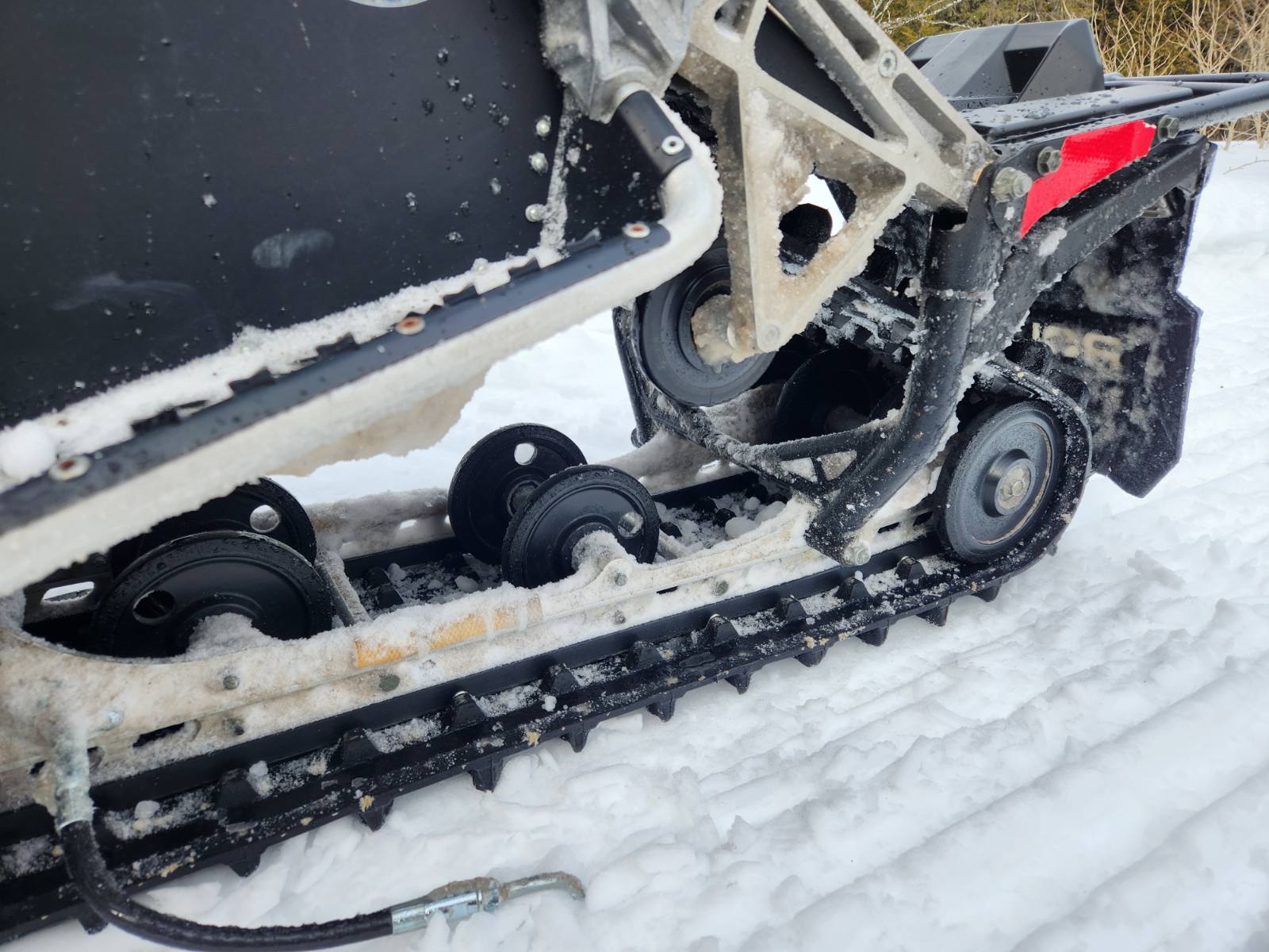

I currently run Qualipieces Trailbizzers with the One Rig Design no-drill mounts.  I still have to figure out something that keeps them "up", they don't want to stay hooked on the rail with the hose I had on there for protection.
Some guys in my club run those as well - they have hooks that are bolted to one of the wheel or cross member bolts, depending on which skid you have.
And yeah, they will get knocked off the rail in rougher trails.  I just zip tie them up until I need them.

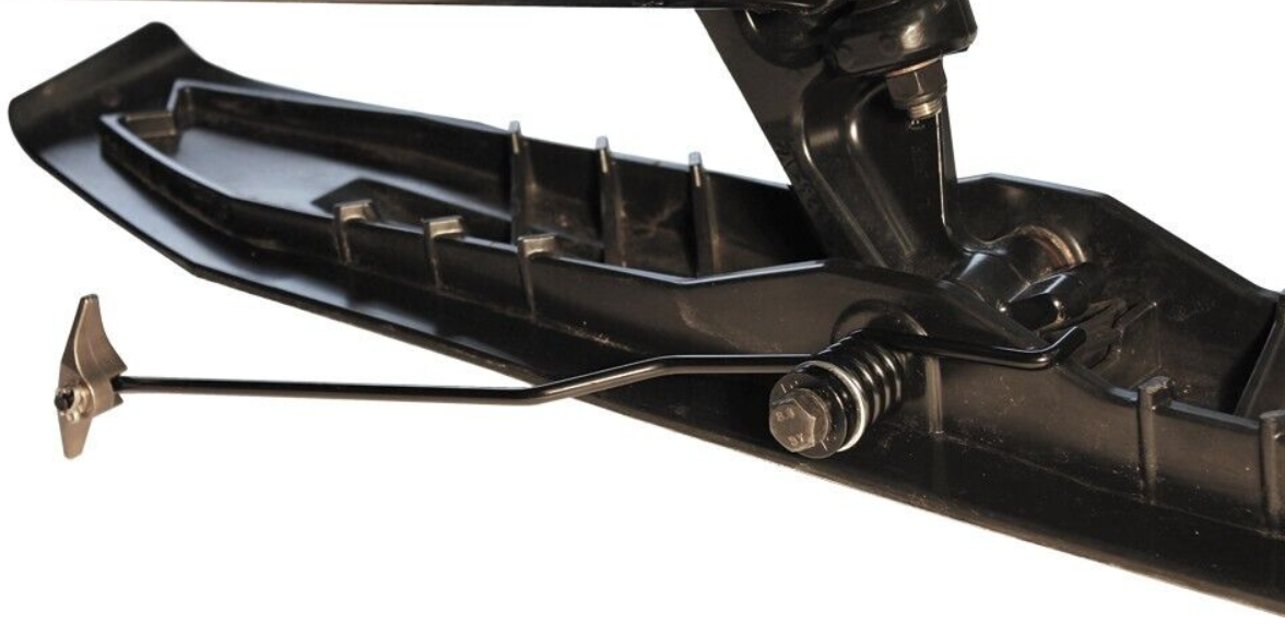

Yes, I do.  Currently running the Ski Doo rail mount scratchers but looking to swap them to the new style before the season.  We are out early on Friday and Saturday morning so the trails are really set up, especially after they groom.  Spring riding you may be parked until noon if it gets above freezing during the day and freezes hard overnight.  Just not worth the risk.
Rail Ice Scratchers 860202330 - Snowmobile | Ski-Doo - USA
