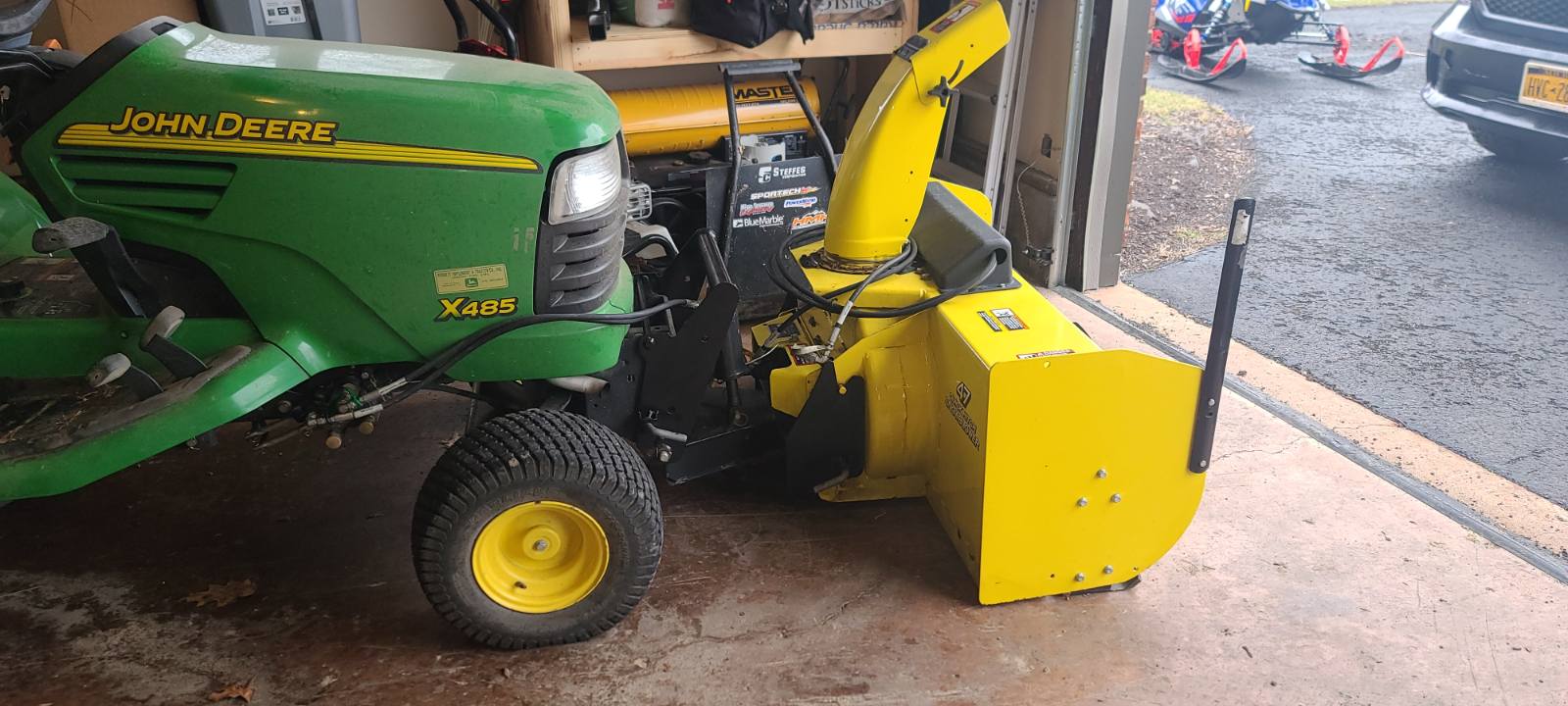

Any of you guys John Deere guys?  I got the tractor (X485) and the 47 inch blower but its used and came with the wrong size drive shaft. The correct part # I need from JD is BM25304 which is a drive shaft AND front end kit to stabilize it as it passes through the steering arm. I cannot find out the part # for that stabilizing kit. The local dealer isn't an option as the reason I want the part # is to find something cheaper online.
Anyone got any ideas?

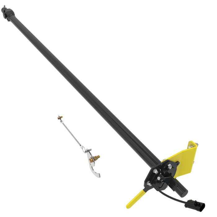

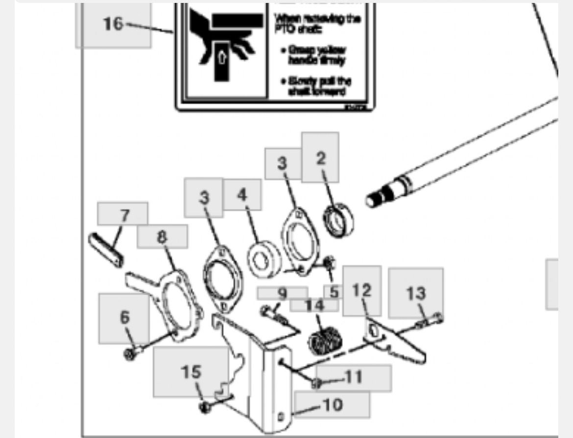

As I understand it I need the entire kit you show as BM25304 is the drive shaft and the kit you posted. I cant find the axel alone on Ebay. The price my local dealer quoted for BM25304 was 450$. I know thats inline with most dealers but still.
So you just want the driveshaft without the attaching hardware? If so, part # AM145723 is what you need. But it’s $868.64. You can buy the whole kit for $456.89. So I’d buy the kit!
Edited by Dieselgeek
1 minute ago, Dieselgeek said:
So you just want the driveshaft without the attaching hardware? If so, you are correct, can only order the complete kit. $456.89.
I was hoping to find the mounting kit sold separately. From what your saying thats not an option?

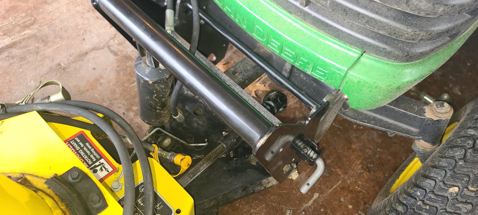

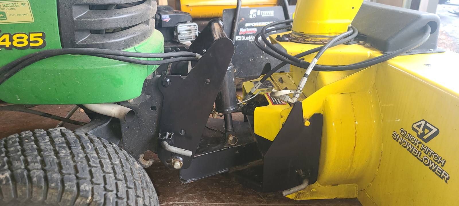

So is the driveshaft incorrect? Is the blower from a 4wd machine? You can piece together parts if needed, but often cheaper to buy the whole kit. I can help find the part #’s for the brackets, bolts, etc, but need to know exactly what isn’t correct. Looking for the yellow bracket in the picture?
@Dieselgeek
The drive shaft that came with the blower (used) is too short. The drive shaft kit (BM25304) is the right piece for my unit. However I have found the shaft alone online and was wondering what the mounting kit would cost.
Edited by Kivalo
I'll have to get pics tomorrow and post them up.

How too short is it?  From the picture it looks as the 'male' end of the shaft is square stock.  Take it off and take it to a welder or machine shop and have them weld a piece on to make it longer or cut it off and weld a whole new length on.  An ag shop would be best, they may have that exact material laying around.
What you're seeing is the snowblower side. The tractor side is longer and has a splined end  with a mounting kit to stabilize it as is goes through the steering linkage. The shaft that came with mine has ujoints at both ends is a solid 18inches too short. I already know the correct part number I need, Im just waiting for confirmation on whether I can buy the mounting kit separate.
