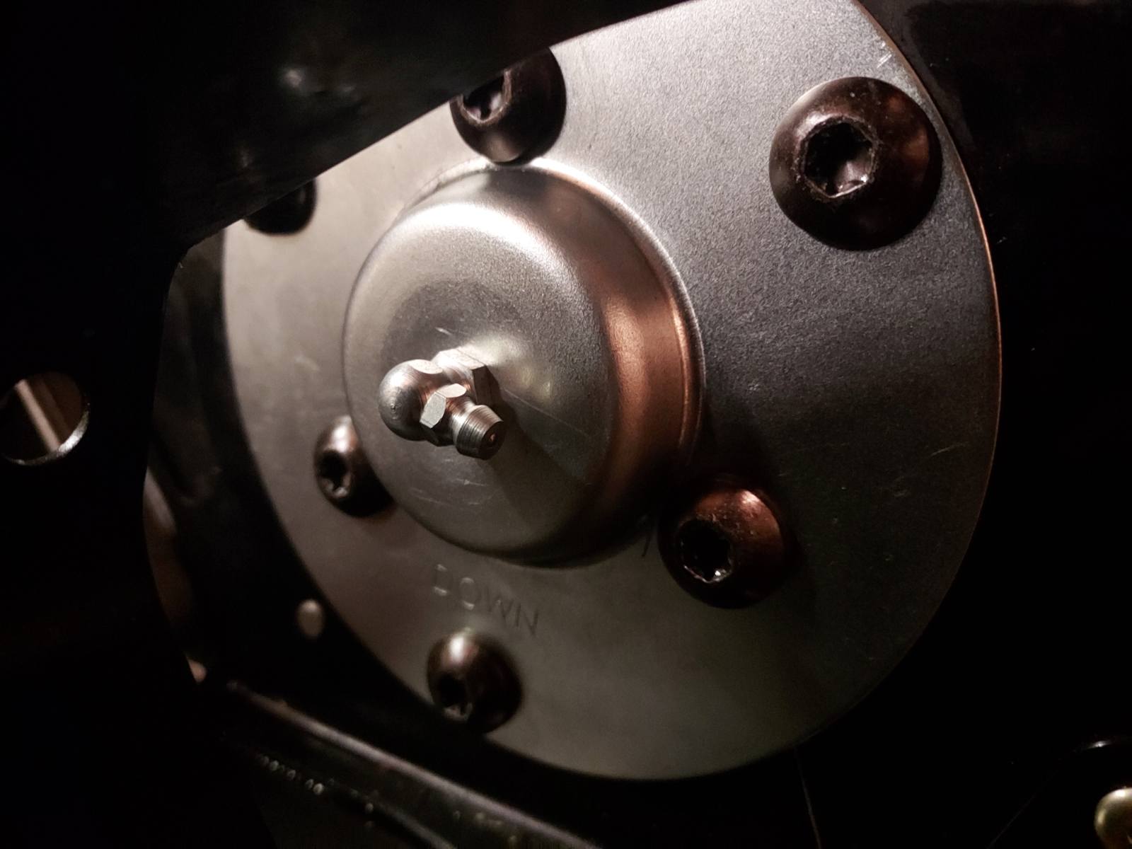

  • It's real easy just to add a zerk to the stock cover. I pull the outer seal off the bearing. Drill a hole in the cover and add a zerk fitting, 1/4-28 nut on the back side of the cover and you are don

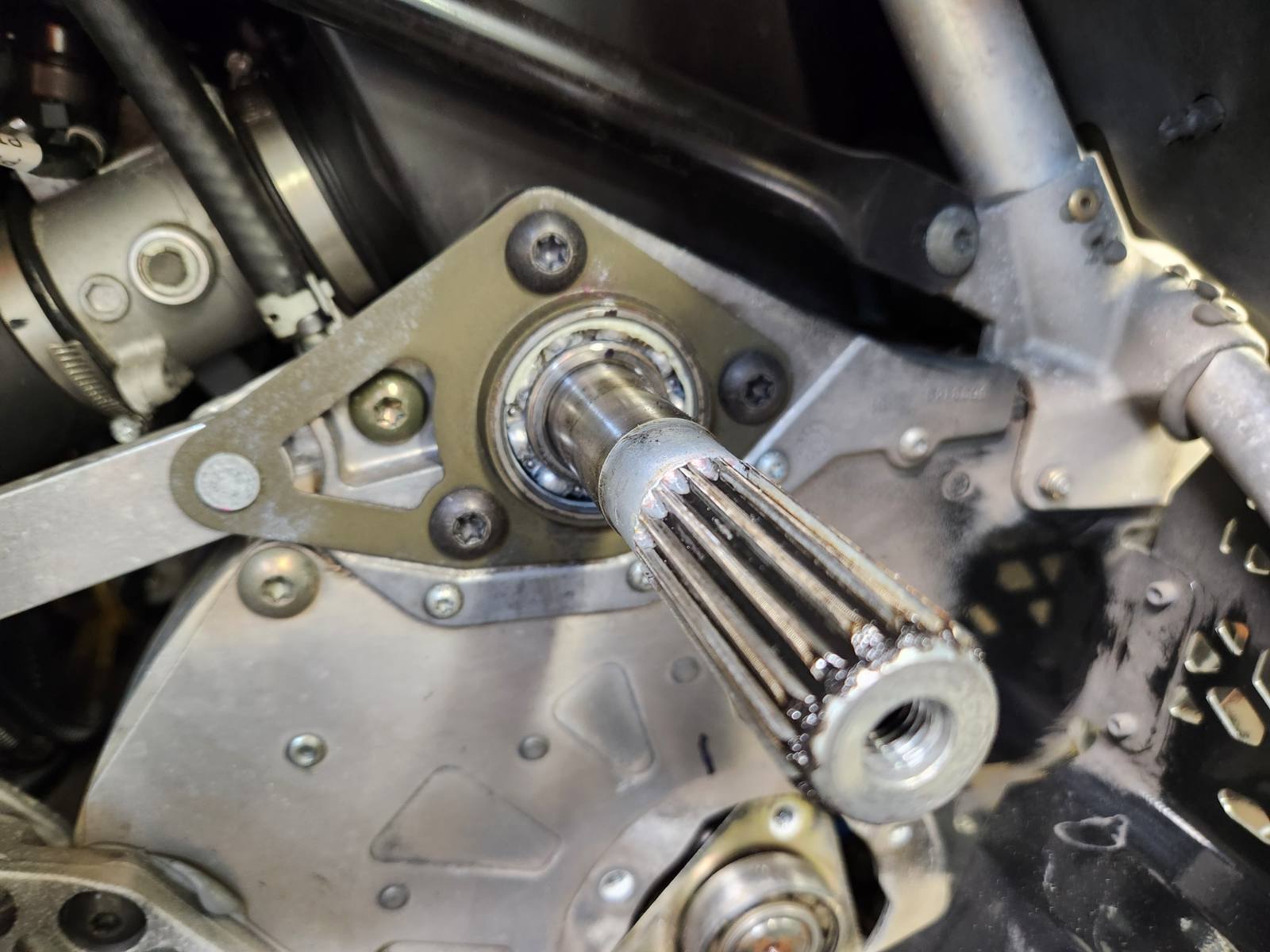

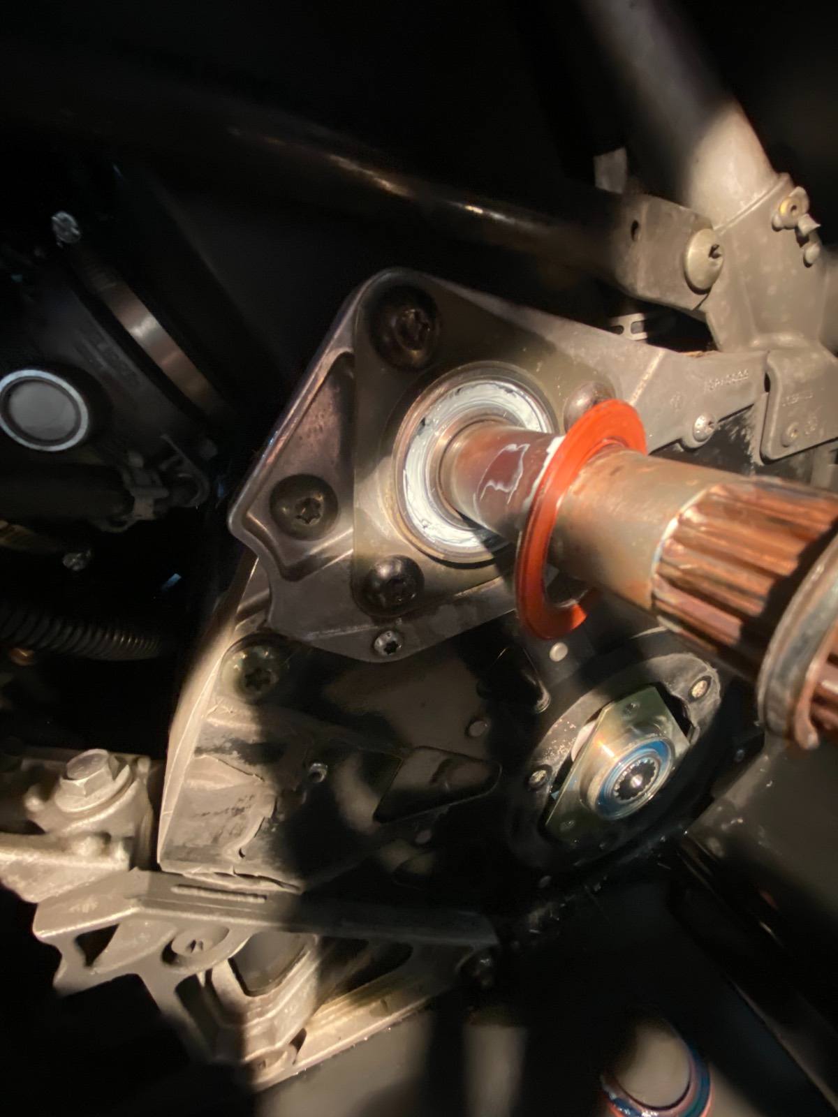

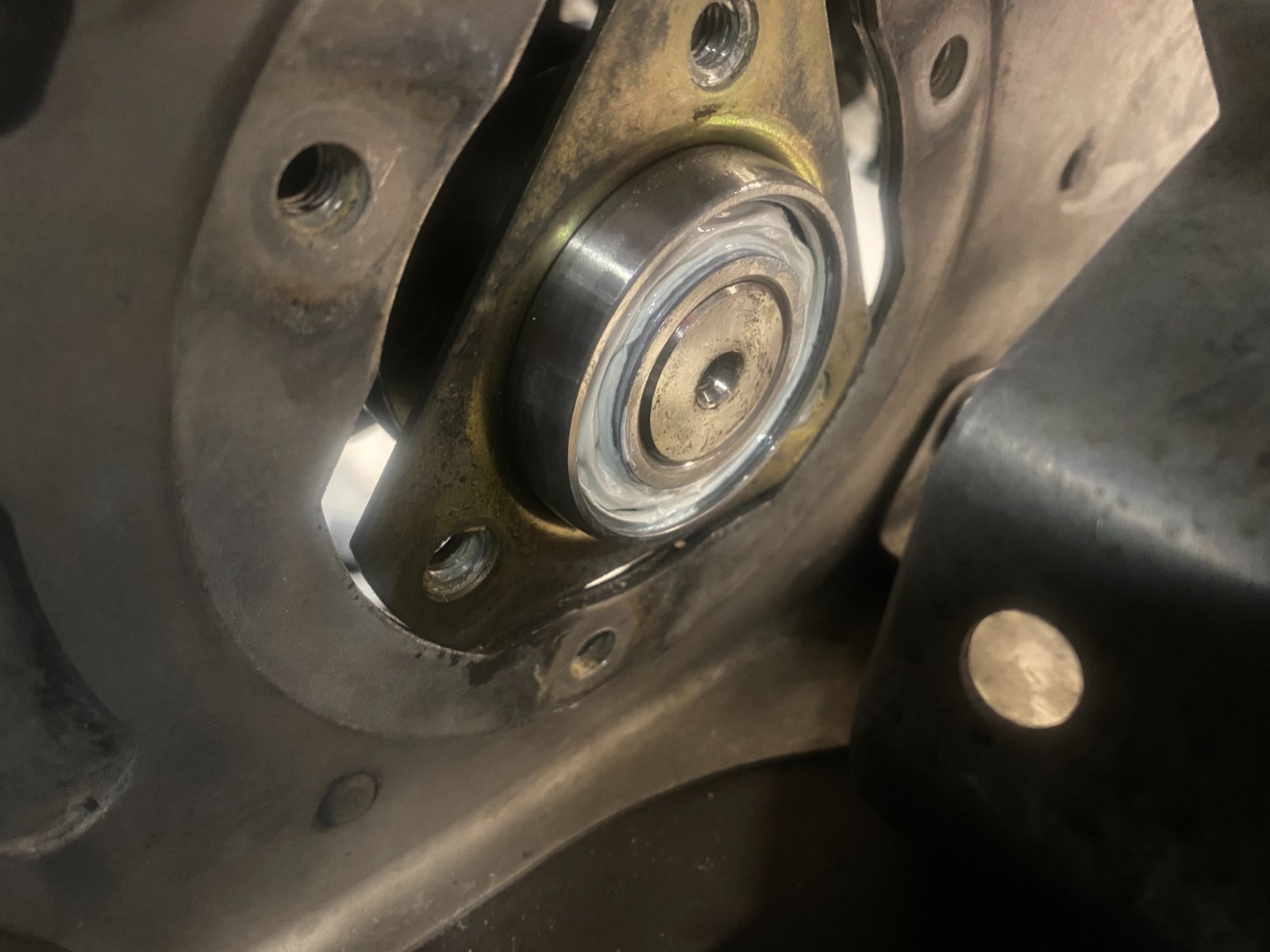

Hear is the amount of grease that is in the jackshaft bearing on a new 2023 sled
Edited by Doug
That is what my '21 looked like - I'll bet you can get quite a bit more in there with a needle grease gun behind that film that was on the seal... Same thing with a new replacement I got under warranty.  Fill 'er up Doug!
Did just that.  The driveshaft bearing was the same.

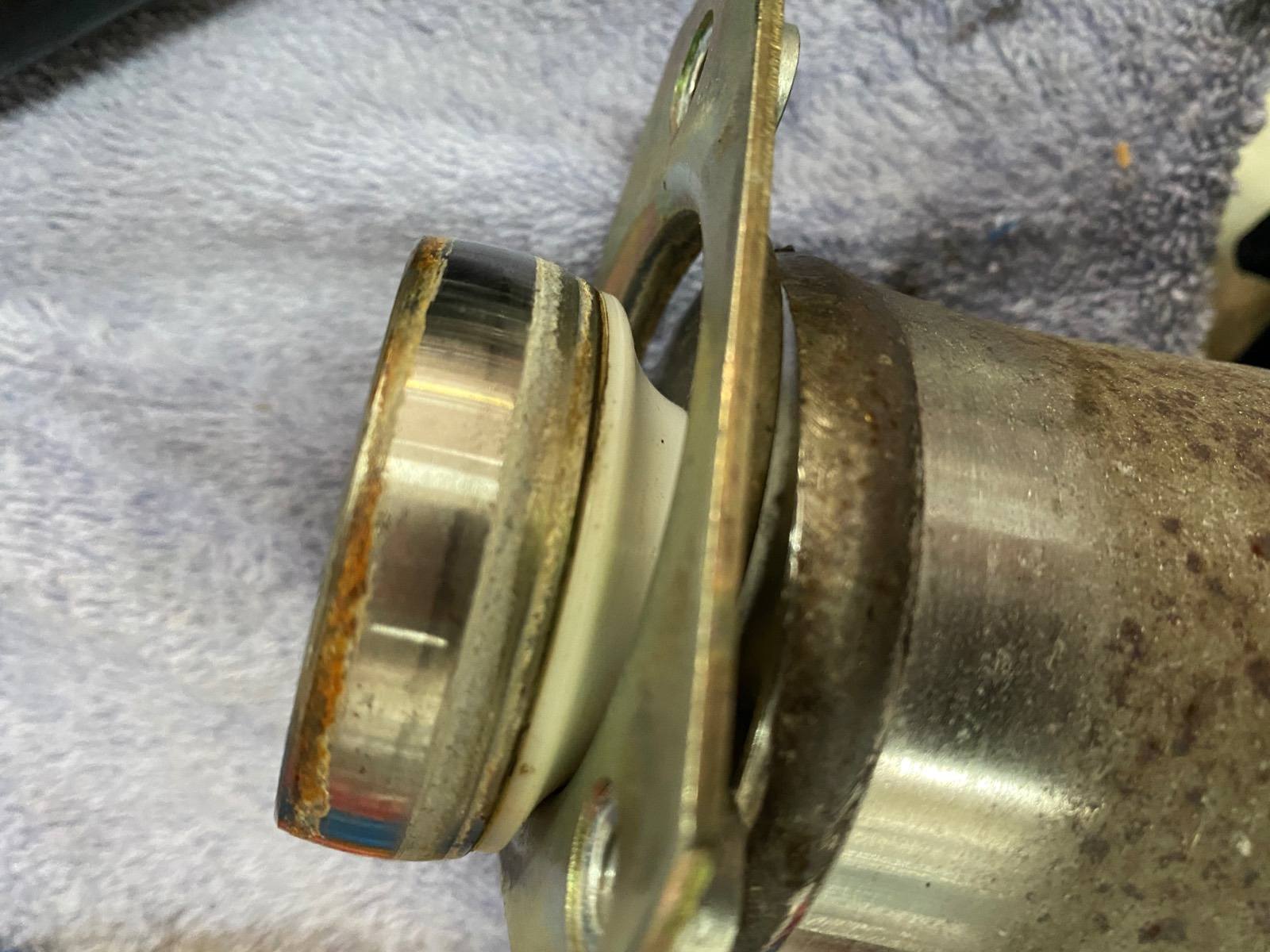

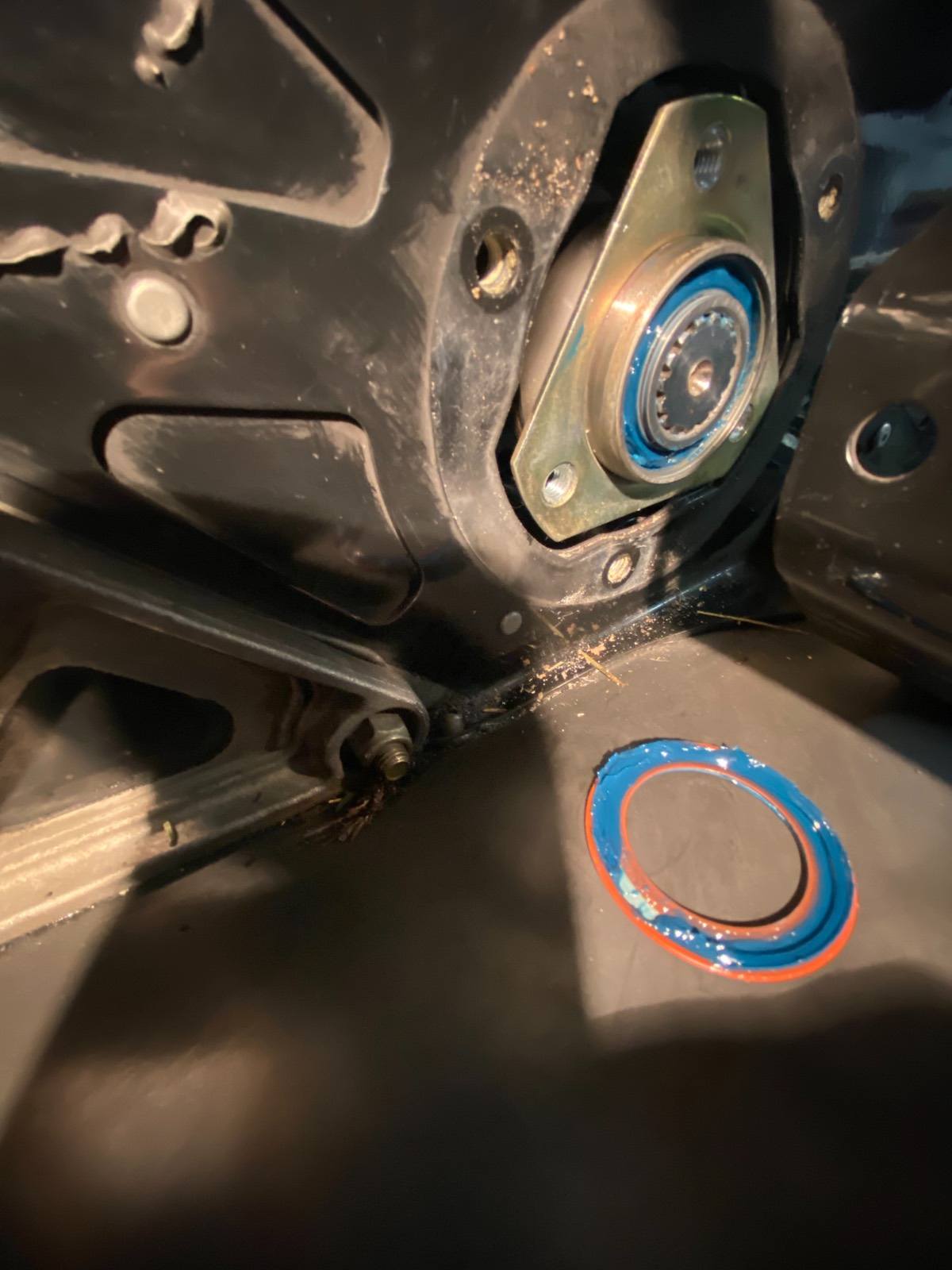

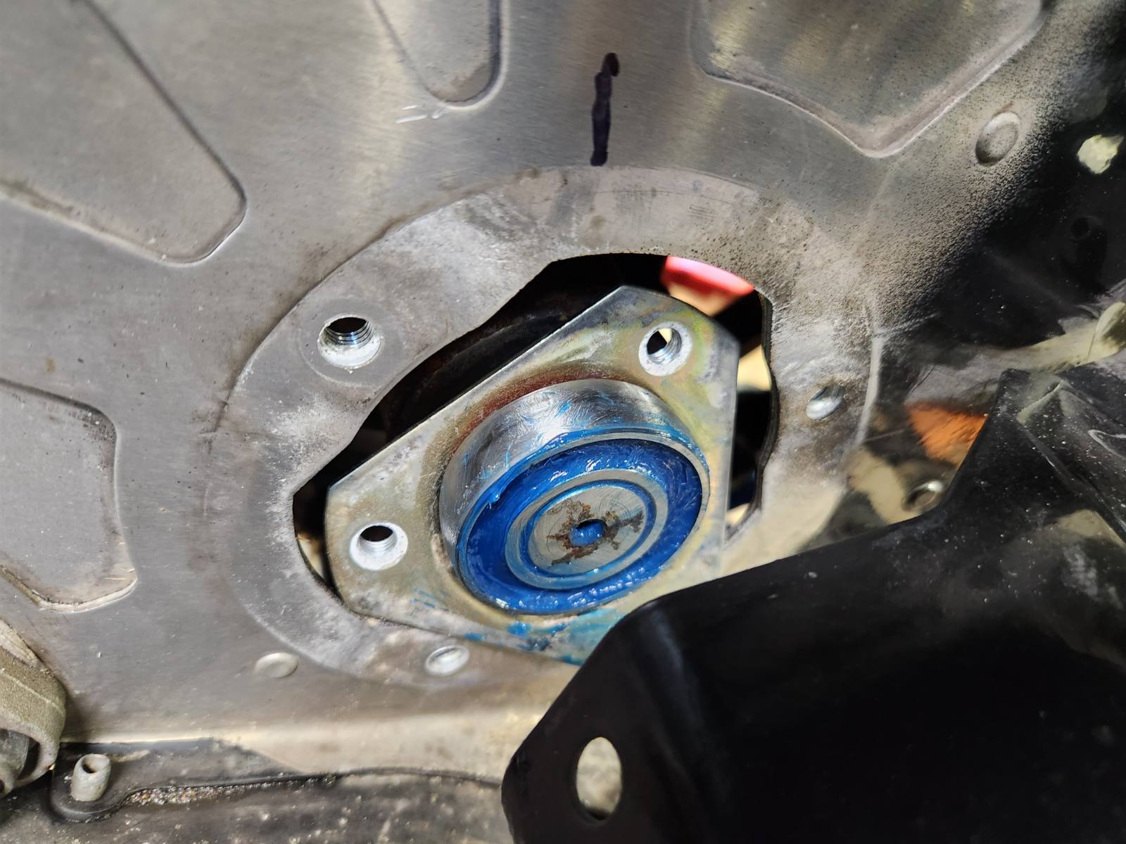

Here's a before and after cleaning and greasing pic of the axle shaft and jackshaft bearing with 4100 miles on a 2020 XCR.
I pull the outer seal off the bearing. Drill a hole in the cover and add a zerk fitting, 1/4-28 nut on the back side of the cover and you are done. This fall I pulled the cover to take a look, bearing full of grease and still good.
When I grease the bearing I just look up inside the tunnel, when I see a little grease starting to ooze out of the seal I stop.
I had the same thing done, and drilled a small weep hole in the cover to let any excess grease out.  As long as you don't hammer the grease in too fast when it's cold, and give the track a couple spins it should be good.

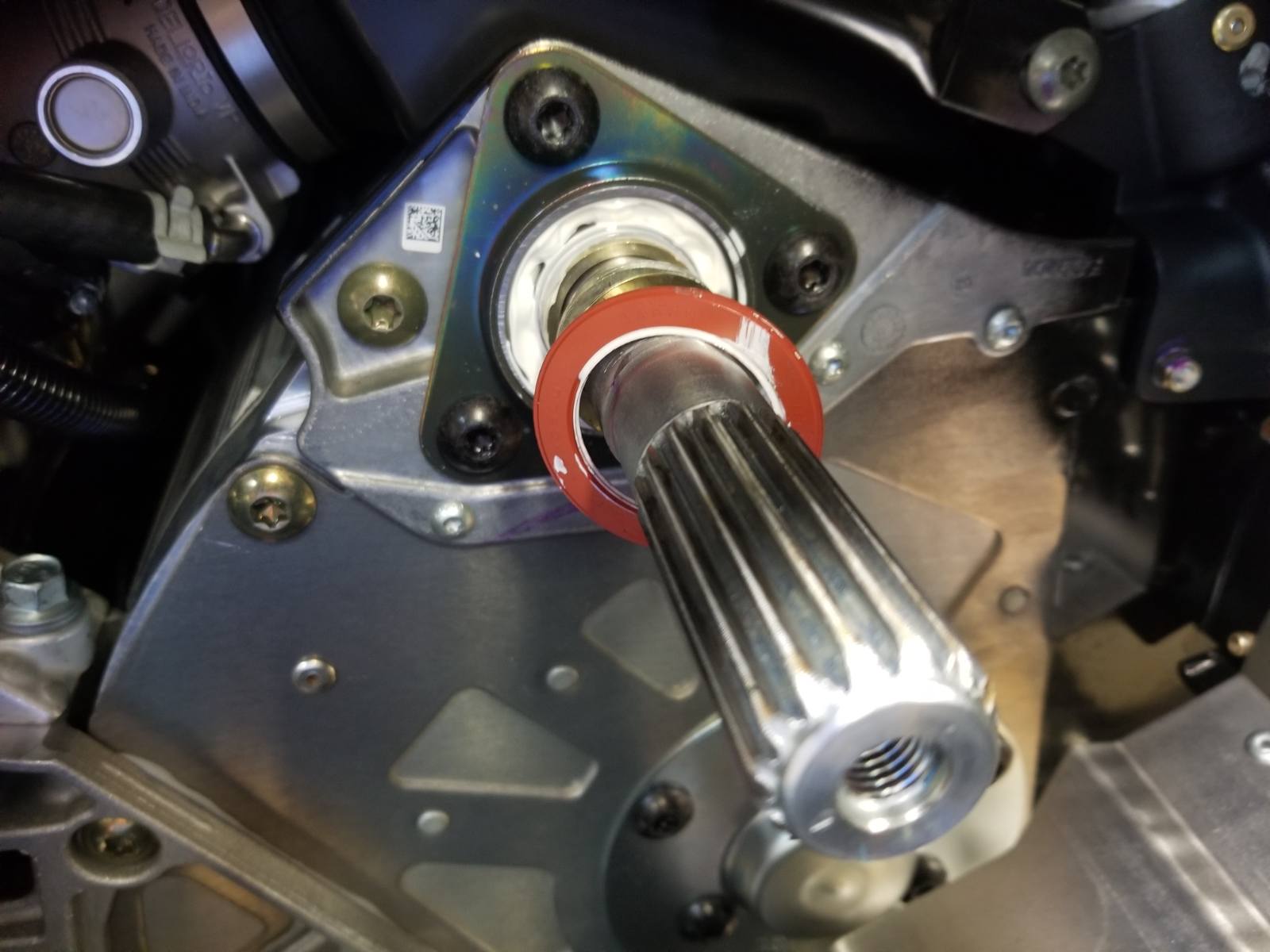

500+ miles on my driveshaft bearing deflector and nothing has moved
  • 4 weeks later...

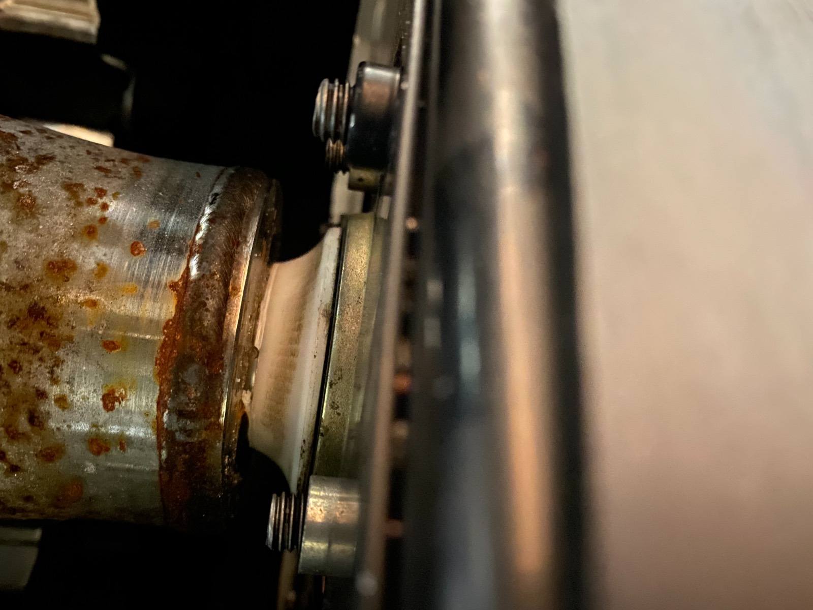

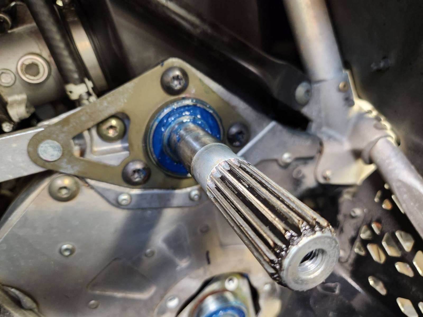

2400 mile report - this bearing deflector is 100% the answer to the drive shaft bearing lasting like the jackshaft bearing with proper grease!  I just added some to this jackshaft bearing when it was new, this driveshaft bearing was packed with the AmsOil @Doug posted above!  I won’t open either one of these the rest of the season… not one drip of water came out when I removed the seal!
1 hour ago, polaris7541 said:
been using Lucas marine myself  ,, the green stuff , so far so good
I've got about 1500 miles for the year and haven't checked mine yet.  @Mag6240you've got a good desgin to keep the water out.  Not even any discolor of the grease 👍
@polaris7541A good marine grease will work fine.  Any grease to that's application is to be water resistant will be good.
This is without question the best that drive shaft bearing has ever looked at any 2400 mile check in well over 30k miles I have put on Axys sleds that I have owned.

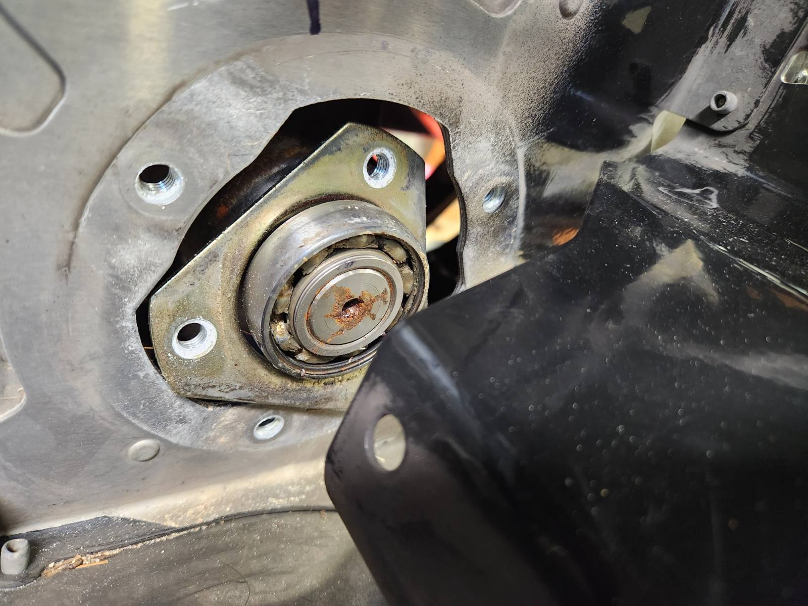

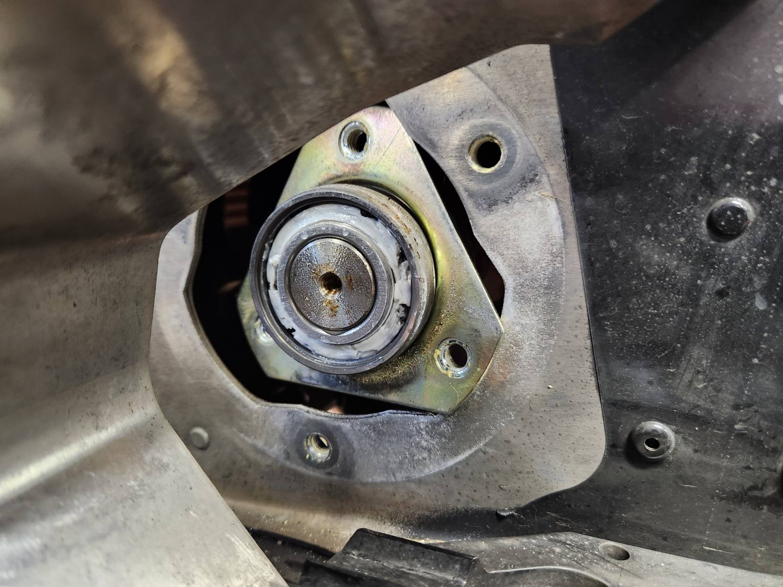

Here's an axle bearing at 1400 miles.  Not bad but will get cleaned and regreased

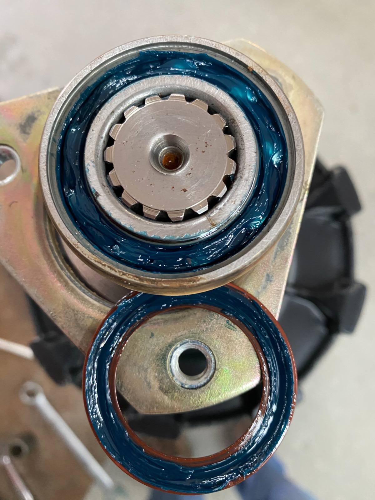

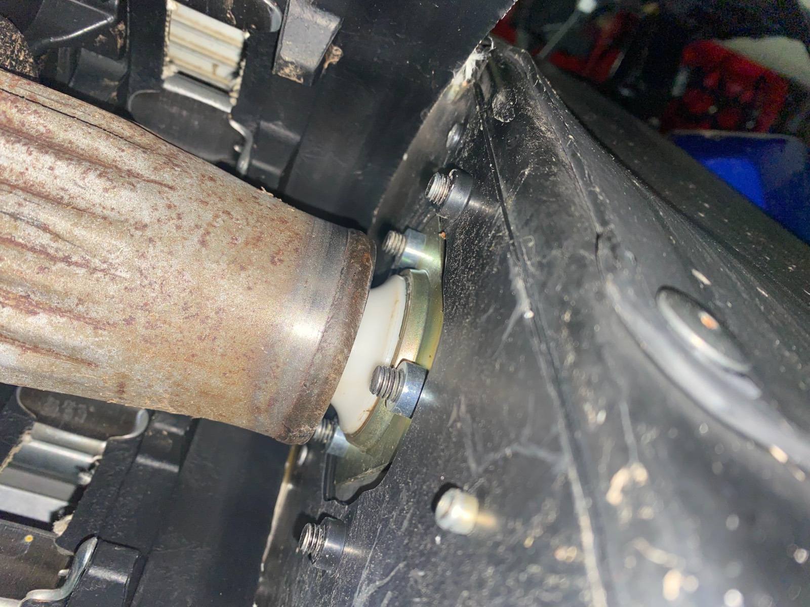

I put a new bearing on this driveshaft on my 2016 Pro-S last summer, with a modified jackshaft bearing deflector, and left what looked like a good amount of factory white grease in it - my son put 1100+ on it, looks perfect!  Didn’t even bother cleaning this one, just popped the seal back on.
That's a great idea you came up with.  Grease isn't even discolored so there's no moisture getting in there. 👍

This is my 2021 with almost 6000 miles this season after cleaning and filling with AmsOil waterproof grease last spring.
