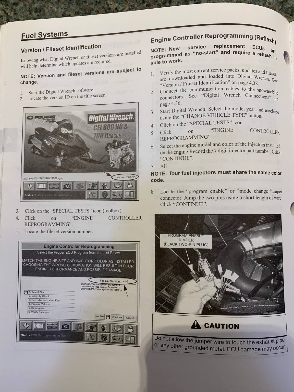

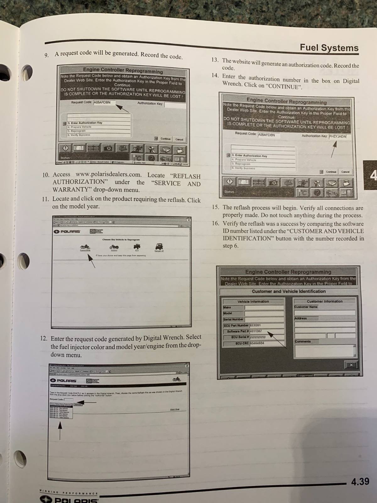

Just got home from riding.  I know back in 2009 we have a 08 700 with a bad ECU and took the ECU off a wrecked 07 600 and refreshed it with the Polaris digital wrench for a 700.  If I remember correctly there's a series of basic questions such as motor and injector colors you had to answer before you could reflash it.  I'll dig around to see if I have some notes yet tomorrow.
Tommy dug up some notes but not sure if this is going to answer your question as I used the Polaris digital wrench which would actually pull the reflash from the Polaris dealer portal.  If its a new ECU you need to initialize it which copies the model ID from the original ECU before it can be flashed.  When we took the used one from the crashed sled there is a section where you can "Change vehicle type".  With in this section you then select the model which will then bring up a list of the injector colors and the latest reflash for each with an associated P/n for the correct flash.  You then select that continue on with authorization code from the dealer portal to continue on.
It's been a while so I can't remember looking at the p/n's your reference on the top and side. The 600, 700, 800 motors did use the same ECU with difference flashes.  If you can find the same model 600 with the same injector color it should work.  I think 2009 or 2010 was the last year they used the 4 injector setup.
