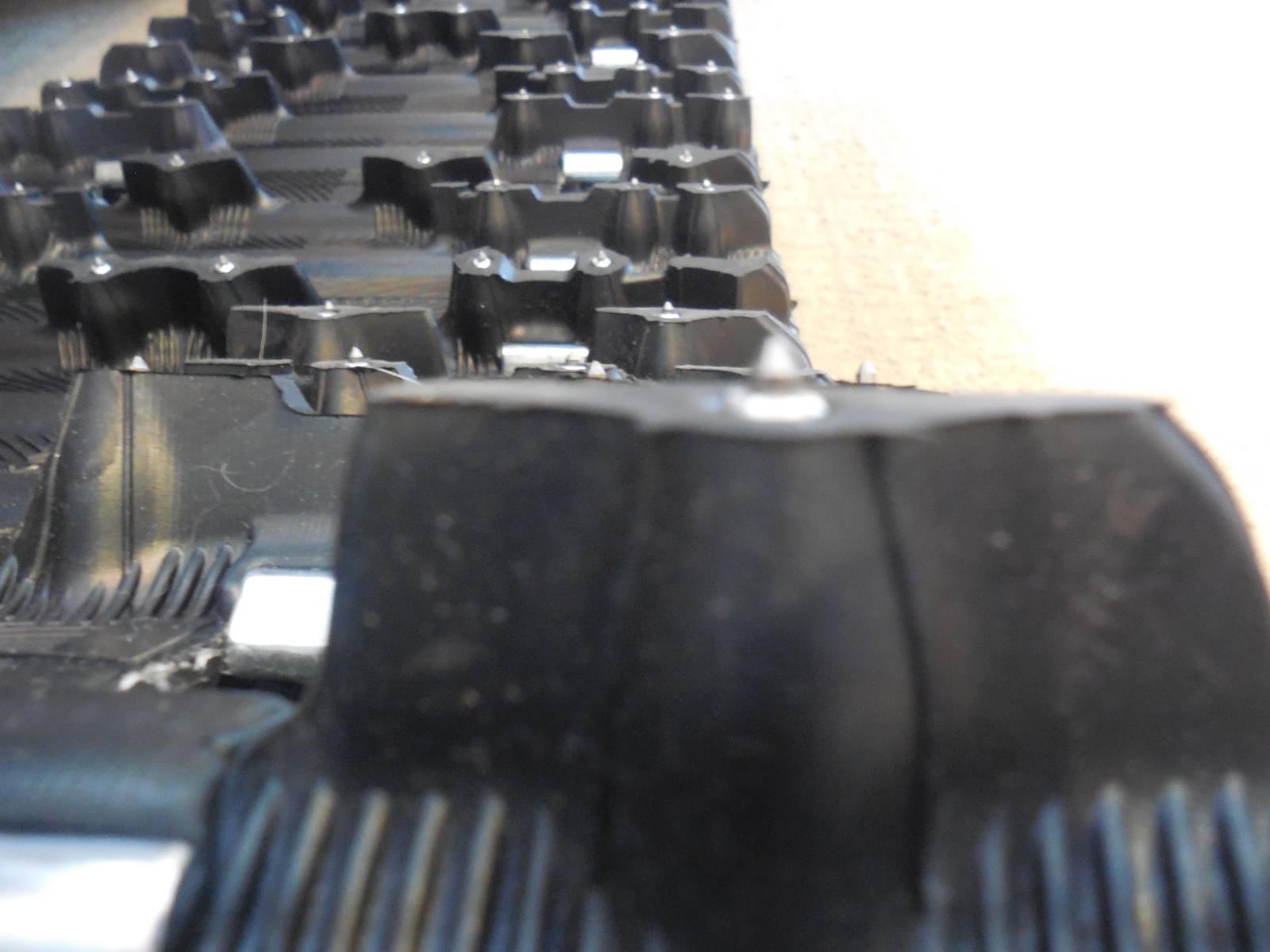

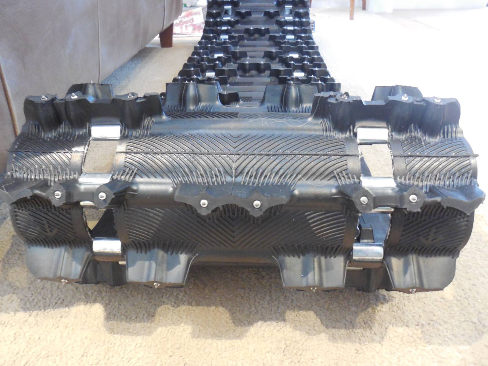

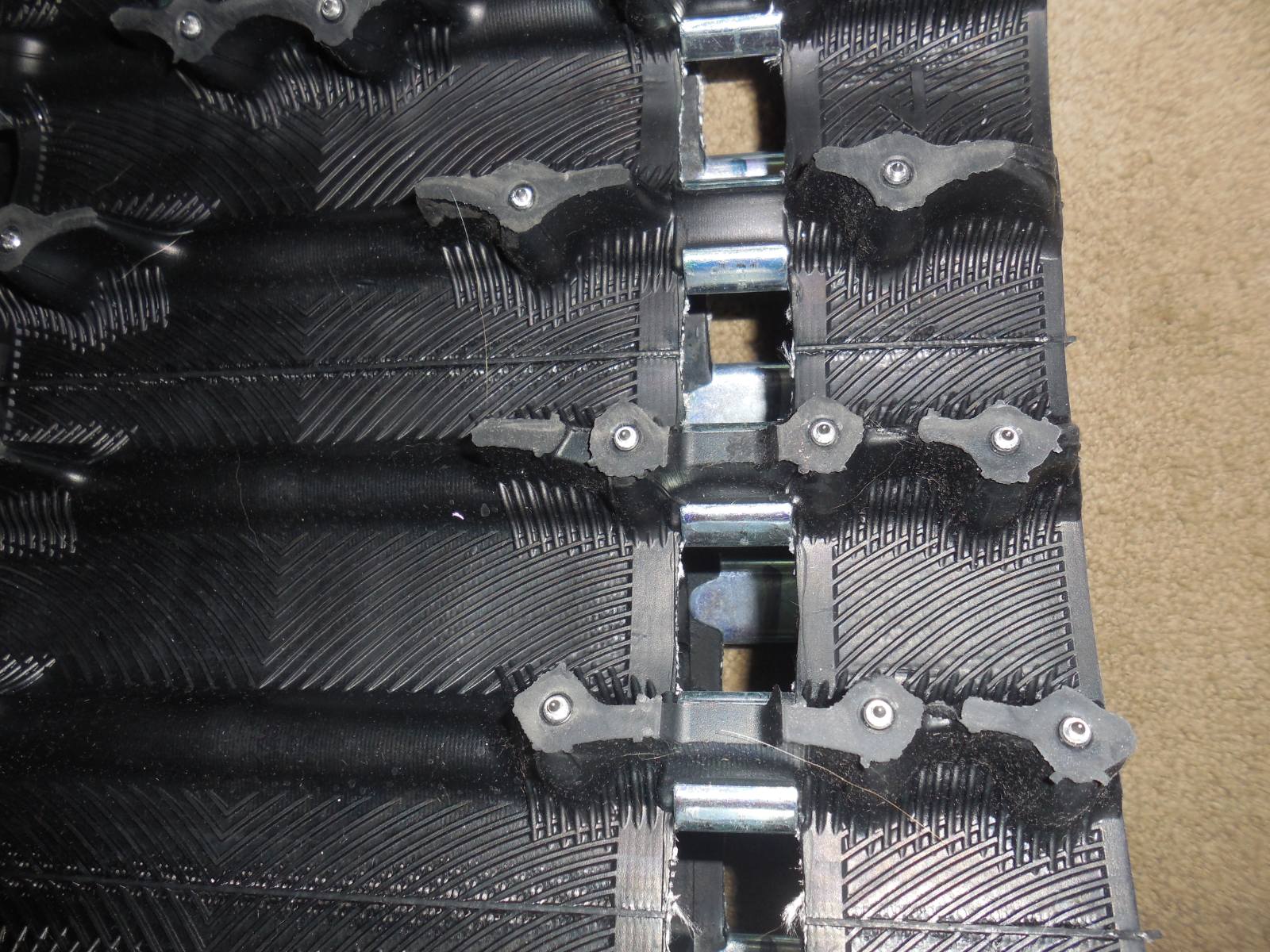

Decided to give the 9201H Camso Ice Attak XT 128/15/1.22" 2.52P a try.   single ply, fully clipped 42lbs and 272 sharp little pins.
Multiple track lengths available.  https://camso.co/en/powersports/snowmobile/products/ice-attak-xt/
Lugs are stout, track looks better far in person than it does on the Camso site.  Sled is also getting DuPont Vespel slides and ice scratchers.
Will report back and directly compare the good/bad to a studded Cobra 1.3 on a nearly identical sled once I get this other machine back up and running.  Both sleds are ridden 99.9% on groomed trails so the basis of my expectations will be based upon that.  Sort've excited, haven't bought a brand new track in ages.
