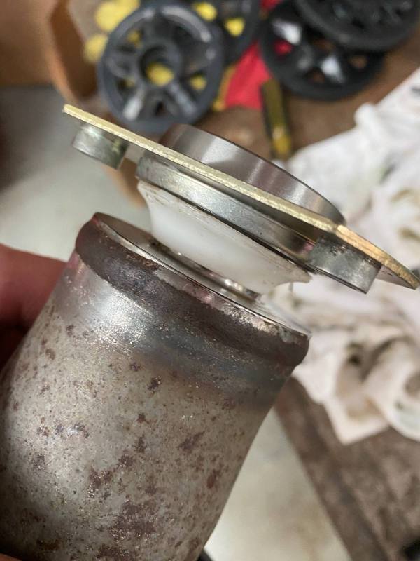

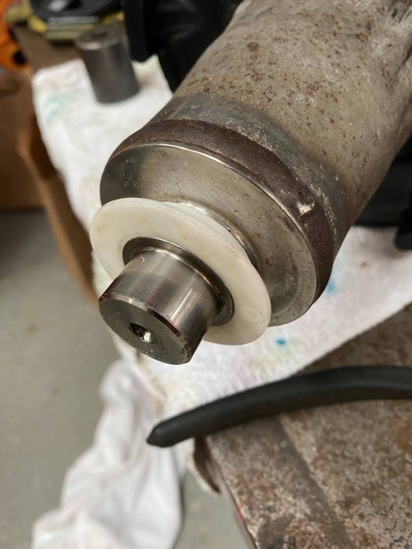

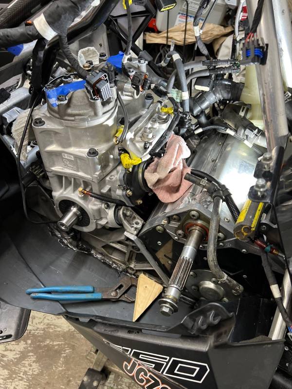

  • Yep this is a 19 850.it was rebuilt by Polaris at 6500 miles.It had bad rod bearing at that time.everything top to bottom was replaced minus cases.which I pushed for but Polaris wouldn’t cover. i

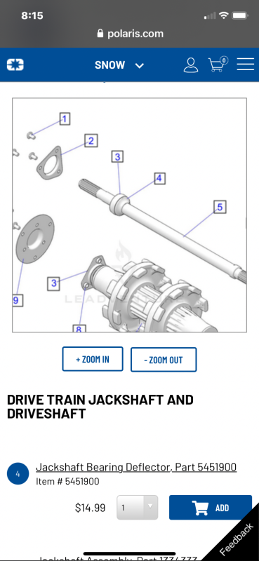

Be a little leary of a 2019 850.  That's the first year 850 and the PTO bearing was not retaind with a retailing ring and some sealant covered some oil ports for the crank bearing.  If the sled has the original lower end I'd shy away.

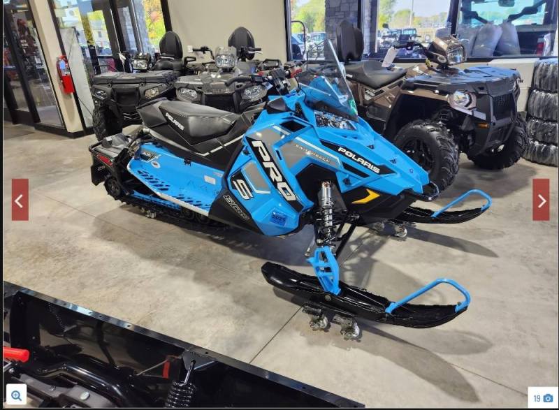

just did a little FB marketplace scan, not much listed f/s atm.
if you don't care about the XCR decals or the XCR brake you could probably just find an 800 XC 129 or 137 reasonable, then upgrade the springs, revalve the shocks and call it a day.  they raced the XC the first year it came out in the Indy chassis as the XCR didn't come along until the following model year.  there was also an over structure upgrade to aluminum tubing rather than carbon and a few venting mods to make them run cooler so if you go that route just tag me and I'll dig them up for you.

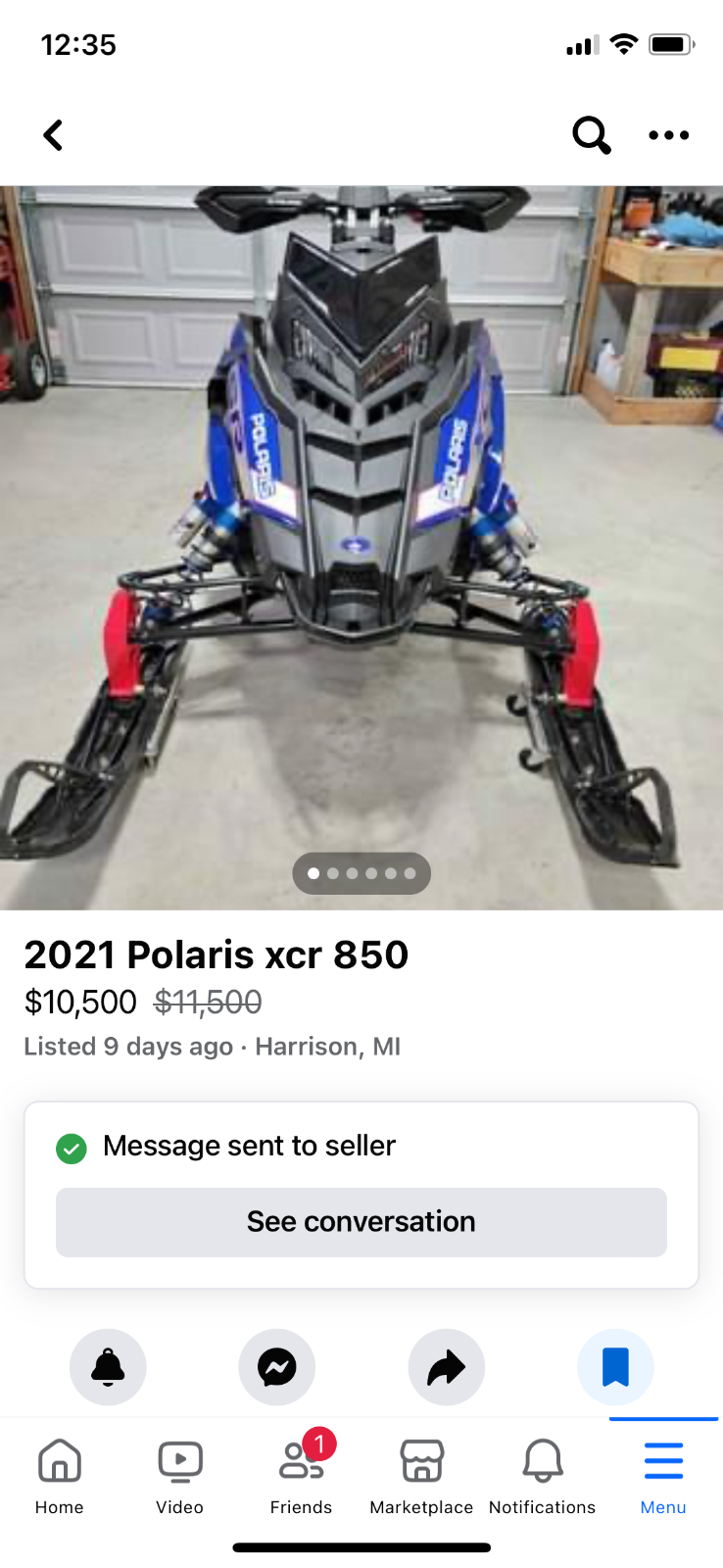

Thinking hard….IMG_4038.thumb.png.e502e0daa22f5cec26656670d6cc5d62.pngIMG_4039.thumb.png.4577ff00473cd149332626354ee9dd67.png
there ya go...

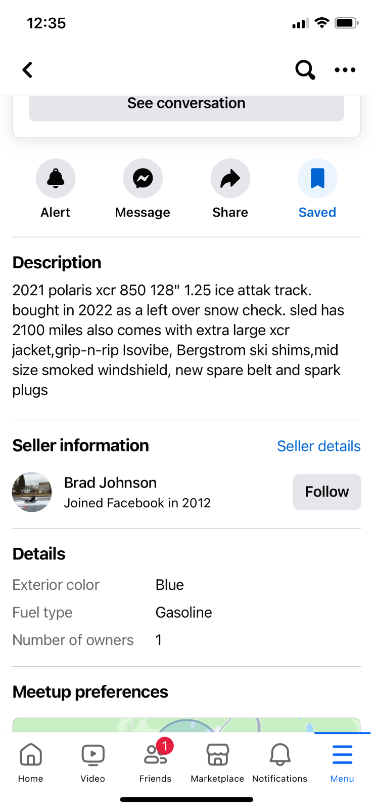

$10,500 with 2100 miles for an XCR 128?  That's a pretty decent deal.
