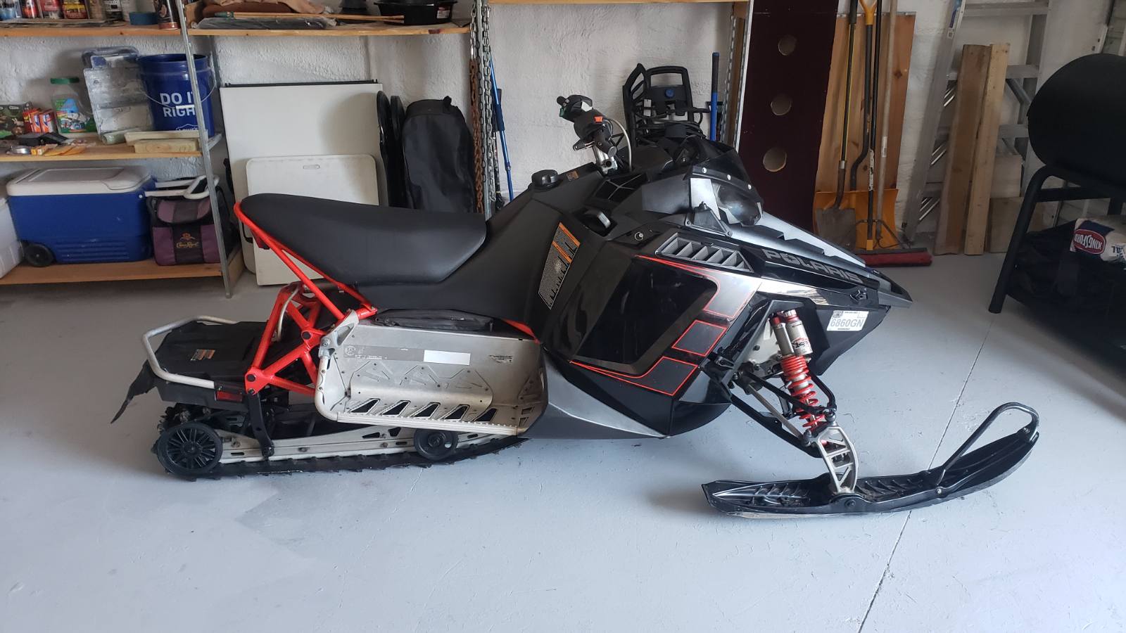

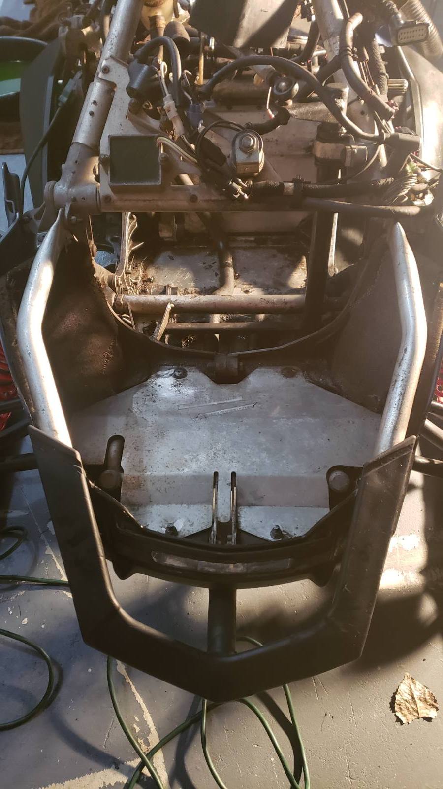

Figured id just start a thread as I'm familiar with the Yammies and Cats, and a little Doo but no so much Poo.  I picked up a Rush 600. Its in good shape overall and has cleaned up nice, ill add red handgaurds, red slides, higher windscreen, new 6" carbides, ext ext. Machine needs a bogie replaced, tie rods on both sides, missing a body pin or two and ill freshen up the motor and go through the entire chassis. Might need another odd and end here or there but its solid.
I do however have a question regarding the 120 rails, that seem to have been updated immediatly in 2011. My stock 120s are worn, not broke or cracked, and I might just repair them with some fabrication, but just so I know, if I bought 121 rails do I need a new 121  track? Will the 120 fit? My gut tells me no, but not sure. And I can't tell if these are the stock skis. Anyone know if they are?

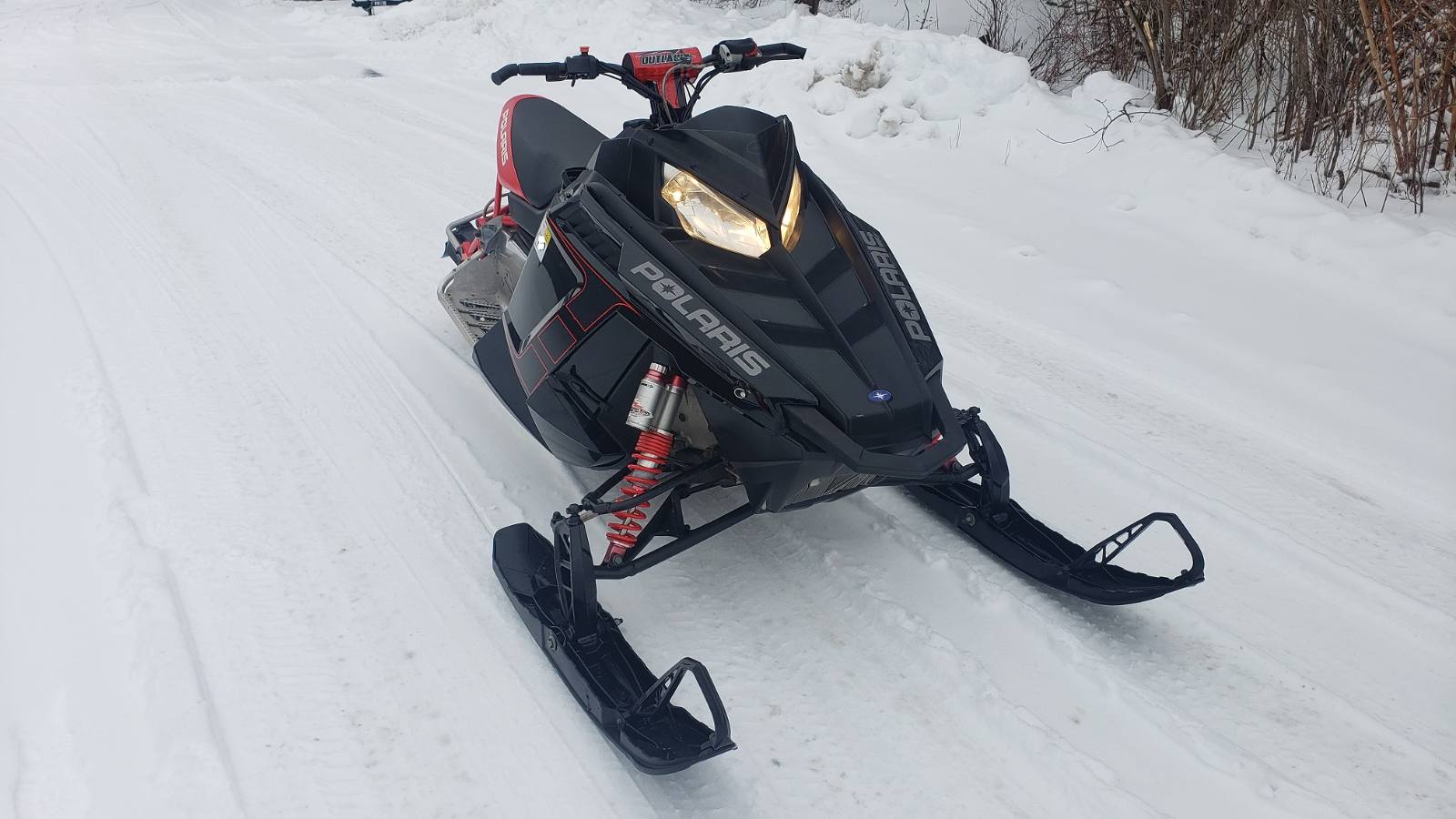

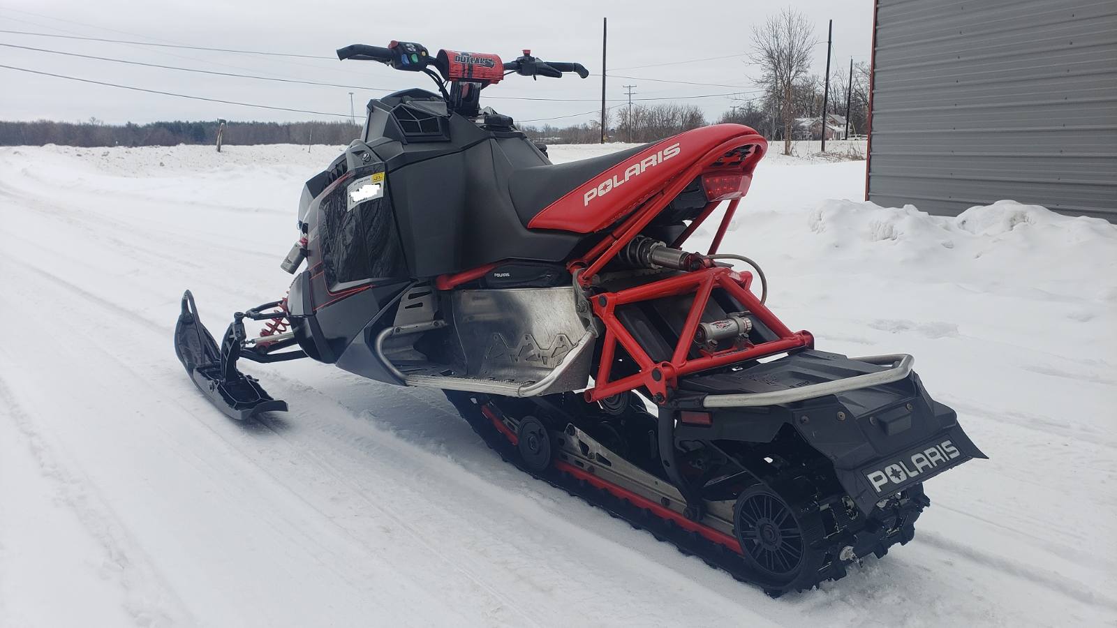

    Project 99% complete, just needs a proper windshield. Steering column done in black to look better, nicer factory polaris seat cover and the frogzskins on the front. Sled is tight and right, fires

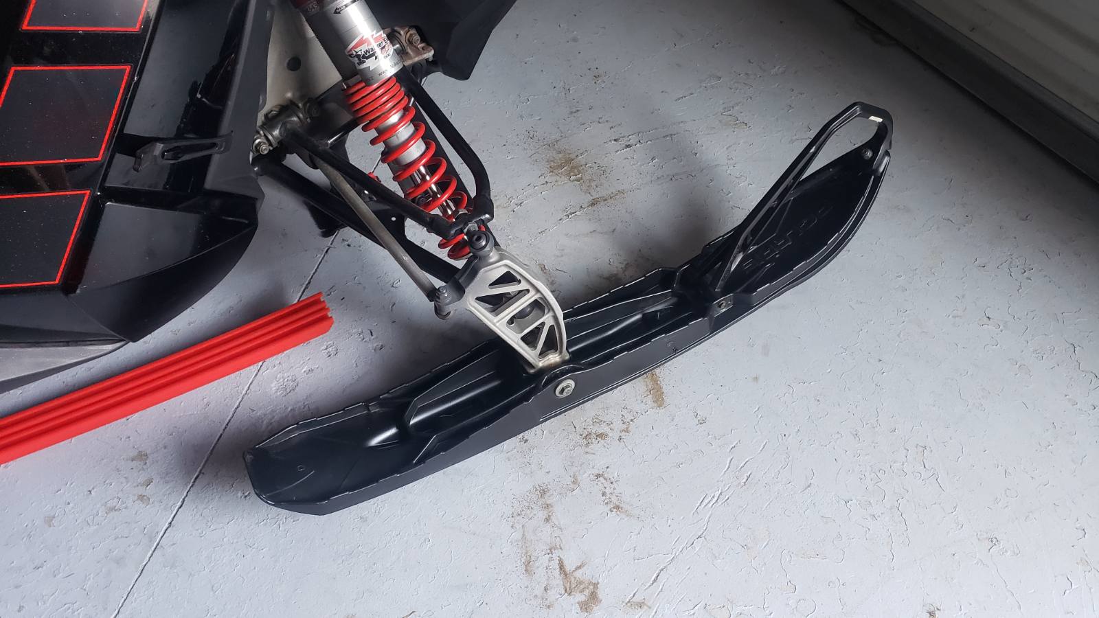

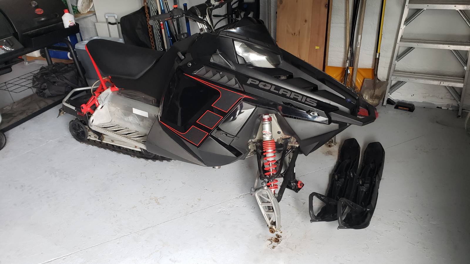

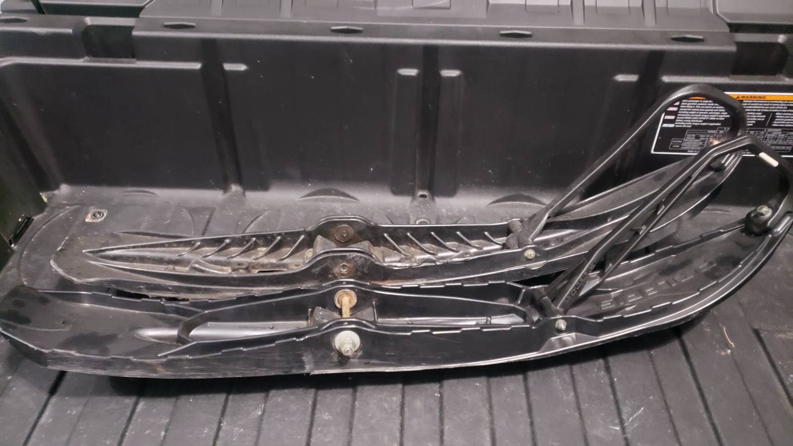

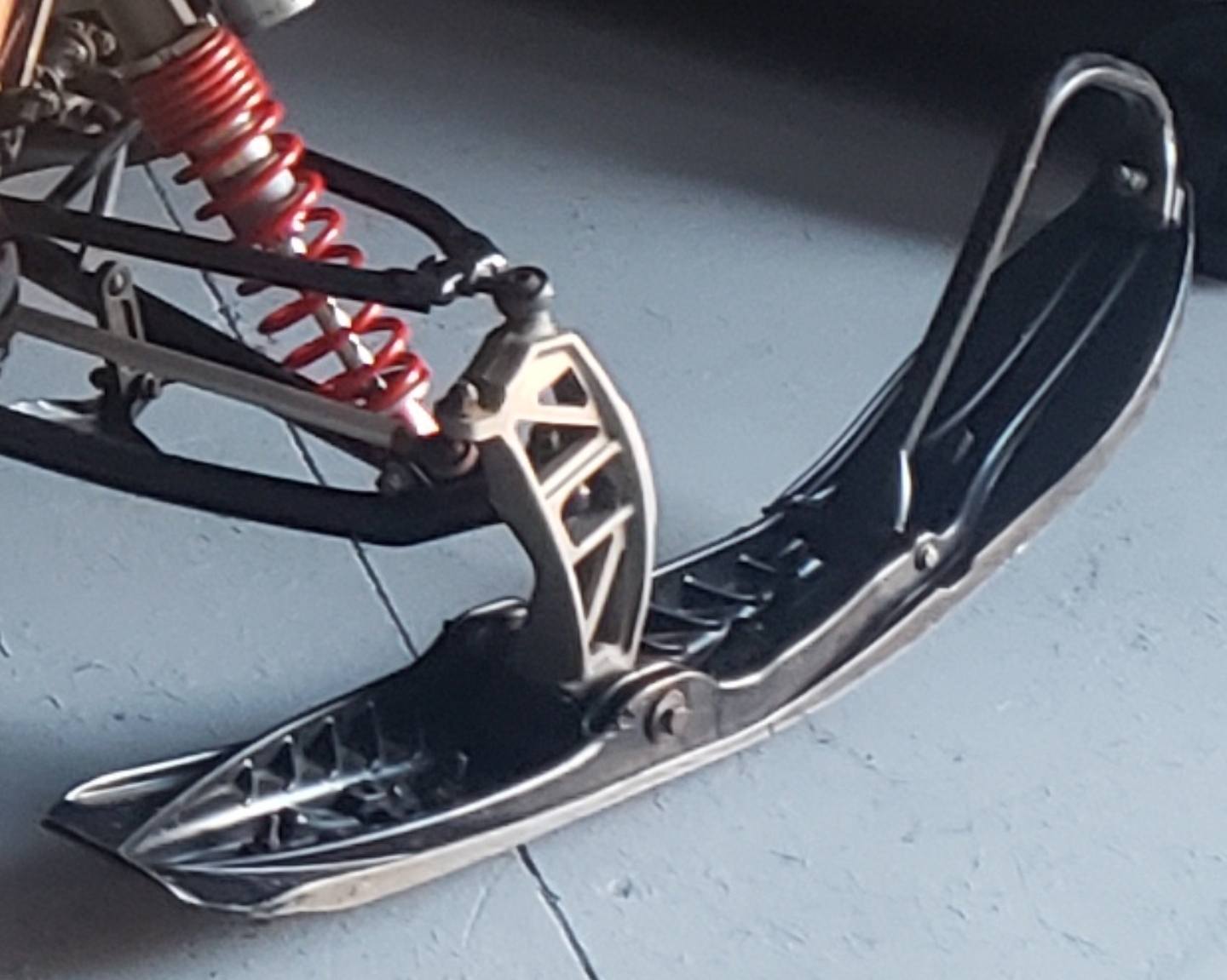

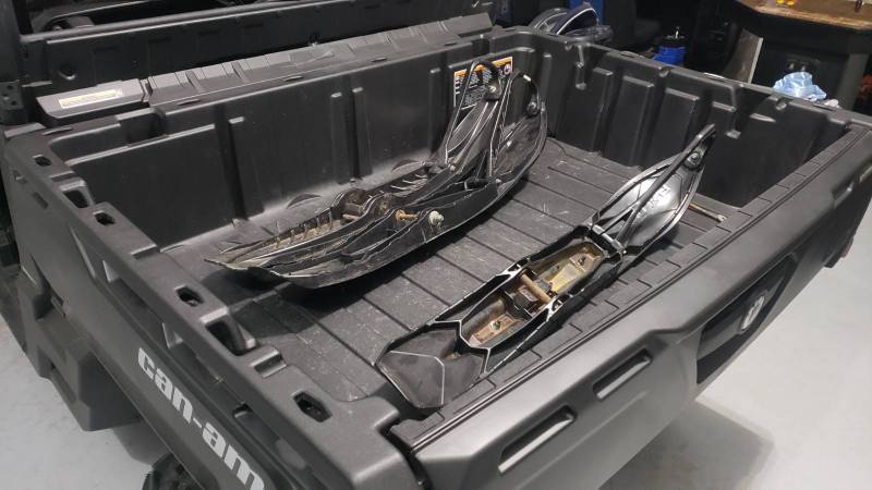

Stock skis had a few nice sized holes so got a pair of newer skis from a 18 Rush 600 after verifying fitment. Old bushings fucked so replacing those of course. Also ordered red slides and some body pins/fasteners, was missing two. Little by little i'll getter done. Next round will be tie rods and steering rack bushing, then onto the rail and left cylinder. Compression is good might just be an injector, won't know for sure till I look. Anyways fun project so far. I wiped down and touched up the nrw skis some, hard to see in the 2nd pic but they look great and will update the machines overall look.
Edited by stinkipinki
Skis from a 2018 fit good.
Bummer that the ones that came with it were bad.  The 2010 came with grippers.  I still have the set from mine.

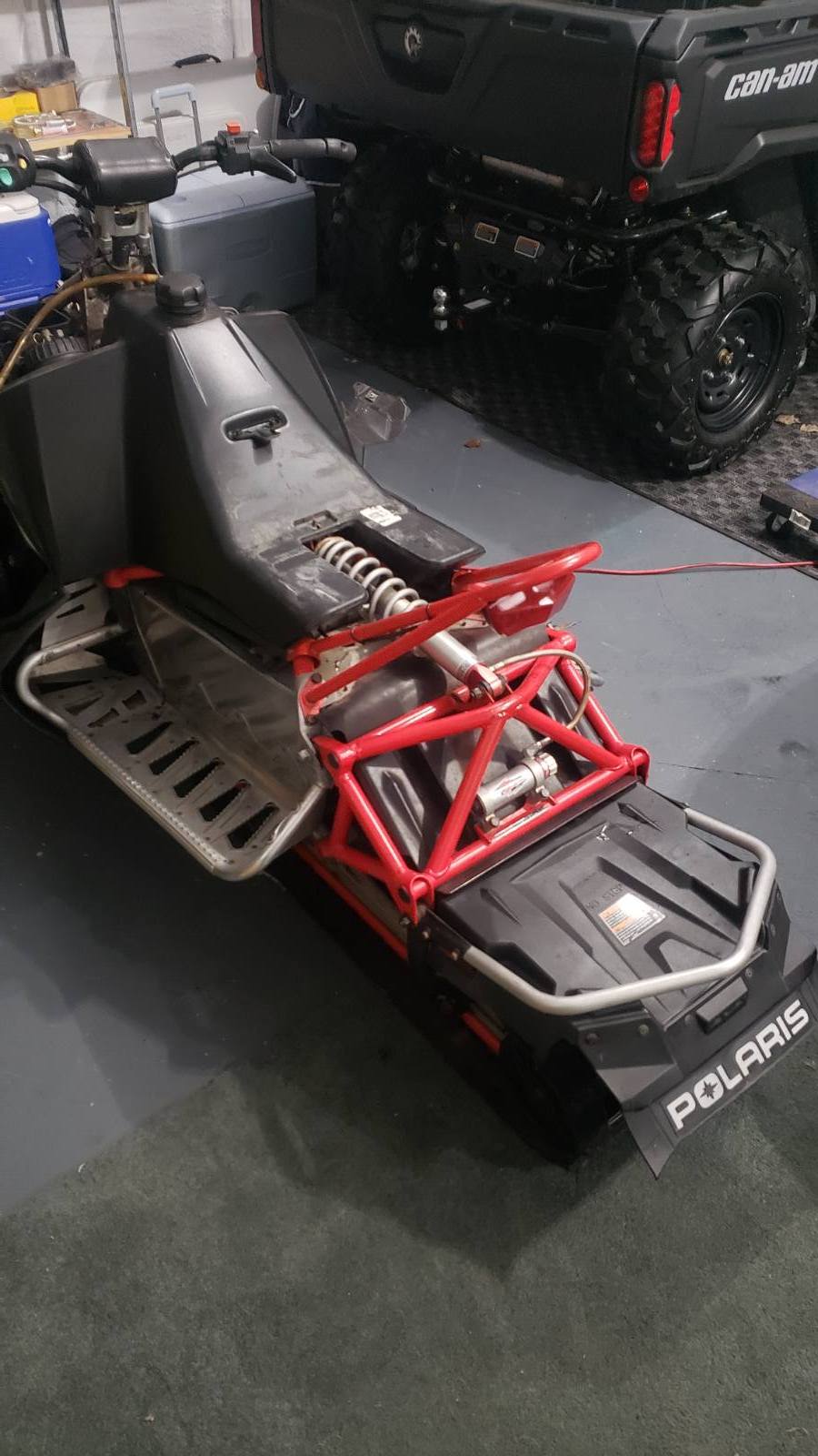

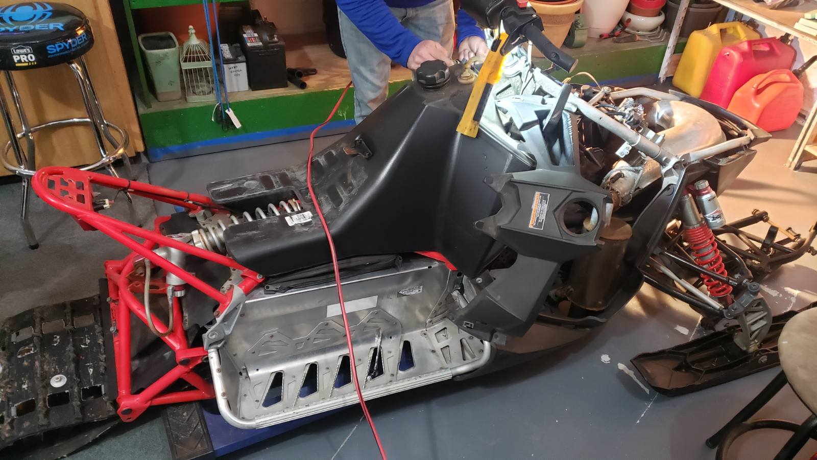

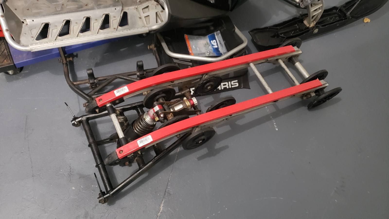

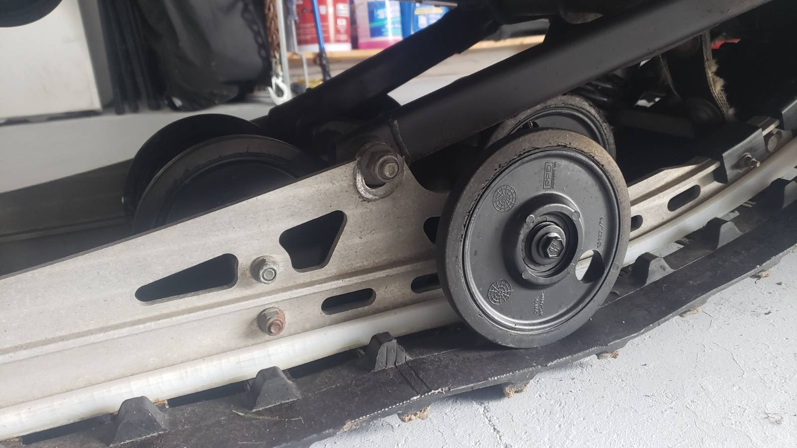

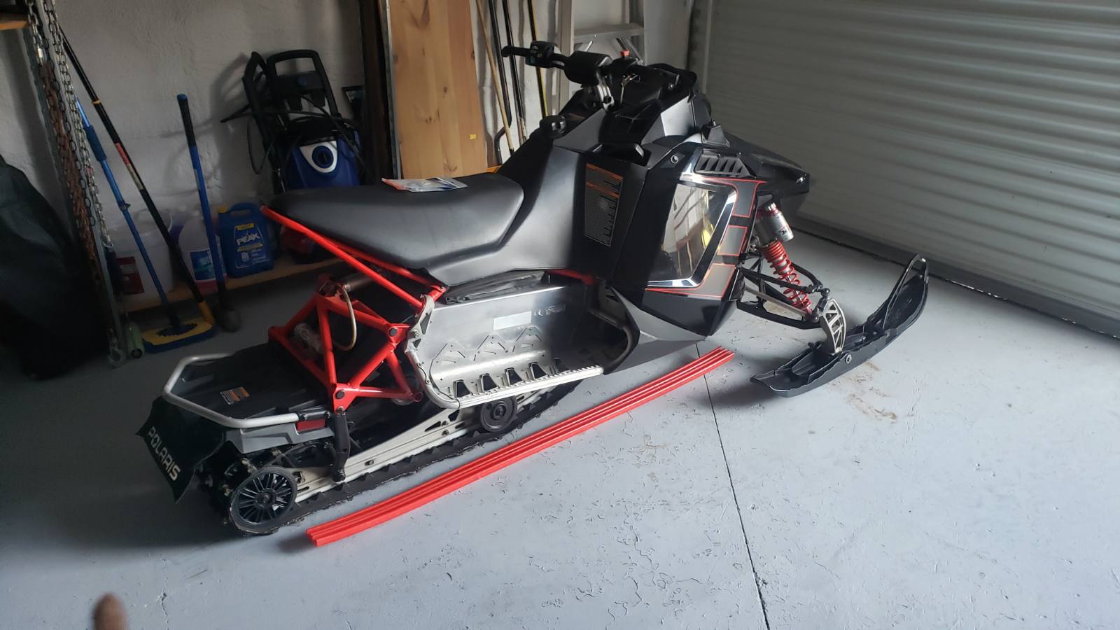

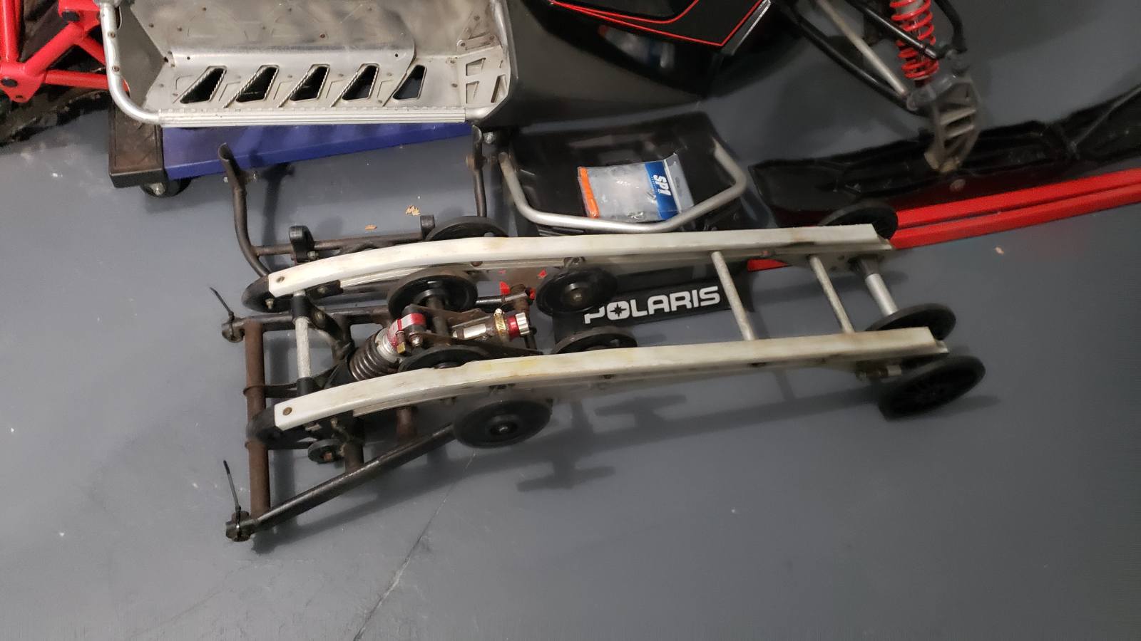

Rails off, needs a wheel or two, got an H bracket in like new shape for $35 shipped, then ill put the new slides. Ill sand and paint any surface rust and  have the rai bolts machined and made like new.
Not done touching it up yet, ill wait till i replace the h-bracket, lookin better though
  • 1 month later...
Rail welded/fixed, ordered 4 replacement idler wheels, h-shaft and h-shaft spacer, few bearings for a few good idlers,  top end gasket kit, got a perfect used cylinder and new spi pistion coming. Right side is perfect compression. Will start putting it back together soon.

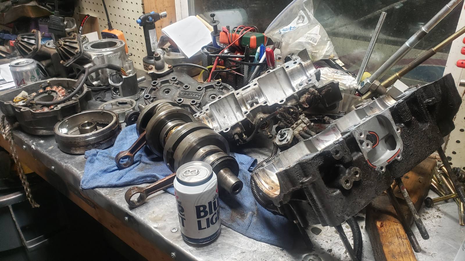

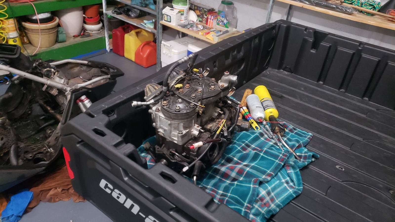

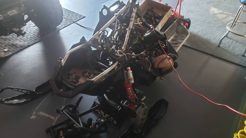

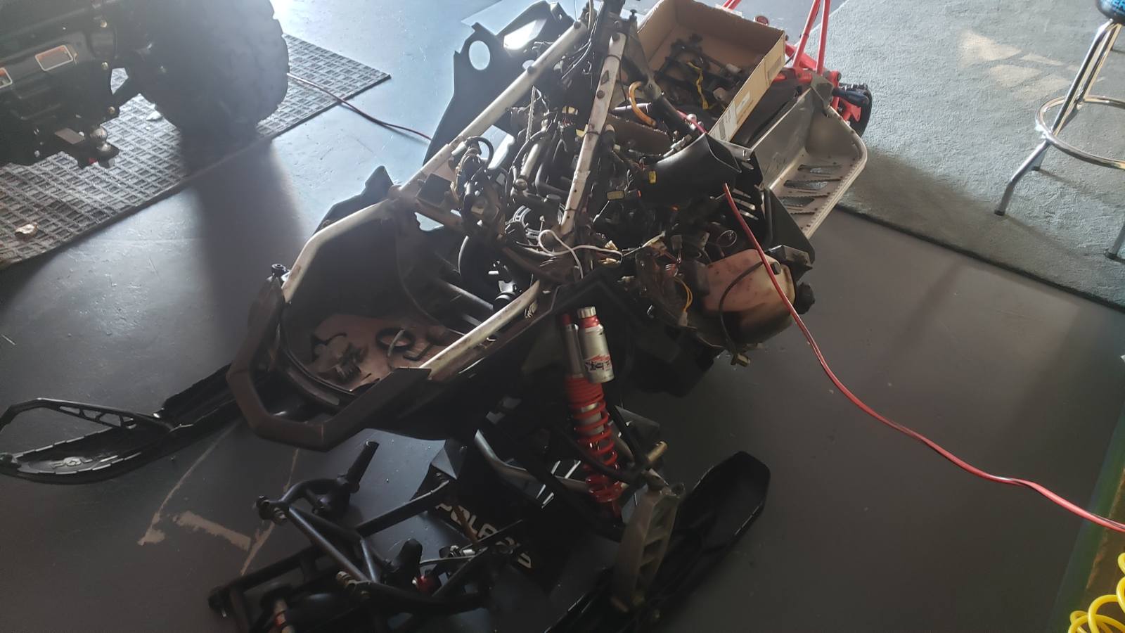

Out comes the motor.

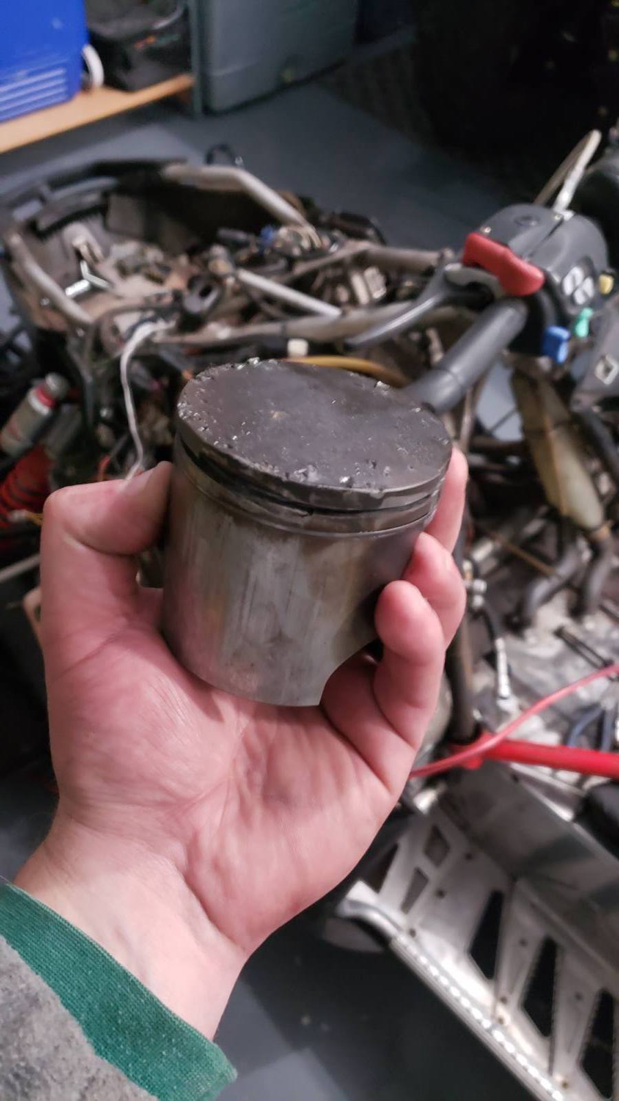

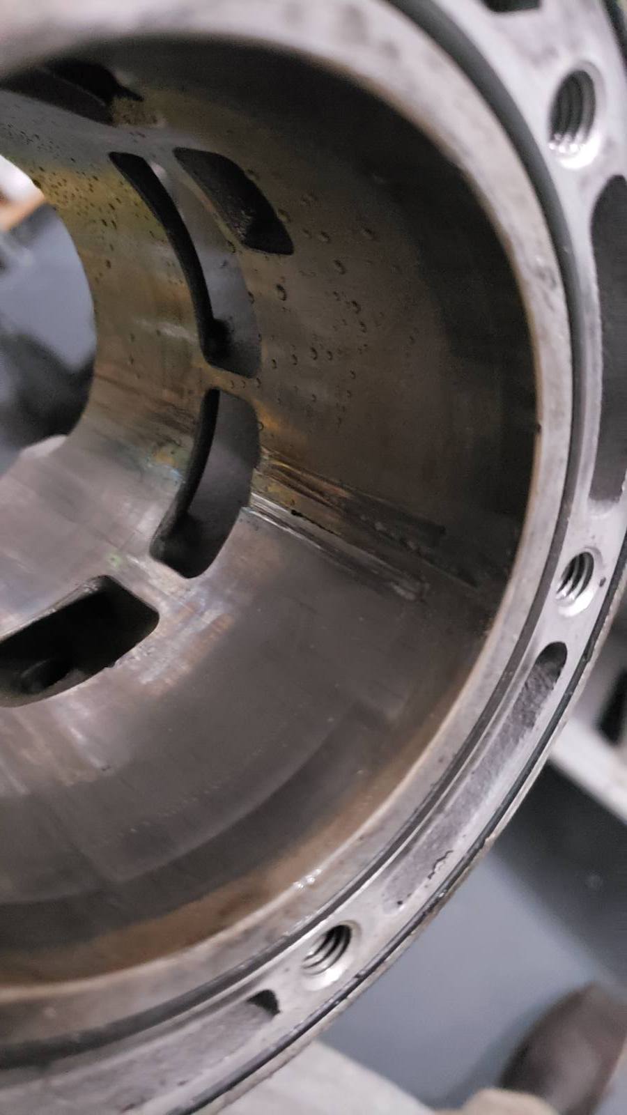

Pulled the motor, piece of a old ring in the bottom, it scuffed my new piston during a trial idle test! Obviously didnt know that, thought it was just the crank seal. Anyways both cylinders checked out fine, just had to hone the mag side and order another piston and complete engine gasket kit, she will purr like new, crank is tight, bearings good, cases in great shape. Also replacing the 2 AMP fuse for the multi function display, and tightened down the front engine bay guard plate, drilled out the two front holes and put bolts with lock washers then grinded off the rest. Replacing pull cord and clutch spring too, it was broke, and cleaned out the chassis good.
Rail/suspension back in. Tight as hell, gonna ride great. Machine will get new plugs too and ill run Klotz. I got about $2400 into it now, so didnt get out at 1800 or so like I wanted, but the machine will be tight and right when were done. Waiting on some last parts then the motor goes back in, and were almost done. Stock can sucked so bought an MBRP standard can, little louder then stock but no loss in HP.
So, other piston had some warping near the exhaust port side of the ring, so doing both pistons now.

The pics make is look like its just a redneck job but we carefully organize and built engines, I had just split the cases.
Crank was solid, tight and the cases look good, but bought a complete engine gasket kit and changed the crank seal anyways.

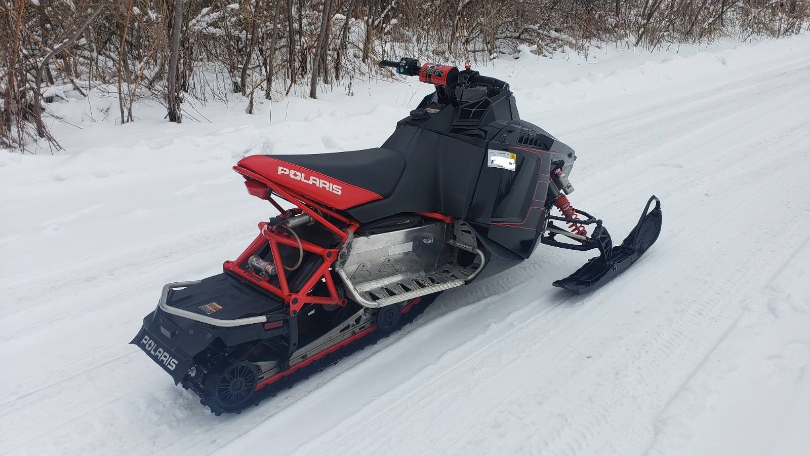

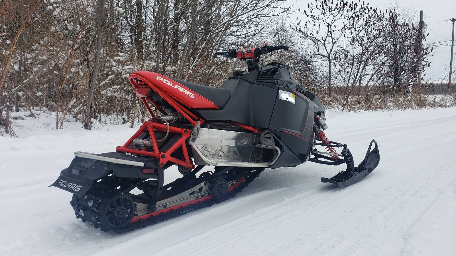

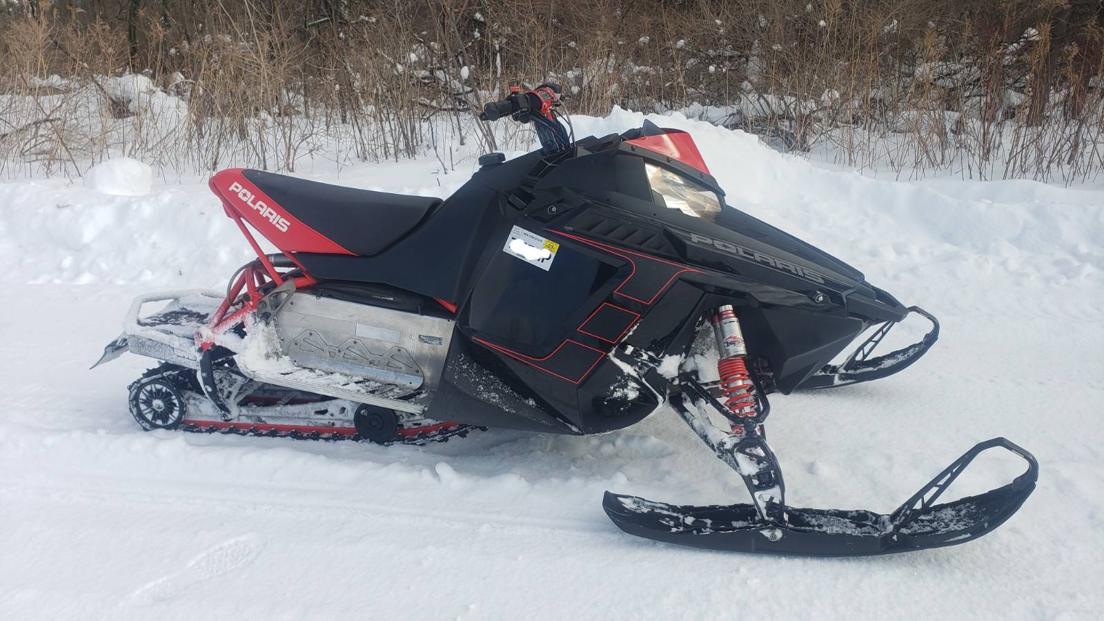

Almost done! ended up with 2 new spi t-moly pistons, new dash relay, 2 amp fuse, runs great, been a hell of a project, needs some final camber adjustment with all new new tie rods and rod ends, but overall happy, total about low 2s invested,

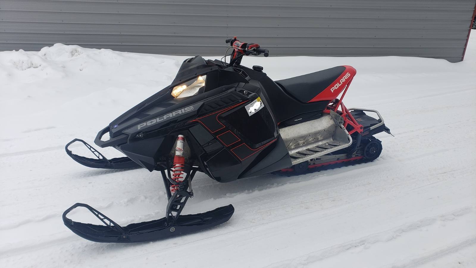

Sled is tight and right, fires up 2nd/3rd pull and idles great, pulls hard for a 600.
Look good man ... nice work!

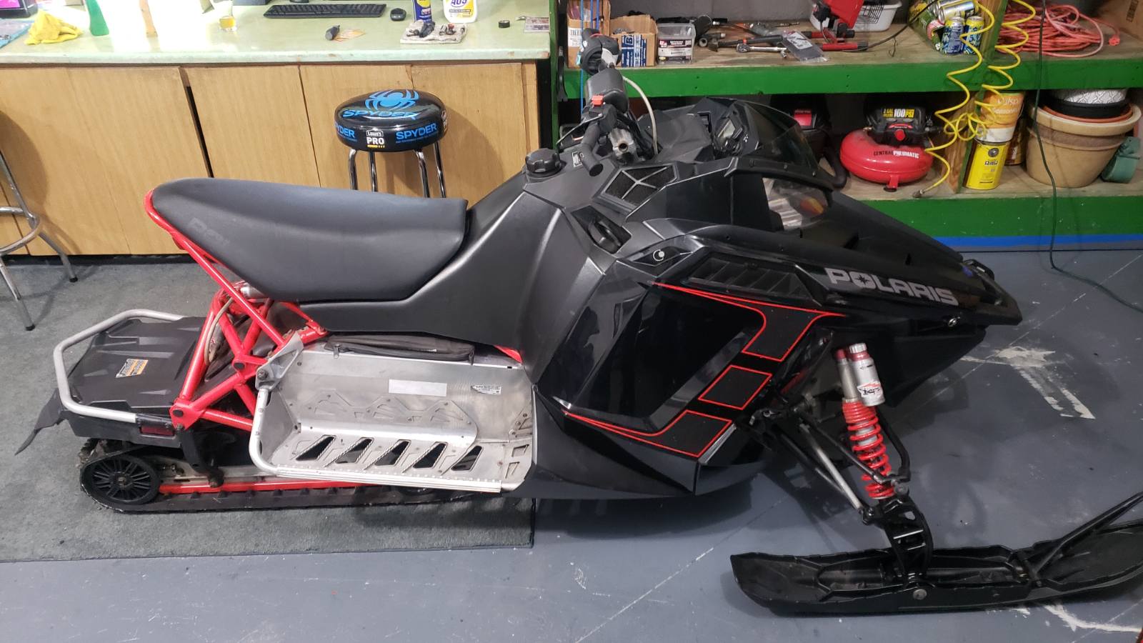

Learned alot about the Rush design. It aint no revised 2015 Axys, but with newer trail ski's, a few studs and suspension adjustments I got it riding/handling as good as any 2010-2014 can. I plan on keeping this machine and if I get new iron again, keep this around as a backup or sled for family/friends to use.
However in all honesty, it looks good, and while its no 2022 its not ancient either, has got reverse, a heated shield rca plug, both work good, and its a comfy trail rider. I might sno-check a new machine in the coming years, but to have something to ride now, im happy. Topend is new, suspension is like new and for only $2400 total invested with todays inflation, I'm content with the project. Sled looks & rips good for a 2010.

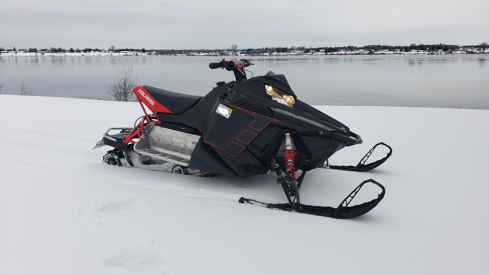

Previous owner cut the already ridiculously low shield, so I made it red to even the front out with a lil more color. Sled looks great, rips great, love it. Project complete.
