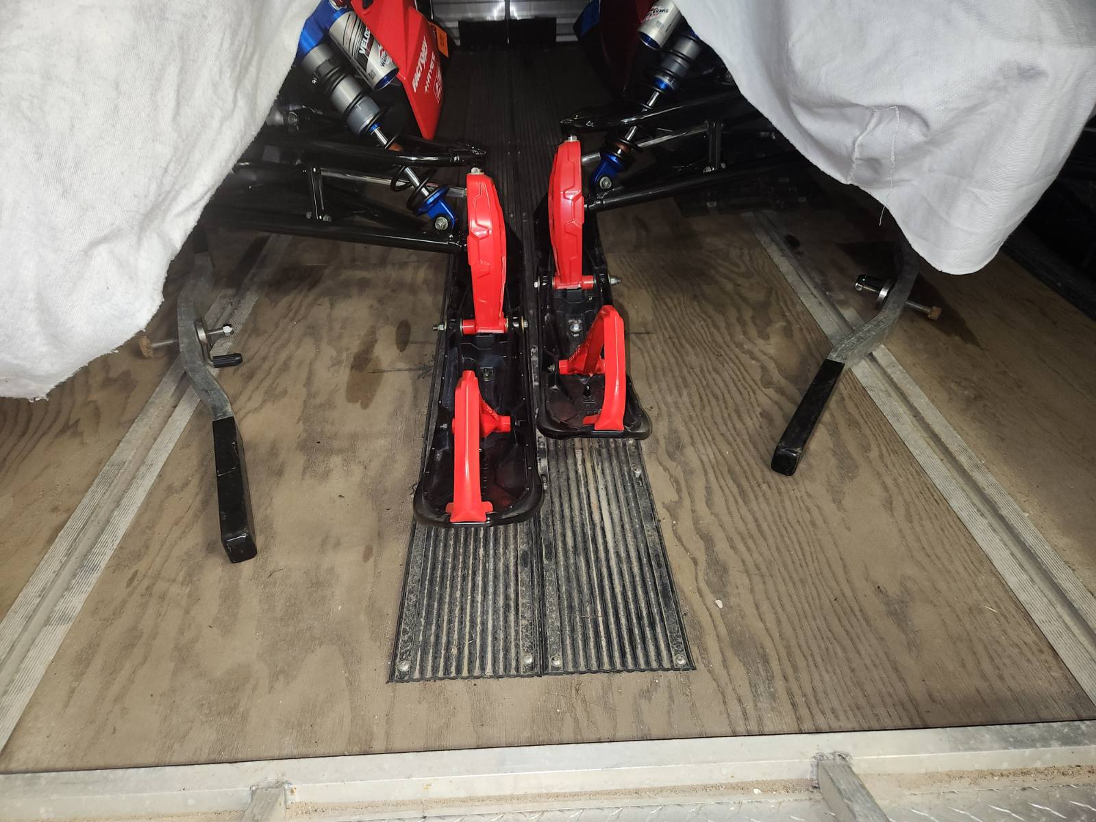

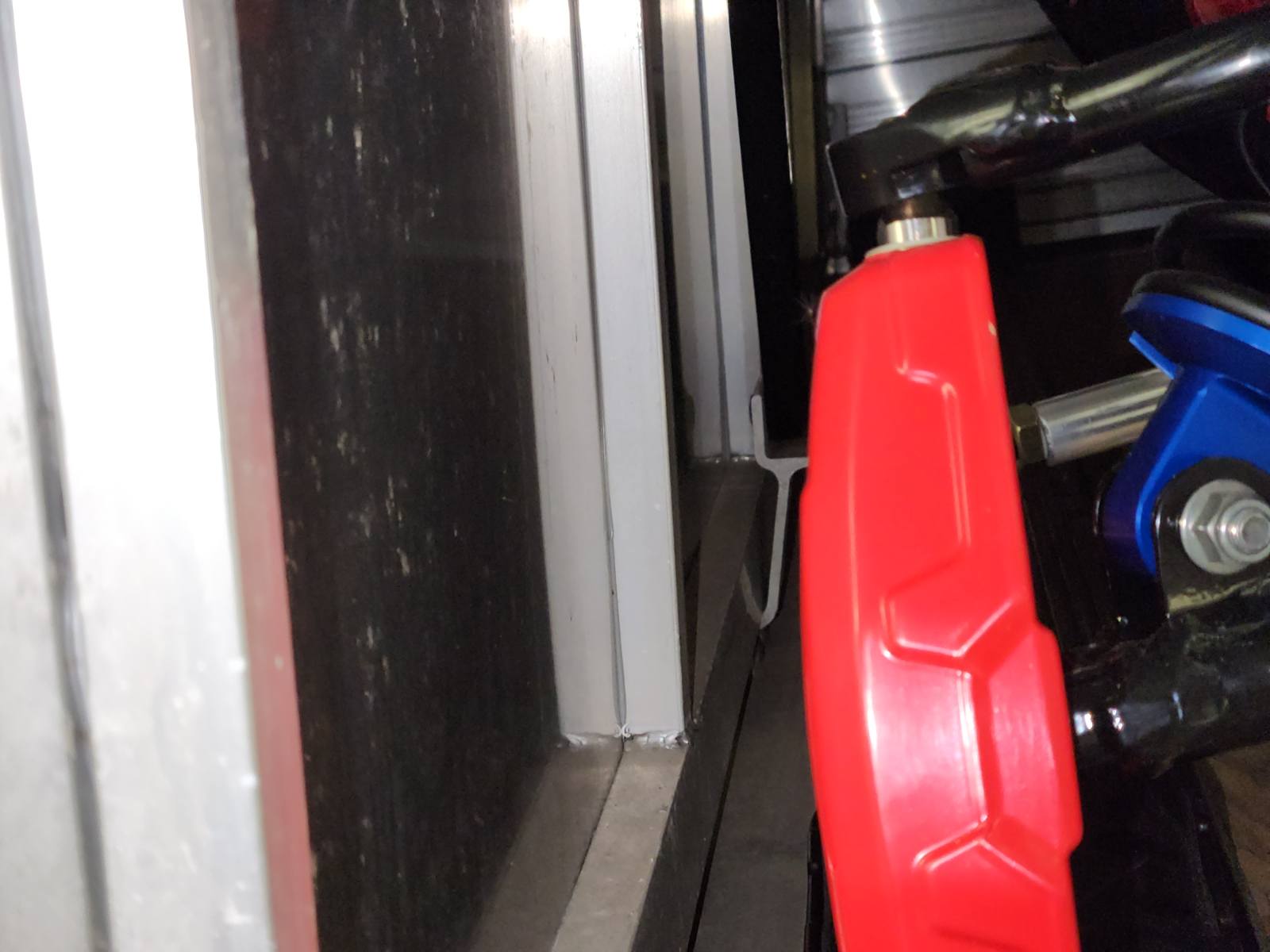

I have a Triton Elite 101 with a cover.  Inside dim of the cover is 99.50".  Two newer sled will fit but there's not much extra room.  Also plan ahead if you're thinking of getting a longer track sled.  I bought 12ft long trailer because I've owner 144 Assaults in the past.

My 12’ hybrid Snopro is 98 1/4” inside. My Matryx and wife’s new g5 Ski doo are both 48 inches wide overall. So no worries, but add some wider skis or adjust the Ras x Ski doo skis to their widest position and it will get pretty tight.

As long as only one sled has grippers you shouldn't have a issue.  In my case where I have a tilt top you have the support brackets to drive around to compensate for.  Being a fixed top for you you won't have to compensate for that.

I had Mohawks on my assault...I would load the buddy sled first and ride up over the ski just a tad...it's plastic on plastic no worries.

A trick a buddy would do is load one sled and then put a 2 x 6 down next to the ski and load the 2nd sled riding one ski on the 2 x 6.  That raises the ski up on the 2nd sled so your not ski on ski where the overlap is.

Normally put it under the one already loaded as the carbide tends to just push it off the trailer otherwise.  Same result
