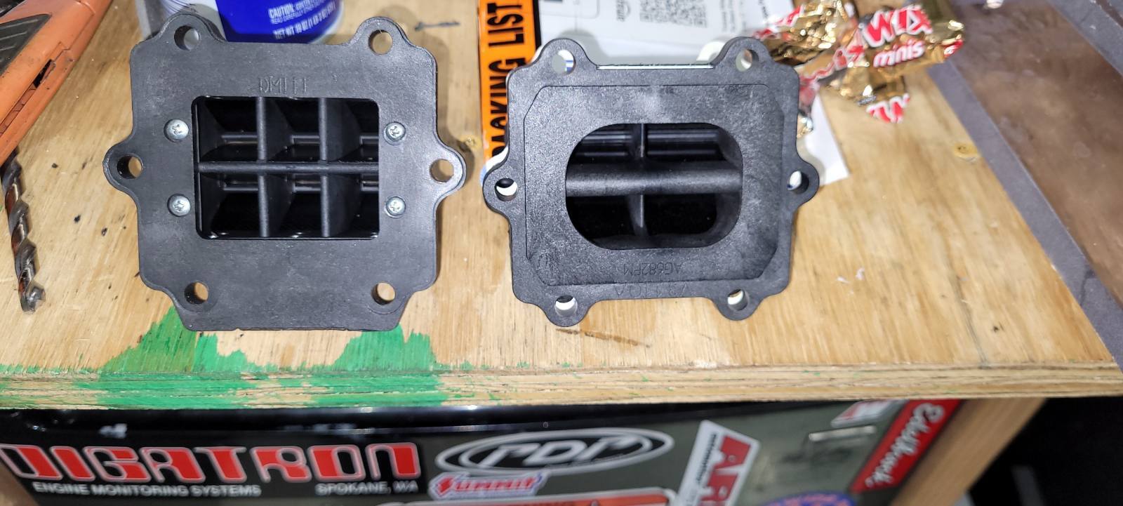

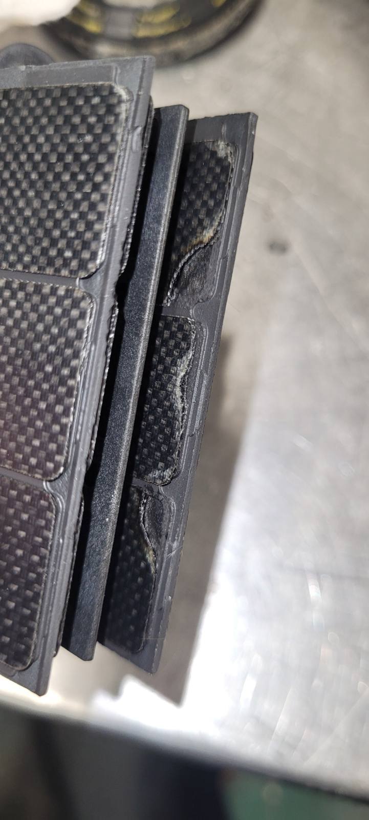

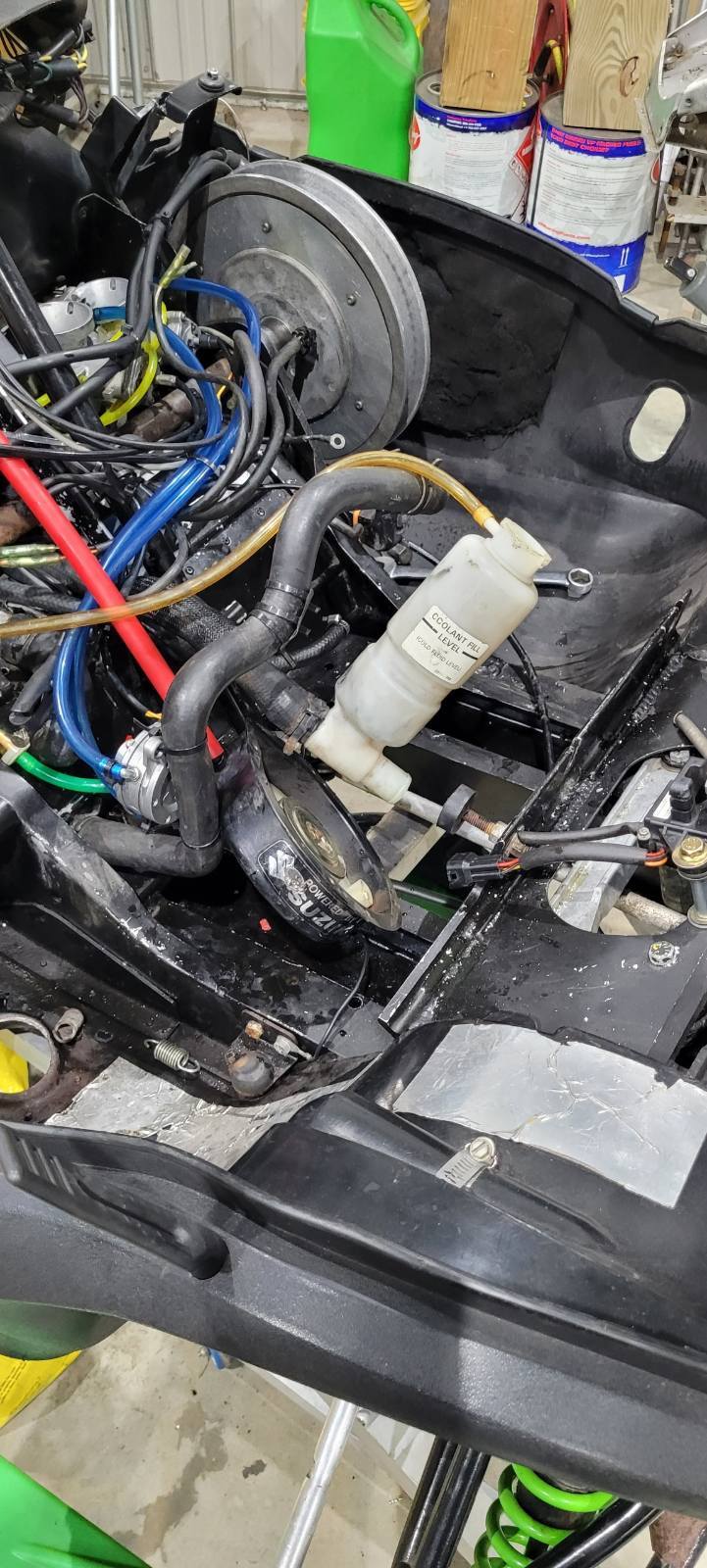

Today was the first day really tearing into it.  Pulled the carbs which smelled like Assoline, got a really good look inside the tank and found some stank and debris in it I wasn't comfortable with so off came the seat, cowl and tank and everything in the fuel system is getting cleaned/replaced.  There was also a bit of water in the fuel.  Found the master cylinder a bit dirty, cracked open the bleeder and some foul crap came out.  Already ordered a new master and caliper seal kit from Wilwood to rebuild the caliper and if necessary replace the entire master.  Found a 2002 green tinted windshield on FB marketplace for a great price and nabbed it.  Not sure which shield we'll run on it yet but it didn't come with the original.  Will pull and check the reeds next week and address the utterly moronic recoil rope routing which has rubbed into (but not through) the fuel tank and oil tank.

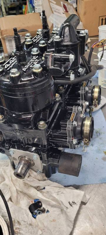

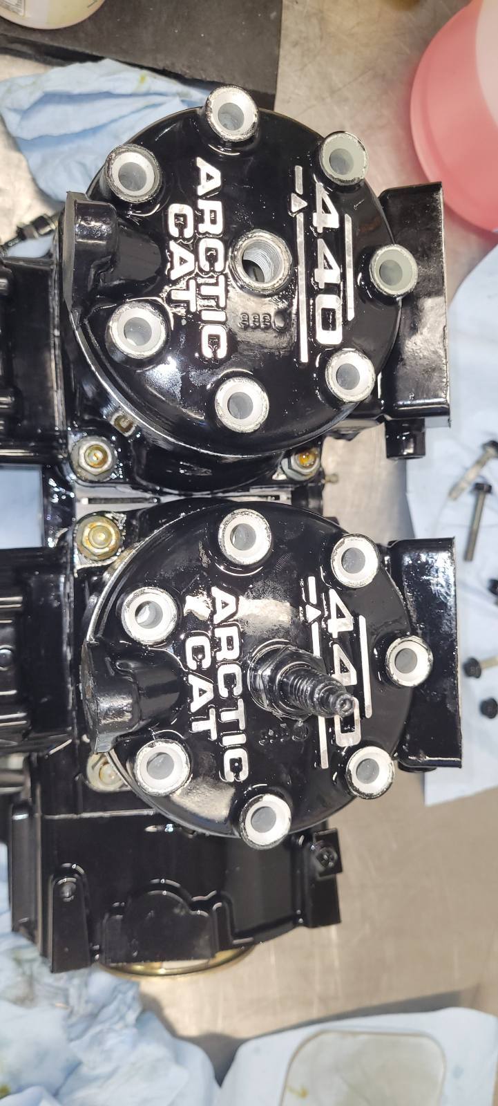

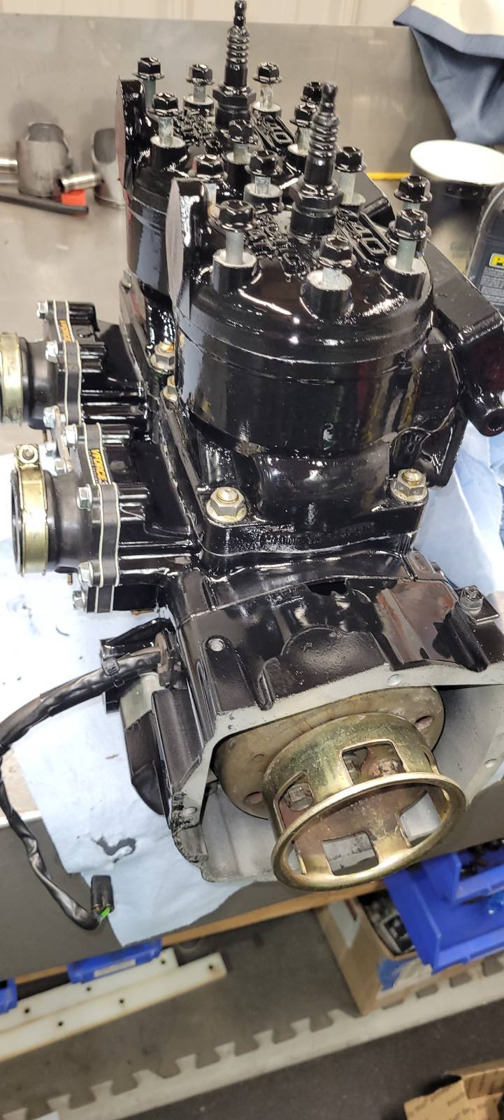

Enigma has been a real journey thusfar... but thanks to 426ODR it's alive!!!
Next up... seat cover, shocks to Carver, skis/carbides and a new track???

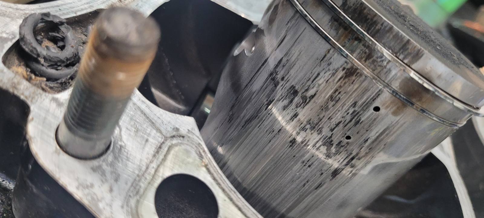

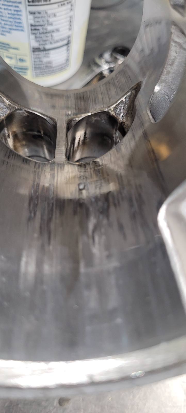

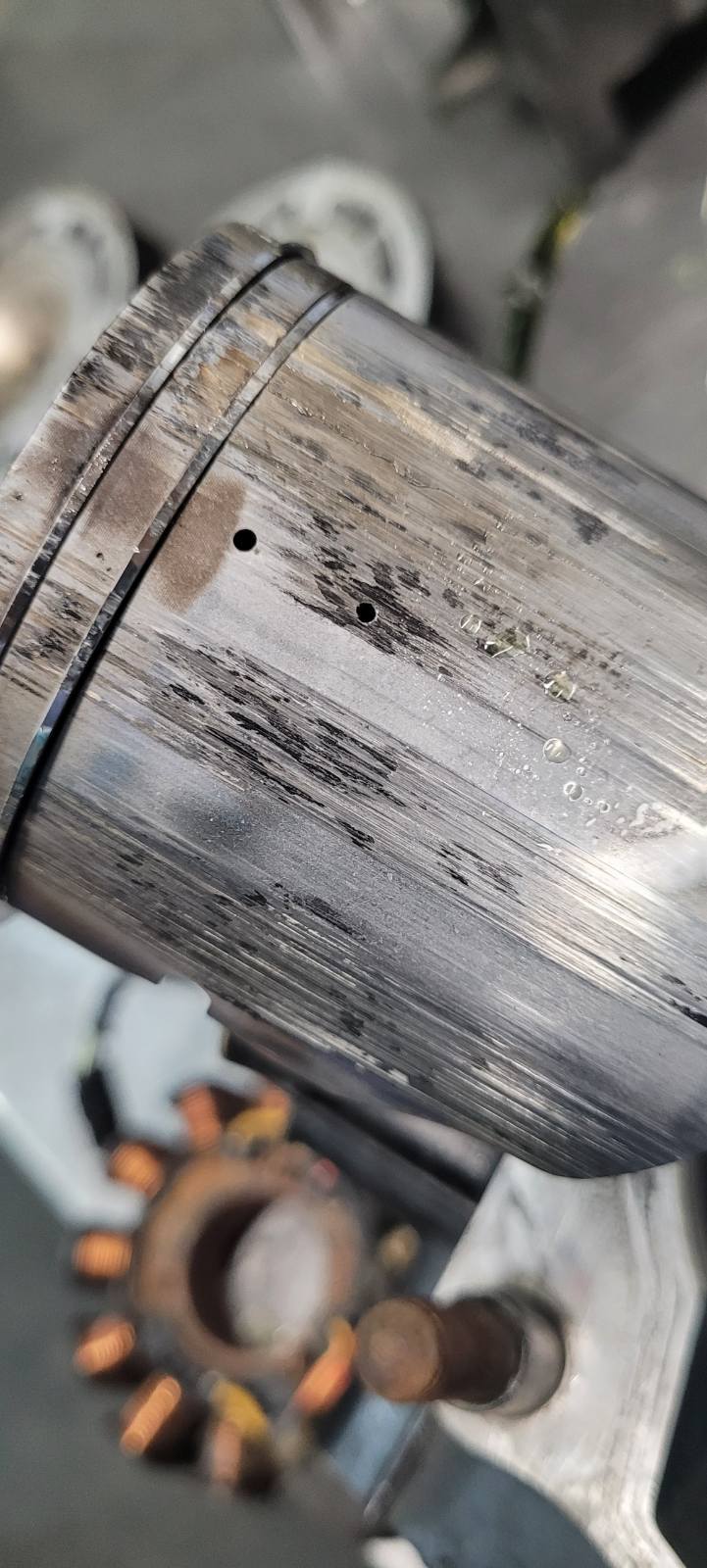

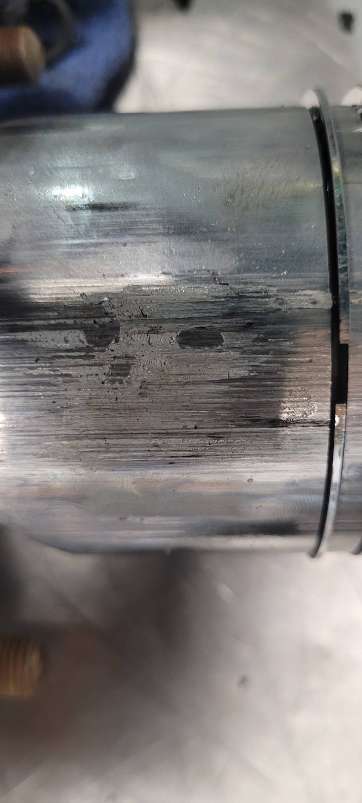

the short version of the rest of the story... there was all kinds of sin inside the engine and a few other little bugs still being sorted out.  for those who know who's done the work, he's the man.  ;)

wasn't 'blown' but someone had been in it once and did a very poor job reassembling it... missing bolts/screws, some not tight, quite a bit of sin.  it idled amazingly well for whatever odd reason?
