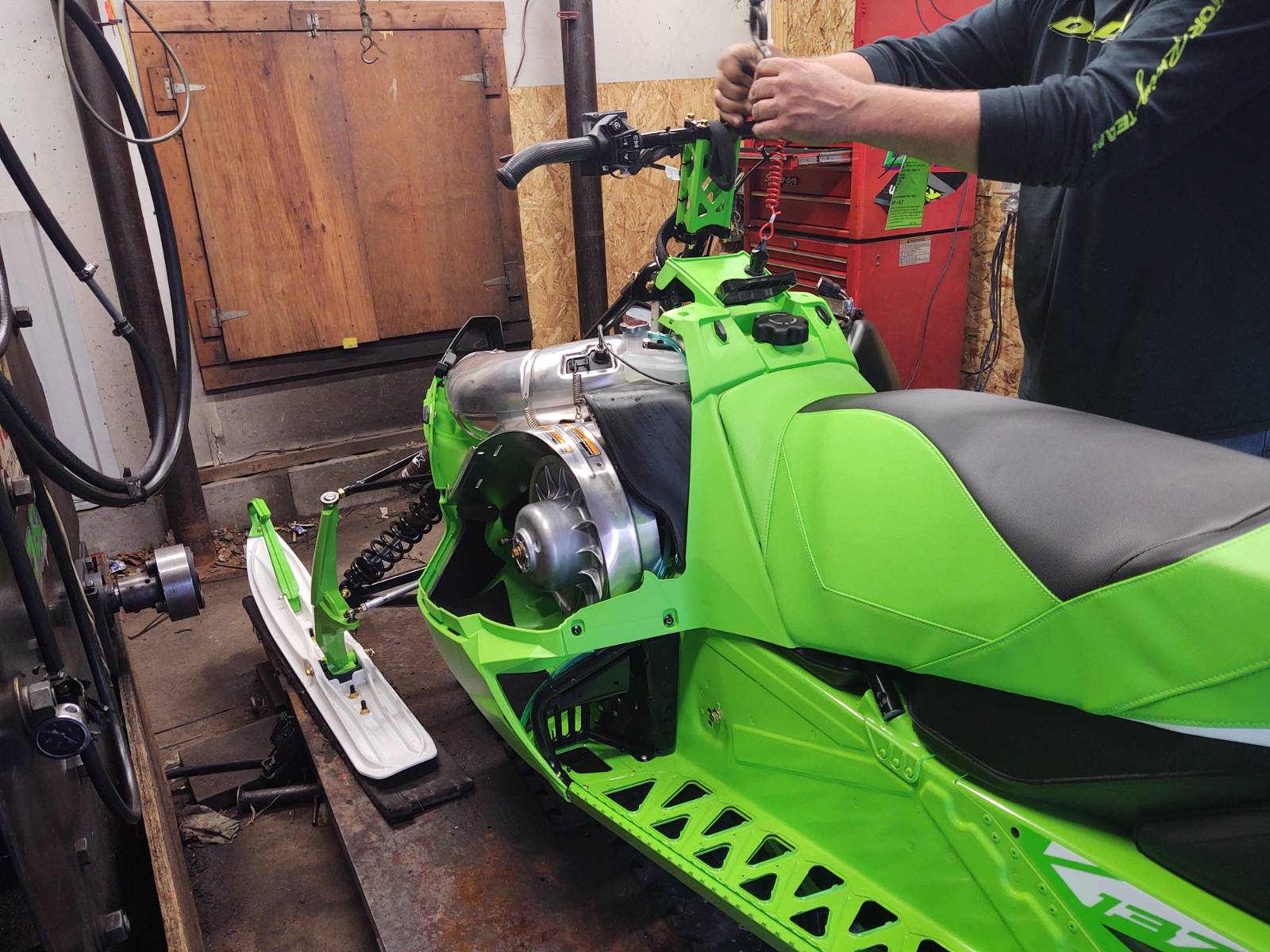

Picked up the 22 RR today.....and dropped it off at the dyno immediately after...........
Tore the ADAPT apart to look inside. Interesting in many ways.....
More to come once we get out of break-in and can start getting some pulls on it.......

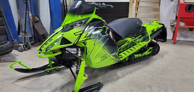

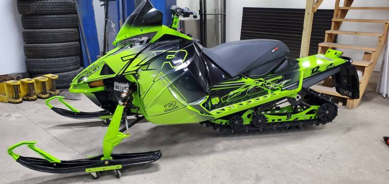

  • No snow to rip on.......but the wrap is done.......

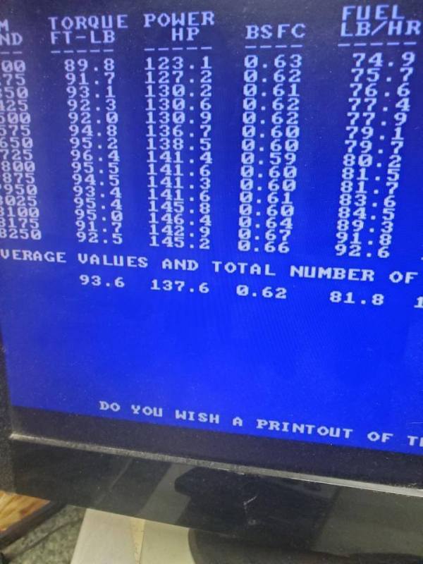

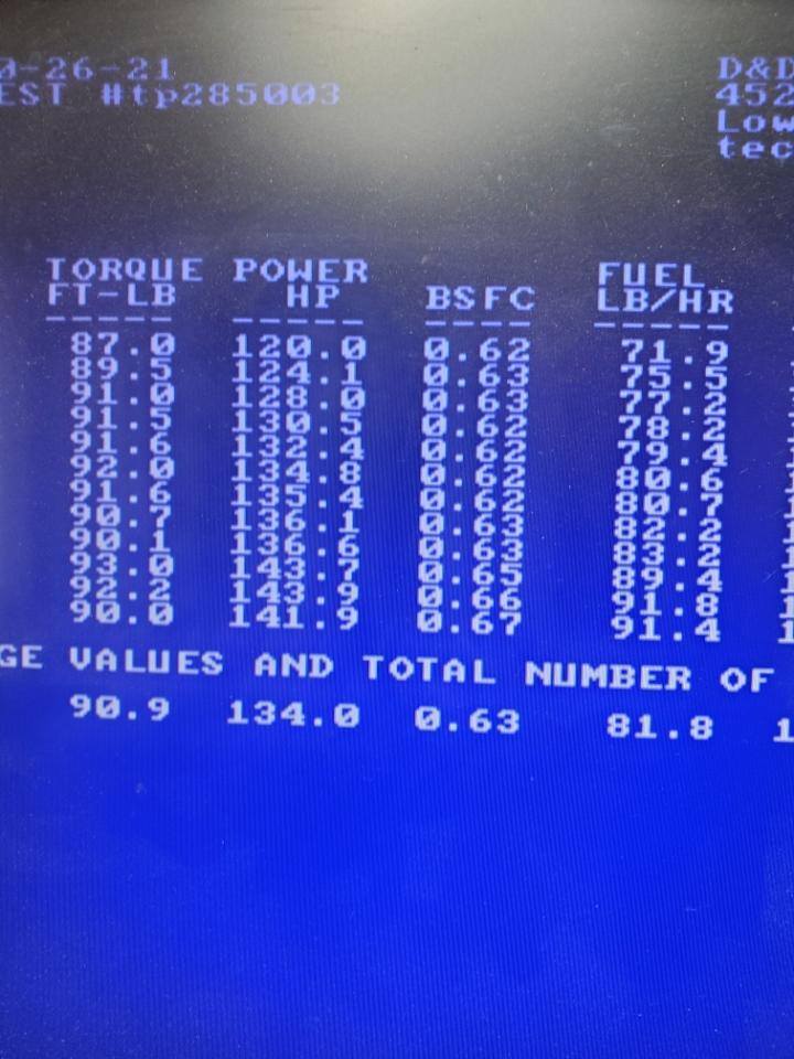

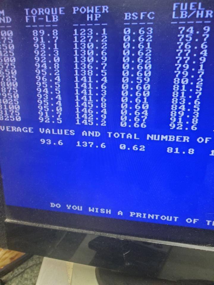

Crappy day for some stock testing on Tuesday .......... high 40s, pouring rain, crap air quality........ but with all things being equal, seeing about the same as we had been seeing with the Cat Ctec2 800 the past 2 years......
1st chart is all stock, just out of the rev limiter and in full break-in
2nd chart is after more run time, still in break-in but less added fuel (still full added oil)

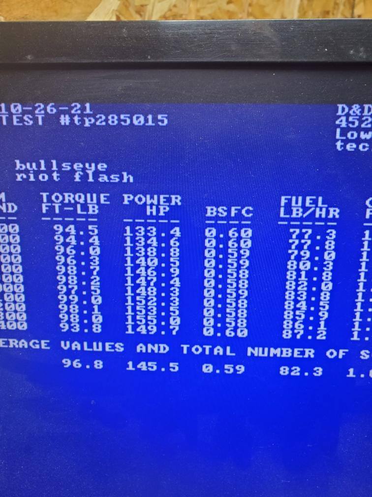

3rd chart is with Bullseyes, D&D stock reflash (still in break-in).
So on this day, with these crappy weather conditions, we saw the additional airflow and better mapping gave us +/- 10 hp

Looks like 8100 is the sweet spot.  Graph #1 illustrates what kind of power the sleds have at the shootout, which I feel is silly.  They should allow Jim at DTR to get all the sleds competing out of break in mode and keep them under lock and key until race day imo.

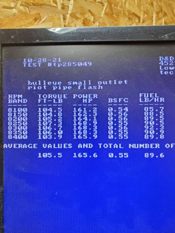

Still mid-high 40 degree temps....but at least it wasn't pouring out today.......
A few more ponies on this one....... and a nice wide band....... Wish it was in the 30s today...........

bullseyes, riot pipe flash, and still in break-in?
when does the pipe go on?
good #'s Tom
good #'s Tom
That is with the pipe.
Bullseyes
Small outlet Riot Pipe (something new they are working on this fall)
Flash (to match the pipe)
More to follow next week...... They were playing with various heads today. Stock, modified stock, interchangeable domes, etc..........
