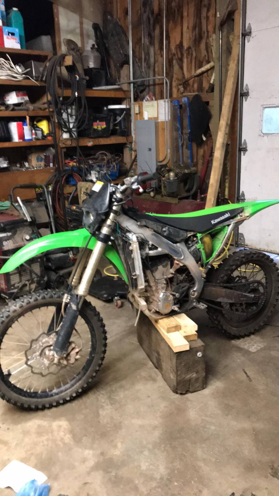

kid next door wanted me to look at his 2020 KX250 four stroke.  It shunt down on him and will not start. no smoke before hand.
I do not know a single thing about this bike other than its newer style engine because there has a second  injector in the intake that came out in 2020.
I can not find any identifiers any where on the frame for specifics on model. Its got electric start so I am assuming its the cross country model. Of course the kid has no specifics.
No hour meter and I know he is not easy on it, not a track bike tho.
Either way what I have checked and found so far... New born in the house so I haven't had a lot of time after work.
Changed spark plug, old one was a little old, figured I would get that out of the way. (it is making good spark)
Fuel pump is running and pushing fuel, haven checked pressure yet.
I have the intake box on and tried squirting some starting fluid to see if I could get a puff but nothing... granted its a weird angle and I was nervous to give it to much because this thing is new. Might get some one to help me with this after I check other things.
Pulled the valve cover to check timing marks and they seem good, I couldn't find anything with the exact bike 2018 was the newest.
gear dots line up and there is the right amount of pins between (28). Crank mark was looked to be in the right position.
My next step is to check the lash, just need to find the spec.
My compression tester doesn't go small enough for the spark plug, if valve lash checks out ill have to do that next.
Head light is something he had put on so Ill have to check what the heck its wired too.
Dealer is  a dick and making him worry about billing, so I am giving this a shot before sending it there.
also if I fix it I can test drive it :ylsuper:   Any help is greatly appreciated.

That thing looks beat! You said you changed the spark plug, Did you check to see if it has spark?
@Gocky
It is pretty roched, you should see it up close.
yea has spark.

I can't help you out here but my god that thing looks fucking rough for a 2020.  Looks like he does a lot of burnouts with it as well.  I'm guessing it has sat on the limiter for most of its life
that's the second tire!
I think he drives it on the road more than the dirt honestly.
I feel bad for his grandmother that bought it for him just to wreck.. jealous too.

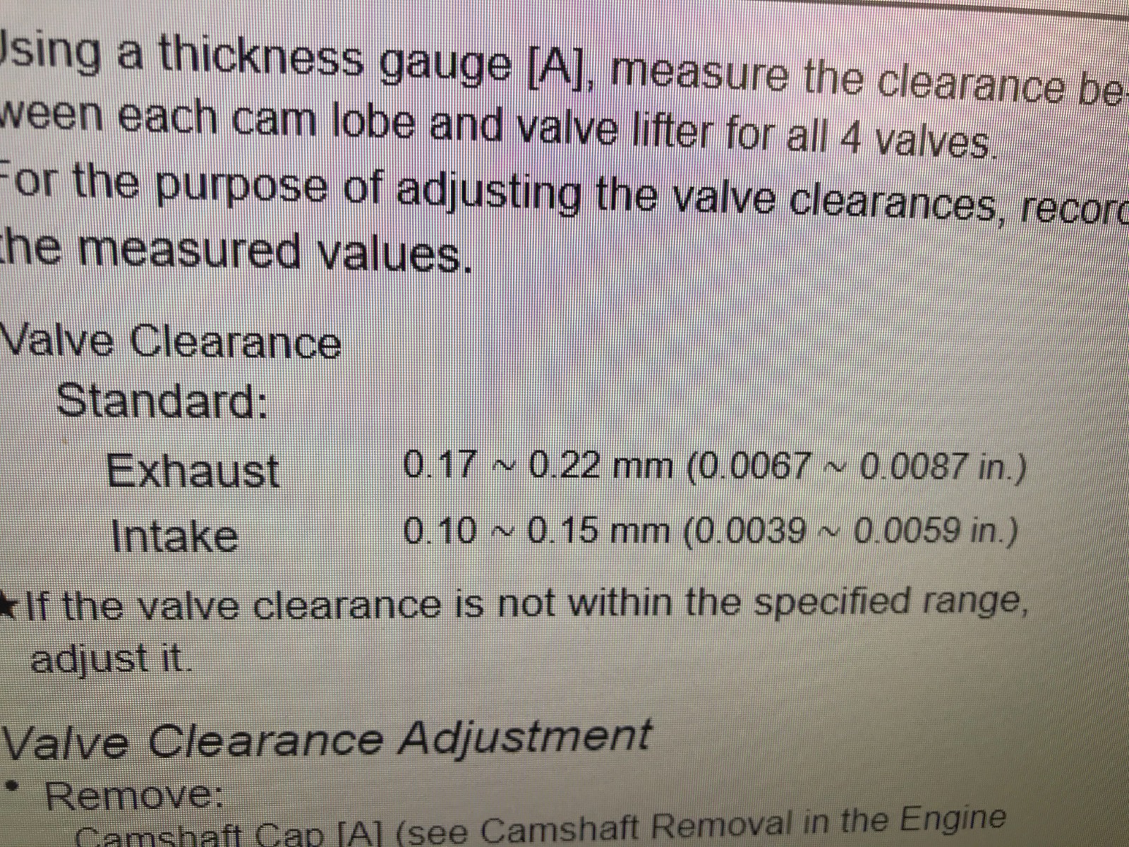

One intake was .002mm over other was .102mm. Exhaust were both .203mm. Here is the spec i was using. Pulled off the inter web.
i guess i need to do a leak down test next?

I sent a message and I guess the valves were lashed recently that's why they are in spec. So knowing people, bike wasnt working right, valve lash was long over due got that done. Now the real issue is showing.

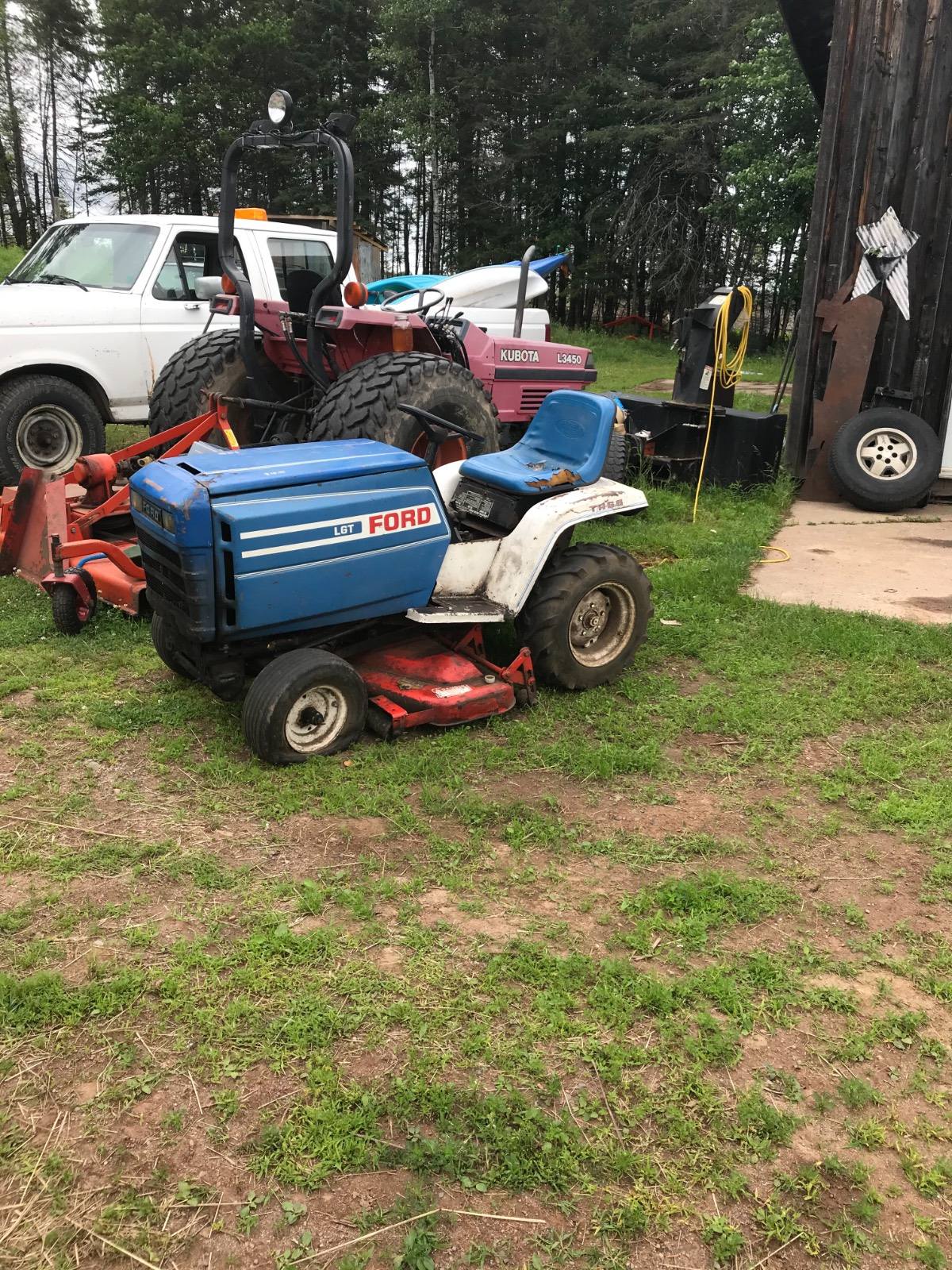

anyway I ave up. Have my own engines to fix. Picked up a little mower that smokes more than snoop dog on 420 and needs 900cca to start lol

Don’t know for sure lgt 145, 78 to 83.

It was my grandfather’s also im excited to get it in working order.
