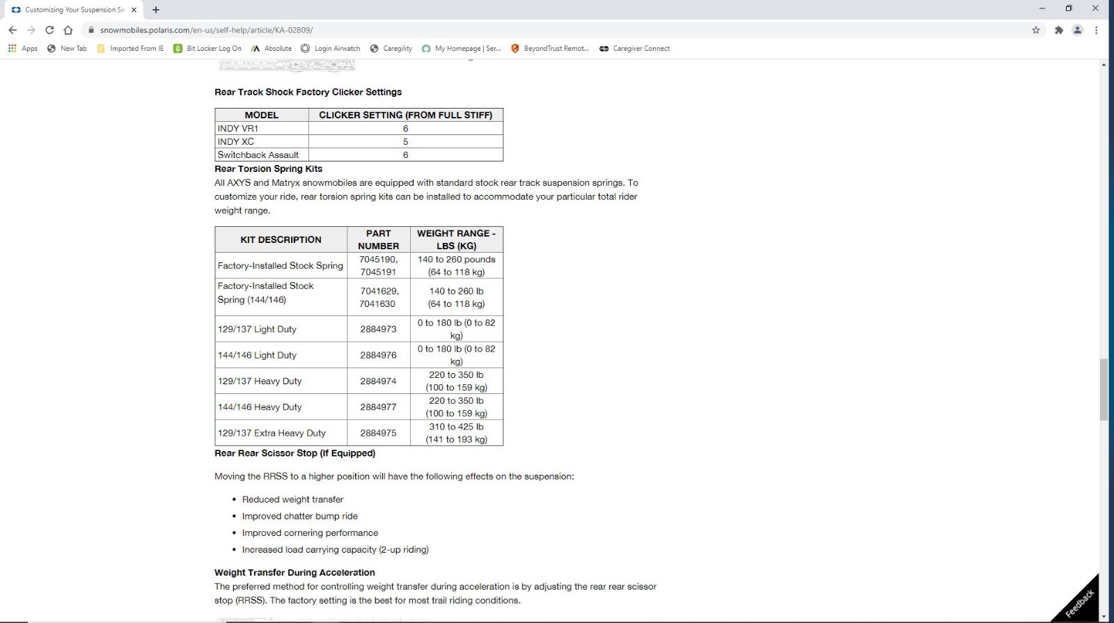

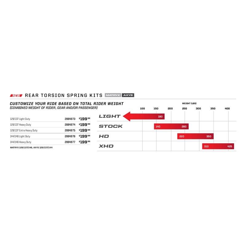

OK I'm confused as fuck here.  The attached says the 2884974's are stock when you look up that part number on the Polaris website and the 2884976 are rated for riders 220-350 WTF? Two conflicting charts from Polaris attached.

Part# Pro-CC
Matryx INDY
Description Driver Weight Range - - - - - - - - - - - - - - - - - - -
2884973 Kit Light Duty up to 180 lb.
Sq .347
Sq .359/80
7045190-329
7045191-329
LH Standard
RH Standard
140 to 260 lb.
2884974 Kit Heavy Duty 220 to 350 lb.
Sq .375/80
7045207-329
7045208-329
LH
RH
2884975 Kit Extra Heavy duty 310 to 425 lb.
Sq .375/70
7045209-329
7045210-329
LH
RH
2884973 LightDuty Torsion Springs $200US/pr avail.
AXYS/MATRYX 129/137 Indy (Pro-CC) Rider Weight upto 180 lb.[/B]
stock Rider Weight 140 to 260 lb.
2884974 HeavyDuty Torsion Springs $200US/pr avail.
AXYS/MATRYX 129/137 Indy (Pro-CC) Rider Weight 220-350 lb.[/B]
Rear Torsion Spring Kit - 129/137 - Extra Heavy Duty | Polaris Snowmobiles
Feel the unique rhythm of every trail with this Extra Heavy Duty Spring Kit. These heavy duty springs
