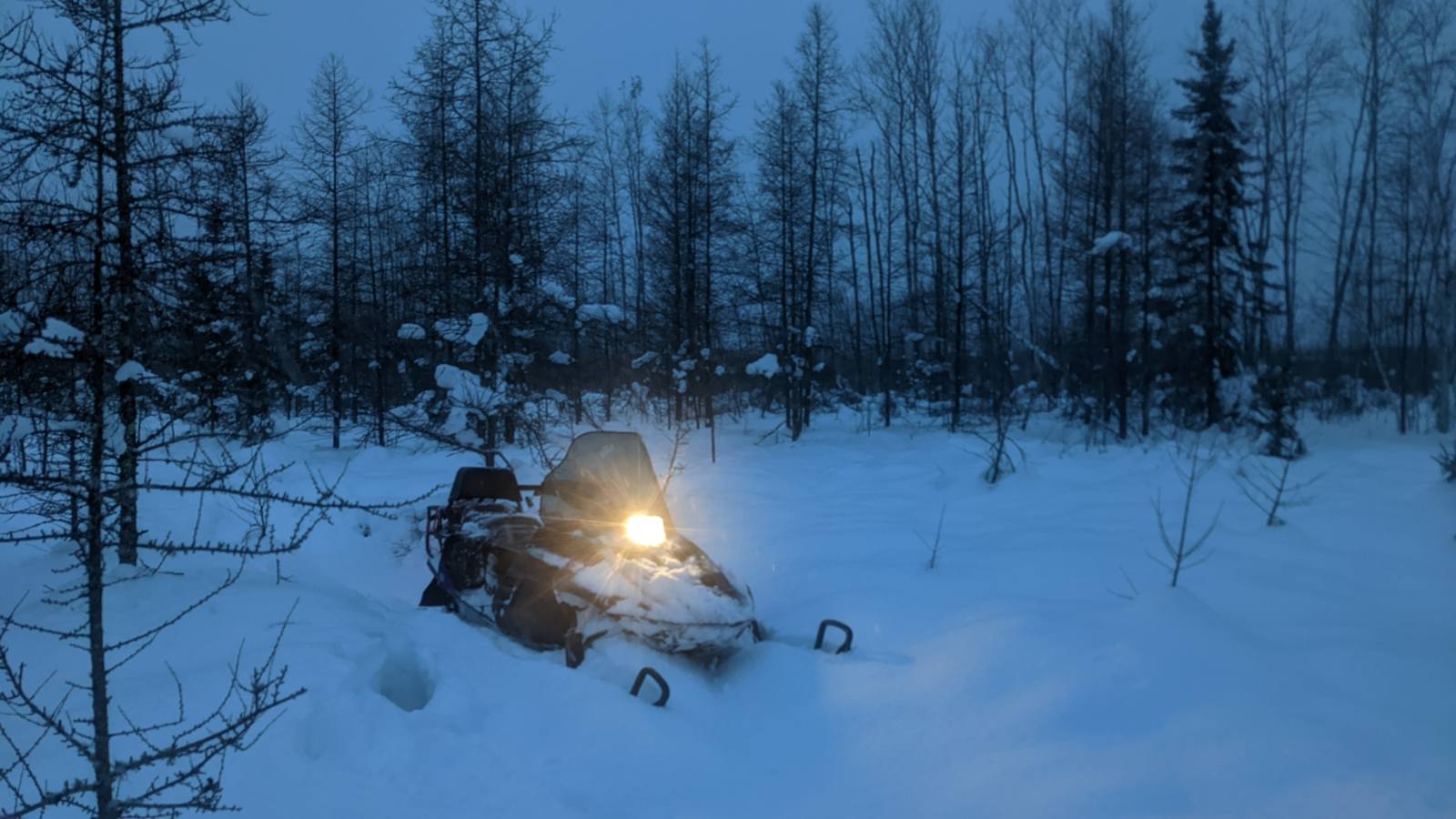

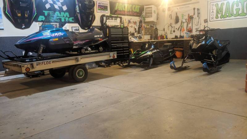

  • It's been non stop aws1 fan cooled action all winter.   Many late garage nights to 4-5am including last night. The mod Jag is pretty much done.  I have a different helix to put in for next time o
  • Cool thanks.  I have continued doing lots of stuff to the aws1 fanners I just don't post about it much.  I have thought about putting a 500 in something, I'm sure I will at some point.  They are fun.

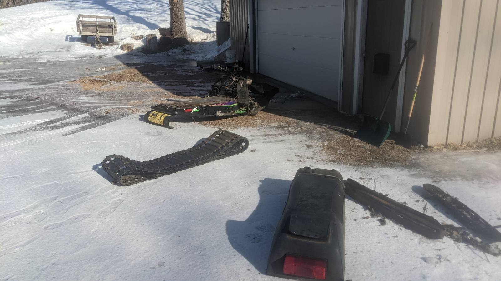

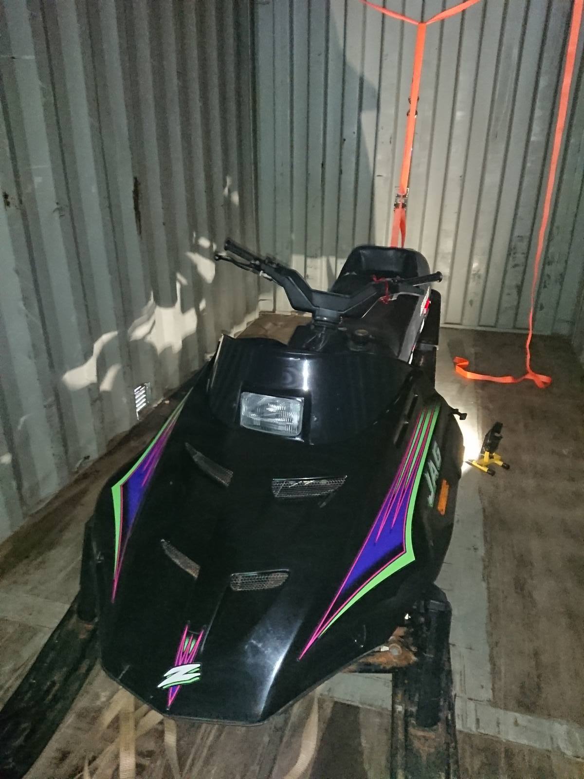

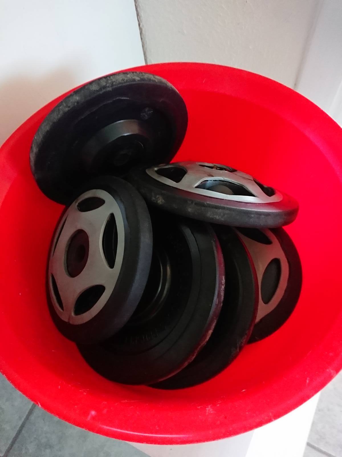

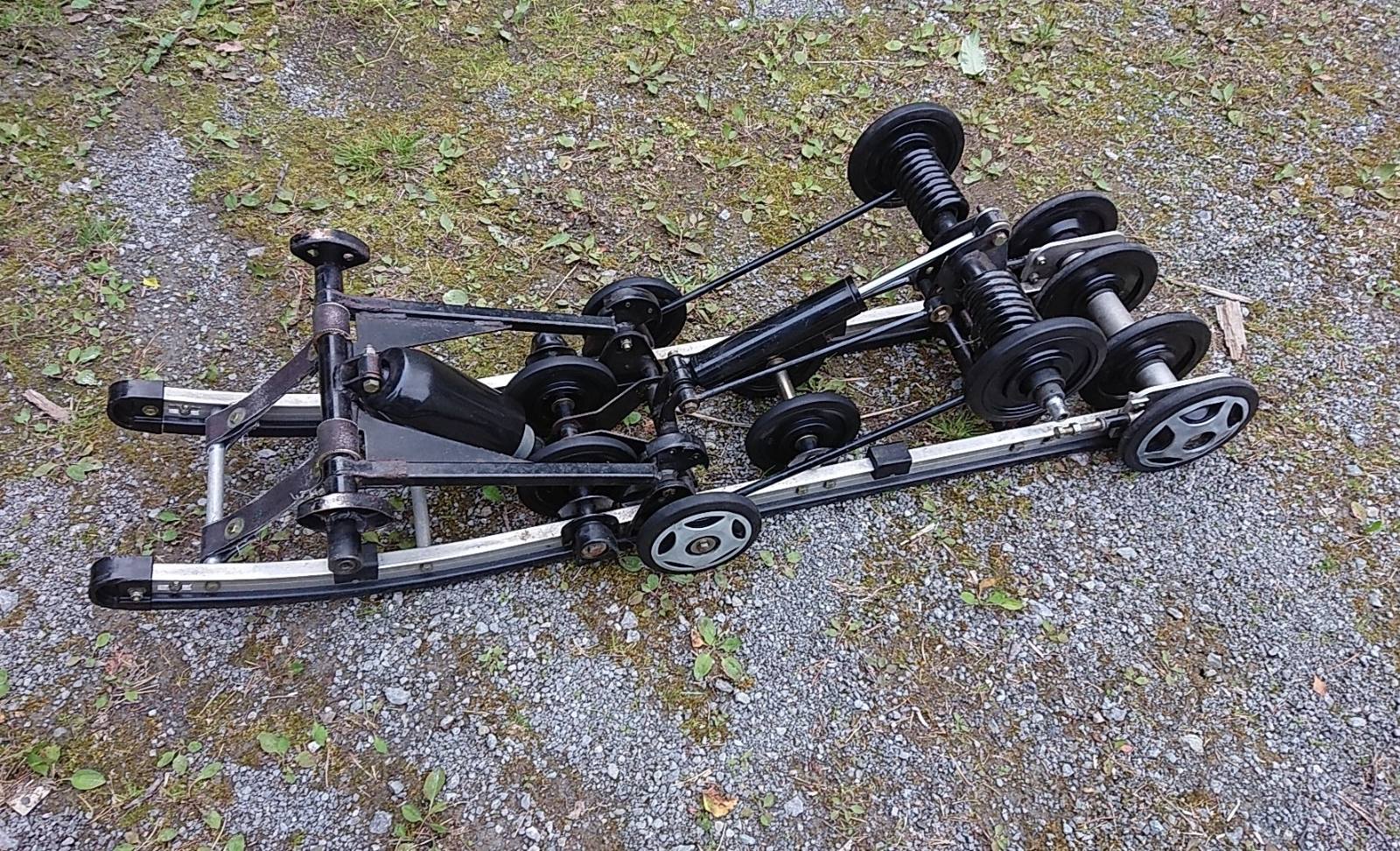

Arctic Cat JAG Z. Rear suspension removed and all the wheels are getting new grease or bearings if they can't be saved. Skid was in better shape than I thought.
Next up, front suspension. Any suggestion how I can remove the rear bolt on the lower A-Arms without removing the engine or bellypan? Otherwise I remove the spindles and mask and paint the arms without removing them.
A 93, nice!
You don't have to remove engine or belly pan to take the control arm bolts out.  I replaced the bushings in my 94 z, our 96 jag, and in the puma last year.  Didn't remove engine or belly pan.  At first I thought belly pan would have to come off but it doesn't and it's really not too bad at all to do.
I think if you remove the exhaust is all you have to do
Edited by mnstang
Ah, I'll remove the exhaust and see what I can see..

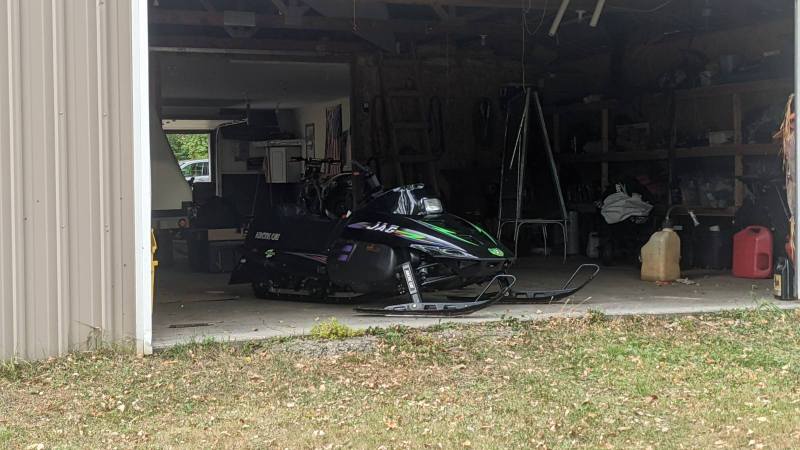

This weekend I got the Jag out and finally put the snopro motor in.  Wanted to get another jag to be the mod but that is not happening so doing it to the 94.  Good amount of time into this motor and lots of reading and over analyzing things as far as timing and exhaust to run.  Hopefully it turns out good.  It's running and I even took it around the yard but it didn't like that, I dumped a bunch of oil in the crankcase when I put it together and it was still burning that out it is running good now on the stand but I haven't even begun jetting it, still using jetting from the stock motor and it's running lean even at 70 degrees today.
And I looked at it a bunch.  Man it looks sweet.

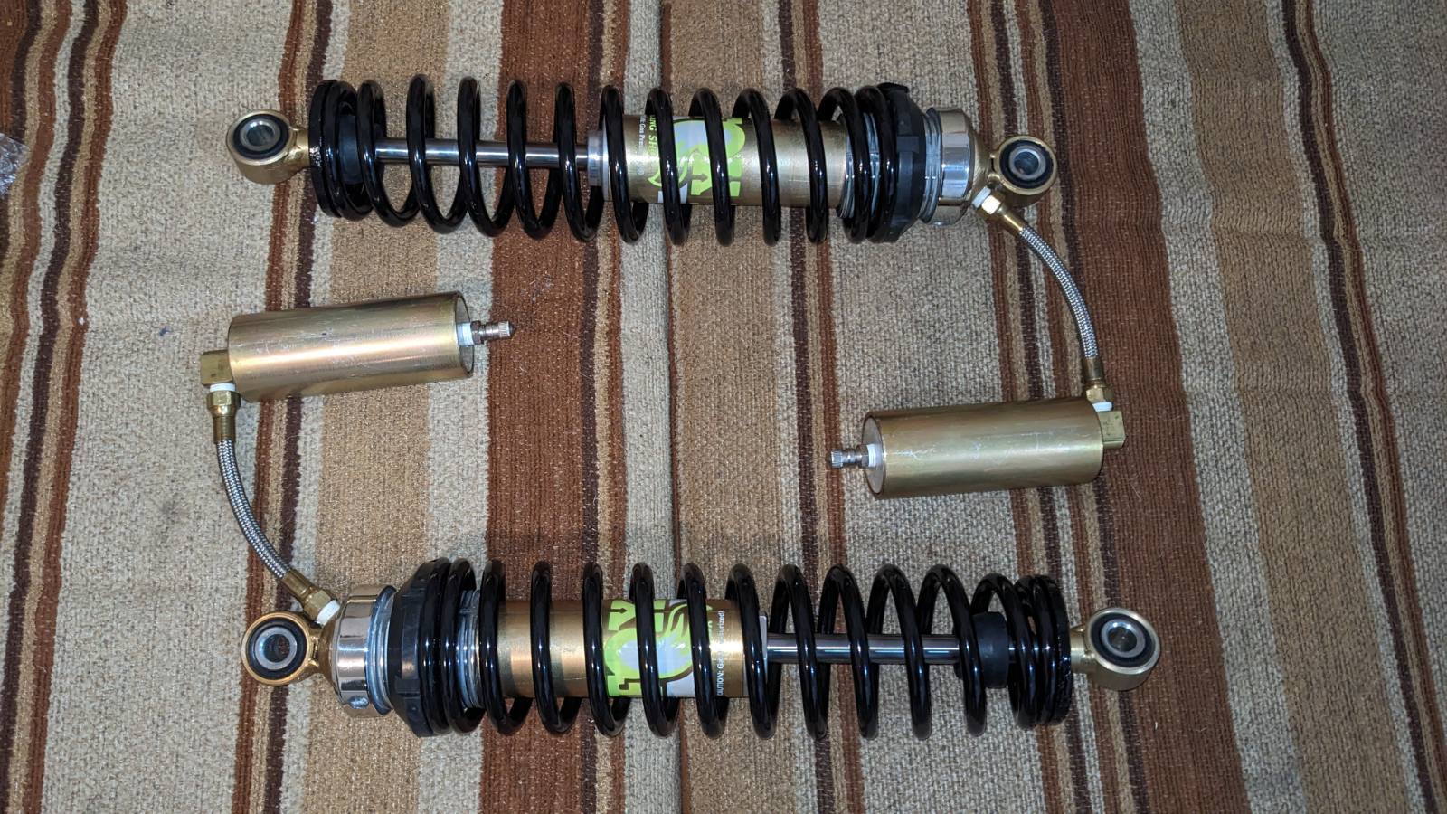

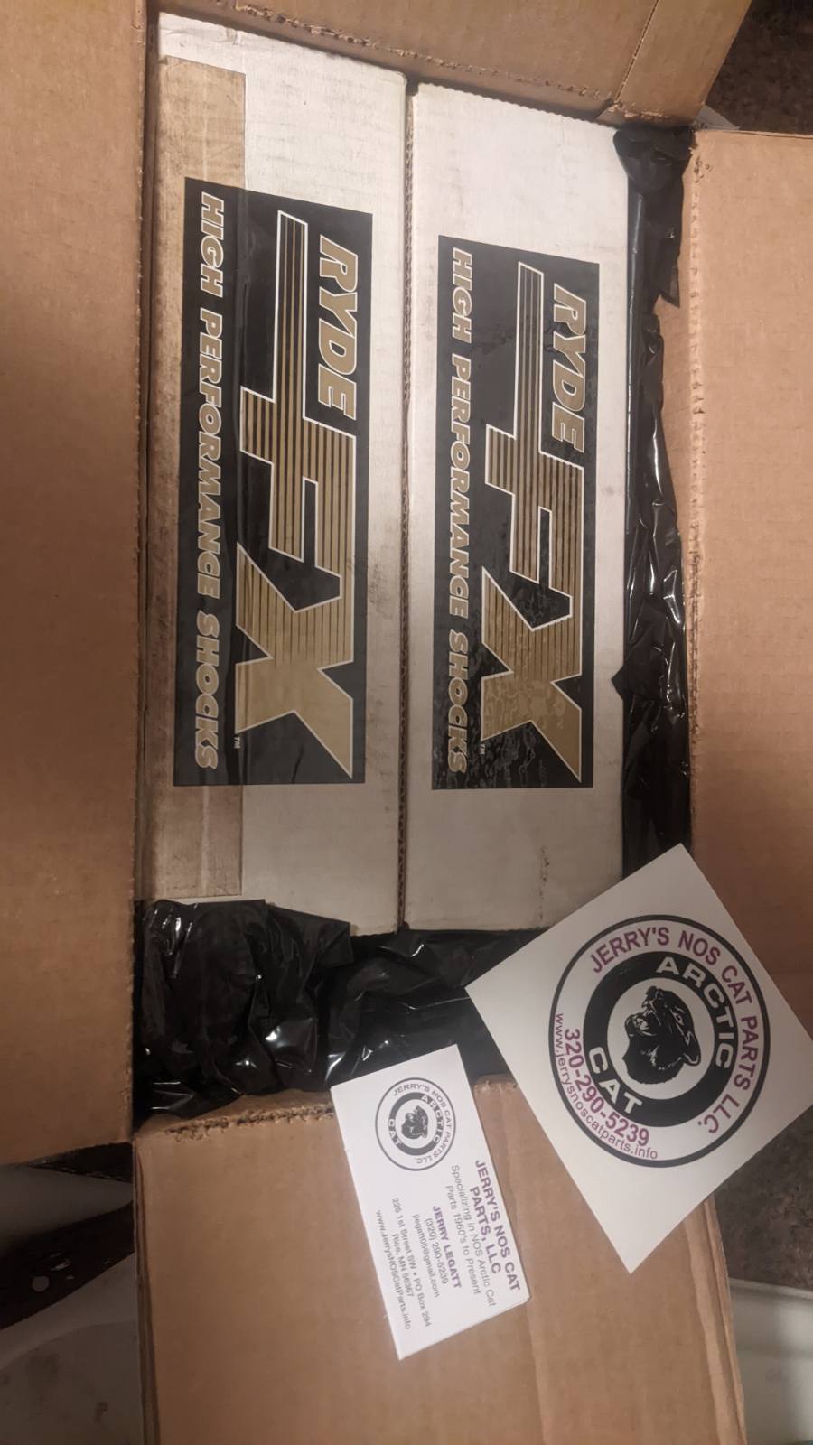

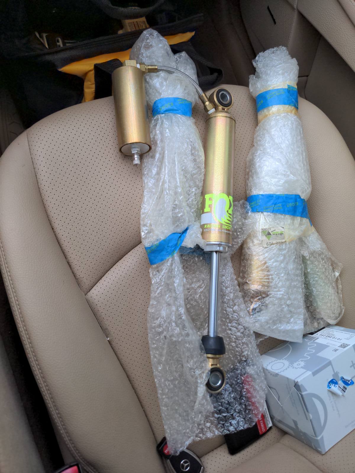

Sourced a couple more shocks so now I have a complete set of NOS Ryde FX accessory catalog shocks for the 94 jag.  Sick.
Also the 96 jag got some early use.
Also sourced some period correct, stock appearing aluminum skis that should be good for a 12 pound weight saving for the 94 and the 96 will likely end up with the 94 skis because the 96's are wearing pretty thin.

Jerry is a good guy and has a ton of stuff.
For sure, he is a good stopping point at Princeton.  I was super pumped to find the shocks on his site.  Great price too.  Last two.  I only knew the part numbers for them because I picked up these old RV sports catalogs and they had them listed there and then I searched Jerry's with those numbers.  Even the old performance manuals I have didn't list those shocks.  The RV sports catalogs are super cool to look through!
Bought a few things from his nos stuff when I had the old cats. Pretty impressive inventory.
You should go to his shed/shop.

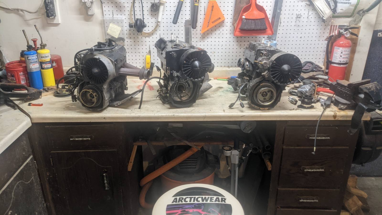

The mod Jag is pretty much done.  I have a different helix to put in for next time out.  All four nos ryde fx shocks are in, they look great in front.  Don't notice a ton of difference in ride but they are set-up differently with spring collar positions so like the FTS now has considerably less spring preload than before... Wasn't sure about that because it handled so well before.  What I've noticed with back to back comparisons with our 96, the 96 is more squirrelly, the back end steps out quite a bit in corners, not where it's going to come around but probably more than needed as it probably scrubs some speed.  The Z still steps out which helps a ton for turning, but it's less and more controlled.  It is more stable in a straight line also instead of how it was before it'd be squirming around just trying to go straight in some snow condition, I forgot about that till I hoped on the 96.  It is an absolute dream handling machine, getting in those tight forest trails with constant up downs and all arounds, there is nothing funner that I know of, you can push it very hard and these sleds respond so well to rider inputs.  You're drifting through every corner but at very fast clips and it's controlled and effortless, faster than you can get through on bigger sleds, it is just so damn fun and the trails I ride are perfect for these kinds of sleds.
On the Z I did a custom frogzskin air intake on the console so it's a straight shot straight into the airbox.  Pretty trick.  Still running the air silencer though, it's way louder with the frogzskin and then with no air silencer it's crazy loud.  Might do some testing/modifying with that at some point.  I did a custom fan shroud that seals up pretty perfectly to the big hood vent so it's pushing all cold air from outside the sled through the motor.  In a straight line race it now murders our 96 which is a pretty good runner.  We went from a few different rolls and even giving the 96 a pretty good jump, the Z instantly reels it in and pulls right by.  To the point I was asking my brother if he was even full throttle and then thinking something is maybe wrong with the 96 but there wasn't.   I'm still not sold on my port job on the motor but I did pick up another snopro motor so at some point I'll swap those stock cylinders on as a test to see the difference, probably next winter at this point.
I swapped the original 440 motor out of the Z and into the puma.  Single carb at first and was using some 440 LC cougar exhaust at first because I didn't have a spare 440 FC exhaust.  Ended up picking up a 93 jag Z for $100 at a swap that is mostly complete, missing clutches, recoil, couple things here and there but I couldn't pass it up (I wanted to) because I would've paid $100 just for the expansion pipe.  That sled has been a HUGE score.  The motor looks perfect inside, like it was fogged before they parked it and it has zero scoring on pistons or walls, zero!  The fuel valve was off and it looks like they ran carbs empty before parking, there was no funny business there either.  So the puma got the correct exhaust pipe.  I now have a spare can so I've done version one of modding that and it is on.  I put the entire twin carb setup on the puma, having a donor was crucial as there's always more stuff like throttle and choke cables, intake boots, intake manifolds and the aluminum fittings, airbox, fuel pump.  The puma absolutely rips now.  It still has puma gearing which is lower but it'll probably give the Z a run up to 60 right now.  Very happy with it.  I'm going to put jag gearing in it today though.  Now it is still a great utility sled for around the farm but it's now an extremely capable trail sled option for a backup, two people, cold weather days, or whatever.  I also took the entire front end and sway bar from the 93z and will clean it up and eventually get on the puma, probably next winter.  2" wider front end and I have some one year old nos shocks for it too that were on the 94.

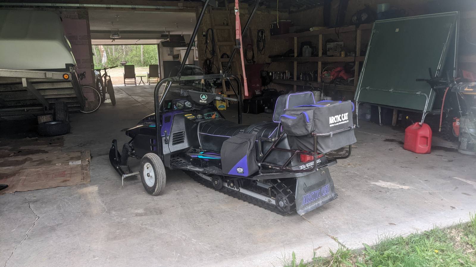

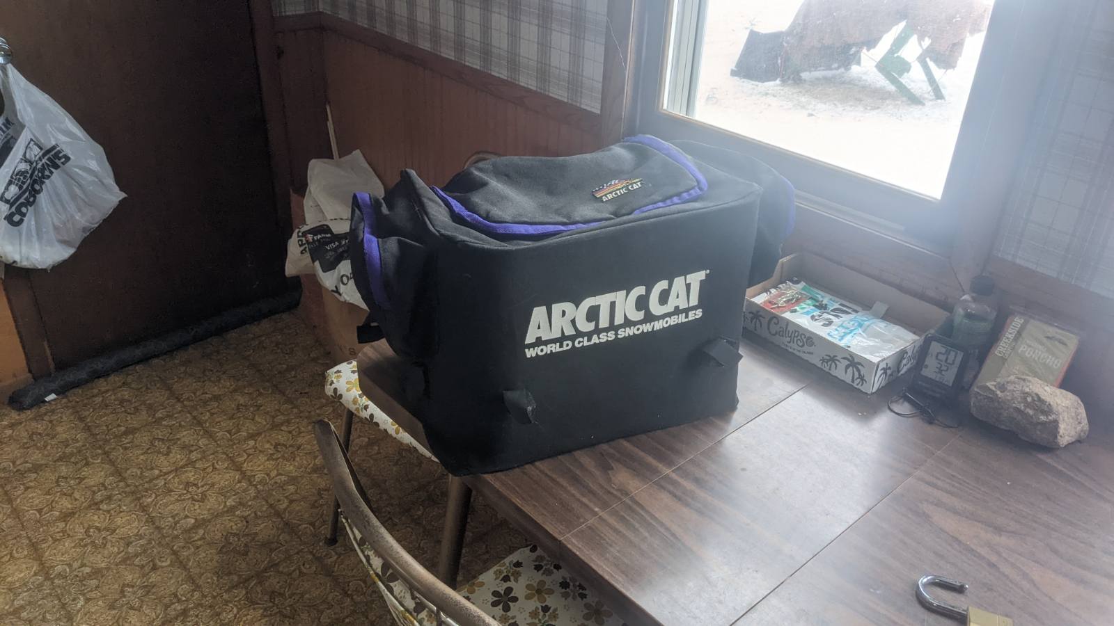

I got this sweet cargo container over the winter and finally installed it as I put the sled away.  I had to slide the rack back to fit it and then redo the backrest again.  Pretty sweet!  I've seen these in the old accessory catalogs and always wanted to fine one.  It velcros to the rack in 6 places so it can be removed easy.

I recently got a bag like that on eBay for my T660 turbo touring, came with a factory tool kit!

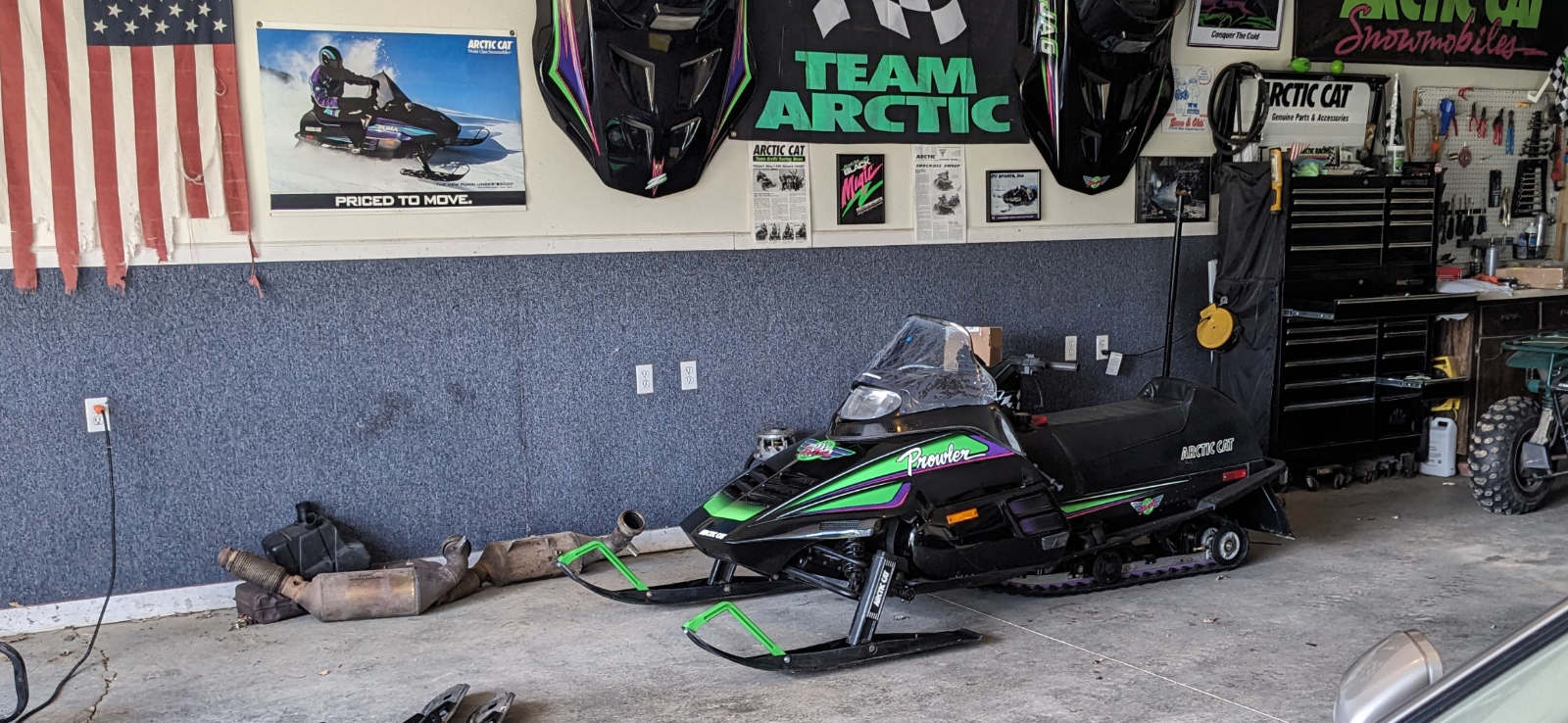

Got one of the cooler aws1 sleds, a 92 prowler special.  Got some nos shocks for it, an accessory nos low windshield, the accessory plastic skis with green loops.  Motor now on bench because I found the stator side crank seal completely smoked so it's getting a full reseal and Suzuki pistons.
Big summer project.
