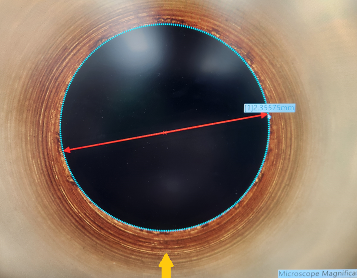

Once I stuck them under one of our high end scopes, found a couple things I suspected, one I didn't.  First was our super expensive microscope measurement software does not recognize the the lenses installed in it, so the measurement on the screen may not be what the actual measurement is.  Orange arrow is a machining mark that follows to the top of the hole, so the concentricity isn't there, but may not be a big deal in this instance.
Size marked isn't consistent.  Some may be mis-marked?
Marked size vs. Measured "size"
200 = 2.37359mm (larger then both 210 and 220)
210 = 2.28310mm (should be 200?)
220 = 2.35575mm (should be 210?)
230 = 2.49449mm
240 = 2.53387mm (should be 250?)
250 = 2.50634mm
260 = 2.54915mm
270 = 2.56316mm
280 = 2.63920mm
290 = 2.65792mm
Would I buy them again?  Maybe?
Trust them to be consistent?  No
Chart them out compared to Mikunis and use them as "odd" just sizes?  Maybe?

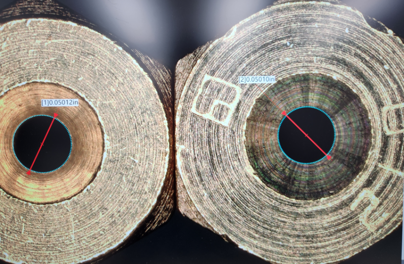

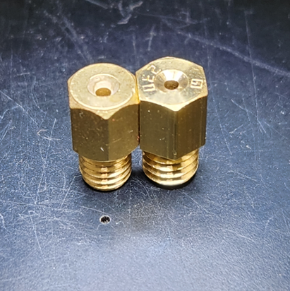

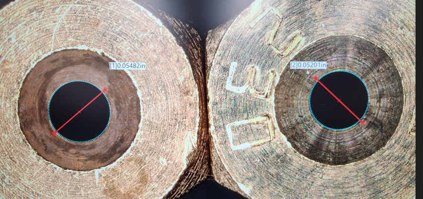

I have had a number of aftermarket jets never trusted them, none of them had the same taper as the Mikuni tested by inserting a Mikuni needle end of the jet.
Comparing the Mikuni to the cheap shit.
Only had 210, 220, and 230 to compare to.  210's were the closest match to one another.
210:
230:
210:
230:
Not sure if it's just the picture but the threads looks a little different too.
Those cheap ones are probably only about good for smoking your drugs out of
