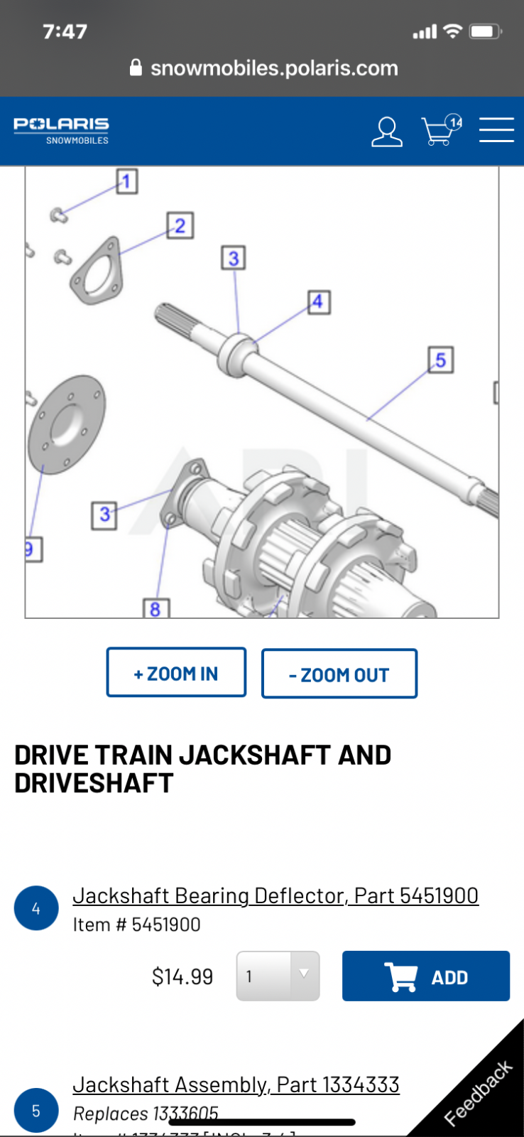

So before Rick tries to sell me one, what did you use for a deflector?
Stock $14.99 jackshaft deflector drilled out to 1 1/4”

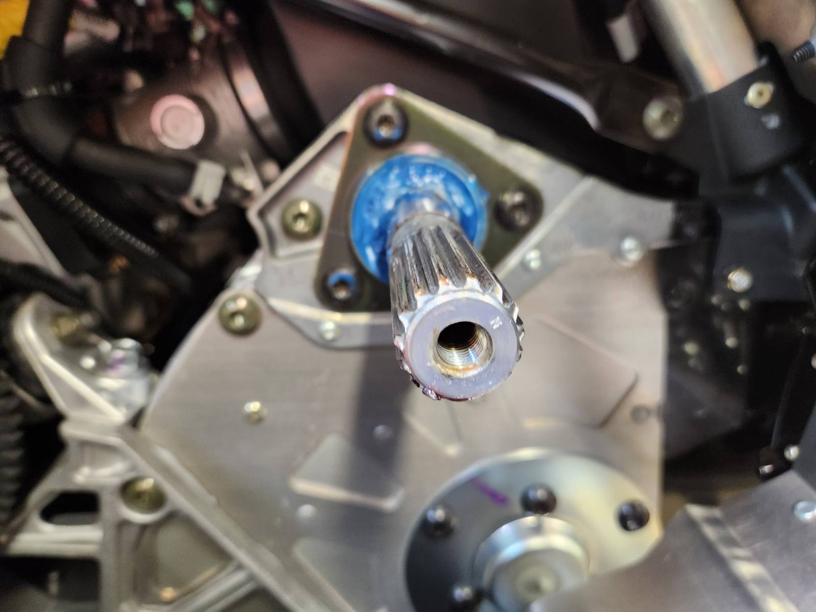

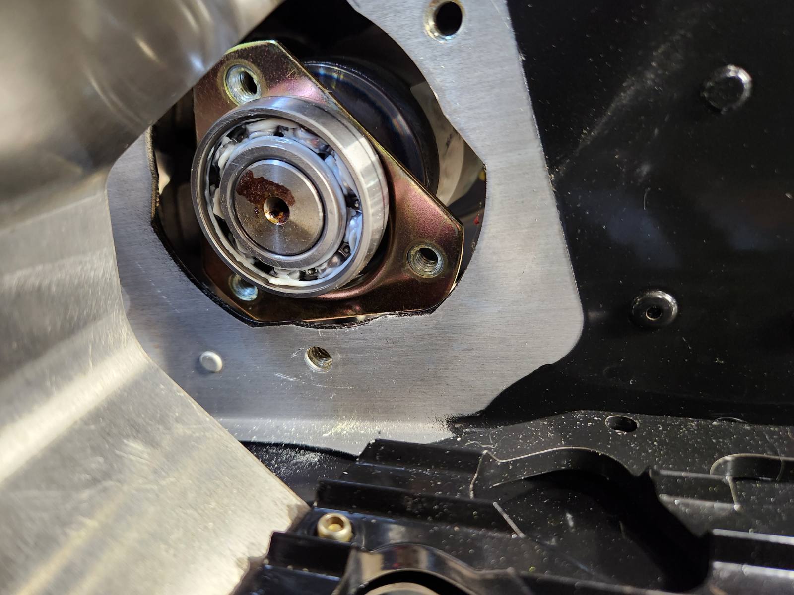

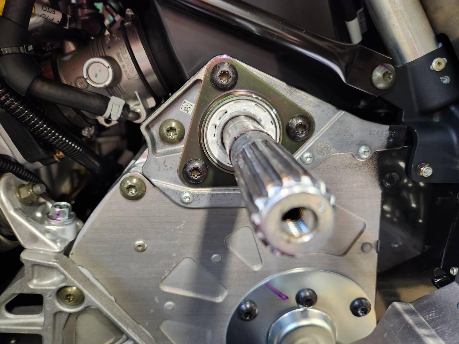

Pulled the seal off a 2024 jackshaft bearing and looked good for grease but I still added some.
Would have liked to have seen more grease in the drive axle bearing.  I did add grease.

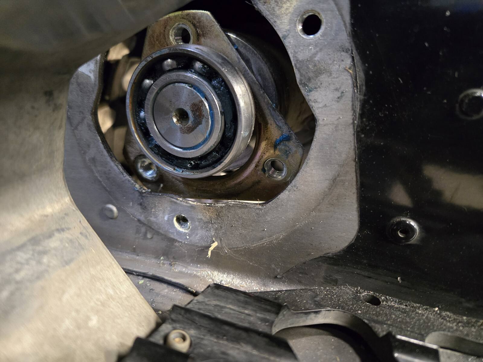

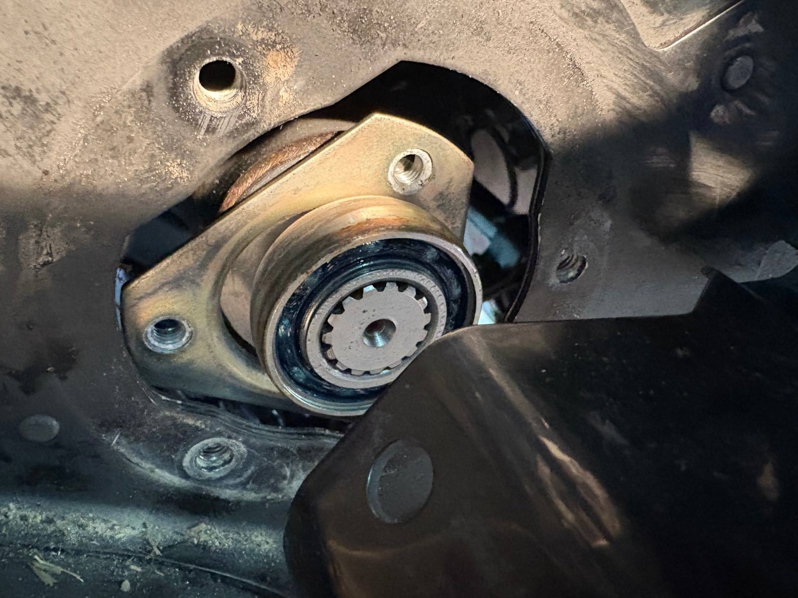

Figured while I was going through shit I’d check this driveshaft bearing, been at least two years and at least 2500+ miles since I checked it.  It now has ~10,000+ miles since putting grease in it and the deflector on the inside of the tunnel… I’m putting the seal back on it and running it!
  • 1 month later...
