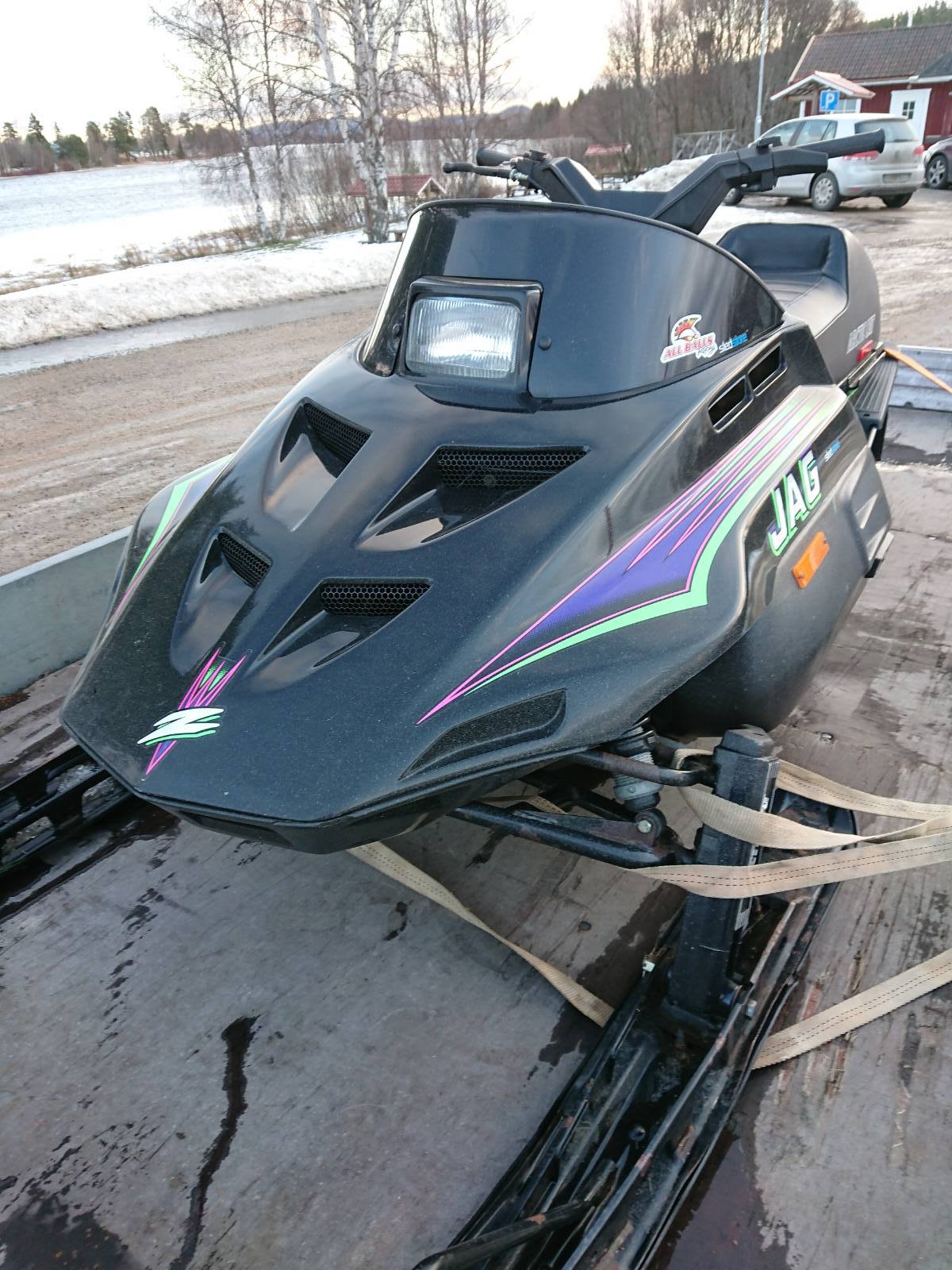

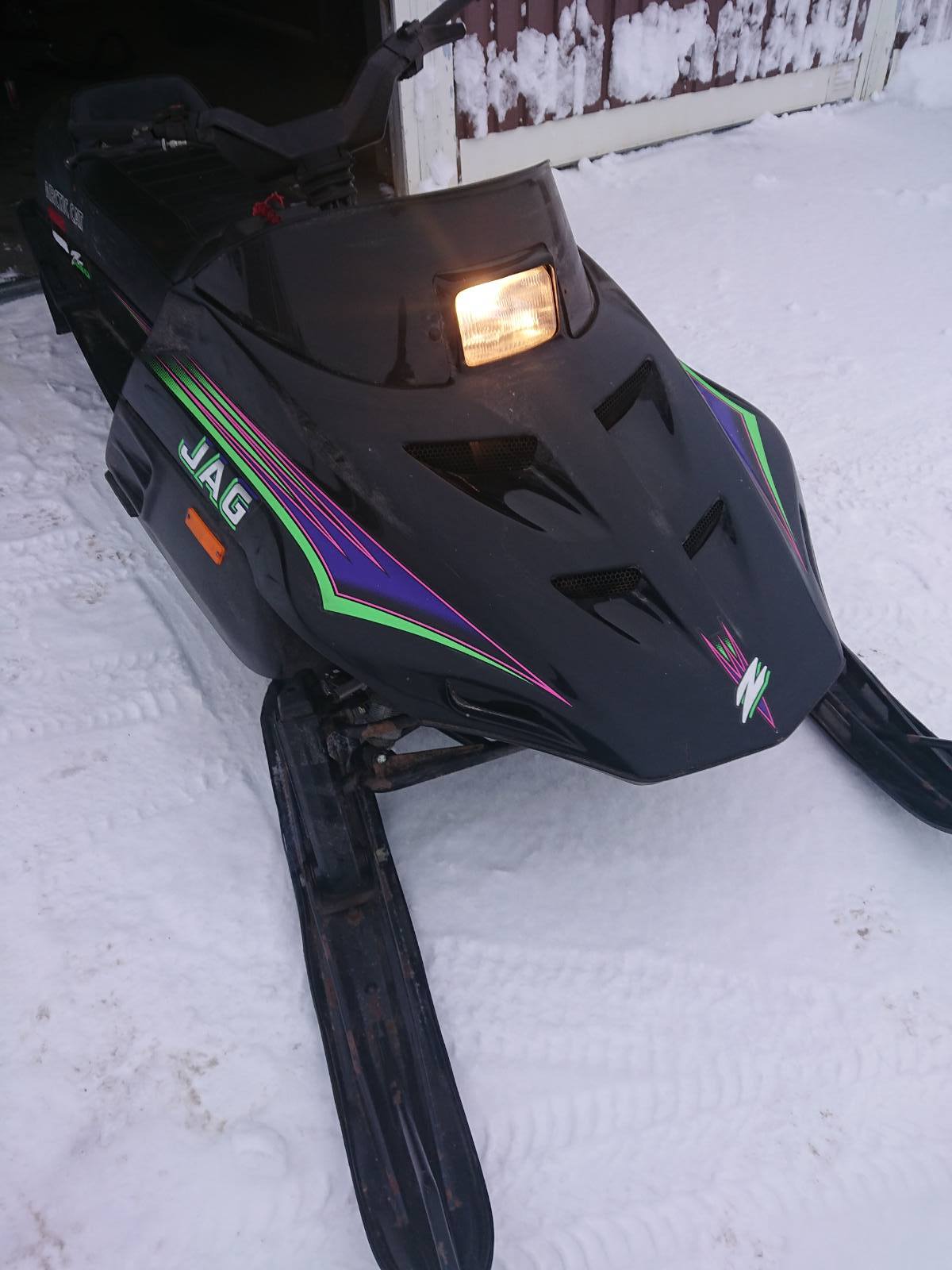

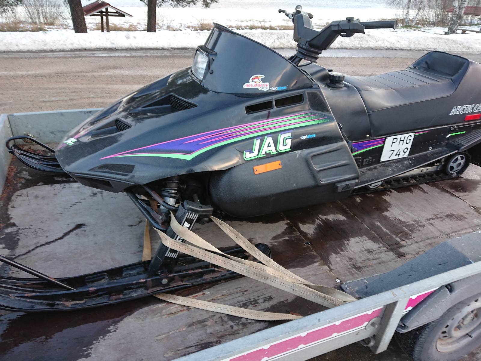

Picked up a 1993 JAG Z Special today, decent condition and runnable. Needs some love and new parts.
Hood has two cracks and the "chin" also has some cracks.
Ignition key is broken in lock
New tether is needed, has the mandatory screw inside it to make it work right now
Switch in throttleblock is out of order
Seatcover needs some stiching or better a new cover
Peeling paint on suspension parts
I think I´ll just fix ignition, throttle block and tether this season and run it. More fixing in the summer.

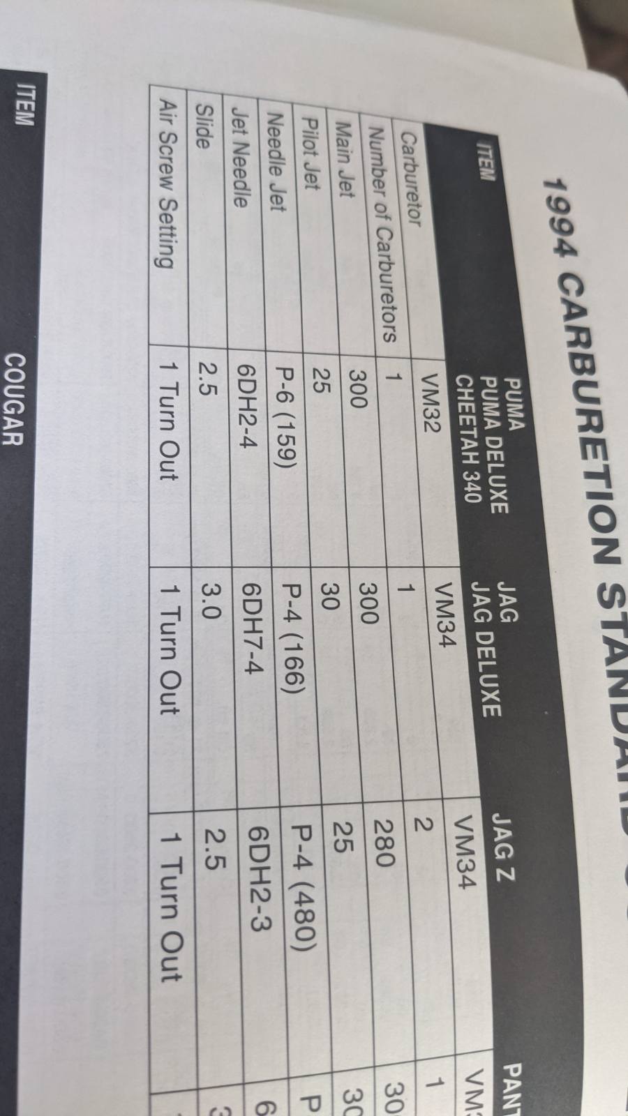

Got no book so I would like to know the default jetting for this machine, any suggestions for main, pilot, needle setting and screws?

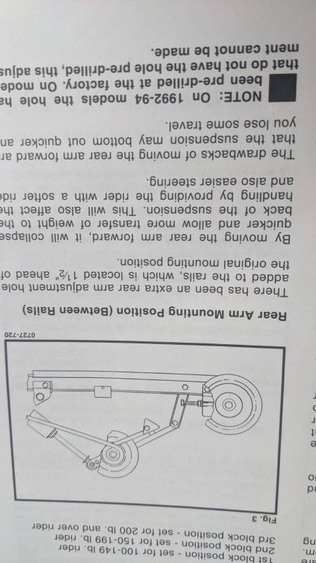

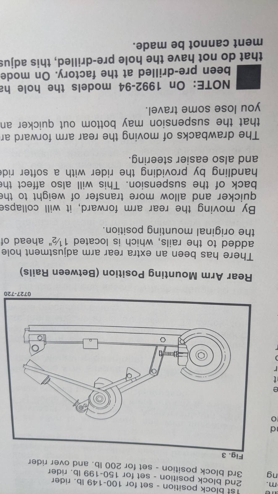

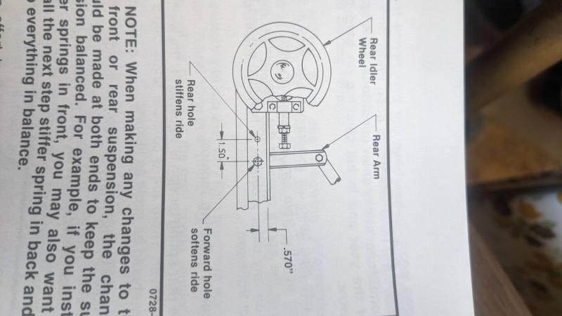

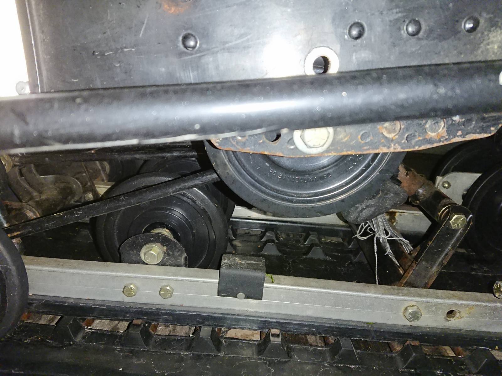

What effect does it have to move the rear scissors forward or rearward?
Suspension is in the lower hole, as I remember it that will get me quicker steering, am I right?
Nice, I like the 93's and have been looking for a decent one to pick up myself.
What is going on with the extra lever by the throttle?
The stock scissor position is the rear hole.  Moving it up makes it collapse easier.  The stock tunnel mount is the upper hole.  I don't think it'll make the steering any quicker, it might make for more ski pressure, but with the scissor moved also, hard to know.  I'd put everything back to stock and see how you like it.  They got the handling and balance very well with it stock.  You for sure don't need more ski pressure.  They already beg to turn and could probably use a tad more straight line stability.
As for jetting specs.  I don't know offhand and I'm not at home where my books are.  But you can look up all your jets sizes in parts finder websites like at www.thomassnosports.com, and order parts there too.
You might be different than my machine due to elevation, temps, etc.  I run stock main, pilot, and needle.  I did try different pilot and mains but found my way back to stock.  It likes the stock pilot the best for sure. I did drop the needles one clip though, that helped alot.  I can look up the air screw setting, I know mine are pretty much what the book says.  It runs clean and crisp.  Don't try to lean it out too much with the main jet, a little rich is fine and it helps keep the motor cool if you run it hard.  I only dropped the needles because I had to, it was too blubbery at part throttle in the stock position.

In Sweden it was mandatory for snowmobiles to have "two independent brake systems" for a couple of years, some airhead politician thought that if the wire broke you would be brakeless.
Yep, the same as if the chain breaks... and both levers actuate the same brake! So if the lever down at the brake rotor comes off you would still be without brakes.
Also it was mandatory with a horn, but the rubber ball horn is luckily missing on this machine.
Of course the extra brake will be removed, less weight and you can move your hand all the way in to the throttle.
Thanks for the tip about parts sites, hadn´t thought about those.
Ostersund where I live is about 312 meters above sea level (1023 feet) so I think stock jetting will do.

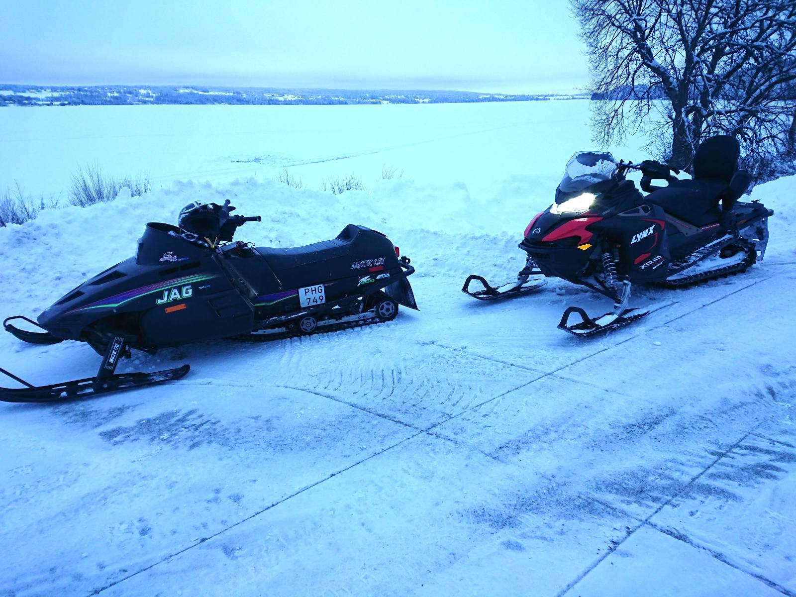

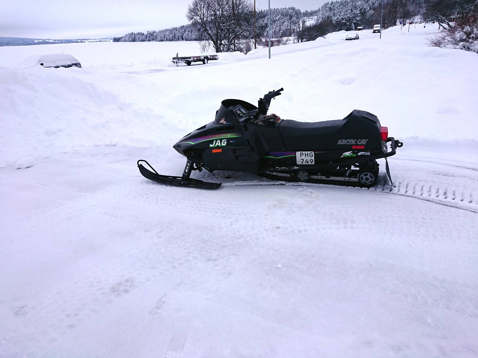

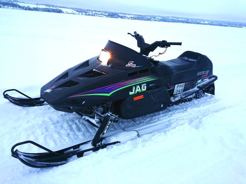

It´s alive! MOOAHAHAHAHA! Hrm. First run for the season and I got to test the JAG Z i bought before christmas.
Faster than I though it would feel, and that was after a hour-long trip on the Lynx 850!
Speedometer not working so I have no idea how fast I went, felt like 200 mph since it is so low. :-D

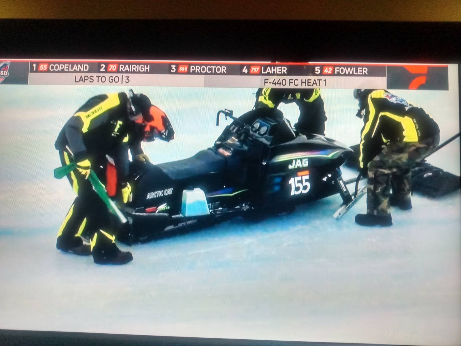

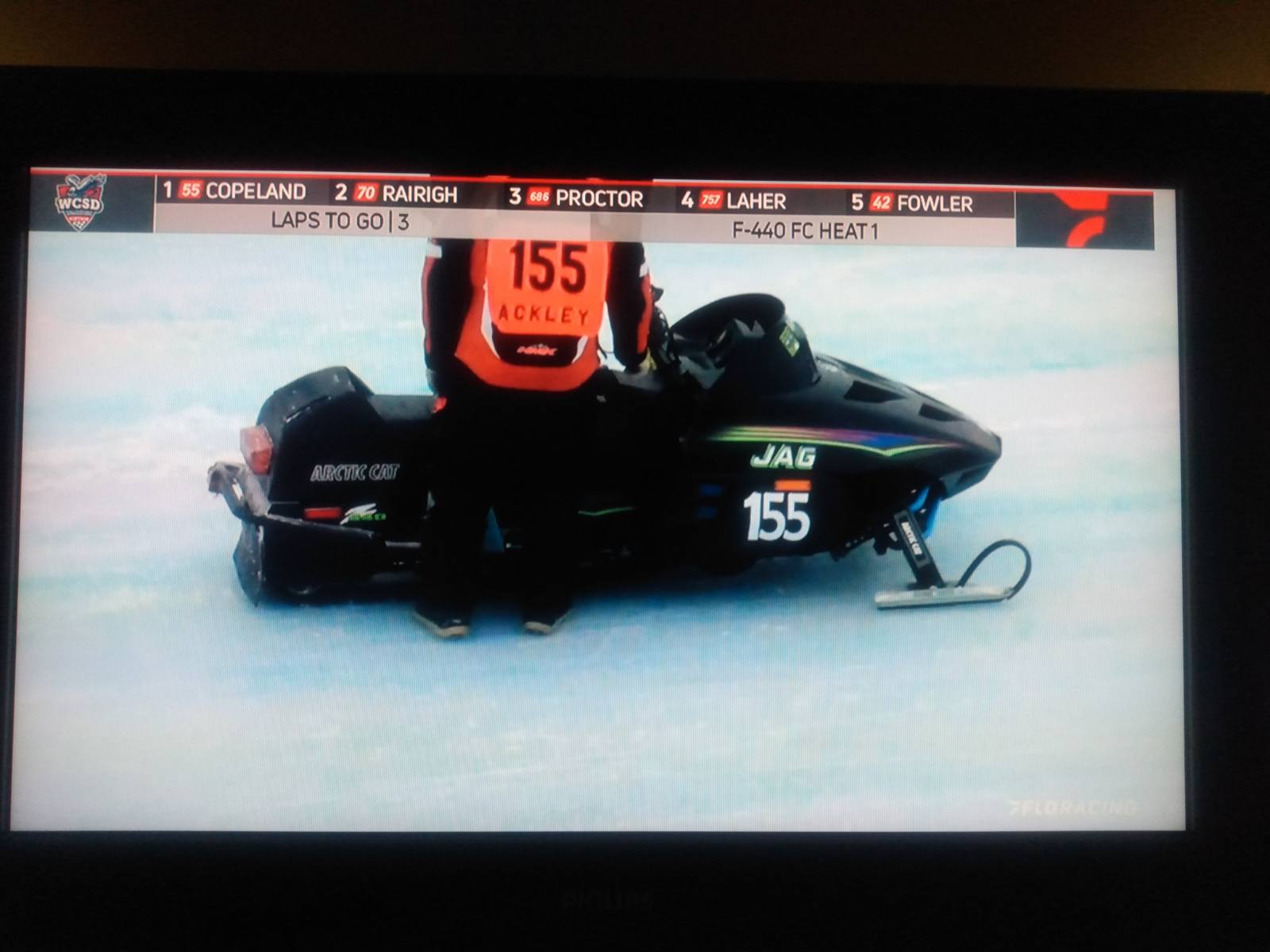

Jag Life

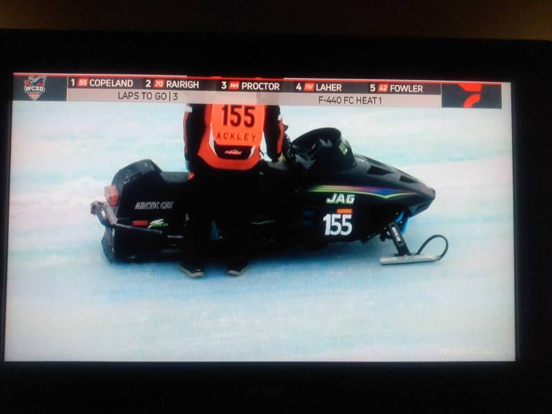

A literal screen shot From Eagle River vintage races:)

I rode mine a little right after riding the 800 and wasn't sure how it'd feel but it still felt fast.  Squirming and fighting for traction will keep it entertaining, it even picked a ski up once when I pinned it at around 30.  I can't wait to ride it some more.  With the gearing they go about 80 on the speedometer, I think I got slightly over 80 on a road last year.  Usually 75 on average trail conditions.
Usually a speedometer not working is an indication that your track shaft bearing is bad.  When it goes bad it will break the little 2" cable section between the shaft and the speedo adapter.  If it has all balls bearings in it, it's probably bad.  Those are the cheapest shittiest China bearings.
9 hours ago, mnstang said:
<snip>
The bearings was recently changed by previous owner, so maybe the speedo was broken already then..
