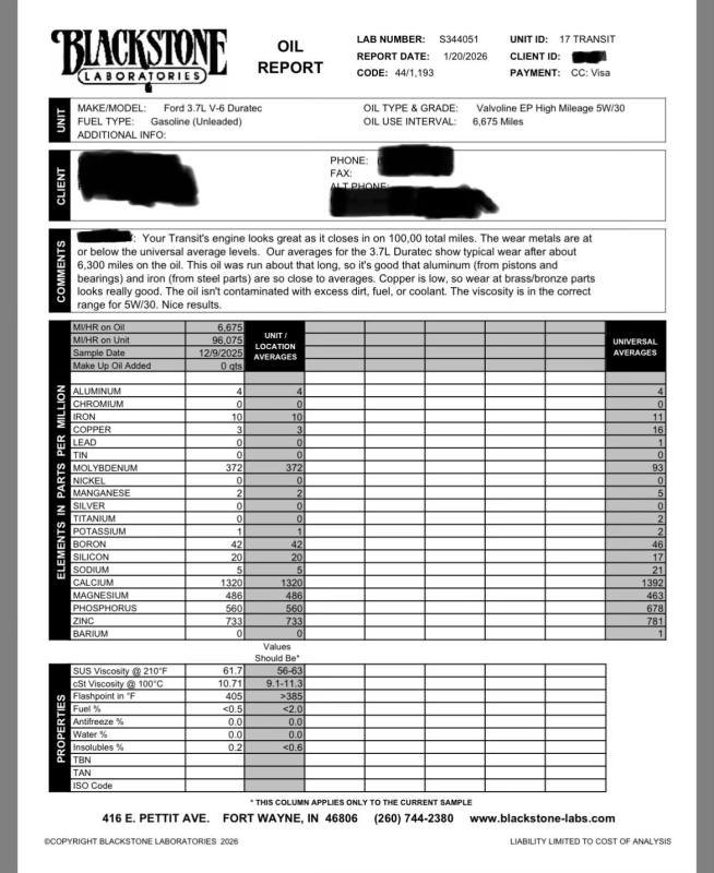

I had a 2015 Explorer Interceptor with the 3.7. I hit a deer at 70 mph and the entire left front exploded in chards of broken plastic everywhere. Insurance totaled it, had about 115K miles. Ex WI Border Patrol vehicle.
I don't like the timing chains and internal water pumps on those engines. Top speed was indeed 141 mph.

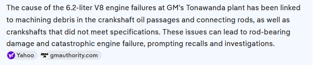

The interceptor has no speed limiter and holds the shift rpm longer in pursuit mode. There was an occasional issue with aggressing shift in pursuit mode. The connecting rod played peekaboo outside the motor. The longitudinal 3.7 in the transit, mustang, and F150 has an external water pump. Much better design. Water pump replacement is a 1 hour job. 400,000 miles isn’t out of the question with that motor.
Thought about buying the 6.2 when I bought the last pickup. Just have a 5.3 that occasionally has a whiff of coolant smell instead.
I wouldn’t go near a 6.2. Several builders have identified that the rod journal oil passages chamfer is too wide. The system can’t keep pressure and the oil film thins. 6.2 motors being rebuilt using Manley cranks have run flawlessly. Those cranks have proper chamfering. .100” smaller chamfer. On a rod journal that is huge.

The area between the chamfered edge of the oil passage to the bearing shells edge is .100” smaller on the GM vs Manley cranks. 1/10” inch difference. Very difficult to keep proper oil film strength with a chamfer that wide.
Manley cranks are one of the best out there. For the price. In fact all Manley stuff is top notch. I use their parts in my race engines i build.
Rod side clearance is a very important spec. Even a little to big creates low oil pressure.

Where it’s made is irrelevant. The cranks were made to within engineering specs. Millions of crankshafts and critical internal engine parts are manufactured in Mexico without incident. It’s another MAGA red herring.
Its a total coincidence that the only LT based engine using mexican made cranks, is also the one only one with common crank/rod failures.
