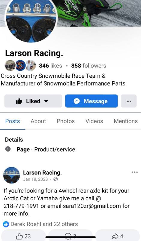

JT or Larson kit are worth the money for 2 reasons. They use really good wheels/bearings and they also use a billet axel and adjusters. The only down fall to them is they are the most expensive but they will last forever. The stock rear axle set up is very cheaply made. JT is running a sale right now on their’s for 300 bucks which is a really good price on it. The Larson kit is kinda hard to get. JT has a website you can order it from.
Here is a link to the Jt. Might have to call him to make sure you get the right parts for the catalyst. I think it is the same as the procross.
https://www.jtatv.com/4th_Wheel_Kit_s/53.htm
I have also attached a picture of the Larson kit. This is what top xc teams run. These 2 companies make the best kits on the market.

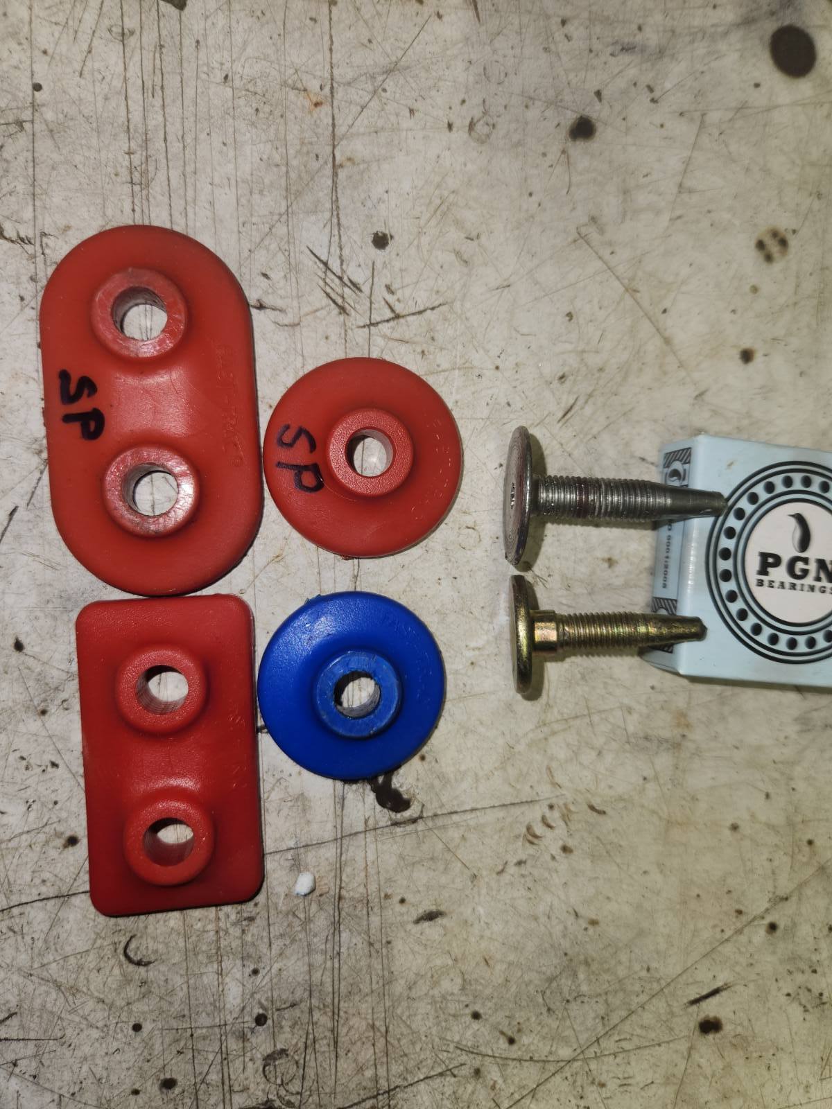

Just an FYI what I've been using for a while the standard 2 ply studs with single ply backers. The single ply backers are slightly larger in diameter offering a little more support
3 hours ago, Doug said:
Been running fasttrac for years with good results.
I was talking to a stud company at haydays years back when the 1 ply/2 ply was a thing. They said the ply did not matter. They said the bigger pitch track (2.86 skidoo was the first to use) needed the bigger stud heads because of how it wrapped around the drivers not because of the thinner track. How true that is I don’t know. I bought their smaller heads and ran it on a 1 ply 2.52 cobra and never had a problem. I did run a lot of them. I was planning on buying the big headed ones but they said it wasn’t necessary. I also don’t think the brand of studs matters any more. I have ran a lot of them over the years and no brand was better than the other.
I still ran the smaller head stud just used the single ply (SP) backers.
