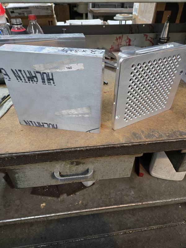

Turning the block on the left(3 of them) into the part on the right.20260701_102714.jpg

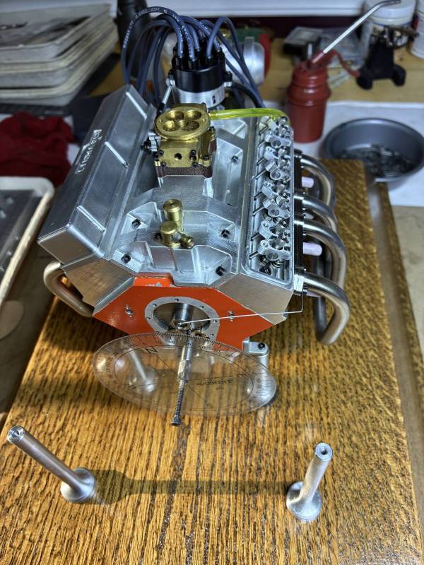

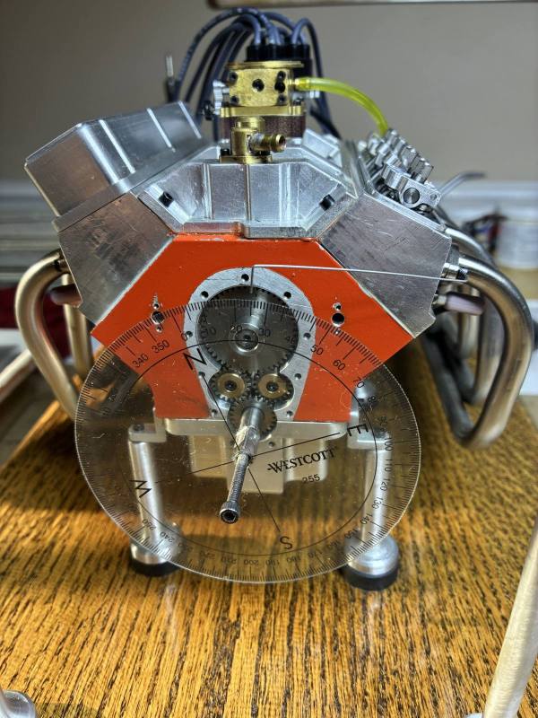

The little demon hasn’t been running well so Im checking cam timing. Still looks spot on. I may pull a head and have a look as I have not had this apart since I completed it.

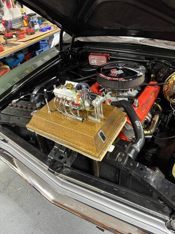

How big is that?
What does it power?
2 minutes ago, Voodoo said:
How big is that?
What does it power?

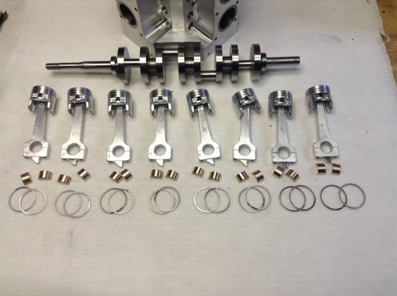

It is 1/5th scale. Runs on Sunoco 110. Water cooled with a splash oil system. All built from billet stock. Every single piece is made by hand from scratch. Over 1000 machined parts. Camshaft, spark plugs ,heads ,block ,crank ,pistons, rings, titanium valves ect.. Spark plug boots too.
I built it to push my machining abilities. Plus Im into scale model stuff.
I bring it to car shows and fire it up and people come running lol. Its awesome
Reciprocating and rotating assembly

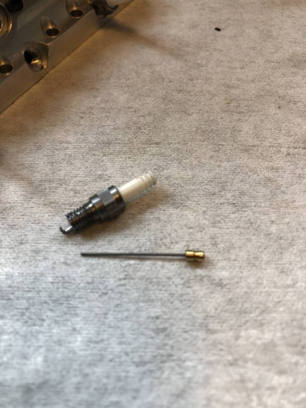

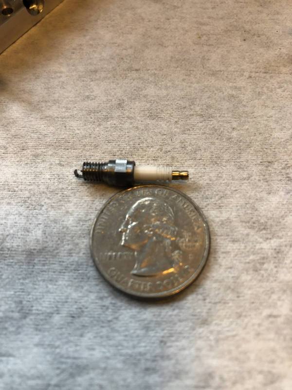

So... where do you get spark plugs for something like that???? And what size are the threads on them??
The plugs are all hand made. The insulator is corian countertop material. The thread is 8-40
