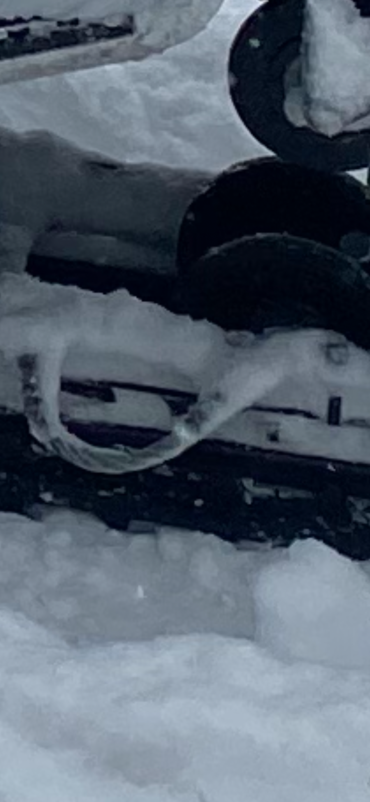

  • Not bringing the sled to a fashion show, cut a section of old garden hose in half and zip tie that to the rail.  They’re covered in snow in a mile when not in use if you’re concerned with looks.  Cabl
  • exactly what we've been doing for years.I also carry zip ties to tie them to rails if i know im not going to use them much on trip.like to fall off .

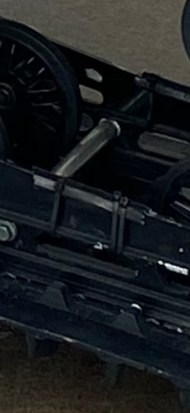

I added a couple simple eye hooks, got lucky with an existing hole in the rail.
I don't have any exisiting holes.
Maybe this?

Not bringing the sled to a fashion show, cut a section of old garden hose in half and zip tie that to the rail.  They’re covered in snow in a mile when not in use if you’re concerned with looks.  Cable scratchers work just fine.

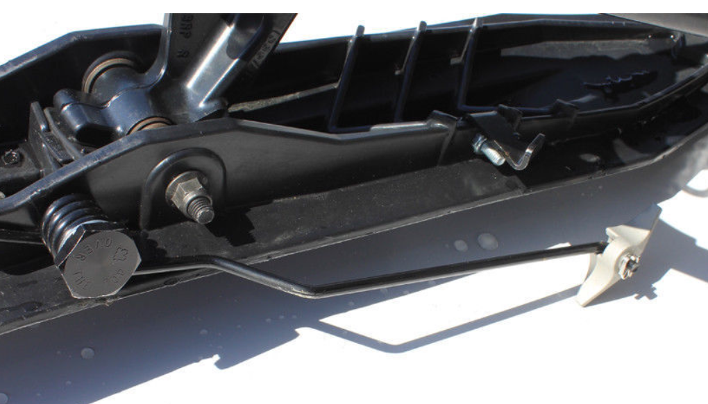

Too late to change things around now, but I won't ever run rail mounted scratchers again.  The ski mounted ones (I run OTTP style) do the job and keep temps down & still kick up enough to get into the track to lube the slides.
Pic?
1 hour ago, Mag6240 said:
Pic?
I wish I had pics from my '19 XC but they went bye-bye with my old laptop.  This is the gist of it though (they go on the inside of the ski to kick snow up into the front of the track):
